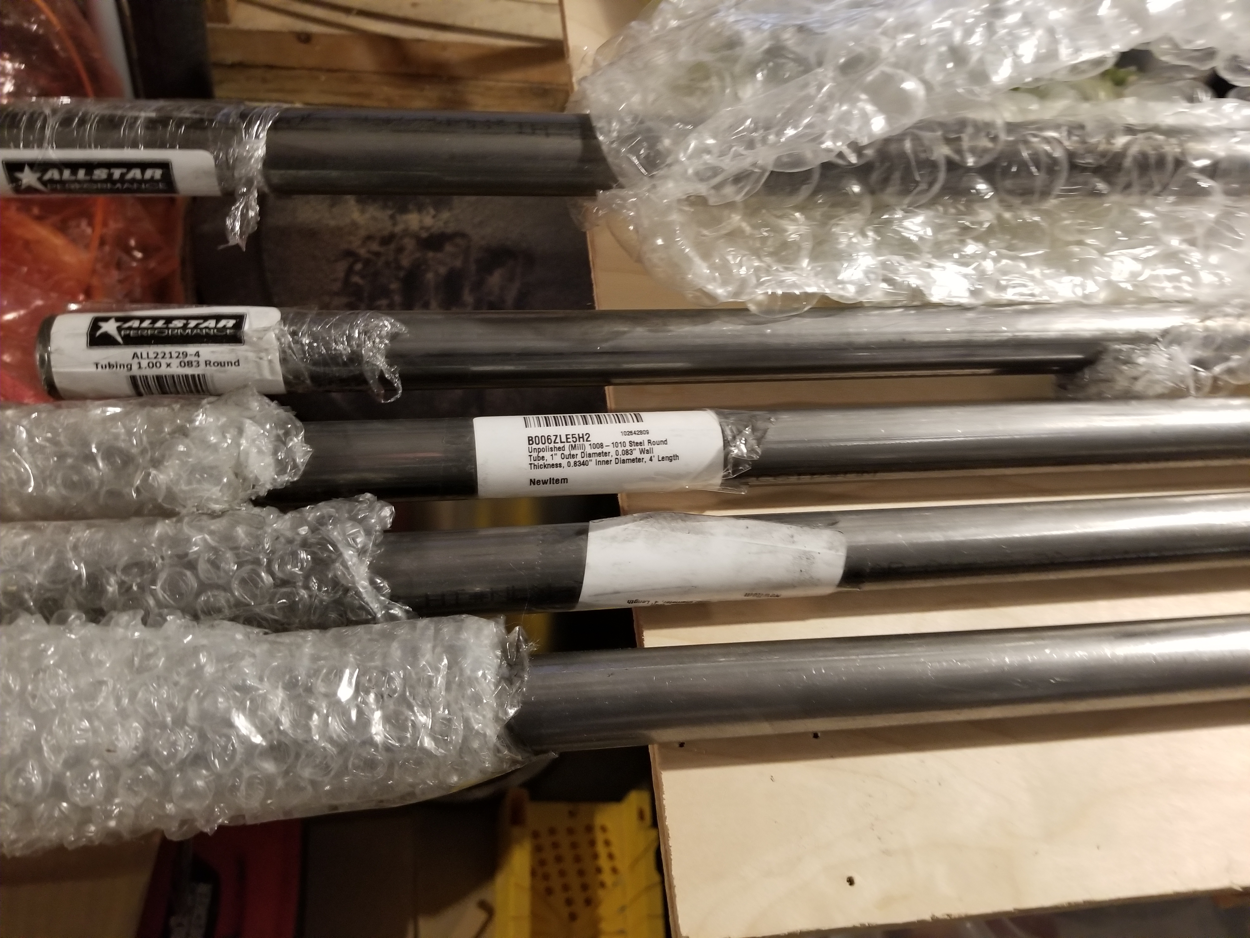

Got the tube from amazon (linked above) for $9.59 per 4’. Seems to be the same as the jegs (all star branded) so hopefully good? Right on spec too! Tubes were mostly packed fine, but I did find some scratches on one.
Next up, picking colors and starting to print. Then ordering upgrade kit :slight_smile:
The only ones that matter at all are the legs, and those do not really matter it is just way easier if they are all the exact same length. The rest you could easily be 3/8" off and probably still be fine.

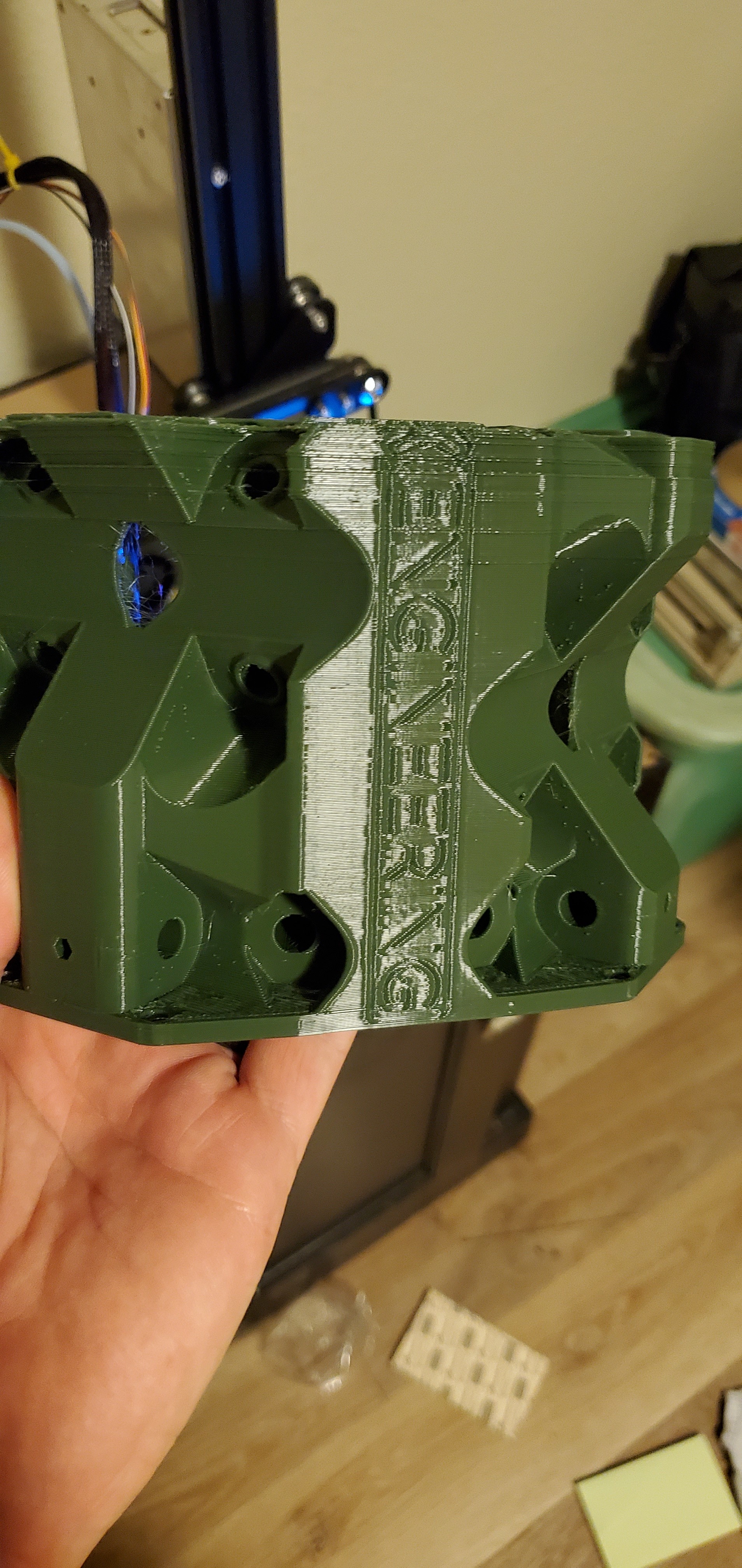

Sorry I think I have the final makita mount printed, but I have not tested it yet. Might not be able to until Sunday. I will post it on all three places when it is ready.

After shipping/tax, I paid $60 for 3 x 8ft tubes from Jegs, so I think that’s a similar price (assuming ‘free’ Prime shipping). The only difference would be in potential waste with only having 4ft stock.

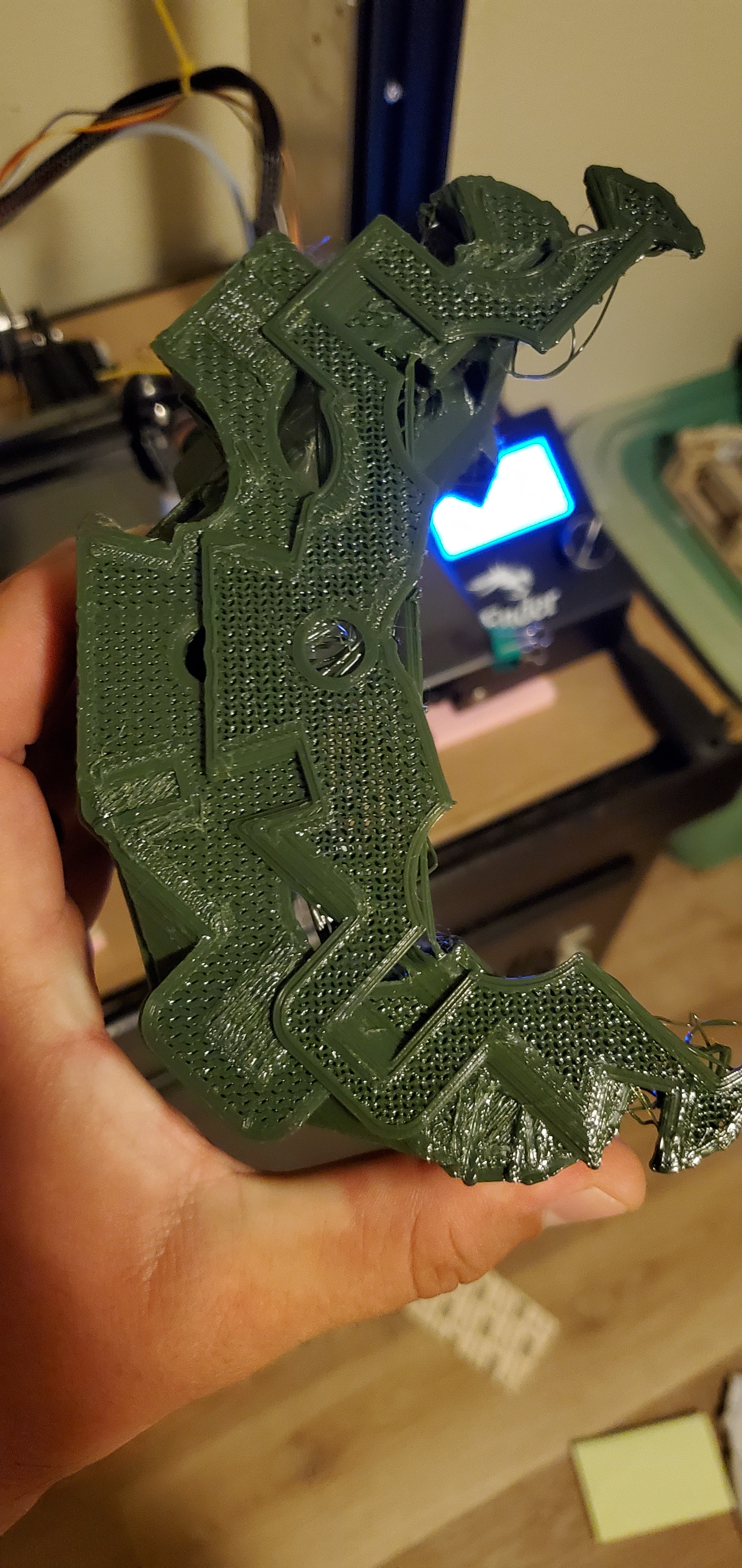

28 hours into the print, here’s to starting again.
Have you received your tubes from metaldepot yet?
Ouch!!
MPCNC Primo
Only for the brave
Dang another 70+% printer failure.
Any ideas for a test part, test the printer and maybe test calibration at the same time? What about a cube with roughly the same dimensions as the core, you can print it with sparse infill and that will test the printers bounds and you can measure diagonals to see if they match?
Be honest would anyone do a test print that large? I could make some tweaks to speed it up but it would still be several hours worth of printing.

What caused that failure?
