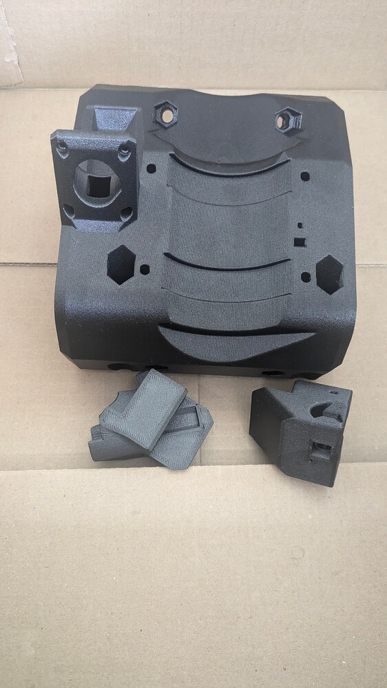

I printed 2 lowrider 4 out pof pet-cf. No failed prints because of adhesion. That thing sticks! Printed with a less than 300usd printer (Flashforge ad5m , with enclosure and . 06 nozzle) i used the sirayatech petcf and the qidi printer profile
Wow those parts really did come out nice!

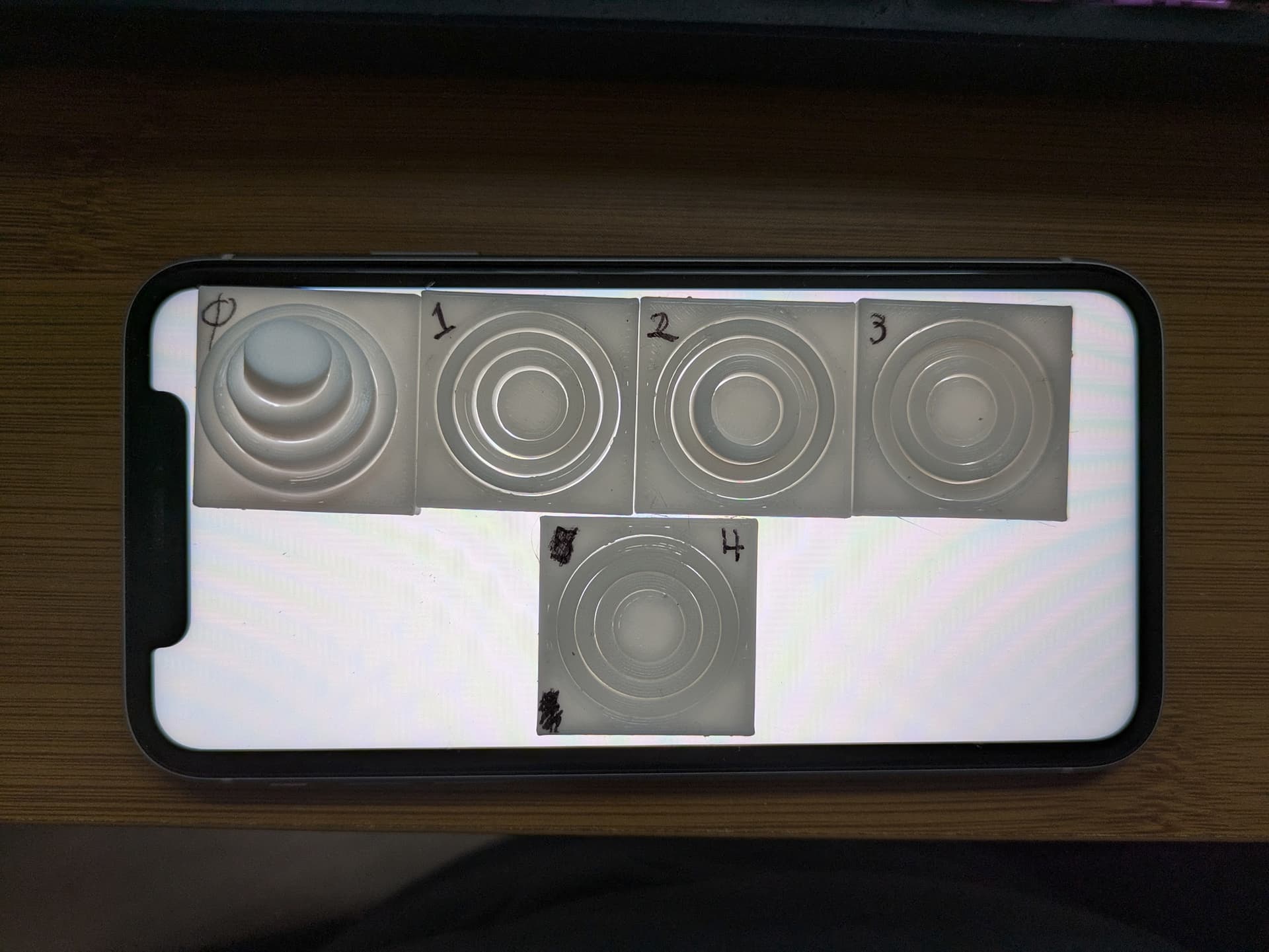

I spent some time yesterday fiddling with the XY compensation and “elephant’s foot” setting on the Ender 3 Pro for a different project. I’ve been using this YouTube video and the spreadsheet linked in the video’s description to calibrate hole compensation, and as I make changes slowly to that setting I’ve also been testing both sides of the fit and adjusting the “elephant’s foot” setting so the parts fit on either side.
HOPING that the tolerances being too tight in the XY plane (various slicers refer to this as “XY compensation” [PrusaSlicer], “Hole horizontal expansion” [Cura], “vertical hole shrinking compensation” [SuperSlicer], and other things entirely amongst many settings [OrcaSlicer]) is not a huge issue for the LR4 build and all of the parts I’ve previously printed.
As I mentioned this is for a different project but as an aside at least for the LR4 it seems possible that @vicious1 might have compensated for this slicer variation by purposefully making the press-fit items like bearings, nuts, rods, etc. all fit in along the Z-axis which is presumably more predictable due to layer height? Maybe there was some other reason for that like strength or stability?
Even if tolerance is an issue for the LR4 prints I’ve already done I’m sure I can just ream or press-fit things like bearings with some pressure. I’ve also been contemplating a switch of slicer to OrcaSlicer for a bit (PrusaSlicer seems to lag behind on some features), and I’ve recently become interested in Klipper because re-compiling Marlin is such a pain.
Here’s an example of the progress I’ve made from the control (default 0.20 mm PrusaSlicer layer height “NORMAL” preset) as number 0 and moving up to number 4 which fits really well. I tried to push it further but didn’t have much luck so this is where I’m leaving it for now.
EDIT: I had drafted this post throughout yesterday but am actually reconsidering my approach for calibration. I just discovered this amazing (and open source!) website Teaching Tech 3D Printer Calibration and I think I’ll probably go through it step-by-step after migrating to Klipper (I’m so over re-compiling Marlin).
You really should not need to do that. chances are really good it will make things worse.
I design the parts so there is very minimal stack up error. The most import thing to actually check for is skew in all three axes. Some printers are far from square, a couple are spot on.
Right on thanks Ryan. I’ve been printing all of the LR4 parts with stock profiles so no worries, glad to hear it’s not a problem for the parts I’ve already printed! I checked for skew per the dogs so should be good I think.

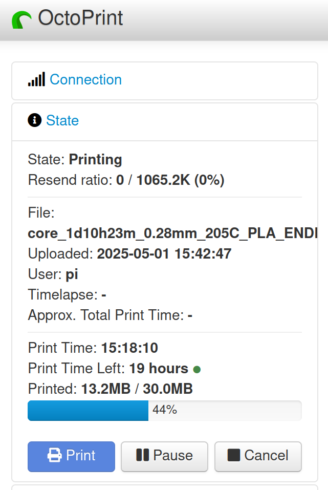

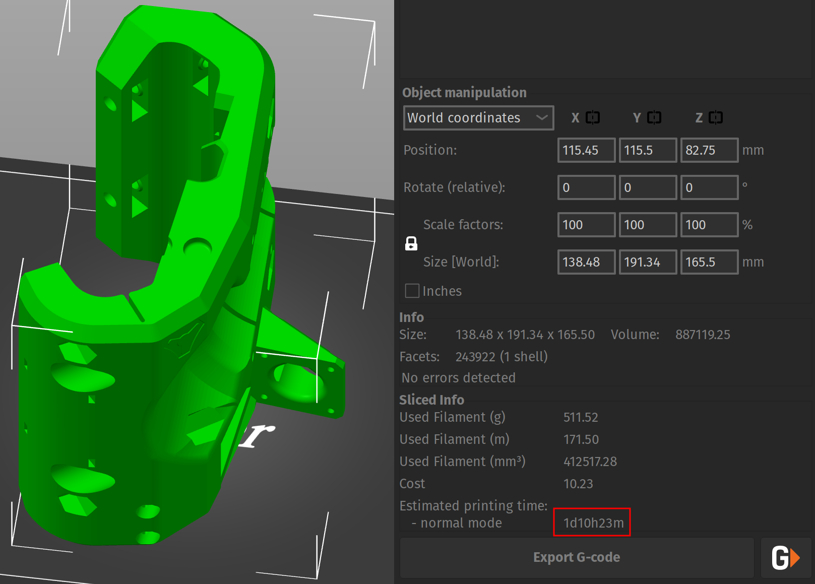

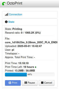

OK, I’ve been kind of putting off printing the core but I’m running out of other stuff to print. That said a lot of the kinks have been worked out of my printer in the meantime so I feel pretty confident, though very occasionally it has locked up on me. I now have one of those resume plugins installed in Octoprint JIC. Here we go!
I print them in 8hrs on a V5…you should make sure you are doing thick layers to speed that up. I would think most printers could knock that out in under 15 hrs.
I think the estimates are probably off? I’ve honestly not monitored much to see how accurate they are, but I’ll take notes this time. As for layer height I’m doing 0.28 mm layers (SUPERDRAFT preset for an Ender-3 Pro in PrusaSlicer profiles) with a 0.4 nozzle so it’s about to the ratio in the docs (something like 3:4)
So far so good on the core print. The estimates on print time were off it seems, but not by a ton. Octoprint typically has a pretty good handle on how long things will take once the estimated time indicator flips to :green_circle:. But no news is good news otherwise!
