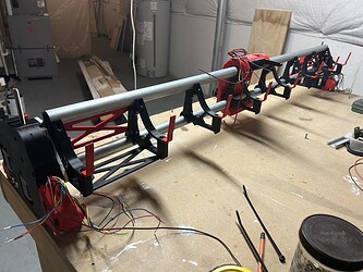

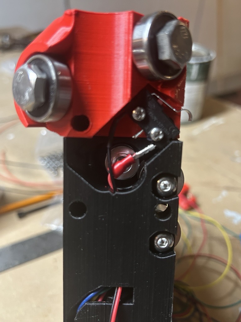

Starting to make progress now that I have all the tools and parts to connect end stops. I will freely admit that the wiring is my least favorite part of this build, but I’ve been pushing myself not to give up.
Question: Why is there only 1 end stop on the Core even though there is room for 2? Is it because if probably “homed” it shouldn’t go past that point?
If you are looking from the front, you connect the left one, it’s also explicitly stated in the instructions. The other one is for advanced users who want to customise the homing routine.

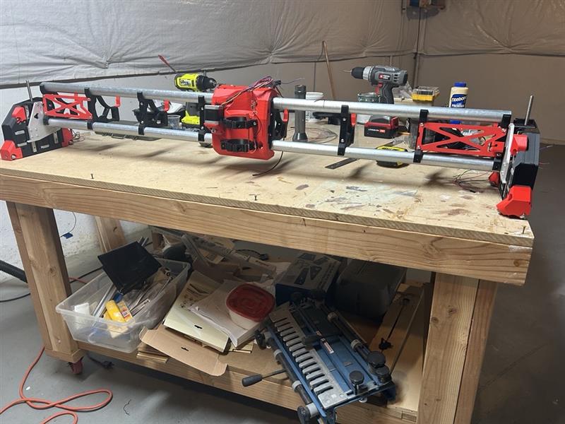

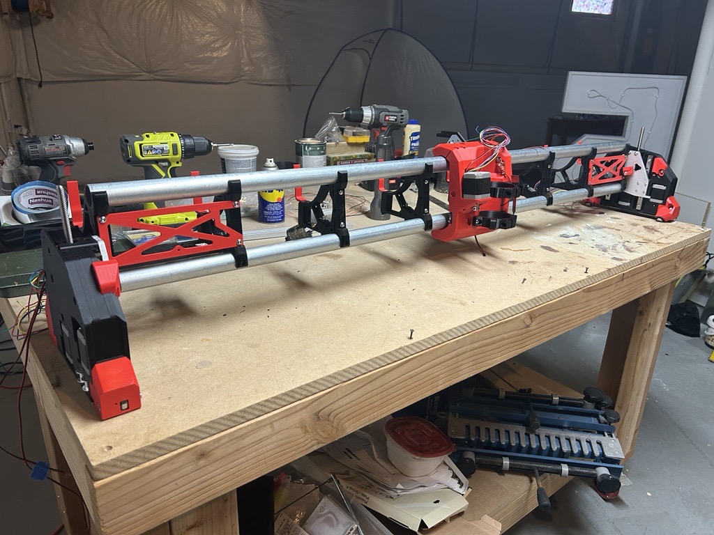

Machanicals are complete. Now I need to start wiring everything up to the Jackpot controller.

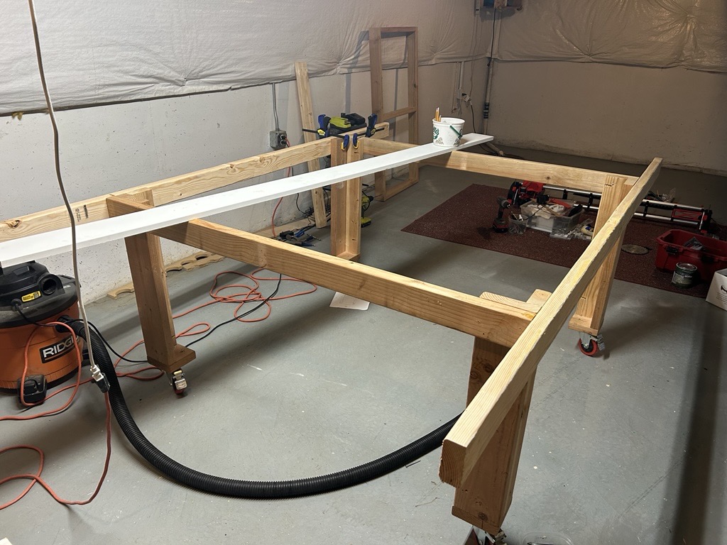

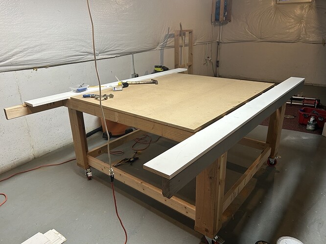

After a little hiatus filled with family vacations, home repairs, and kids events, I got back to work on my LR 4. I deconstructed (you can see pieces of it in the background) my old work table and turned it into a CNC table. This is my progress so far. It is made of premium douglas fur as it was fairly straight and in expensive (comparative speaking). I’m going to use a piece of 1x PCV board I had left over for the XY min side as I think it will provide better wear than MDF….If you have used PCV board and got different results, please let me know.

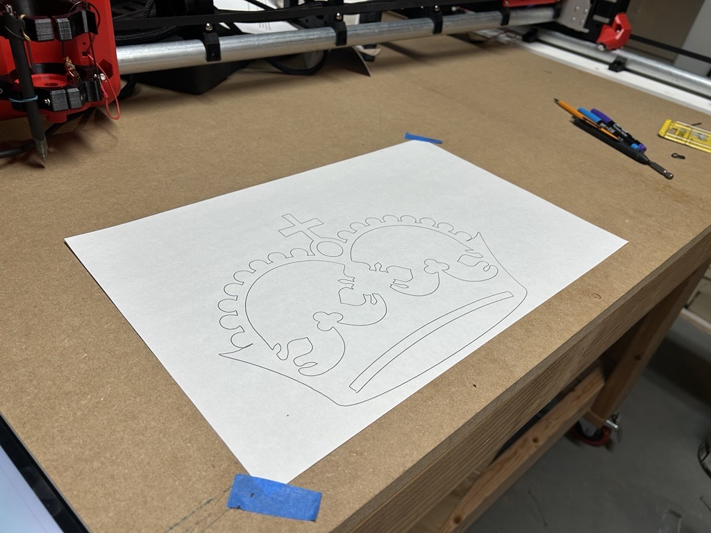

Ok..spent the last day or two reading and using Ryan’s probe g-code which a found in one of the forums. After all said and done, I finally got the obligatory crown plotted with a pen!

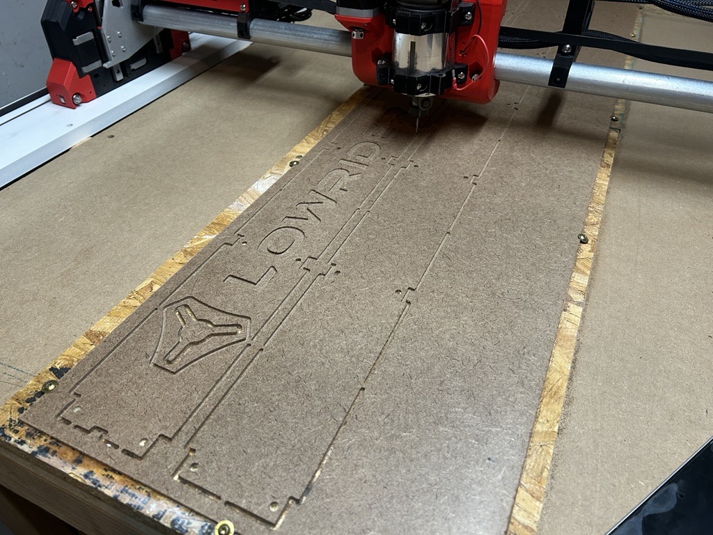

Last weekend I went out to Home Depot and bought a full sheet of hardboard figuring that a full sheet would give me opportunity for practice. The first cut wasn’t bad except the bit blew out of the router (fortunately it didn’t break) which I suspect was due to the collet being new and I was trying to cut to much at once. I re-adjusted my program and ended up with the following.
This is just a test piece. I have another piece of hardboard painted black which I hope to mask off the Lowrider logo so I can paint in a different color. Any advice for a good masking material? Painters tape? Packing tape? something else?
