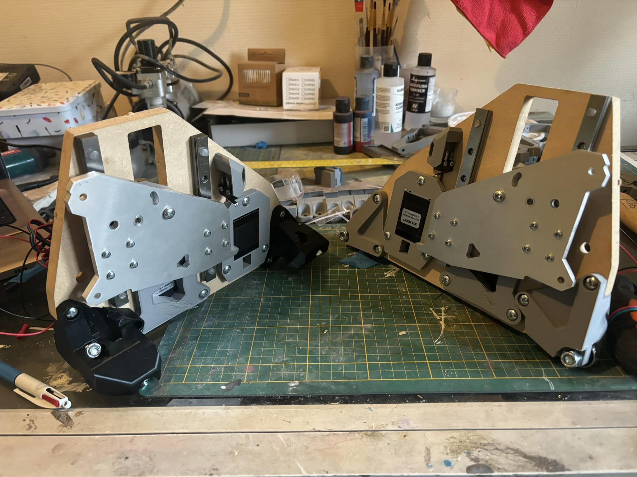

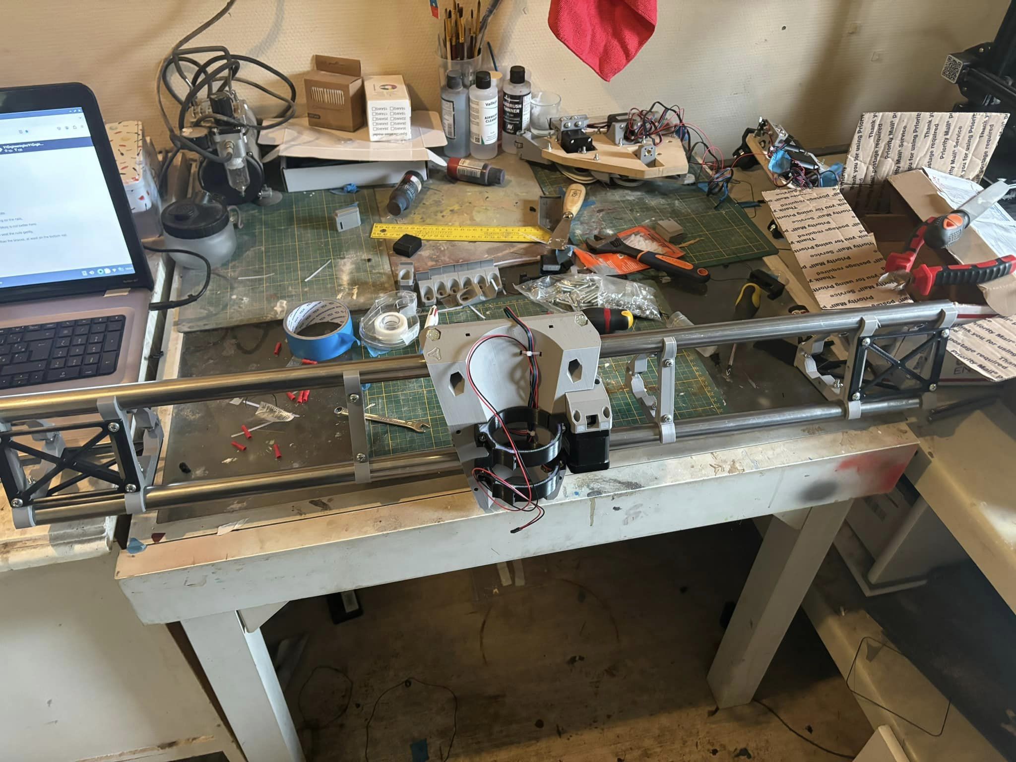

My name is Yves and I’m from France. It’s been a while since I wanted to start building a CNC, my choice fell on the lowrider V3 with a machinable surface of 160cm x 80cm.
For the moment, I’m having no trouble assembling it, the documentation is well done, but I wouldn’t hesitate to ask for your help.

the crown is done, I’m waiting to receive the end mills.
