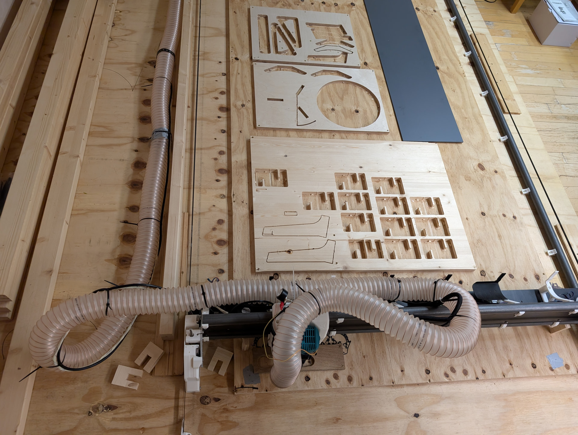

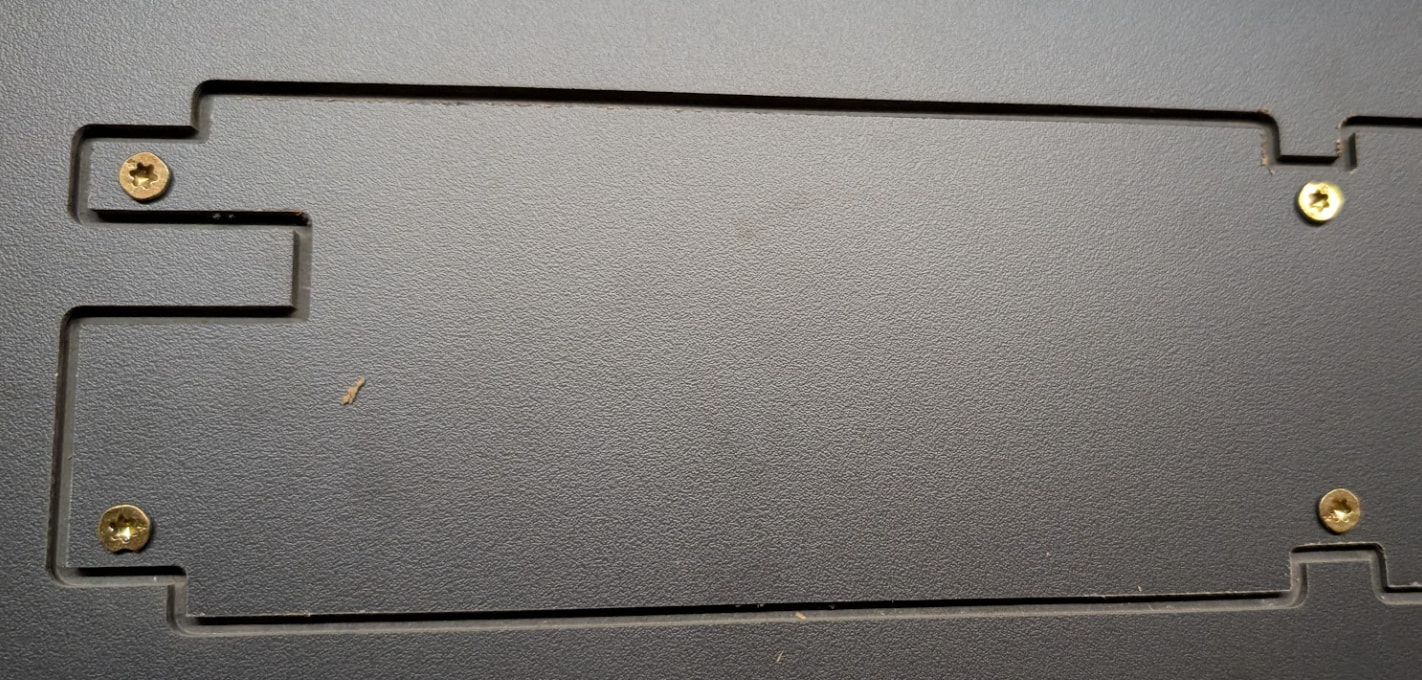

I built a Lowrider over the past few months and did already a few cuts. I have no table yet and still sort out a few things but the results are already pretty solid if I don’t cut to aggressive.
After lurking around here for almost a year I wanted to join the community and share some feedback and ask some questions.
So the machine is currently on top of 3 C-grade plywood sheets with another one as spoil board.
I wanted to cut the frame for the torsion box table out of that but I think I’ll get a MDF one and use two of the other sheets as top and bottom plates. On the left you can see some beams I want to use for the legs.
If you look close you can already see some spots where things got wrong. But I managed to build the plant stool and laptop stand from ZenziWerken with an OK quality. Also I did a lot of test cuts to get a better understanding of the machine. These are the test parts from @franklyrosalind torsion box table generator which I want to use for the table later.
I started planning the build around November last year, the general key attributes are:
  • Full sheet (2500mm x 1250mm)
  • Jackpot 1 controller
  • Makita clone router
  • Self-sourced, Alu plates from @Tokoloshe :waving_hand:
  • My brother-in-law printed the 3D parts for me, most is PLA except for the braces on the router and I think the jackpot box, these are made of some carbon reinforced stuff
  • vac with cyclone separator (this works insanely well)

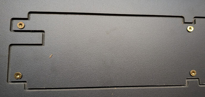

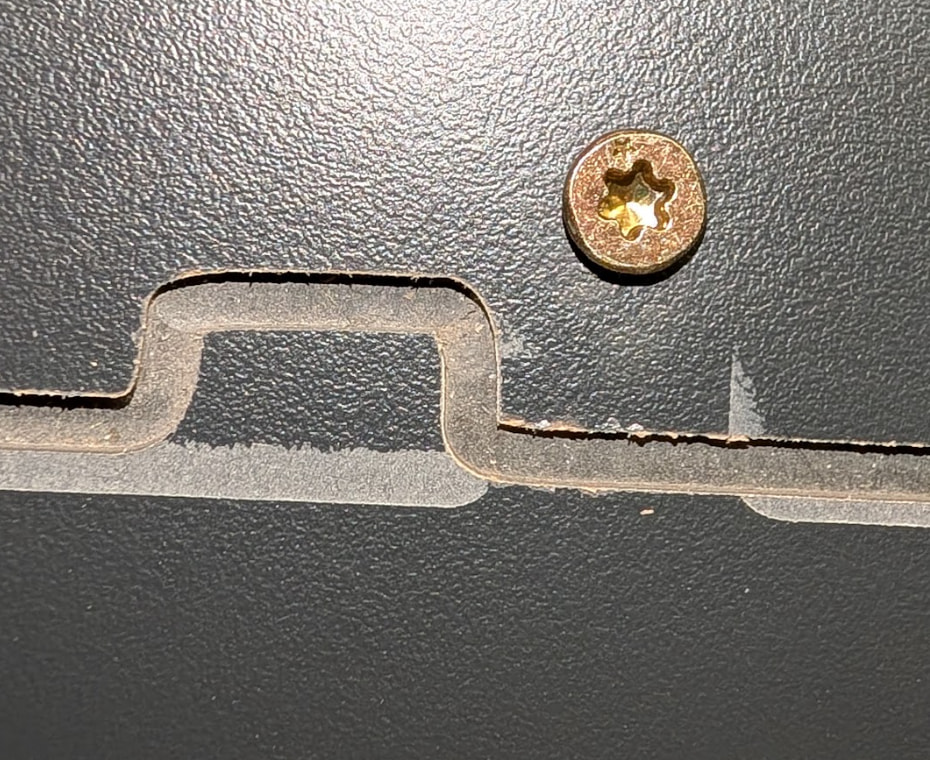

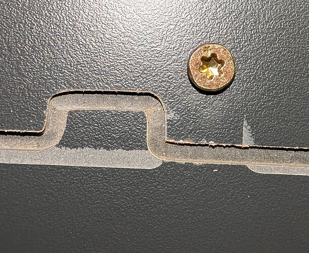

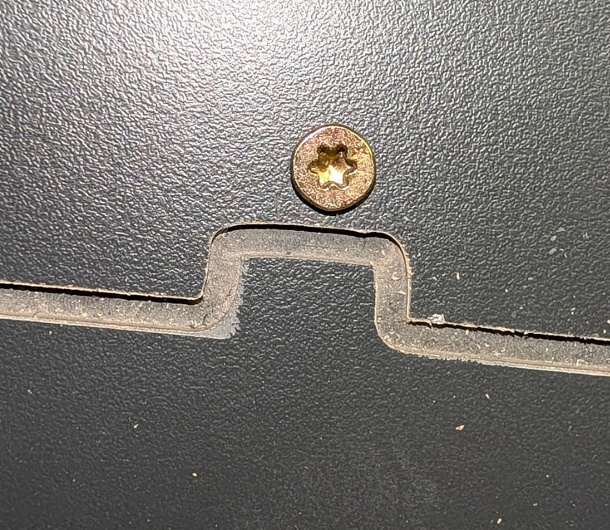

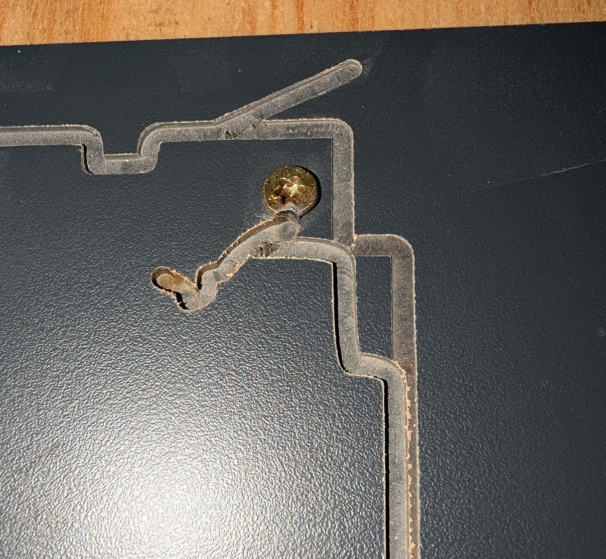

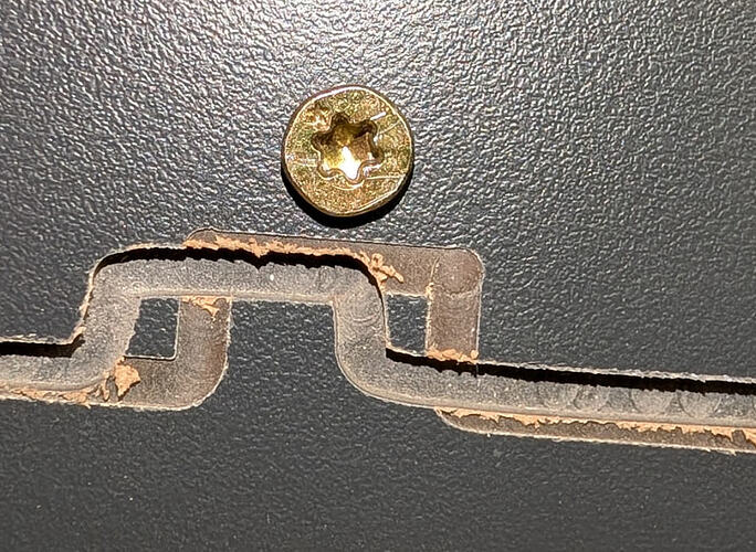

  • without strut plates it was a mess. My strut plates are right now 4mm phenolic plywood (idk if thats the right translation, we say Siebdruckplatte in german) when I cut them the DoC was partially deeper because the surface is everything but flat and the force was so big that the whole XY plates would just get pulled to the center a few mm until the x-belt tension would get to low. On the other hand the Y trigger on Y0 would just drive past the screw instead of triggering. with the struc plates the gantry has the correct width now. But the strut plates are still pretty flexible so I bought a plate of 6mm HPL for new ones (the black plate in the picture)
