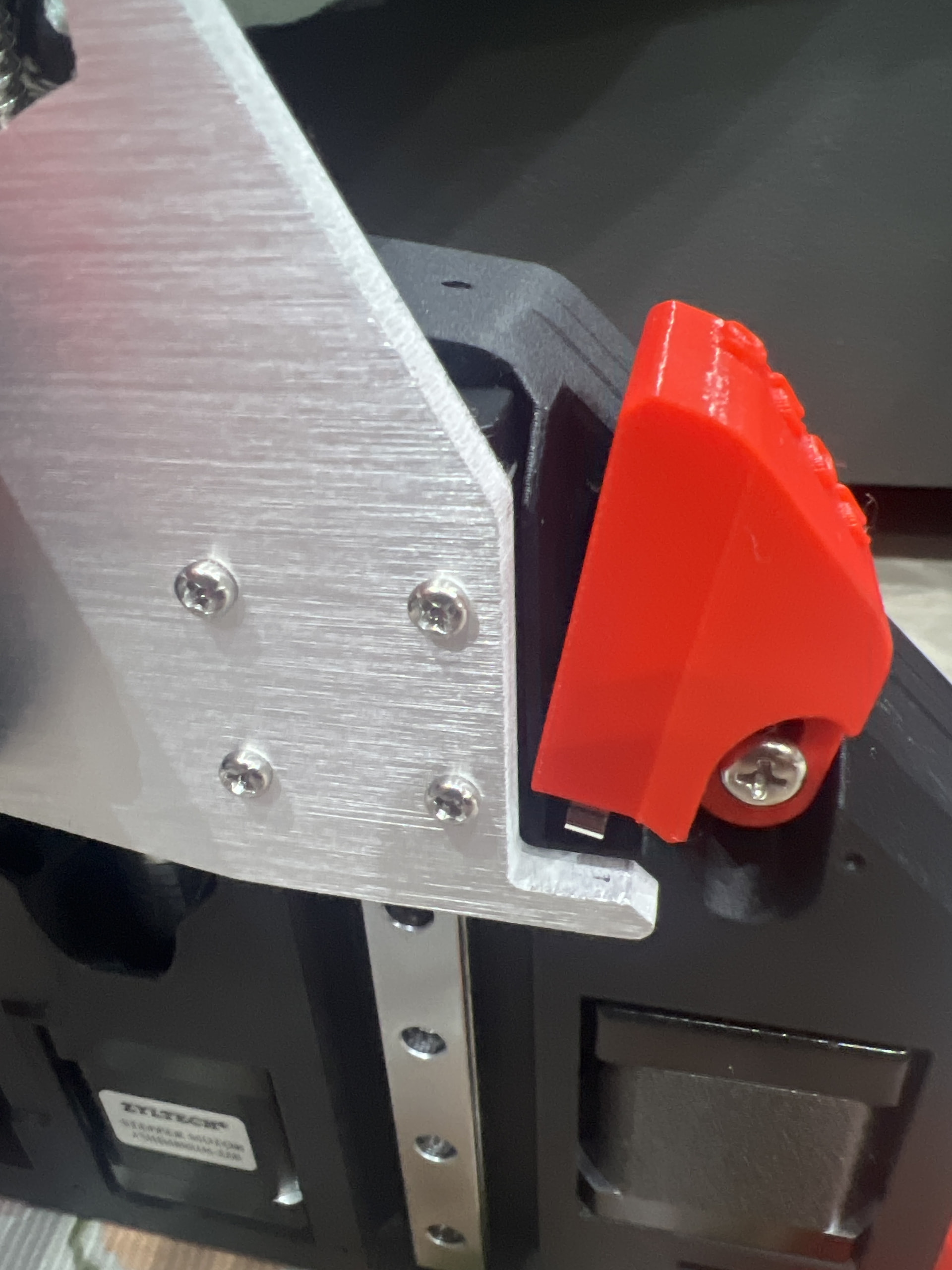

I have noticed, however, Z+ moves down, and Z- moves up - is this correct?? Or have I missed something?

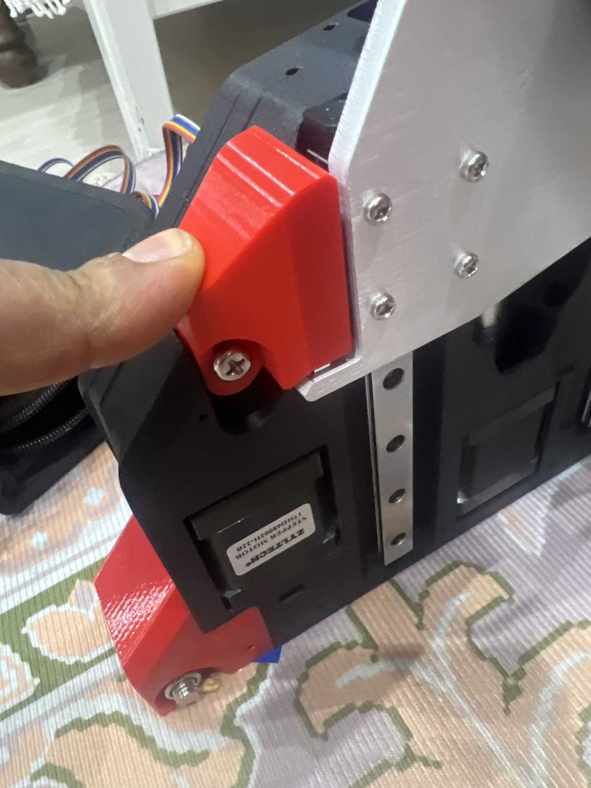

Also, because I dont have the y-axis pipe yet setup, the Z-homing Limit blocks on both sides seem to rotate slightly when I raise the Z up (by hitting Z (10 o 50) button accidentally. Is this also normal for the blocks to rotate- although I have them tightened.

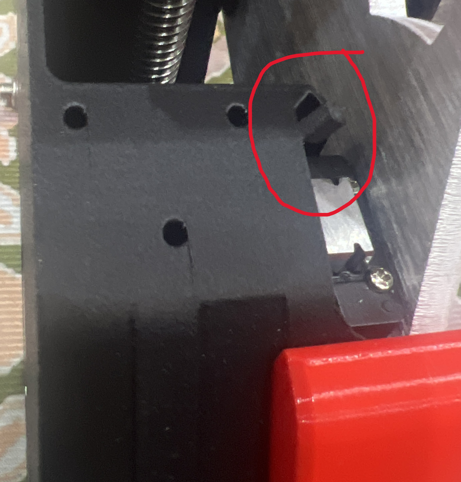

Both these z-limit blocks seem to go out of alignment once the limit switch is hit.
the small tab broke off.
no that’s incorrect. reverse z stepper wires.
i haven’t had any issues and mine broke off long ago.

The z-Homing still does not work. It goes beyond the limit switches. like what I mentioned, as a result the limit blocks go out of alignment.
Snug the screws up. You probably didn’t pull the nuts through completely.
They are as snug as they can be. Shouldn’t the z-limit switches stop the Z movement?
Oh yes, sorry, that’s the problem. This happens, for instance, if you swapped Y/Z or something like that regarding the endstops. Check that you really have them correctly mapped.

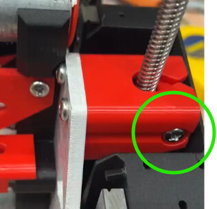

The two pipe for the X-Axis were not aligned correctly, as was the z-limit that get knocked out of its position.
Sound like it’s binding up. Remove the cross tensioner screws in the Z-stubs - they are not required and can cause binding problems
