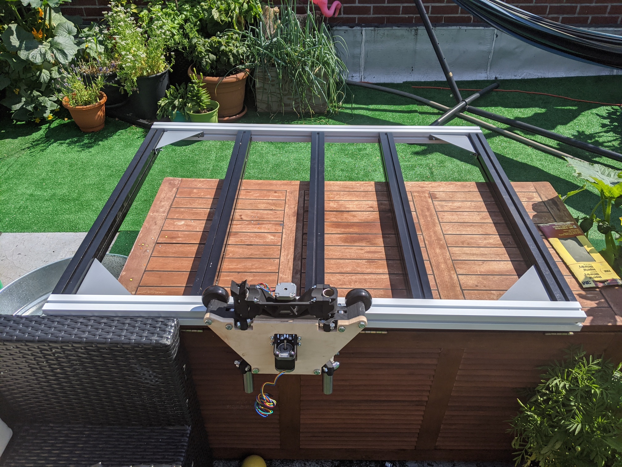

Hey everyone, I just thought I would post some pictures of lowrider build at the current state and maybe use this post for any questions I maybe have…I’m using this AGAM extruded aluminum for my frame.

Here are some updated photos of the frame/table setup. Think it might be rigid enough? This table size gives me a usable area of 28x33.
Here’s an update on my build! At this point I just need a case for the electronics and a spoilboard and I’ll be cutting!

Nicely built, could you post details on the clamping at the table, please?

Àlex, I used these saddle brackets I found on thingiverse from another lowrider user. I did have to modify them to work with my extrusions
That just gave me a cool idea on how to keep my top table in place…thanks for sharing it.
