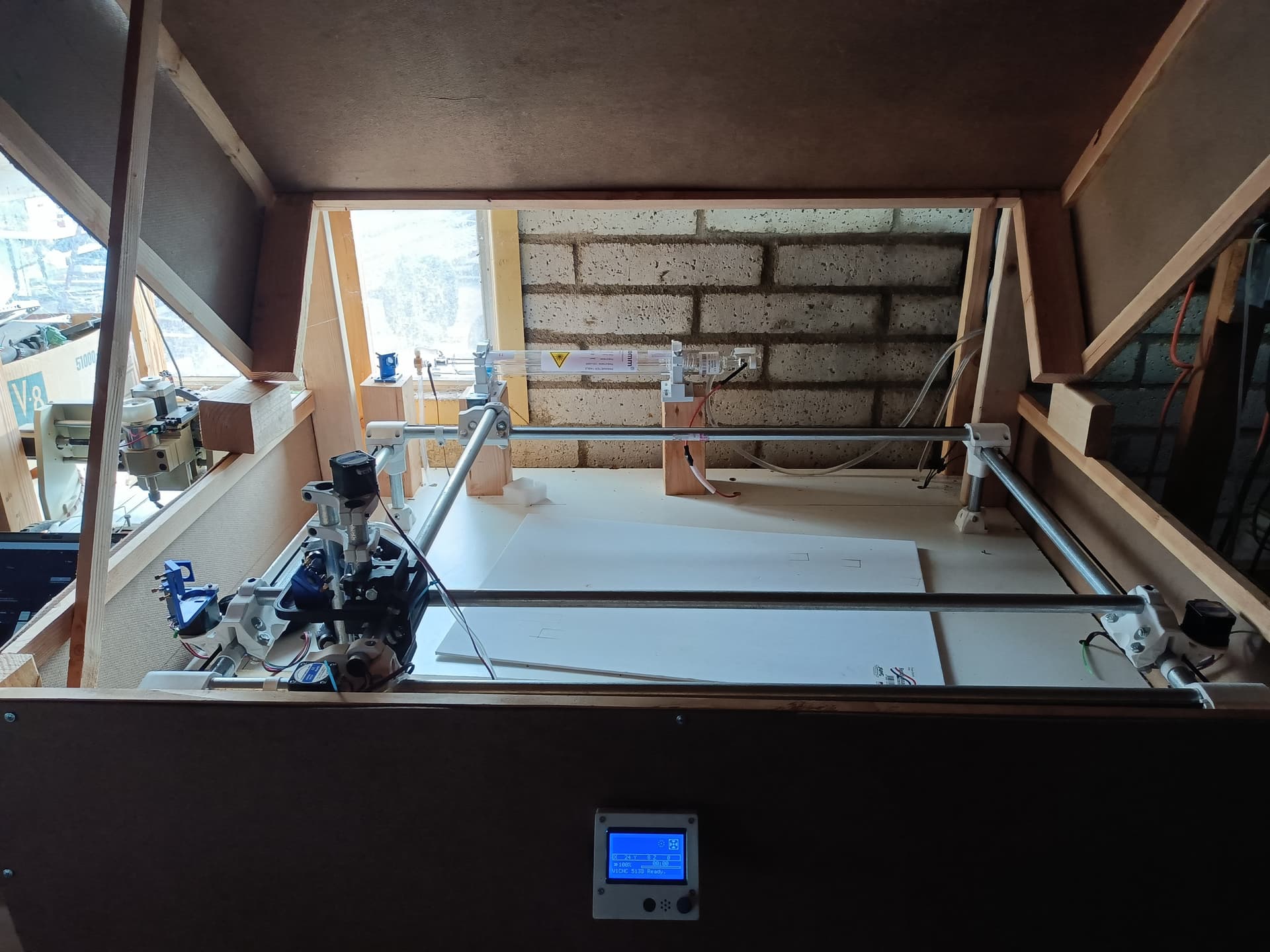

Spent the last few months building myself a laser cutter. I wanted a large format laser (20x30 inch) for making model aircraft. I know it would have been easier to just buy one but it was an interesting challenge to build myself.
Just made my first test cuts and clearly still need
make some adjustments to the firmware. But it’s finally working almost. Would include photos but my account is new :confused:

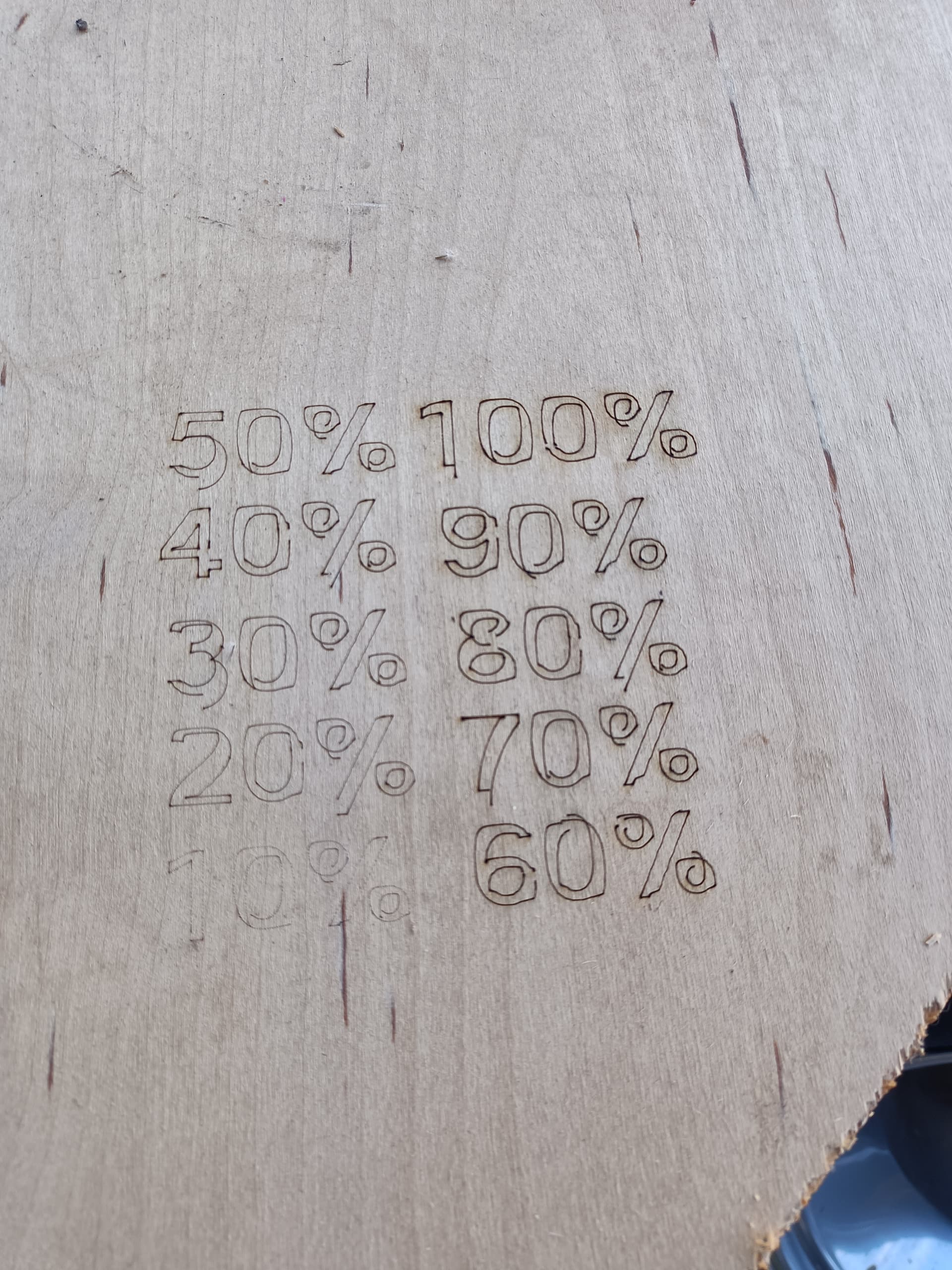

First cut results, don’t know what is off but it’s exciting to make some progress. :slight_smile:
That looks like backlash. Probably a loose grub screw on one of your motor shafts. Or maybe one of your motors isn’t working at all, and the axis is being driven by only one motor.
This test pattern generator by Jamie draws a ruler in each direction to measure backlash. IDK if it can be used with a laser though:
https://vector76.github.io/gcode_tpgen/
I’ll keep my safety monkey comments to myself as it seems the OP knows the risks, and other monkeys have spoken up already. I will say though, that this safety monkey has less luck than the average monkey in general. So would not attempt this myself as it would guarantee loss of vision in my case.

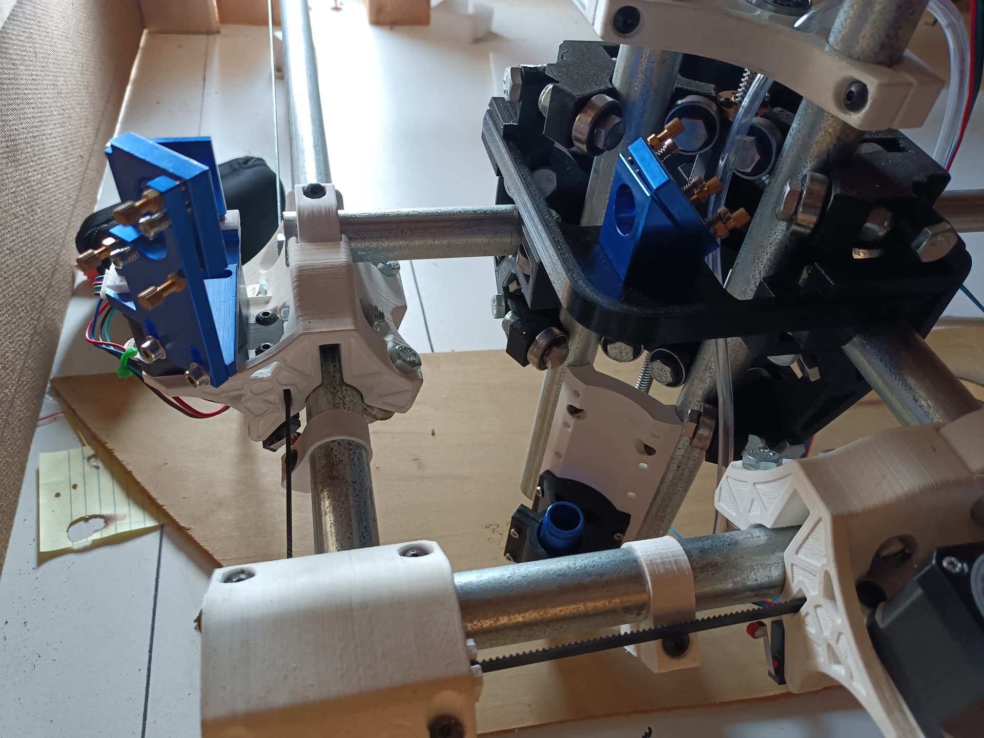

That said, those are some wonky looking letters for sure. It does look like some backlash at play, but looking at it I have a feeling it’s not going to be that simple. When I mentally visualize all of the flexing that happens throughout the frame as it moves, and how that may affect alignment of mirrors… I’m thinking there’s going to also be more complex interaction with mirror alignment at play here. For example, we know the gantry generally will take a saddle shape, dipping in the middle. That will make the first moving mirror rotate about the x axis… and the second moving mirror will have that rotation, plus a rotation component on the y axis as well. The angle change isn’t much, but the laser path isn’t that short either… build up of small angle errors could end up looking like that. Compensating for these slight unplanned changes in mirror angle I have a feeling may become a big problem here, especially riding on rough conduit. I think this is why most co2 gantry’s tend to be very lightweight… less mass to bend the gantry, and less momentum to get things swaying when they accelerate.
Could that sagging be removed by replacing that huge core with a simple plate gantry? All it has to hold is the 90 degree mirror block and lens assembly. That just weigh much less than the regular router in there

My vote as well, super cool to see though. Those mirrors are insanely hard to get ideal What I did not understand when I started with a big laser is the beam is the size of your mirror, not a tiny spot. So any misalignment early on drastically cuts your output power put also compounds the positional error several times over as it hits each mirror.
