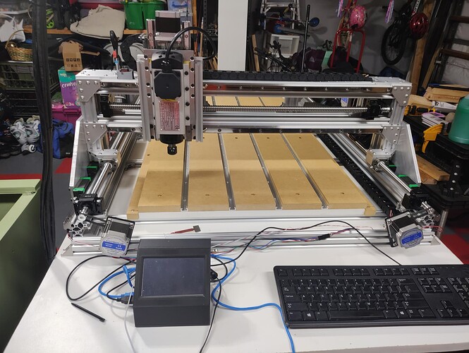

getting super close. X and Z endstops are in and working wonderfully. I installed the Y stops but the design was half baked. I need more adjustability.
My frame isnt square. I know this, and basically came to the conclusion that it doesn’t matter. As long as the Y rails are parallel to eachother, and a consistent height off the table, I should be good. Both of those criteria have pretty much been met, to the extent I am able to measure.
However this became a problem when locating the Y endstops at the end of the C-beams. The out-of-square frame meant that one endstop needed to be just a bit further from the end of the C-beam than the other. So one was triggering, then the gantry bound up before the other one triggered.
I tried to put the endstops at the end of the beam to not steal any travel from the Y. Instead I will give up about an inch or so and mount them to the outside of the c-beam, so I can move them along the extrusion and dial in the position to keep the gantry square. Hopefully tonight. I am so close to chips its driving me nuts, lol.
After a real dunce moment with my limit switches swapped to the opposite Y motors, I got homing all sorted out.
I can FINALLY build the bed and do some testing/tuning this weekend!

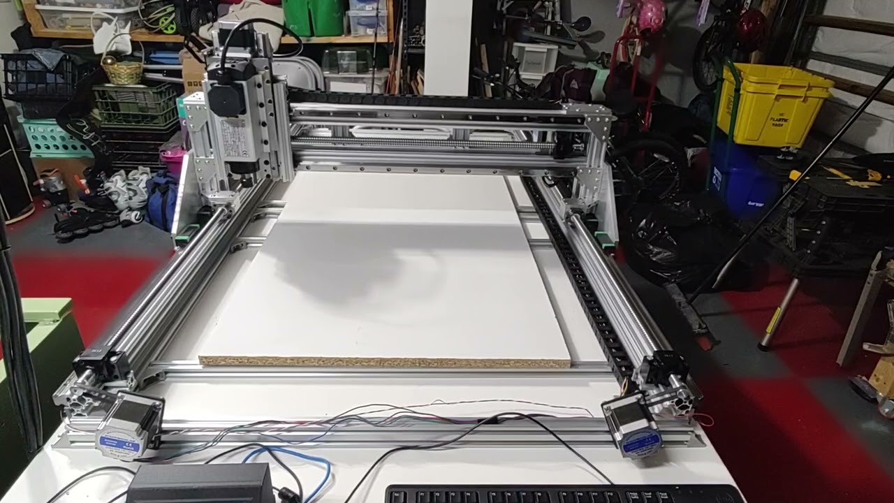

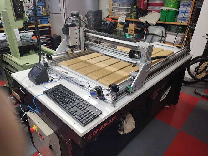

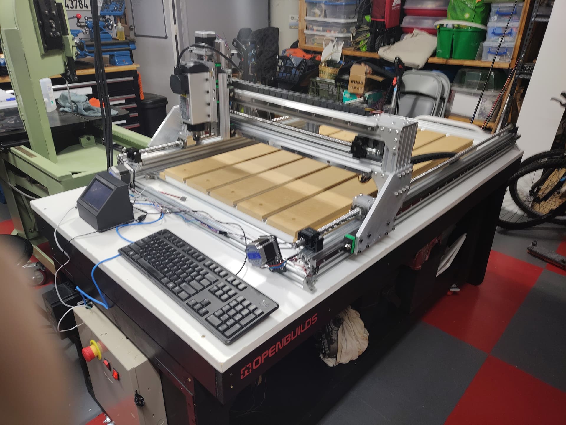

It’s “done”! Of course the quotes are because I still need to figure out dust collection and enclosure…but the machine in terms of what I would have received in a turnkey system is basically complete. The final price tag to this point is $1,715.99. this does not include the table/bench or any little bits and bobs I had on hand (limit switches, wire, the electronics enclosure I salvaged from an old alarm system.)
Of course I also need to do testing and alignment. I didn’t include a system for tramming, it’s all shims and a few taps with a rubber mallet. I might add that later as well.
I tried to draw some squares but I need a proper, spring loaded pen mount. I ruined a sharpie by ramming it into the table already. Hoping to get to all that this week and into the weekend. (Perhaps some more cable management too)

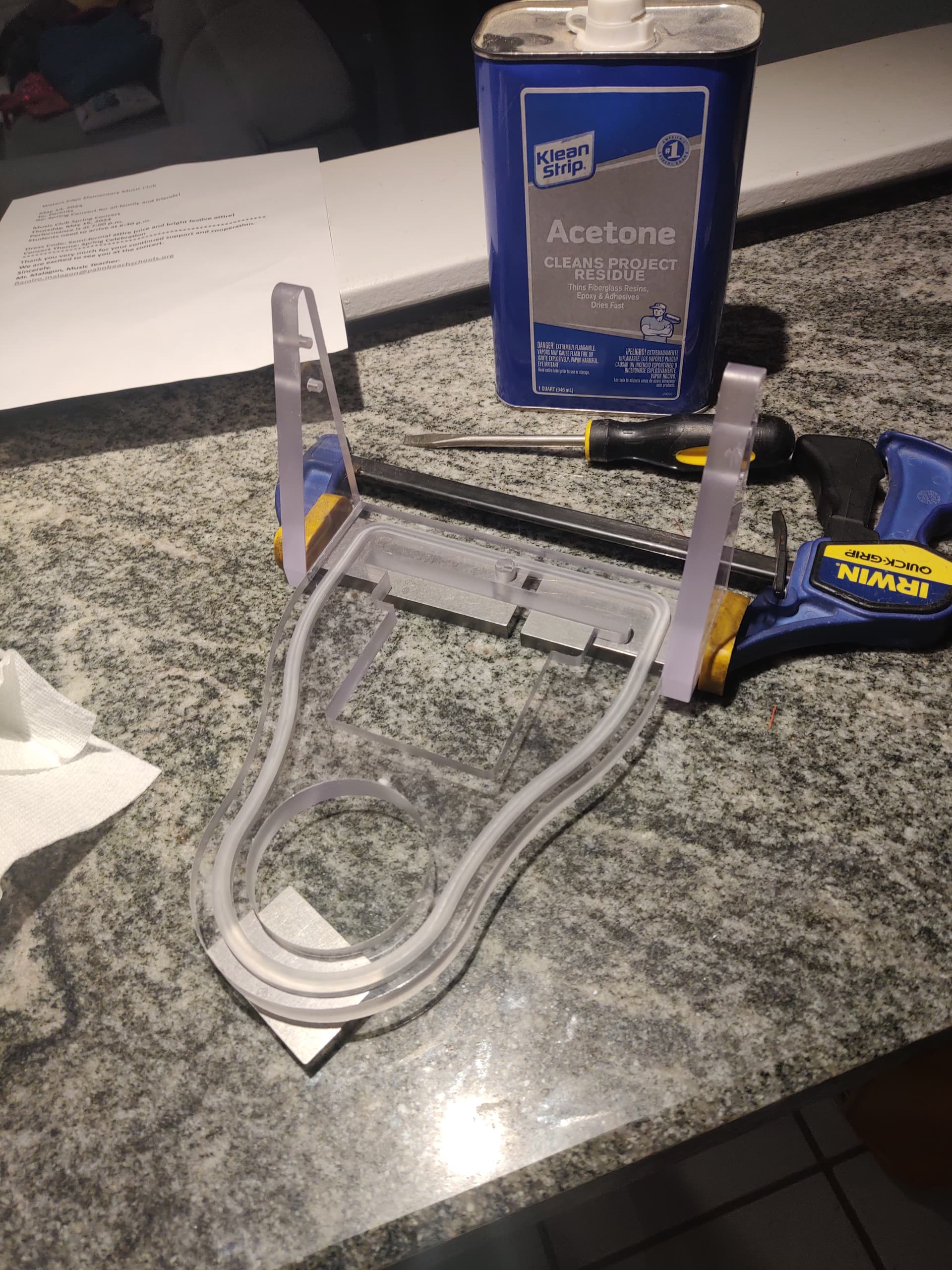

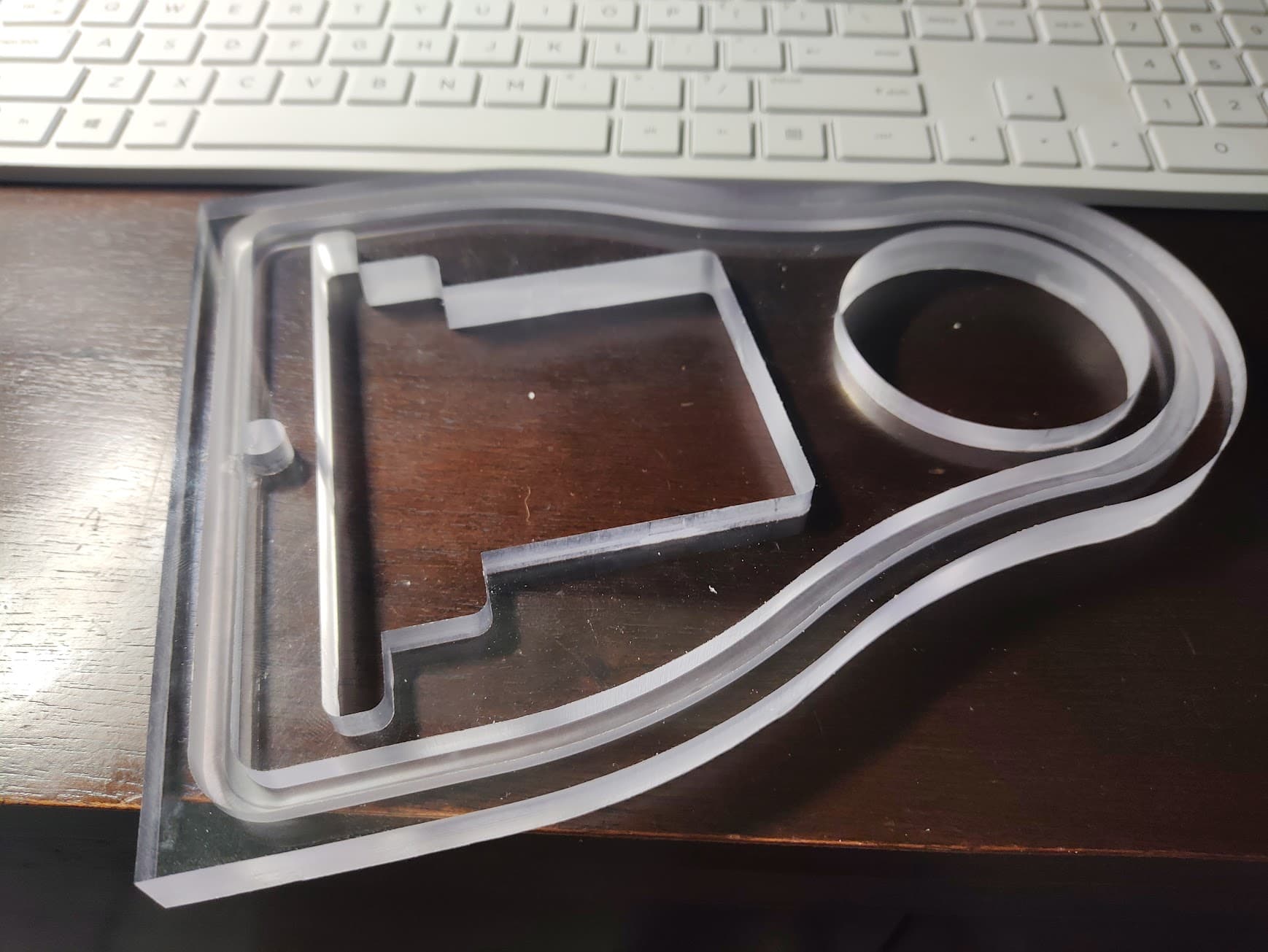

Ok, after banging my head against the wall last weekend and fixing my pin assignment oopsie, its time to finally make some stuff. Starting with a dust boot. Did it in wood first for test fits:
Final piece in acrylic/polycarb:

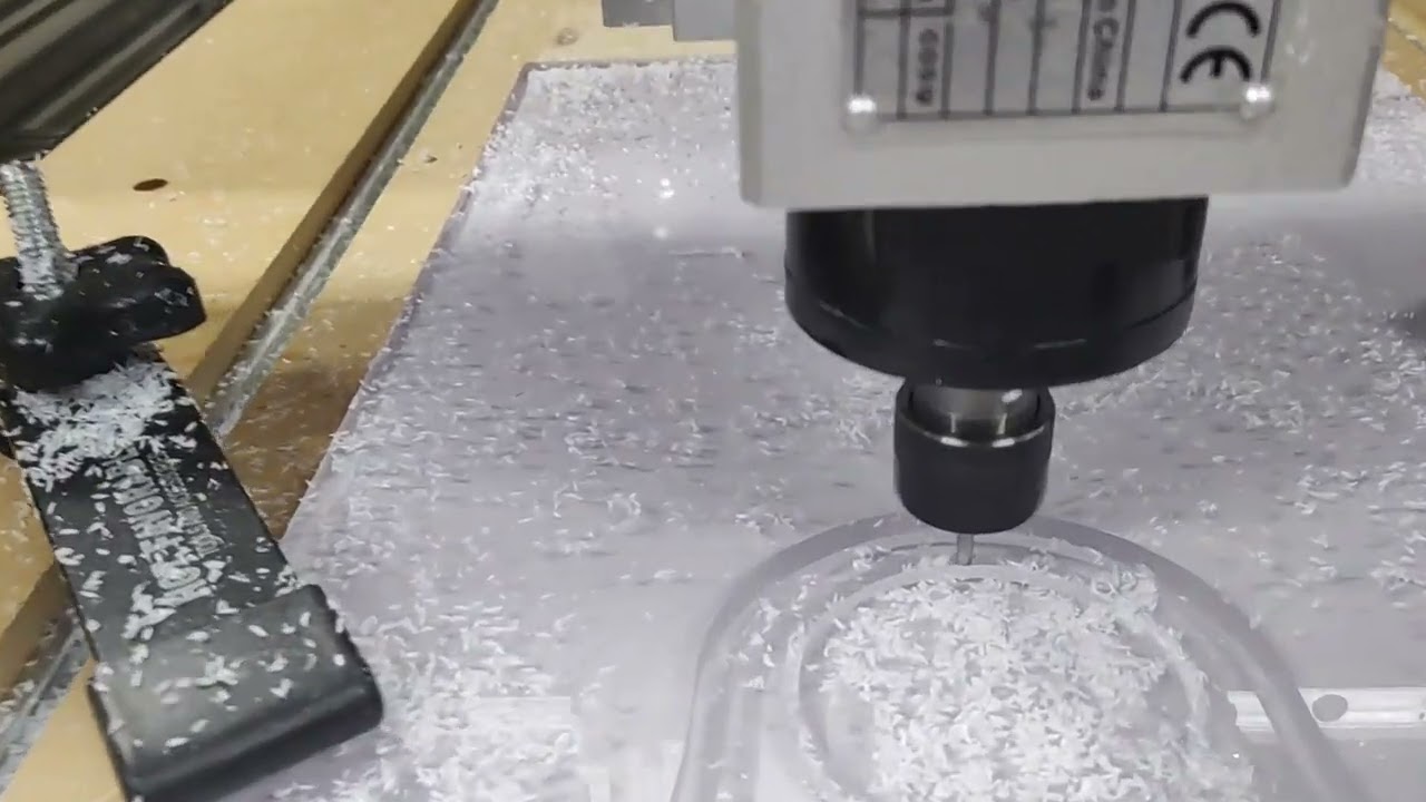

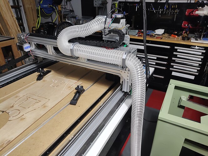

Running a 1/8" single flute at 350SFM, 14IPM, and 1/16" ADOC. The cut is noisy, but the surface finish is outstanding so far. The chips are perfect with no re-weld. I think the noise has more to do with my table and the fact that I am using thin ply under the workpiece to preserve the spoilboard (yes, I know this is dumb.) I could probably push the speeds more, but the cuts look good, even if they don’t sound great.
Looking forward to checking the accuracy once the part is off.
Aluminum is next…

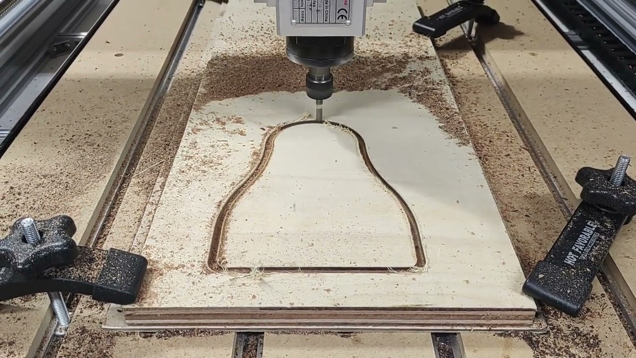

officially the 1st part off the new rig:
Those edges look pristine. Wow. :star_struck:
And I’m getting about -.005 dimensionally. I can work with that. It seems to be uniform too, so I if I can just offset the error then I’m a happy boy.

Dust boot is solvent welded and drying:
The uprights were nearly perfectly to size. I sped up the rpm and feed a little bit, and things went smooth. Still a lot of vibration. I am a little worried how the vibes will affect metal cutting, but we’ll see.
So I’m happy. The biggest issue was accuracy and so far so good. I probably could have fixed or built a new mpcnc that performed better, but I don’t have any regrets about this path. I’m under $2k and otherwise where I want to be performance wise.

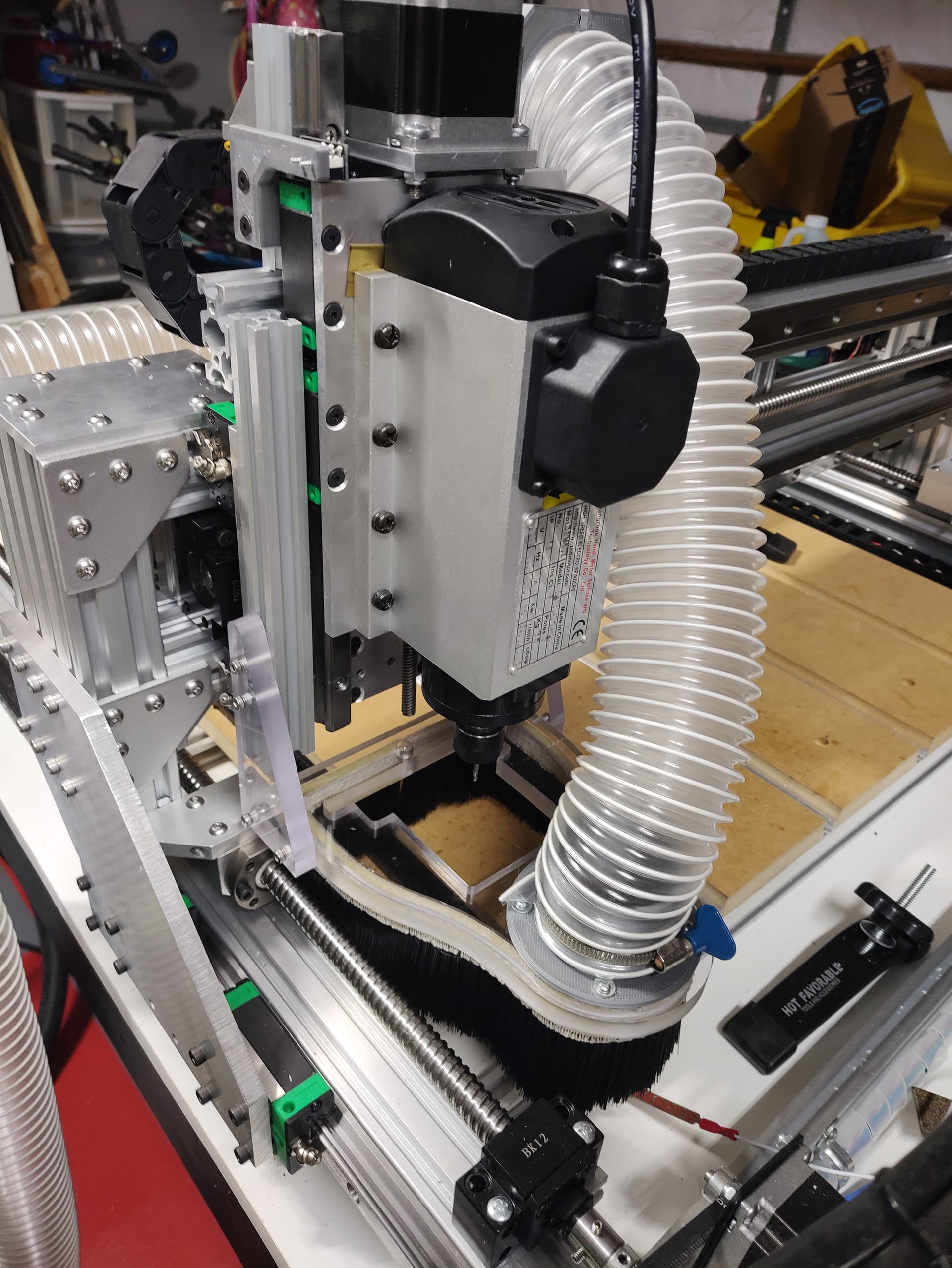

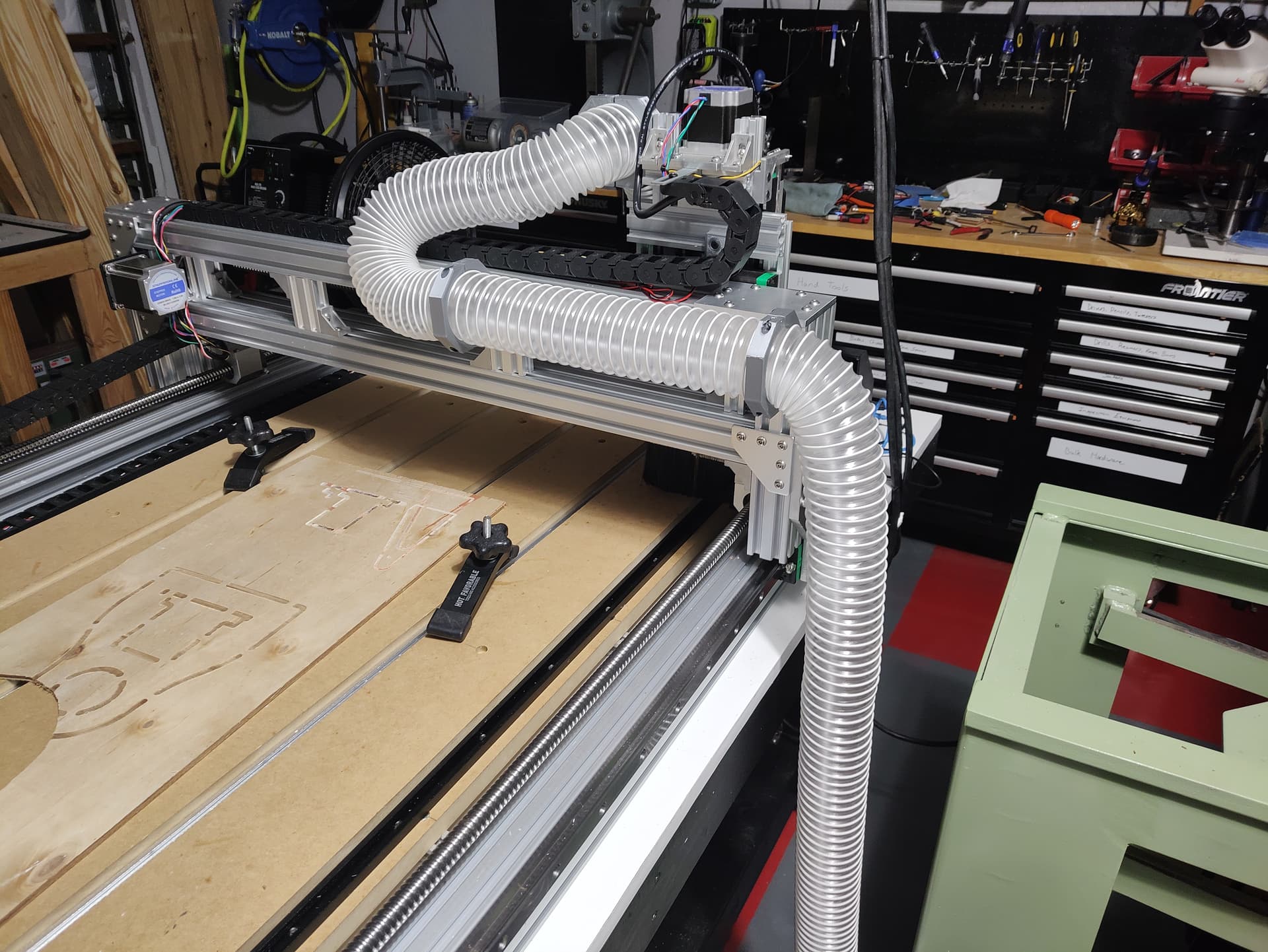

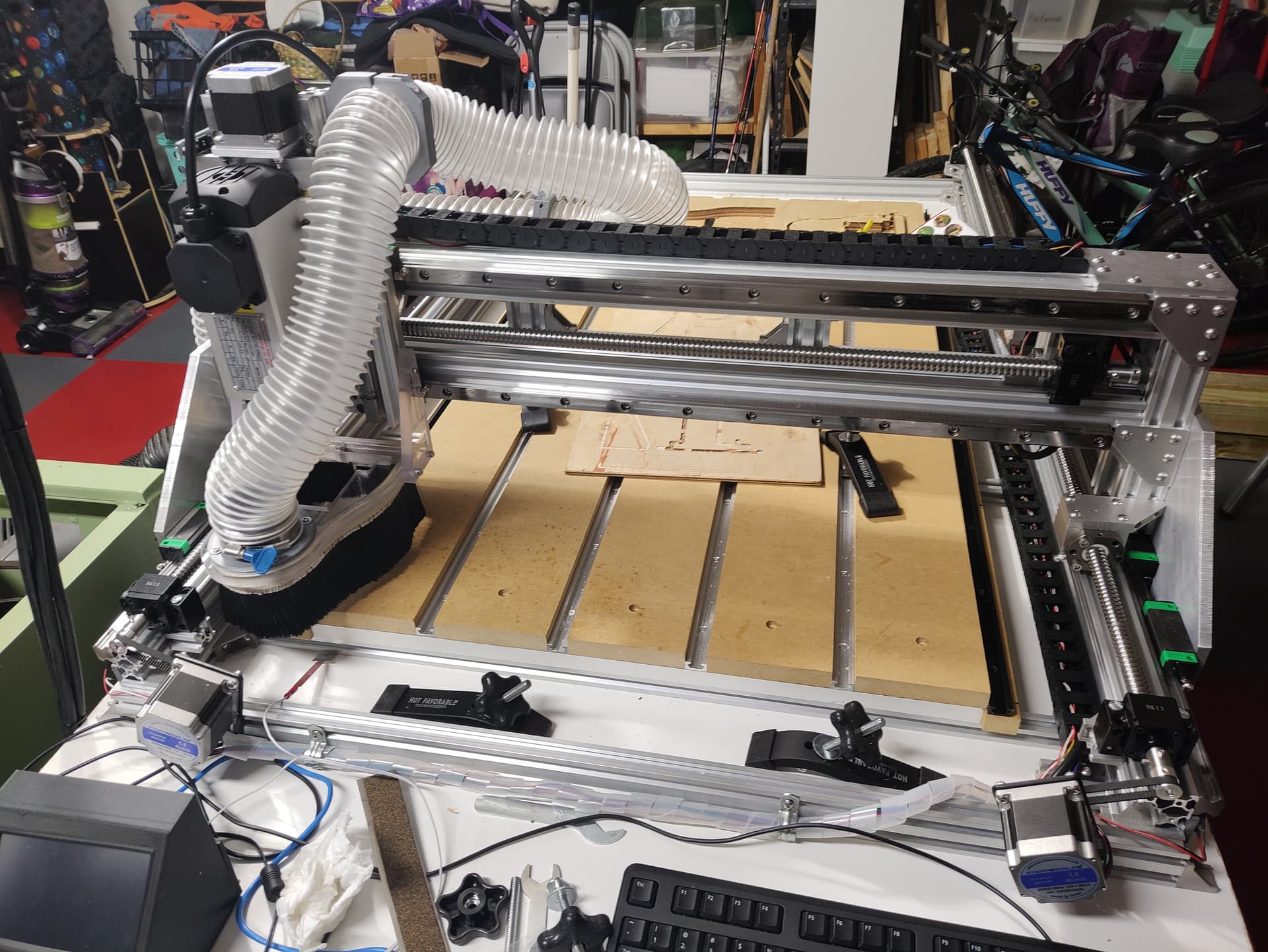

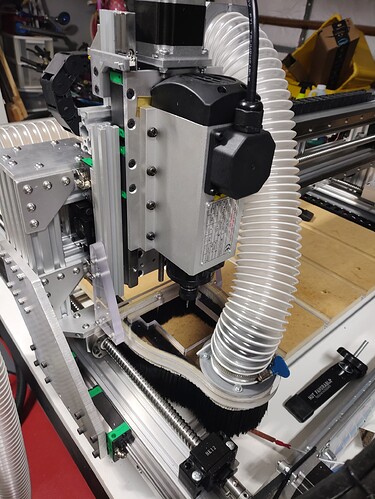

Dust boot finished and installed. I love the way The boot itself came out, but I have to admit it is a little bulky. It’s adjustable in height but I discovered that if I have it at its lowest setting where the brush is just touching to spoil board then I will have a collision when homing X between the acrylic bracket and one of the ball nut housings.
Now most of the time I’ll be cutting material that is thick enough that the brush at its lowest non colliding setting will touch the material, what time will tell.
Also not sure how well it performs yet, as I haven’t cut anything and this whole thing is just running on a simple dust deputy and shop vac set up for now.
