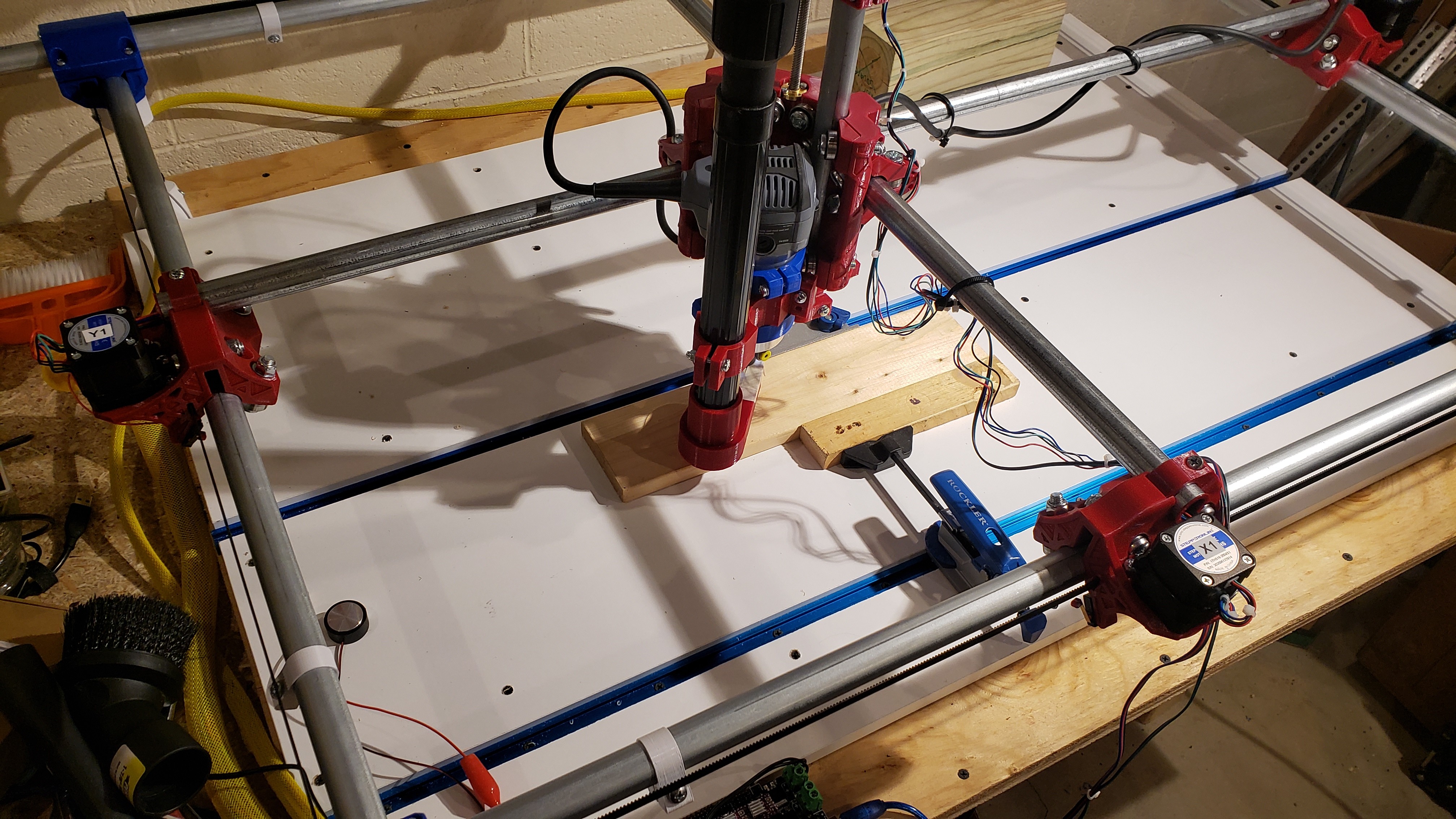

New build working
840mm x 500mm x 130mm Primo-C
grbl for RAMPS markbroiles(sp) version
Menards Performax Compact router (RT0701 clone)
12v - 3A cord wart power supply
bCNC controlling
custom dust collector
very nice! how’s the rockler table working out?

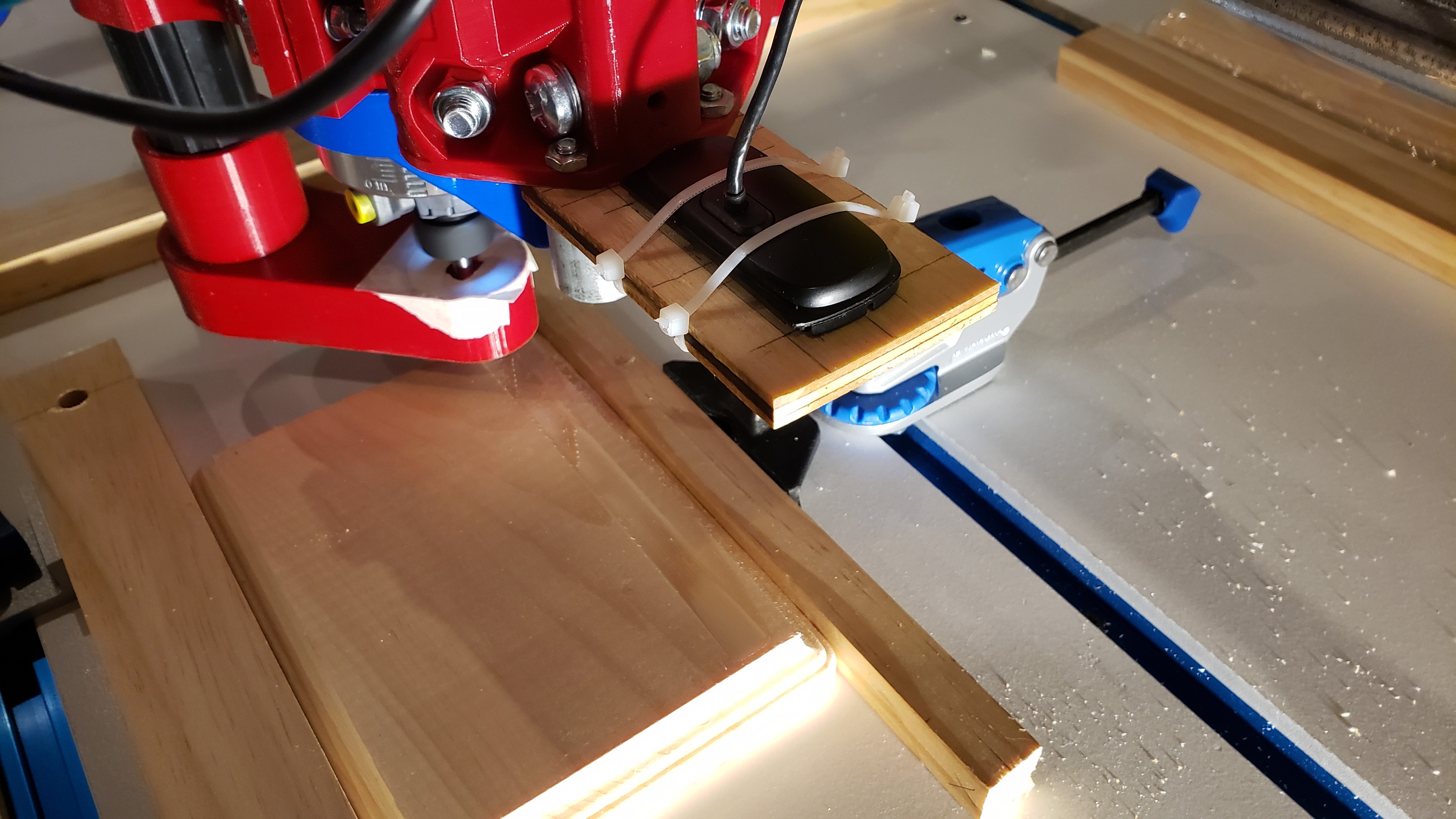

The only thing that is Rockler is the hdwe and the tracks. The white pieces are Rubbermaid 10" shelves. The compression clamp is really nice to use and nothing slips. I really need three more of them and a pieces that I can run between t-track runs and anchor down as a reference point for doing repeat runs.

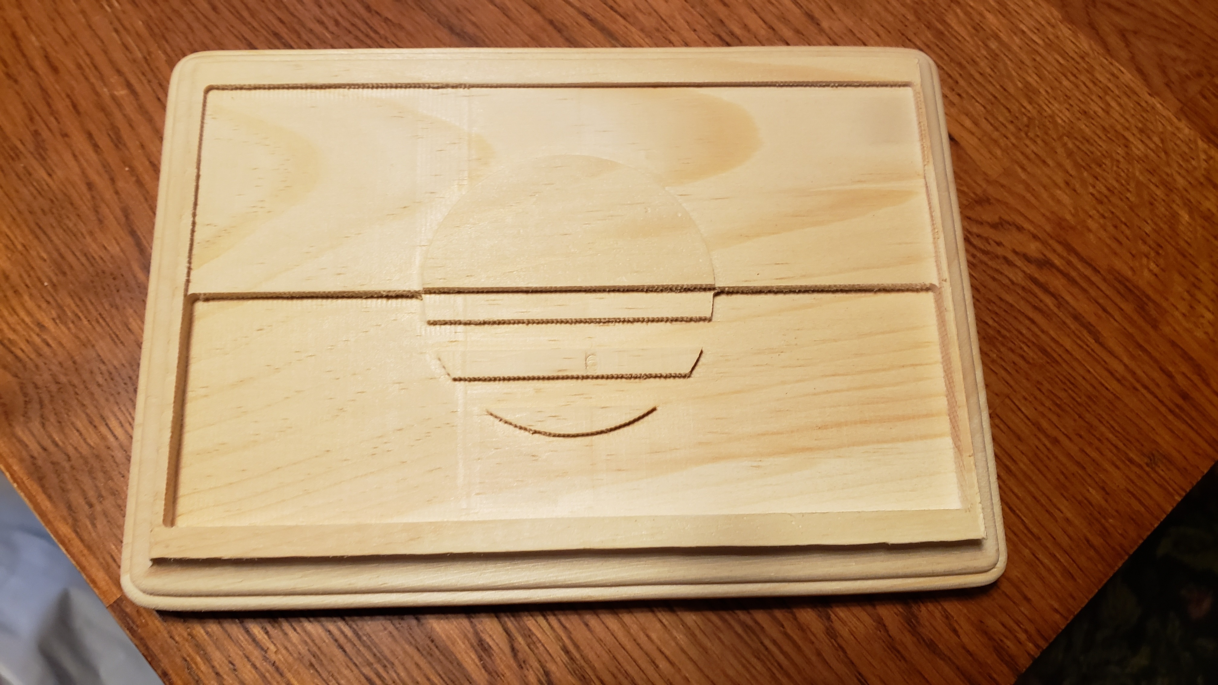

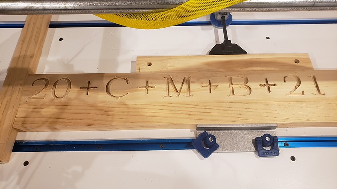

First really clean job. Getting this dialed in.
Just added the webcam to the core. Nice to have for hitting zero but I am not using all of the auto features with bCNC that the webcam gives you. Just happy with unit running under RPi3.
And completed. A couple of hiccups but not a problem.
