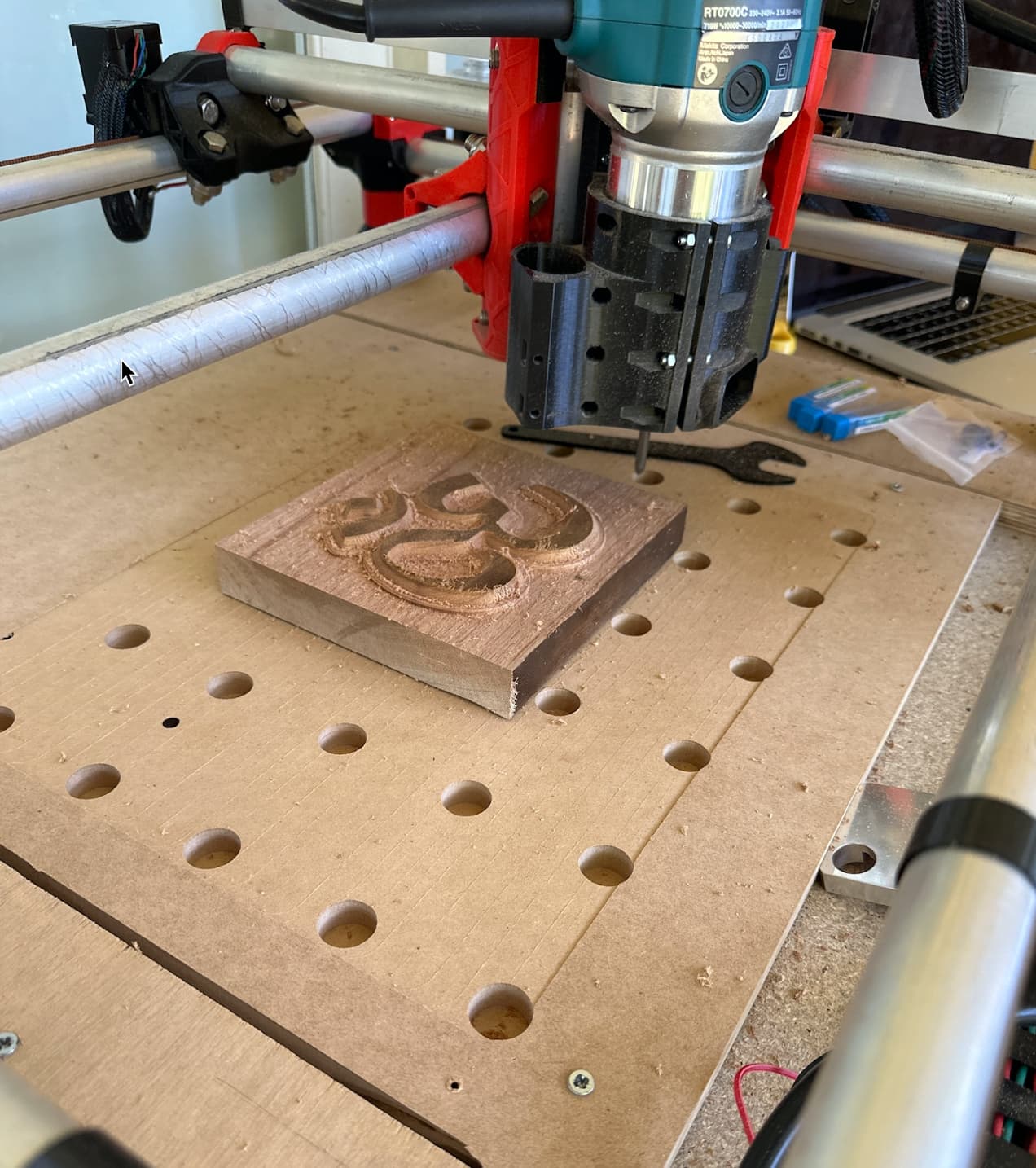

First test carve this evening - I flipped the spoil board over and re-levelled it.
I found out that UGS doesn’t really like talking to these Duet 2 boards. Its a pity because I really liked the gcode viewer, it was handy to triple check that I had my dimensions correct and correct z heights before I started destroying things.
In the end I used UGS to visualise and check everything but uploaded the gcode straight into RepRap and played it from there. Worked a charm even though I was a little puckery when I started it.
I also got the z probe functioning again and I think I found out the cause of some of my other pocketing errors that had been bugging me. I’m pretty sure it’s the xyz probe macro adjusting for the tool diameter, and I didn’t change it when I switched to a smaller diameter tool. I’ve built a set of macros for every diameter tool I have now so I’ll hopefully get to try a pocket again tomorrow and see if it fixes things.

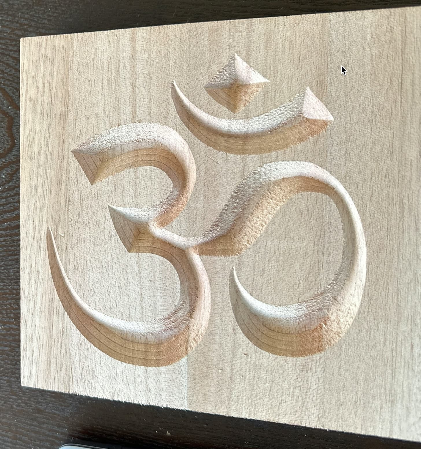

Doing an inlay carve for the first time.
Male:
Female:

pre stain/paint first attempt at an inlay. not as neat as i would like, i think next time i’ll make the inlay much deeper as i had some chipping where it got thin. but i should be able to salvage it with sanding sealer and tlc and hoping it will come up nice with some oil.

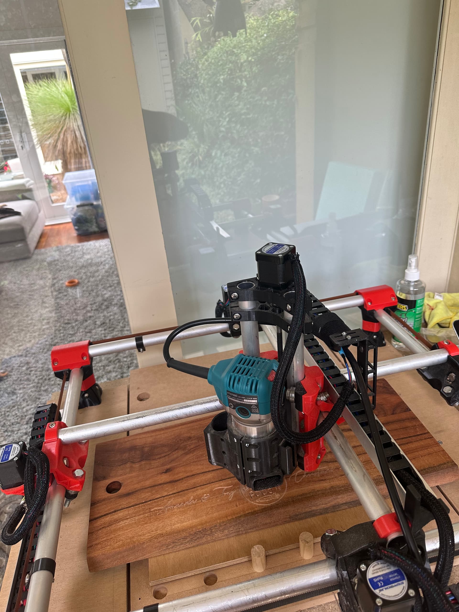

macguyvered a way to keep my oversized cutting board square
and the finished product!

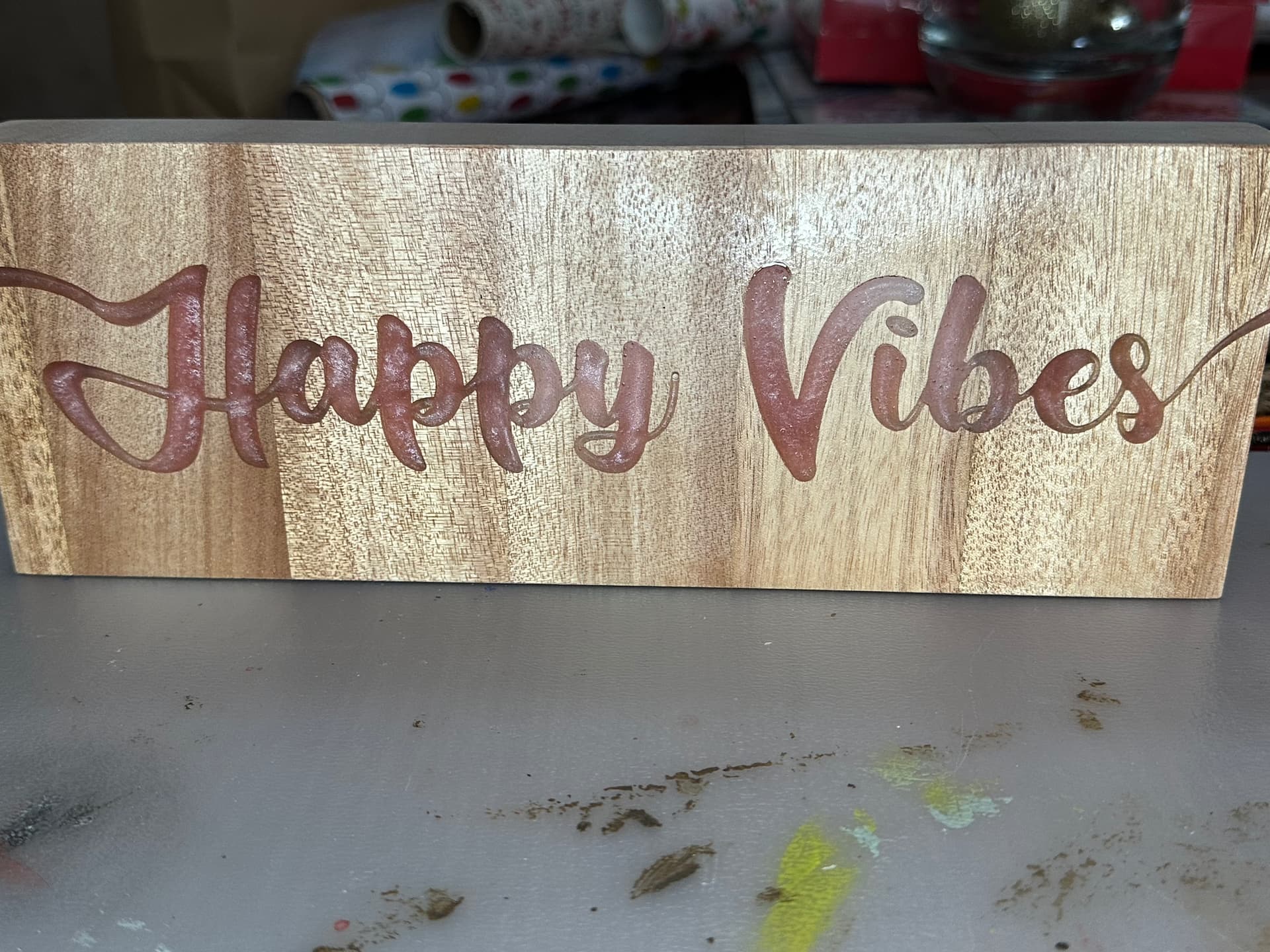

another xmas present and my first attempt at resin
When doing resin I started milling a mm deeper and then planning the whole thing later because I could not get the bubbles out.
