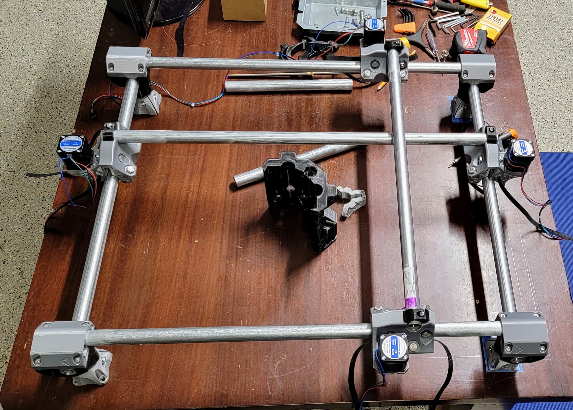

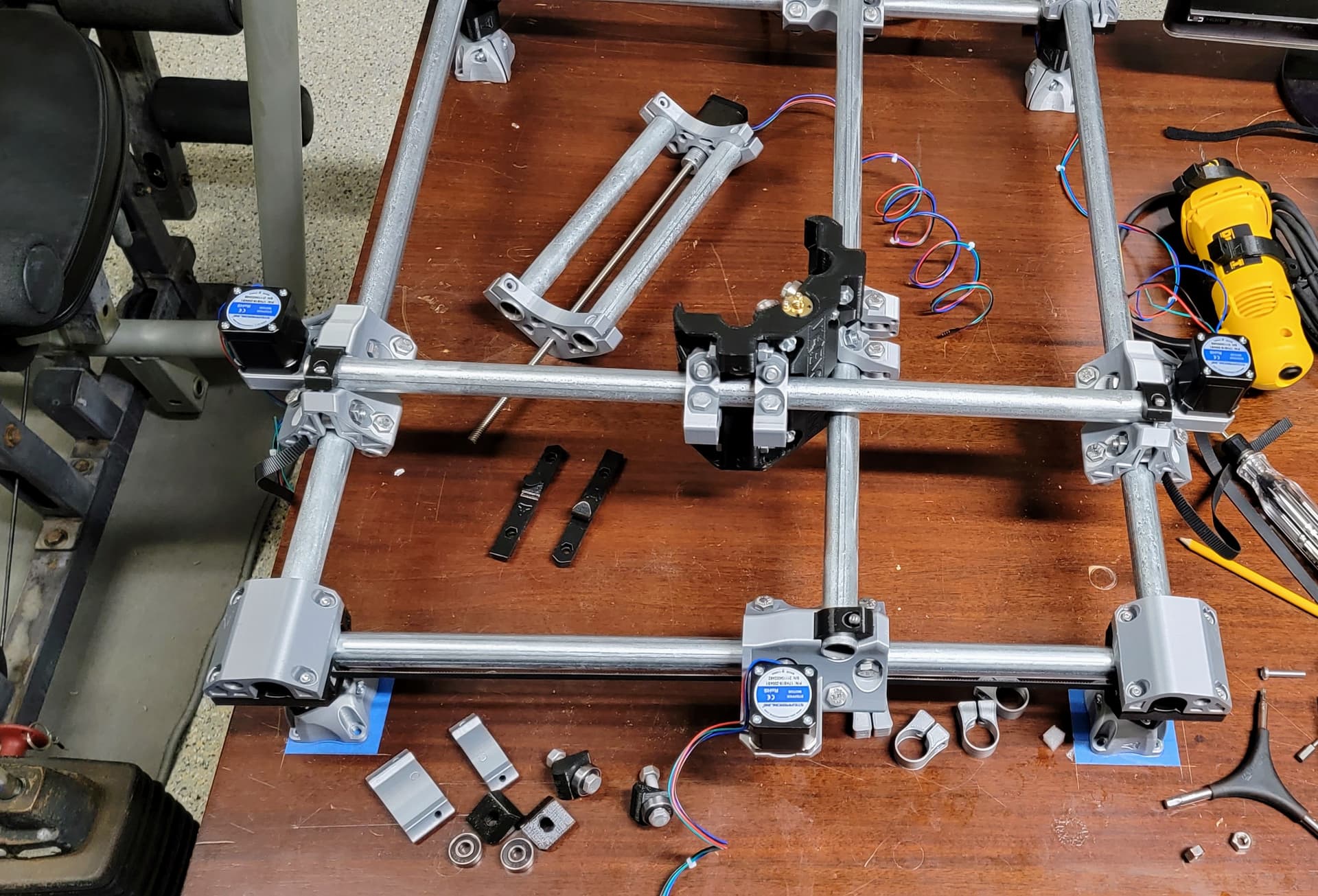

Got the kit, following the guide, almost done with frame, steppers and XYZ axis, next is the electronics part, I’m using RAMPS 1.4 kit, very exciting!!
The more I get deeper into the build the more I appreciate the design, thoughts put behind, great work for the designer/s/community!
It really does go together nice, doesn’t it?
I put the beta testers through hell on this one. Thanks for noticing!

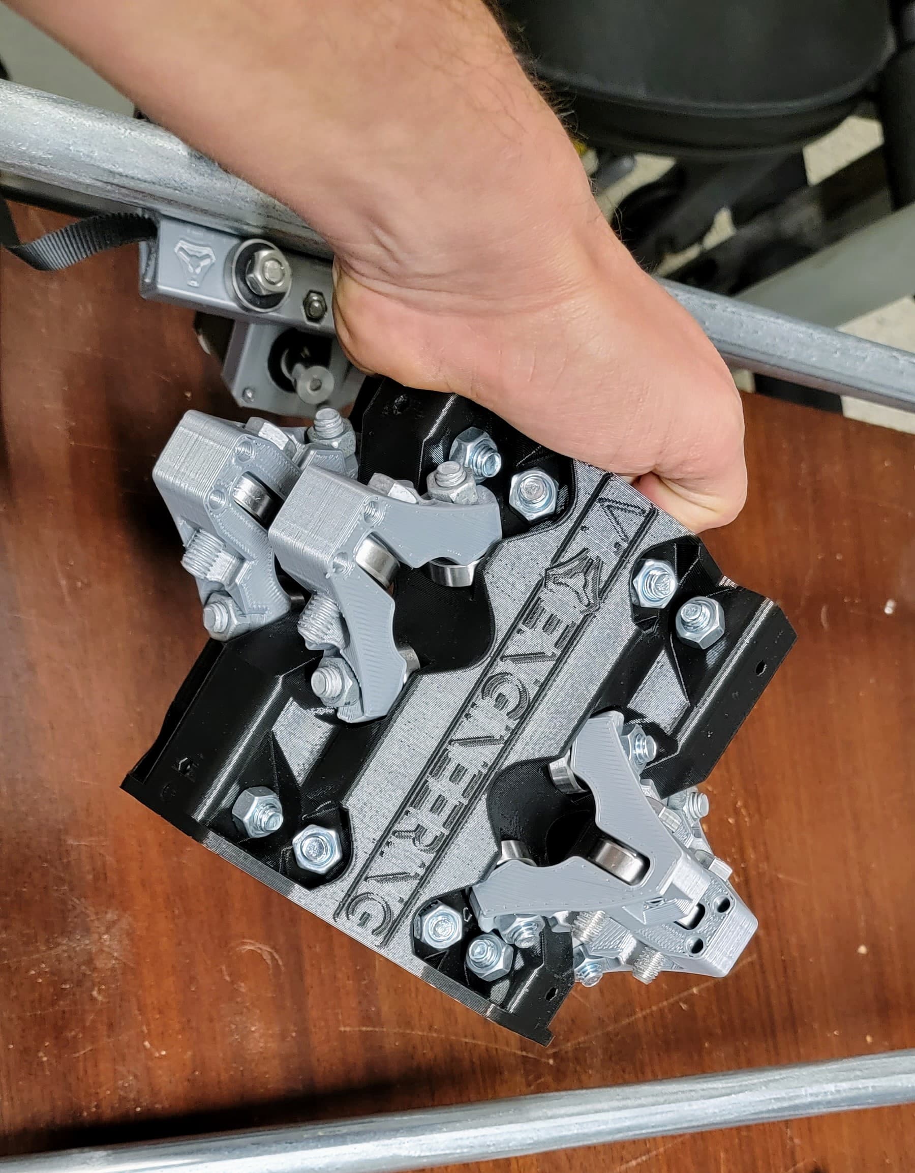

Yes, the core was a fight :slight_smile: just to get all bolts in, aligned, bearings alignment …etc so only five points touching the rails, I was worried to run into alignment issues but at the end all sit perfectly and smooth!

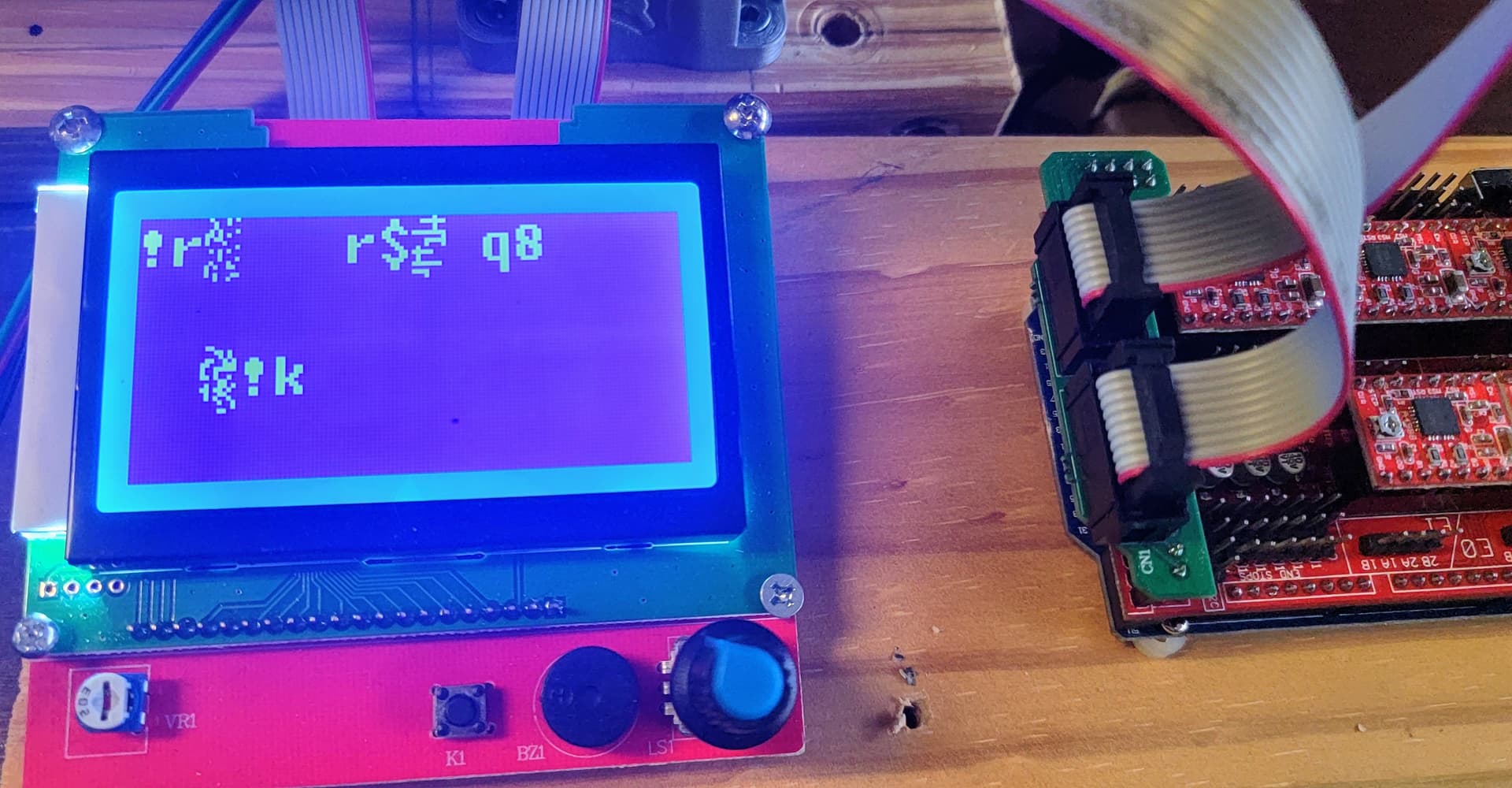

I got it all up and running and then all of a sudden the screen will show some gibberish like Chinese fonts random, I had to power reset, now I’m gett an error when I try to flash the firmware using VSCode and not flashing, I think maybe the board got corrupted.
Is the a way to complete reset ATMega board?

You can try taking the ramps shield off the mega board and flash it naked like that.
So i have ramps kit from amazon. I used the fw from here with xloader and it was a breeze, unless you need something custom
https://docs.v1engineering.com/electronics/xloader/
I did it already, also tried the “Burn bootloader” option and the board is timing out no matter what I do.

It did work fine uploading firmware, doing initial testing, during the crown example I was navigating the menu on the shield screen then I see random typing on screen, reset was the only option out, it could be the screen part of it.
what firmware did you load? You loaded the V1CNC_Ramps
firmware, right?
Sorry for the late response, really late :), finally back to the world of tinkering!
Yes, I used V1CNC_Ramps firmware.
I was able to get it working, the bootloader was corrupted, so I did a reset then burn a new firmware (Atmega16U2 part of it), then flash Atmega328P.
Reset the 16u2 :
short the reset pin with the ground, right behind the USB connector port.
Burn a new firmware:
sudo apt-get install dfu-programmer avrdude -p at90usb82 -F -P usb -c avrispmkii -U flash:w:MEGA-dfu_and_usbserial_combined.hex -U lfuse:w:0xFF:m -U hfuse:w:0xD9:m -U efuse:w:0xF4:m -U lock:w:0x0F:m
