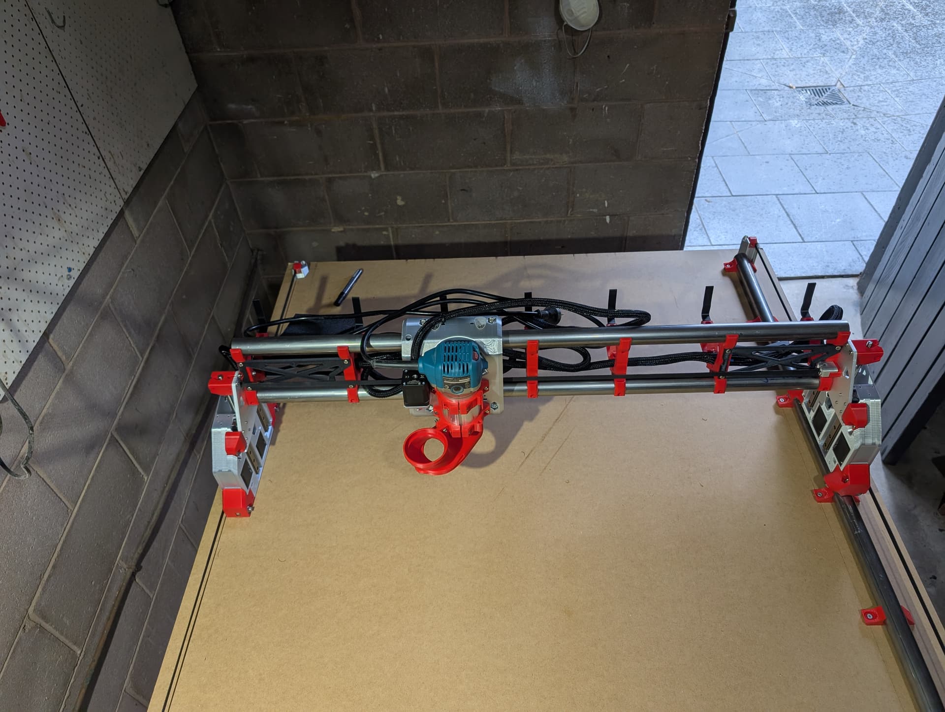

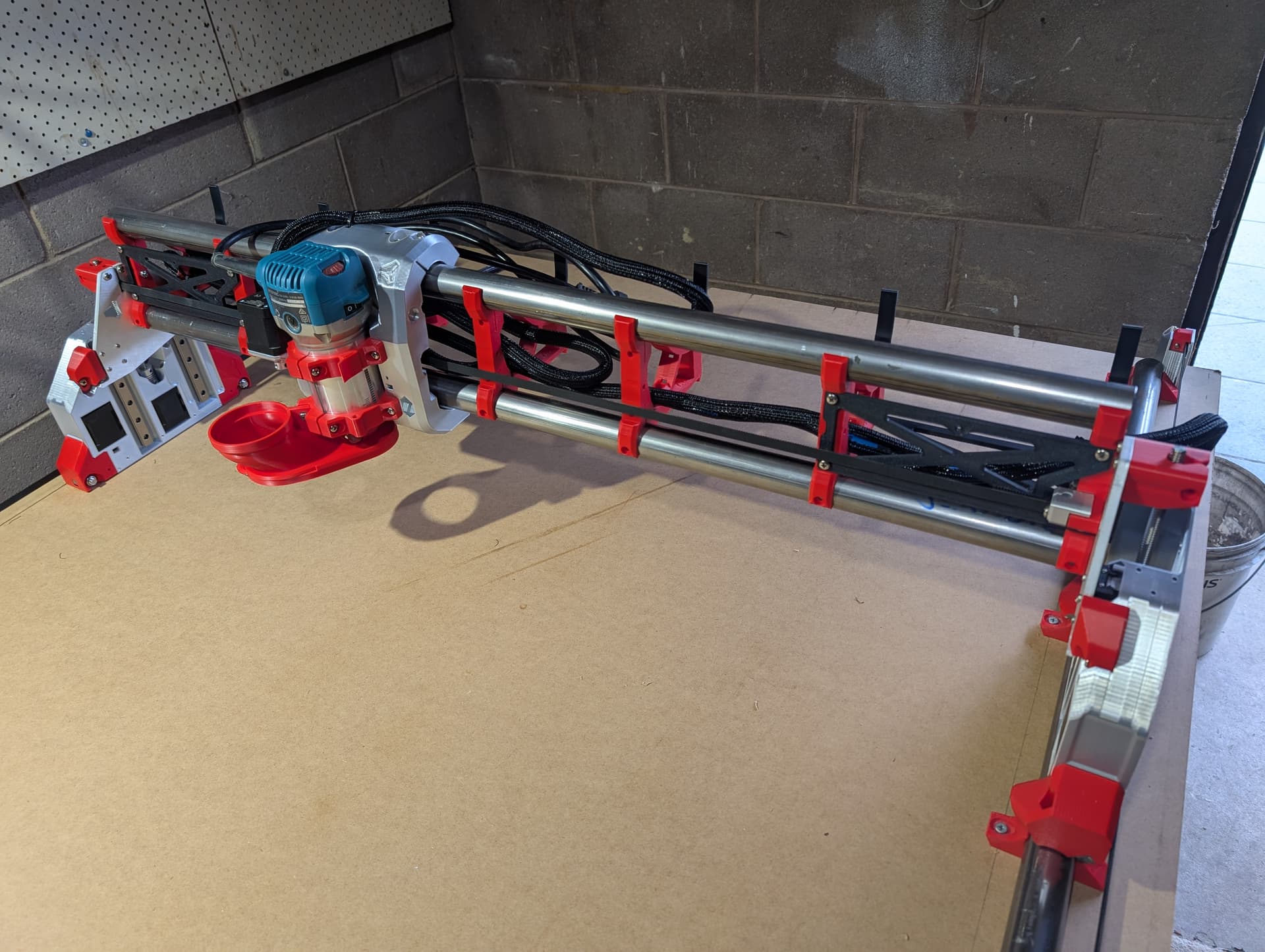

New build LR V4 started Canberra Australia

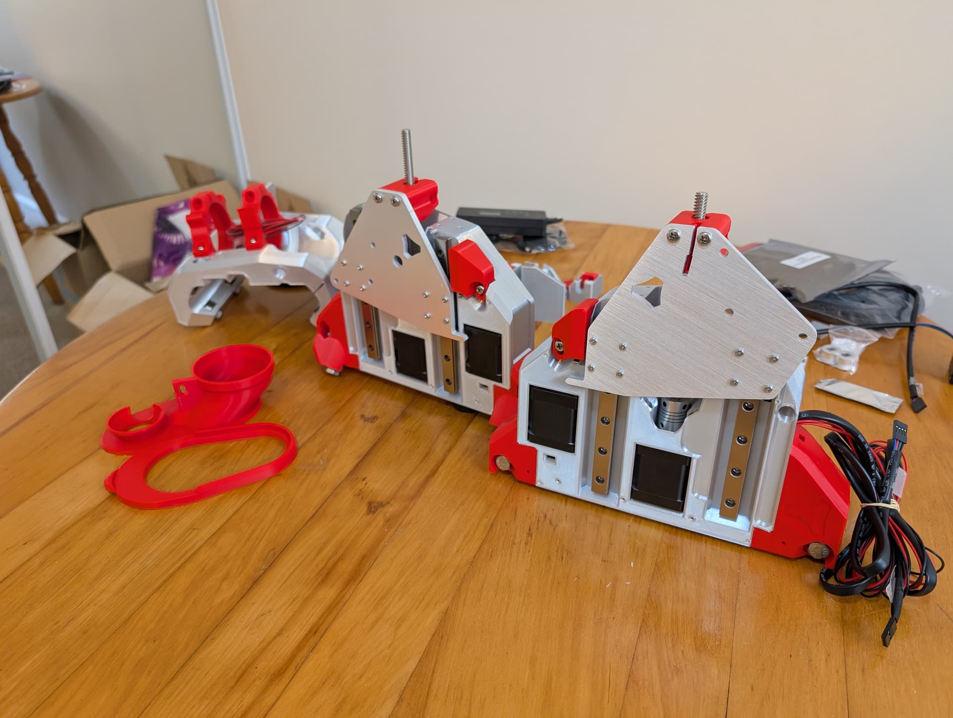

Progress, YZ assemblies complete, core just waiting on the touch plate to arrive so I can run the wires before completing.
Instructions are pretty straight forward to follow. Definately check ALL captive nylocks before fitting. I had one M8 nut (from the purchased hardware kit) that bound up and locked solid after running the bolt through it - would have created a huge problem if I hadn’t checked it first.
Time to get on to that new bench this weekend while I wait for the parts to arrive ex USA.

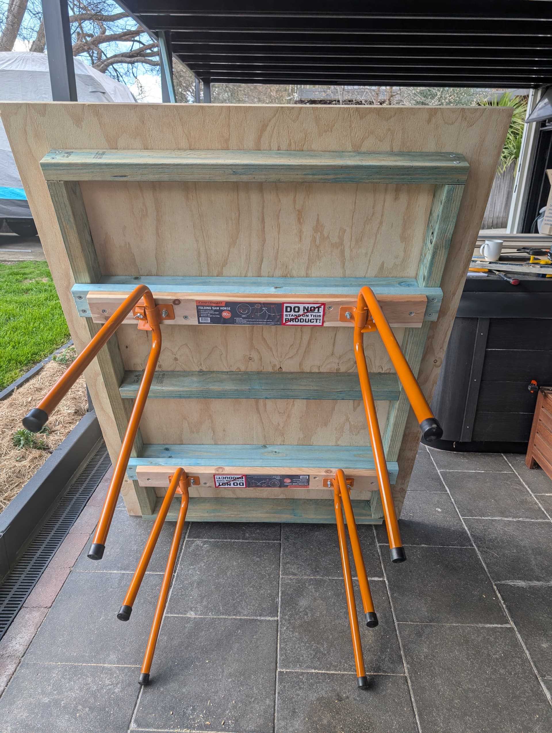

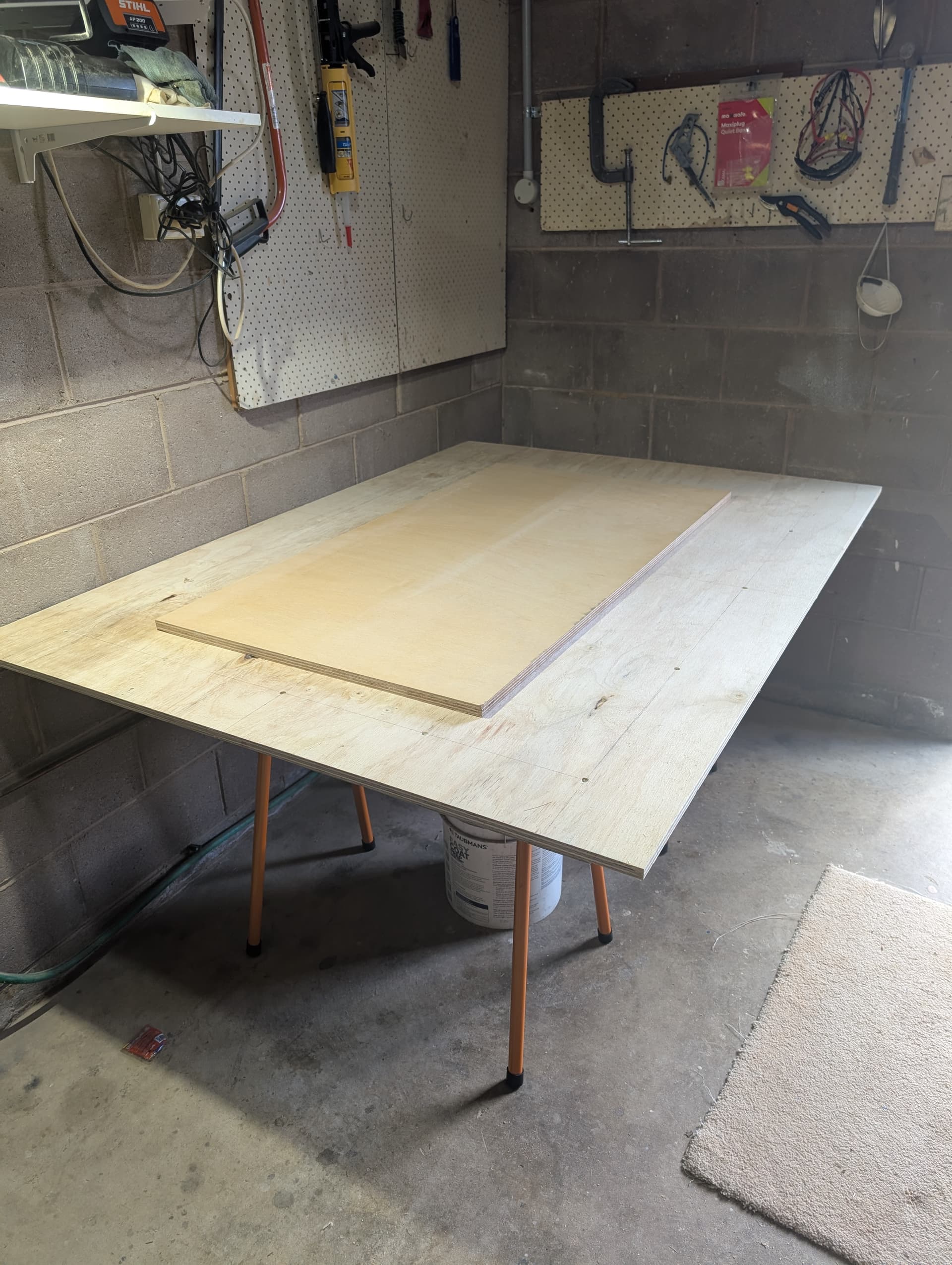

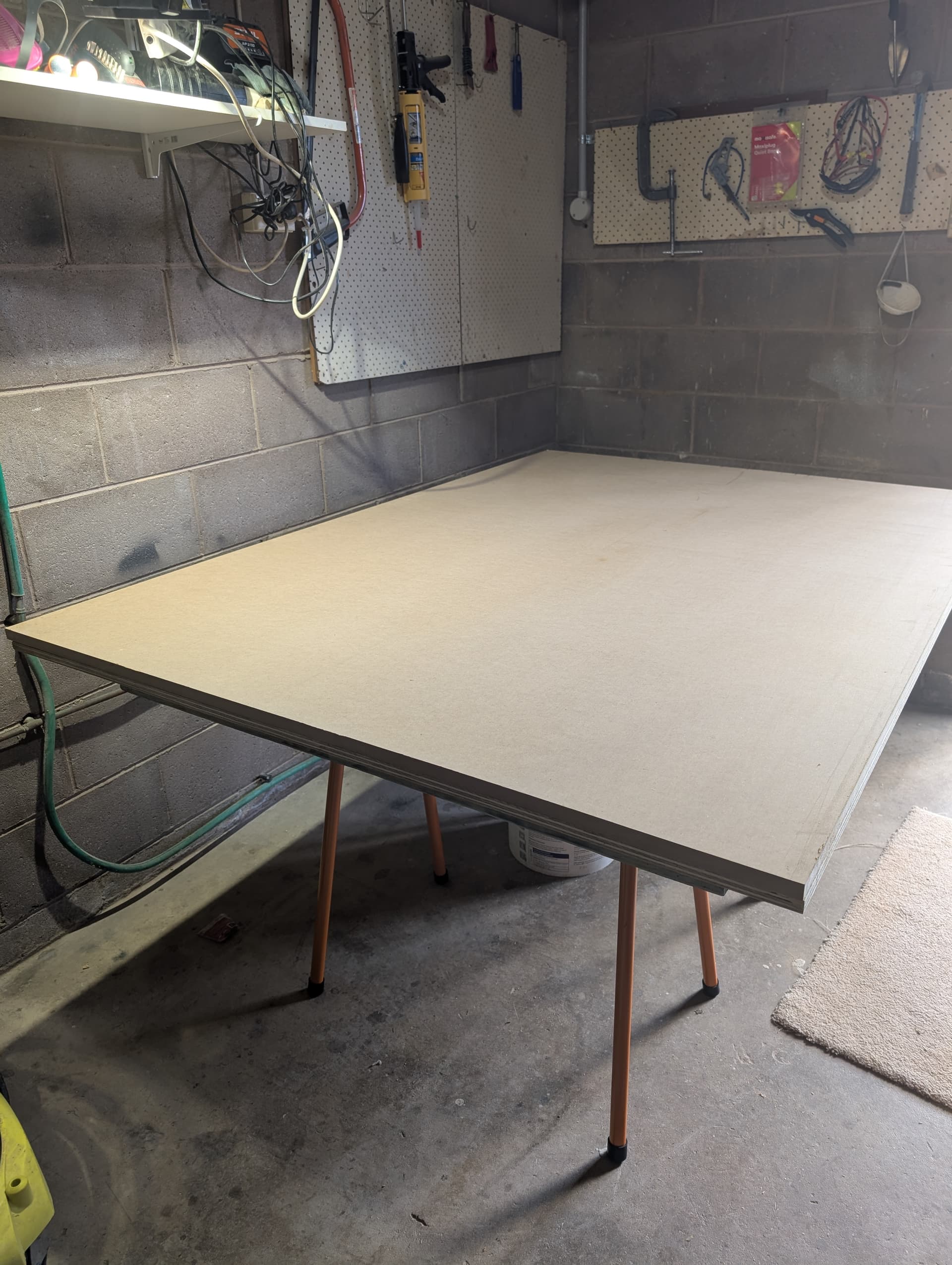

More progress, the table finally made.
I’ve sized for what storage I have in the workshop and to suit some existing projects I have going, so it’s an odd size until I finally get a full sized workshop and expand it to full sheet if I find I have any use for larger.
Folding legs were a must so it can be moved without major disassembly. It weighs a lot! I used 15mm structural ply and 18mm MDF for the spoil board. Worked out at around $250 AUD with the saw horses for legs and 90mm x 45mm for the main table frame.

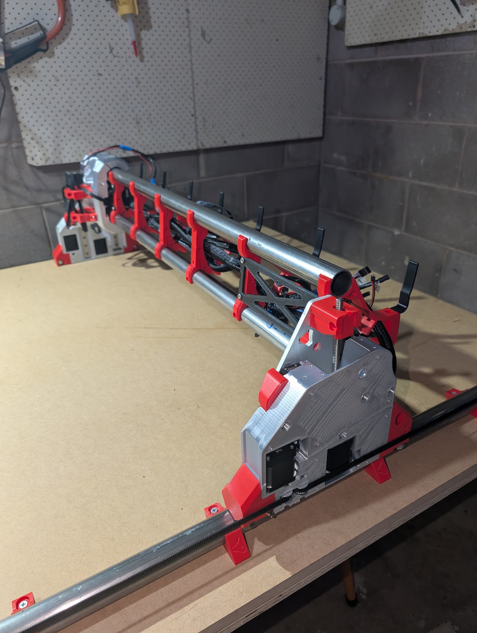

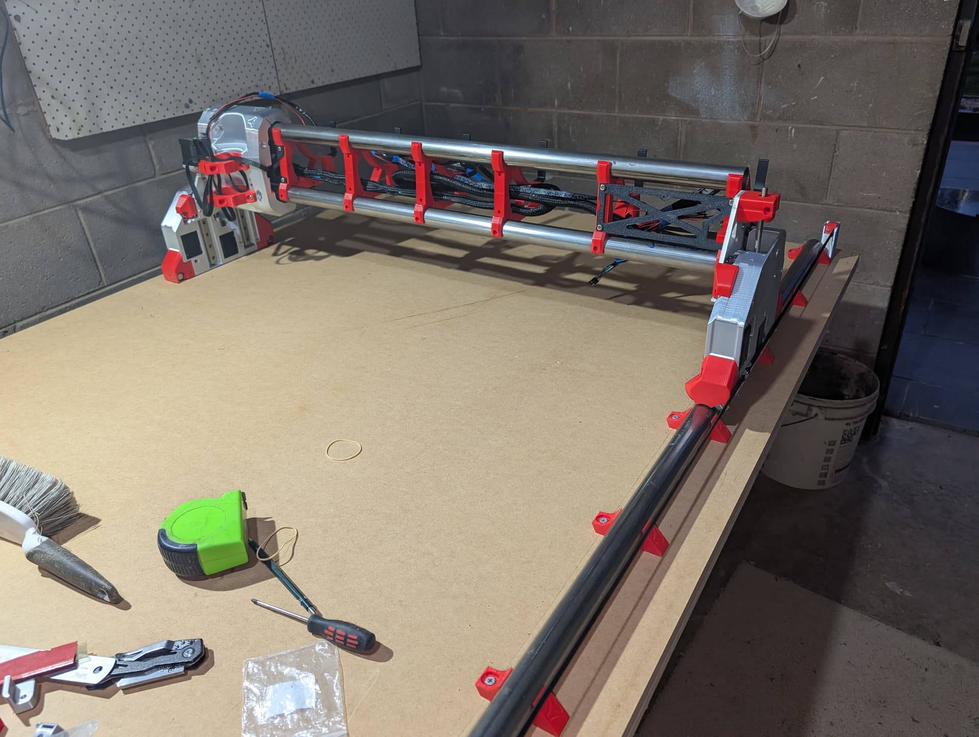

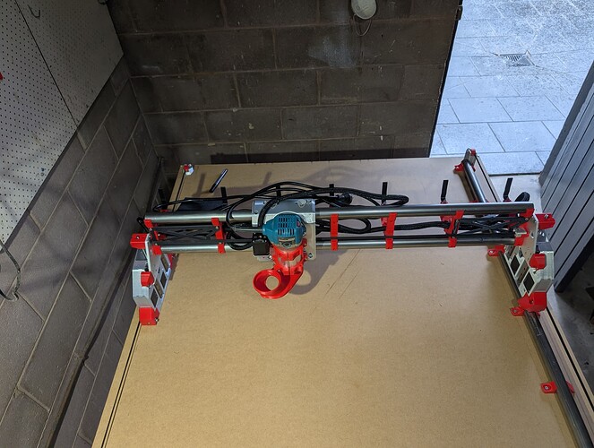

More progress today, it looks like a machine now.
I’ll soon run out of things to do until USPS gets itself organised with my controller and probe.
OK, officially stopped while waiting for the controller now. Time to spend some time in FreeCAD getting my initial cuts ready!

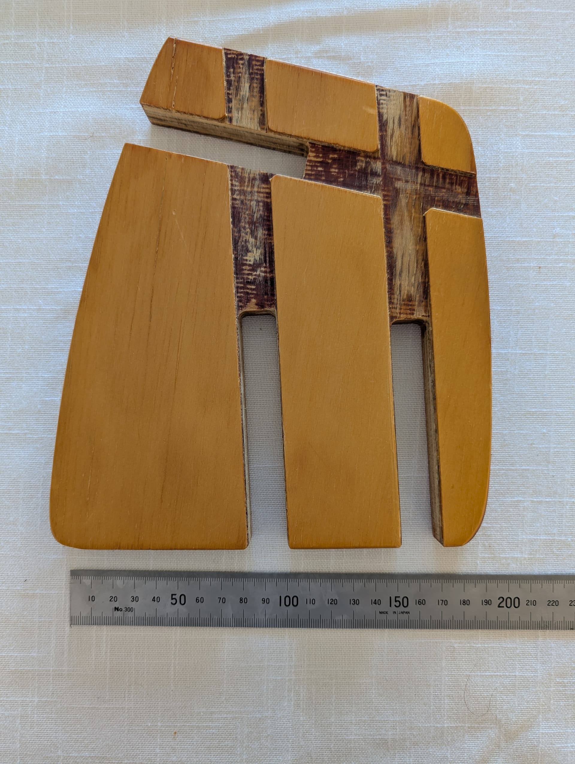

I’ll have all the calibrating to do, then I have some adjustable meditation seats that I currently template route to do in the CNC instead.
Here’s part of what I’m be cutting out of 18mm marine ply
Strut plates first. :slightly_smiling_face:
Yep, better get that done first

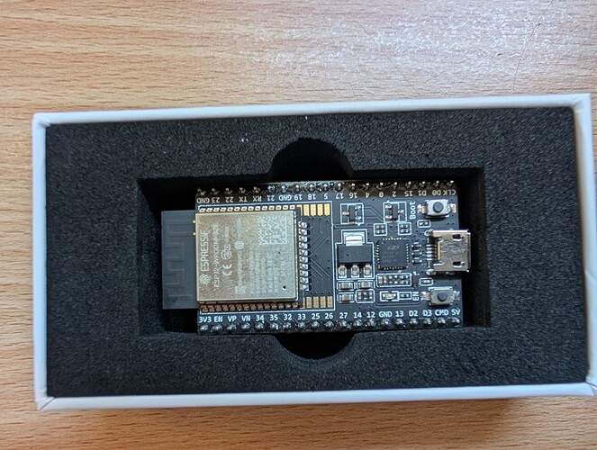

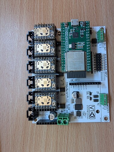

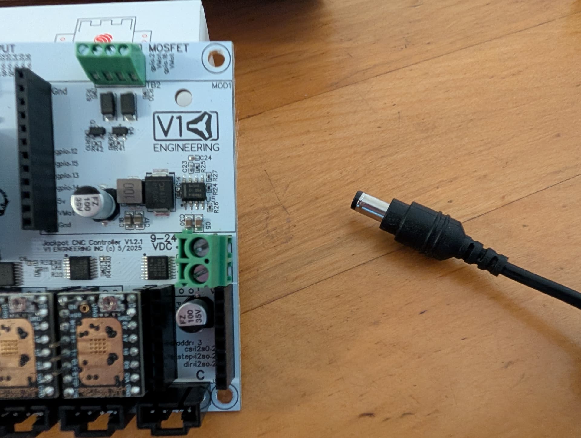

OK, now that the control board is here I have a couple of rookie questions if anyone could help :slight_smile:
  1. For powering up the Jackpot controller, do you just cut the plug off the low voltage end of the power supply to expose the positive and negative wires or do people get a female plug and then wire that in so it’s easier to plug and unplug the power supply to the board?

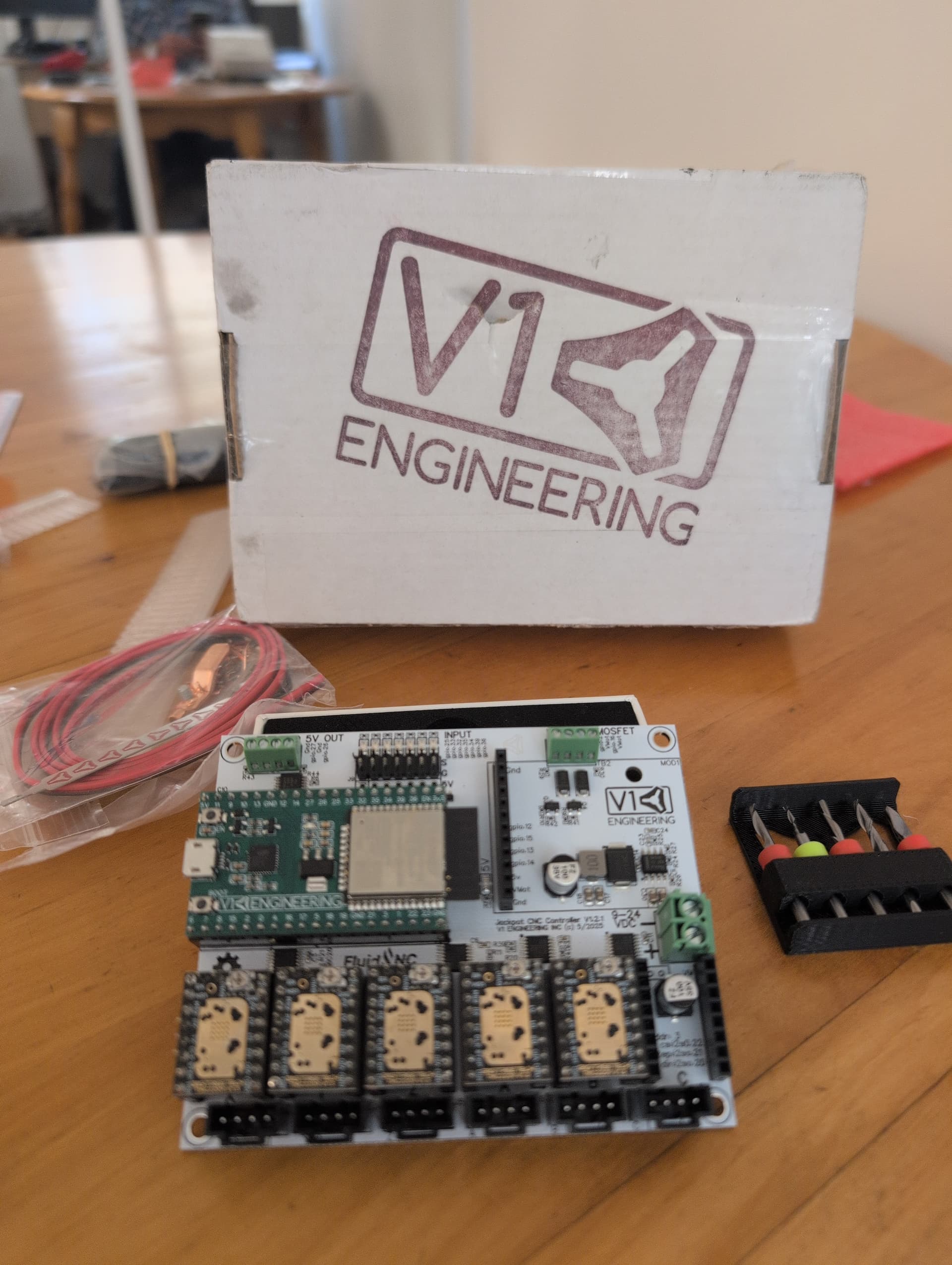

  2. I ordered a separate DevKitC internal antenae ESP32, don’t really remember why … The Jackpot board came with a ESP32 board already installed. The one on the Jackpot is a genuine Espressif as well. I’m guessing I might have bought and extra dev board by mistake, or is the one supplied and the extra one different? I think I had assumed that the ESP32 was a separate purchase but I’m just just not sure.
Thanks in advance …
Mike
  1. You’re right, cut off the connector and the +ve and -ve wires screw directly into the terminal blocks. Don’t overtighten
  2. Yep you’ve got yourself a spare esp32 board. Handy if you want to put ui v2 on one and v3 on the other and see which you like more.

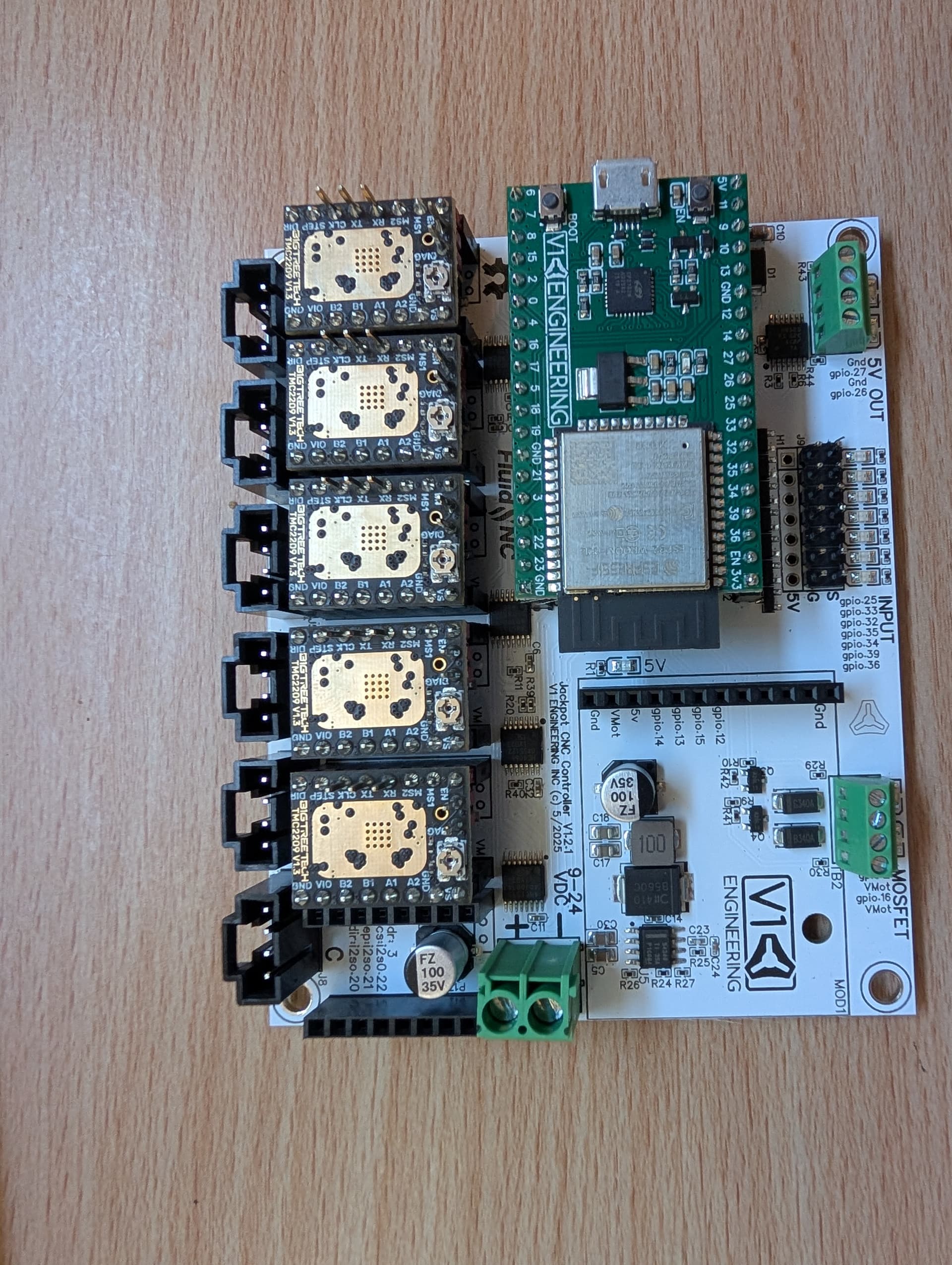

You might know this already so please I don’t mean any offence if I’m stating the obvious but before use the stepper drivers - the 5 little boards - need to have the self adhesive heat sinks attached to the pads on top, making sure to avoid touching the tops of the pins along each side.
Thanks muchly for the confirmations, and certainly no offence taken, it’s a timely reminder
Don’t forget the heatsinks for the drivers, those spiky blue things. Make sure they don’t touch the pins. :slight_smile:

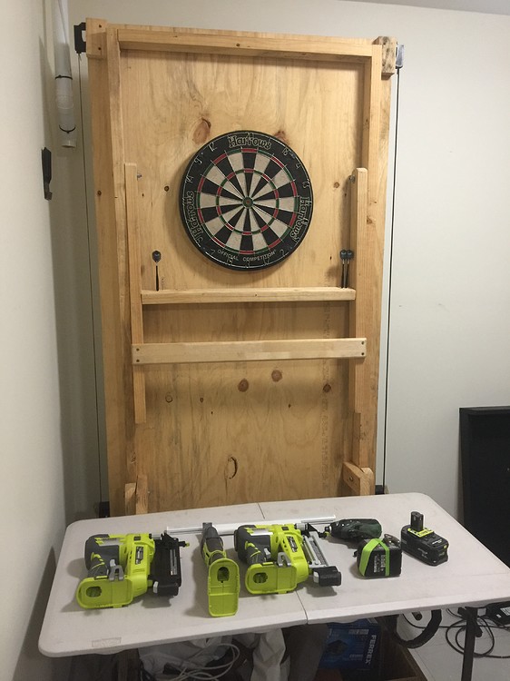

I built a fold down table as garage space was a bit sparse. When foldd up I use the underside for playing darts :slight_smile:

table
Table Stored

Great looking bench you made there!
32mm Steel Electrical conduit available from most electrical wholesalers is the right size.
Not sure how the pricing will be compared to a steel merchant that carries a similar size.
Nice one - I’m in Moss Vale and about to start a build, so situated right between you both.
Also just bought a 3d printer from Jaycar to replace my old, dying 3d printer!
That’s a great looking bench, I might have to copy that!!
Cheers!
