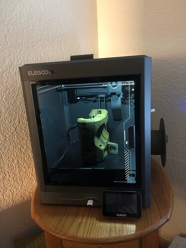

My original printer the OG Ender 3 has been collecting dust for about a year so I’ve officially retired it (mostly for speed reasons) and so I am now the happy owner of “the next Ender 3” an Elegoo Centauri Carbon. Its a wonderful machine and I have been paying my fair share of filament to relearn some lessons forgotten during my absence from the hobby. The PEI bed that comes standard has a smooth side for PLA with is a new thing for me. I had used the recommended bed temp of 30 C that was etched onto the PEI sheet but was getting some corner lift from my braces. My default fix was to add brims to everything, but I just realized that turning up the temp higher to 50 C resolves that. Unfortunately I’ll have to clean brims off of most of my accent parts but its a lesson I will happily learn. I am hoping to be finished with printing parts in the next week or two, the yz plates and core will be last on my list.

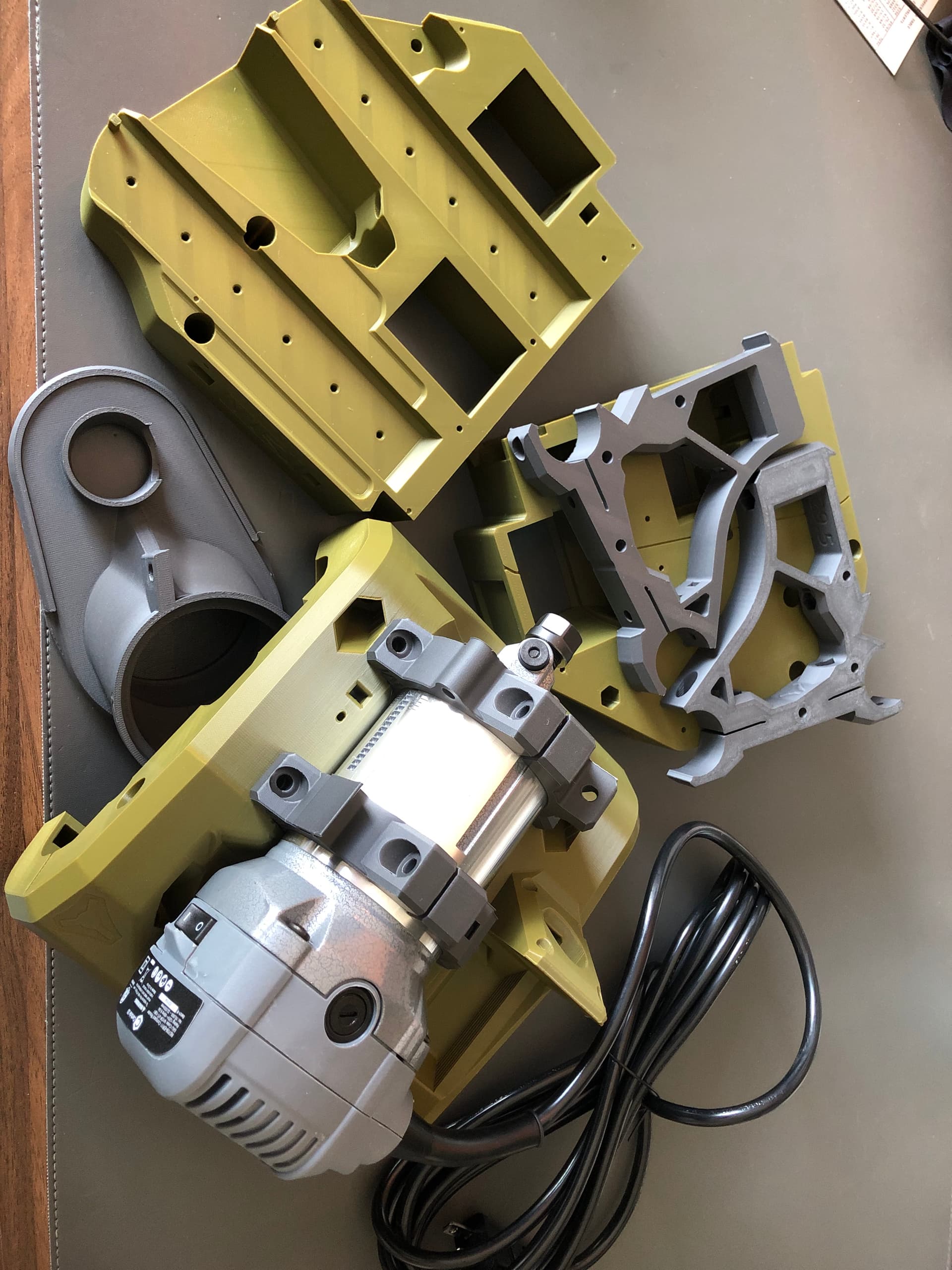

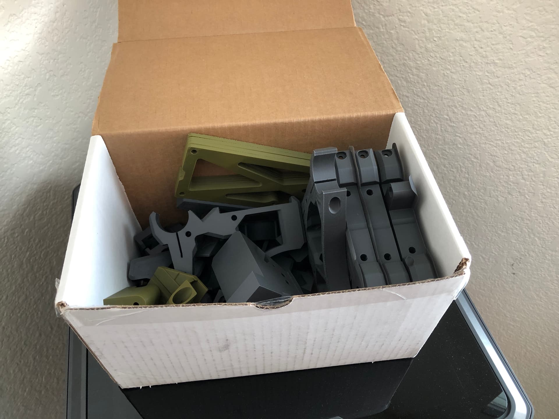

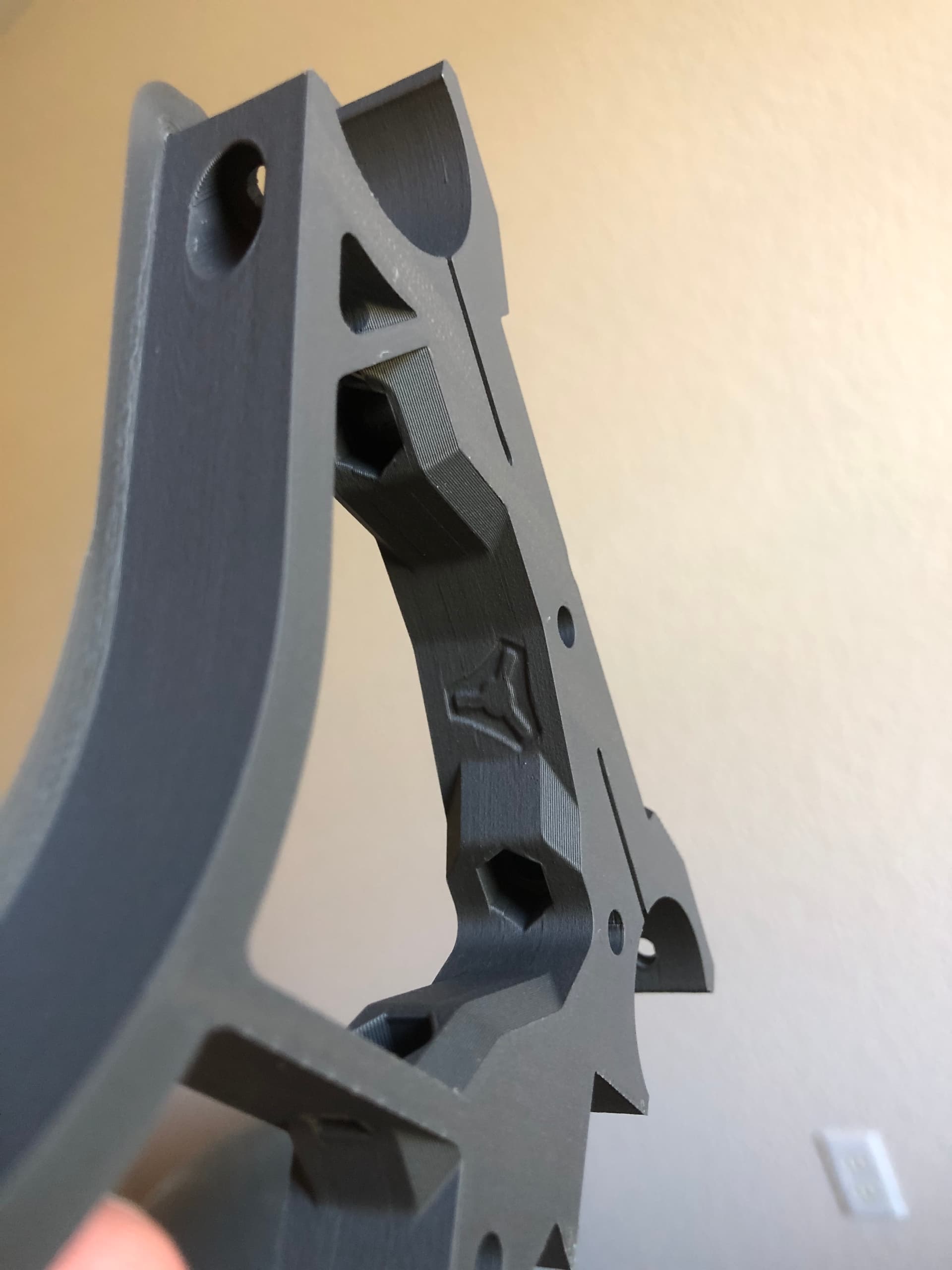

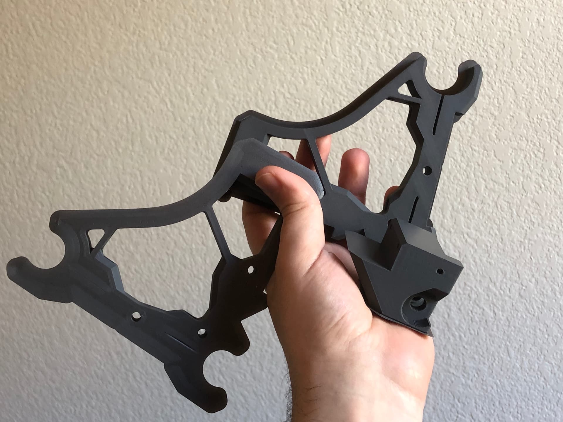

Happy to report that printing is complete! I still need to clean off the brims of the first half of the parts where I included it but should be a short job. The parts all printed incredibly well and I am so thankful that I turned on top layer ironing…icing on the proverbial cake :pinched_fingers:

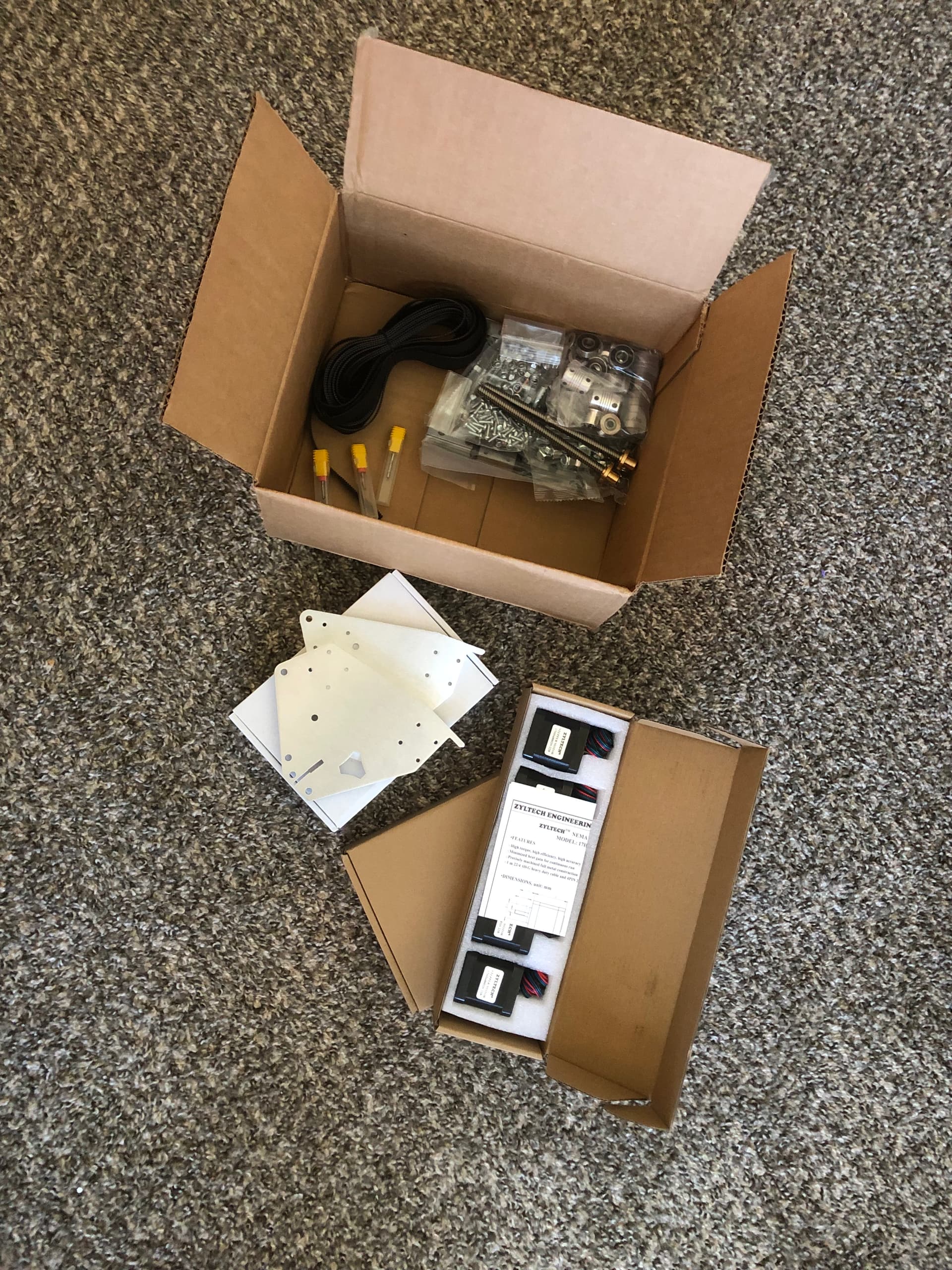

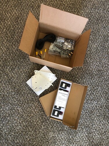

Going to have to pause progress for a few weeks until I can order the hardware kit. My hobby piggybank is hurting after the Centauri buy so I need to build that back up. In the mean time I will probably do some rough table ideation as a way to learn FreeCAD (Creo power user at work).

Upgraded from an Ender 3 Pro to the same 3D printer - awesome bang for buck.
Those parts look great. Congratulations, that was a lot of work.

Looks so good! What colors and brand filament did you use?
