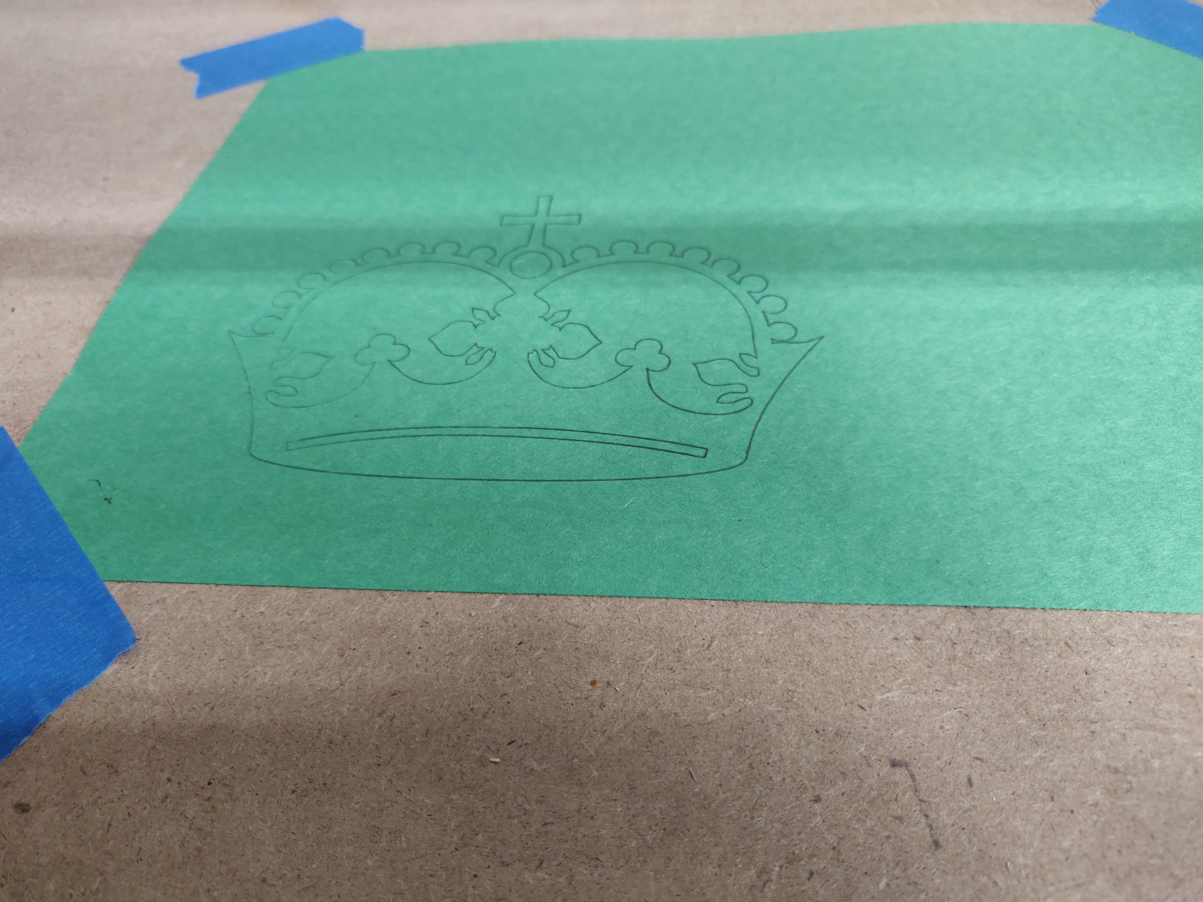

WOOHOO, Crown test done!!

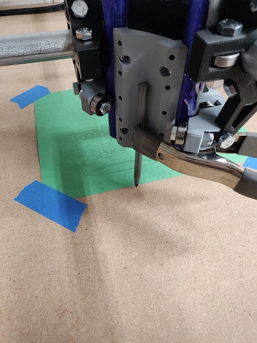

With my janky pen mount, lol:
