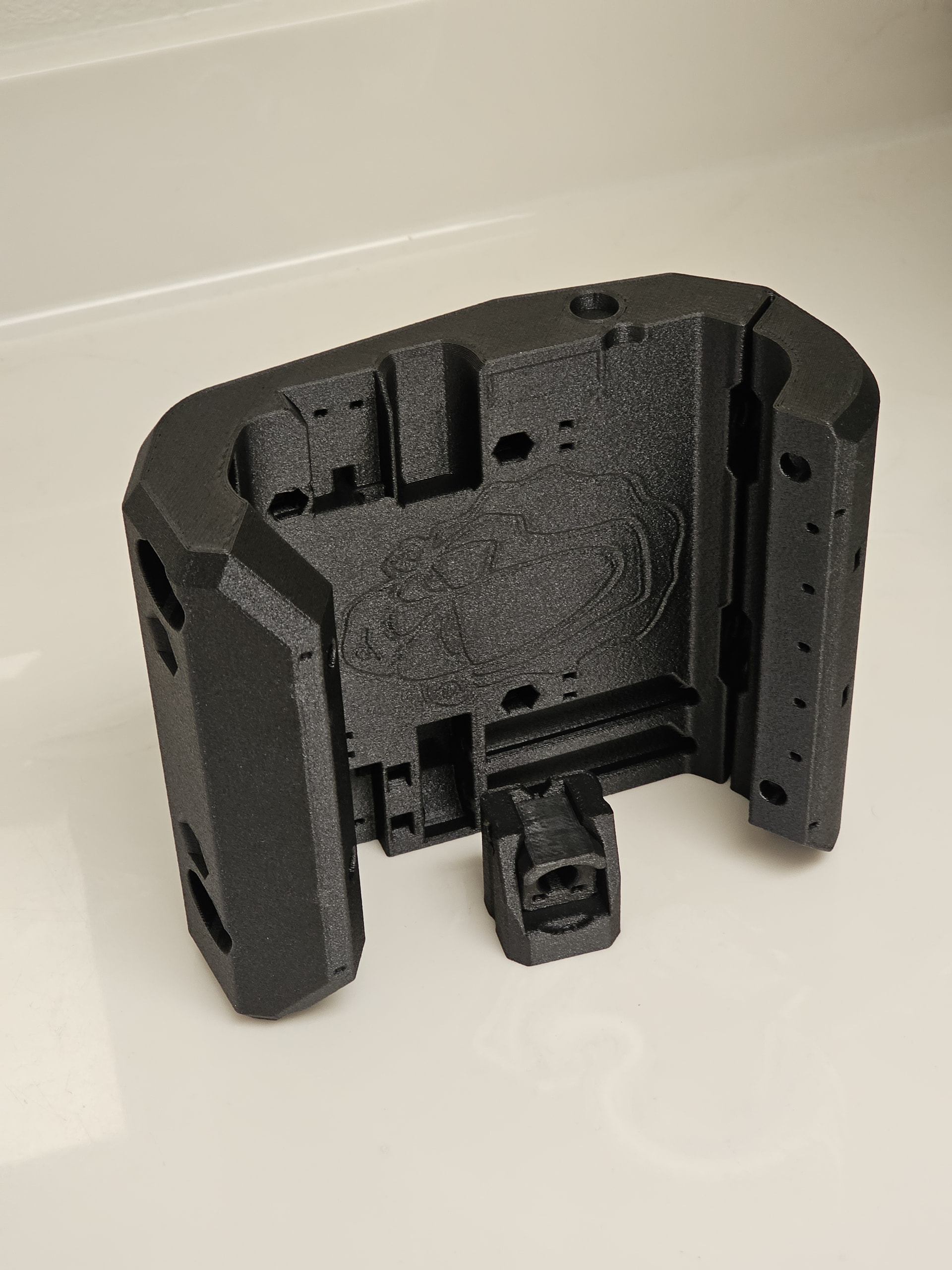

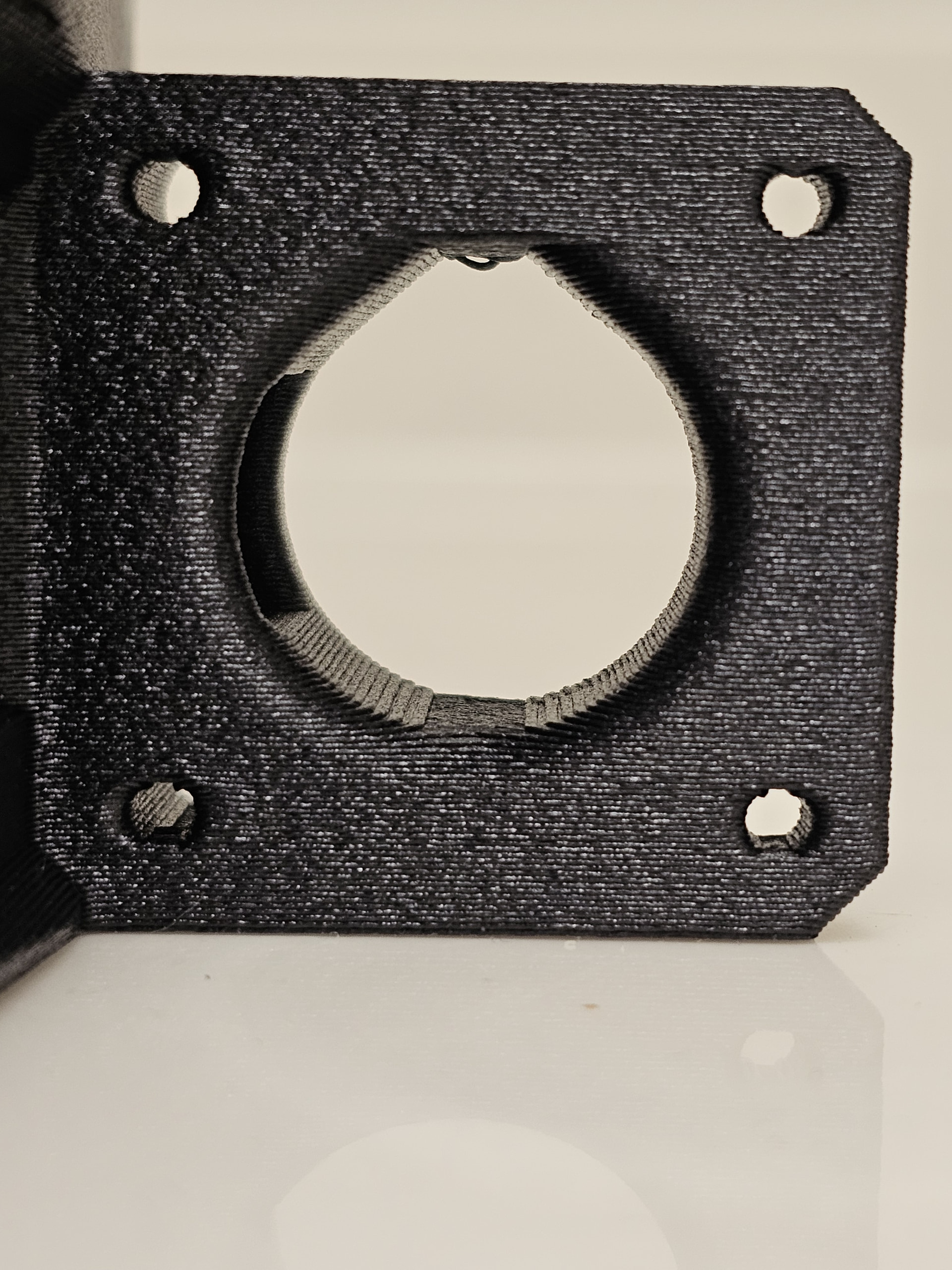

Here are my completed parts so far:

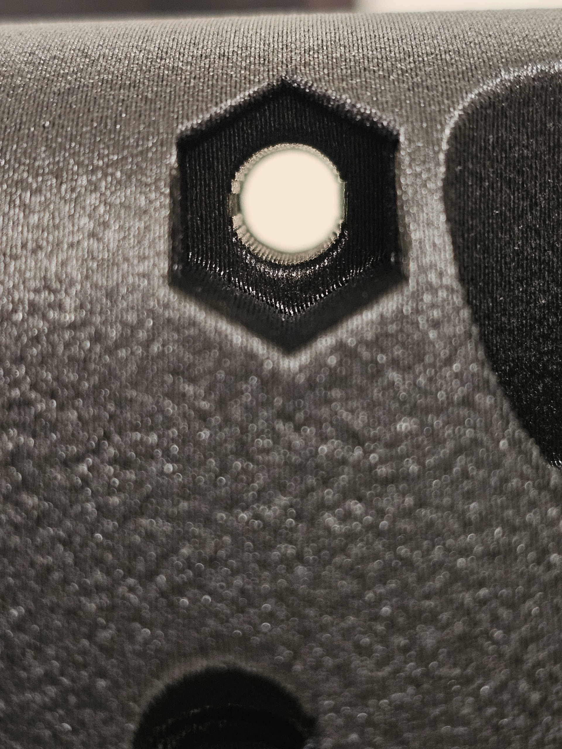

These overhangs are great.
Nice design tailored for 3d printing.
I printed the core with 15% infill, one extra perimeter, one extra top, and one extra bottom layer based on the default 0.6mm quality profile. The mass is about the same as a quality 0.4 mm nozzle profile with 30% infill.
