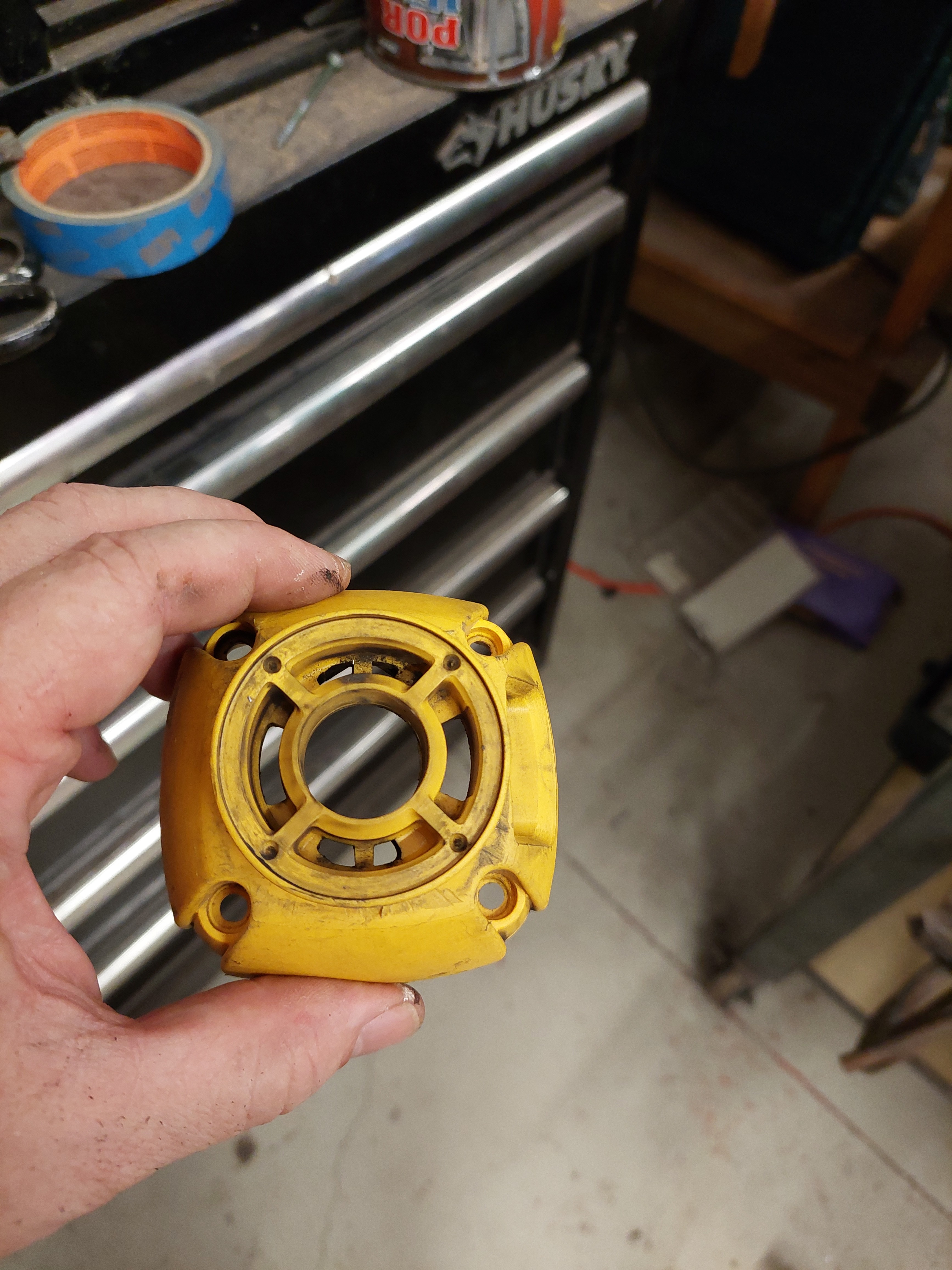

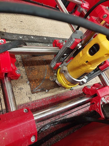

A little down time, I finally broke my Dewalt. It was an odd failure, best I can determine the cooling fan blade disconnected from the armature shaft and wedged itself in to the bearing holder. So I bought another used DW660 and swapped the armature into my first router. I also made a little cleaner mod on the bearing holder for cooling flow through and removed the plastic collet nut adjuster because I never use it anyway.
All working good and made some great aluminum cuts tonight. I think I am getting better results now because I am getting so familiar with the machine. When working well, the sound is much lower decibel. I can easily work on other projects while it is running by just monitoring the sound. Even loosening of screws seems to have diminished somewhat.

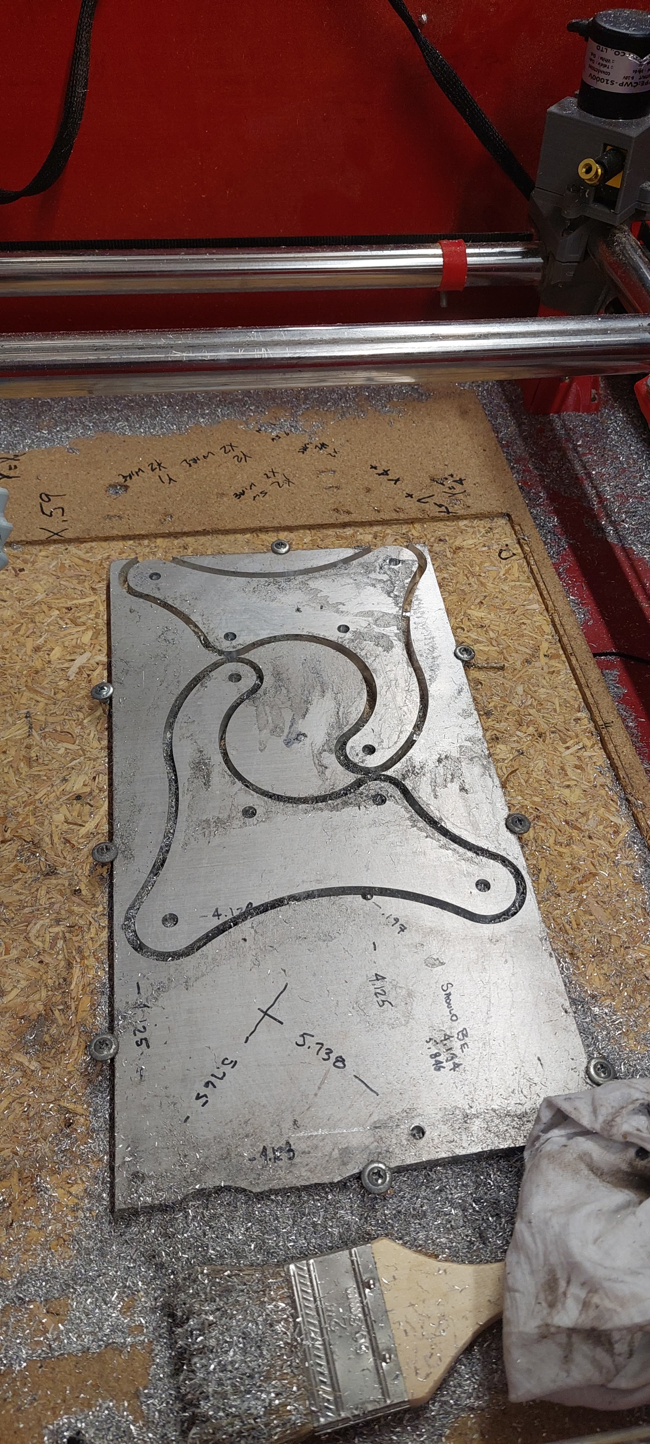

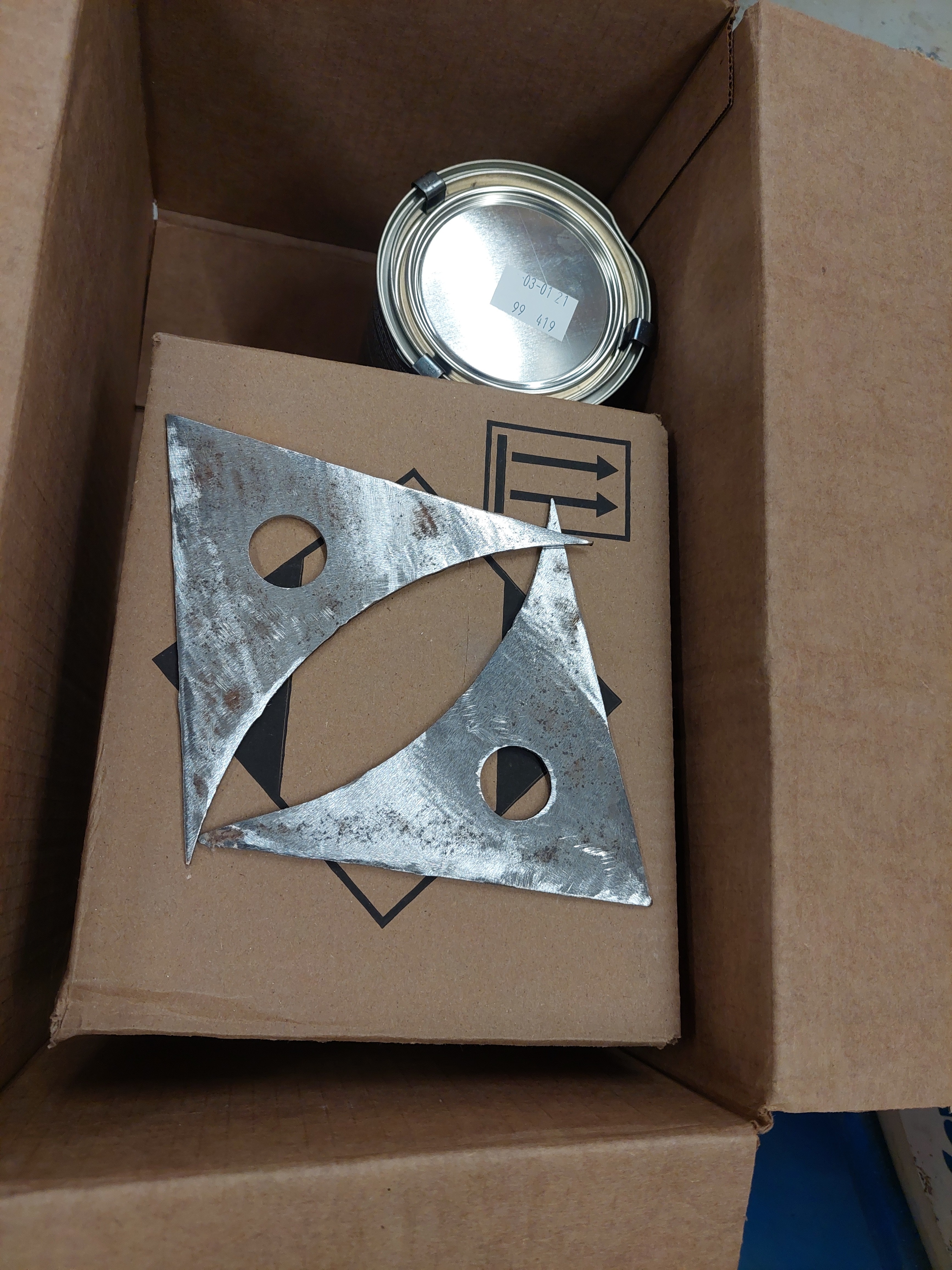

Back to cranking out some chips. Machine is becoming more solid which makes me think some of the plastic relaxing may have been a lot of my struggle up to now. I ran probably 3 hours in aluminum and another hour in steel before the bit gave up. I replaced the bit and it went through this 2mm steel sheet metal easily.

Here are some pretty gussets from 0.090 carbon sheet. I think I have a little break now so I may take a look at accuracy and precision in metal to see where I am at.

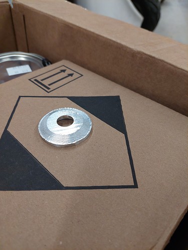

Here is the result of my latest efforts. 1/2" aluminum cut in 3 x 4.5 mm trichodial passes and a single finish pass. Measured within 0.0015" true to design.

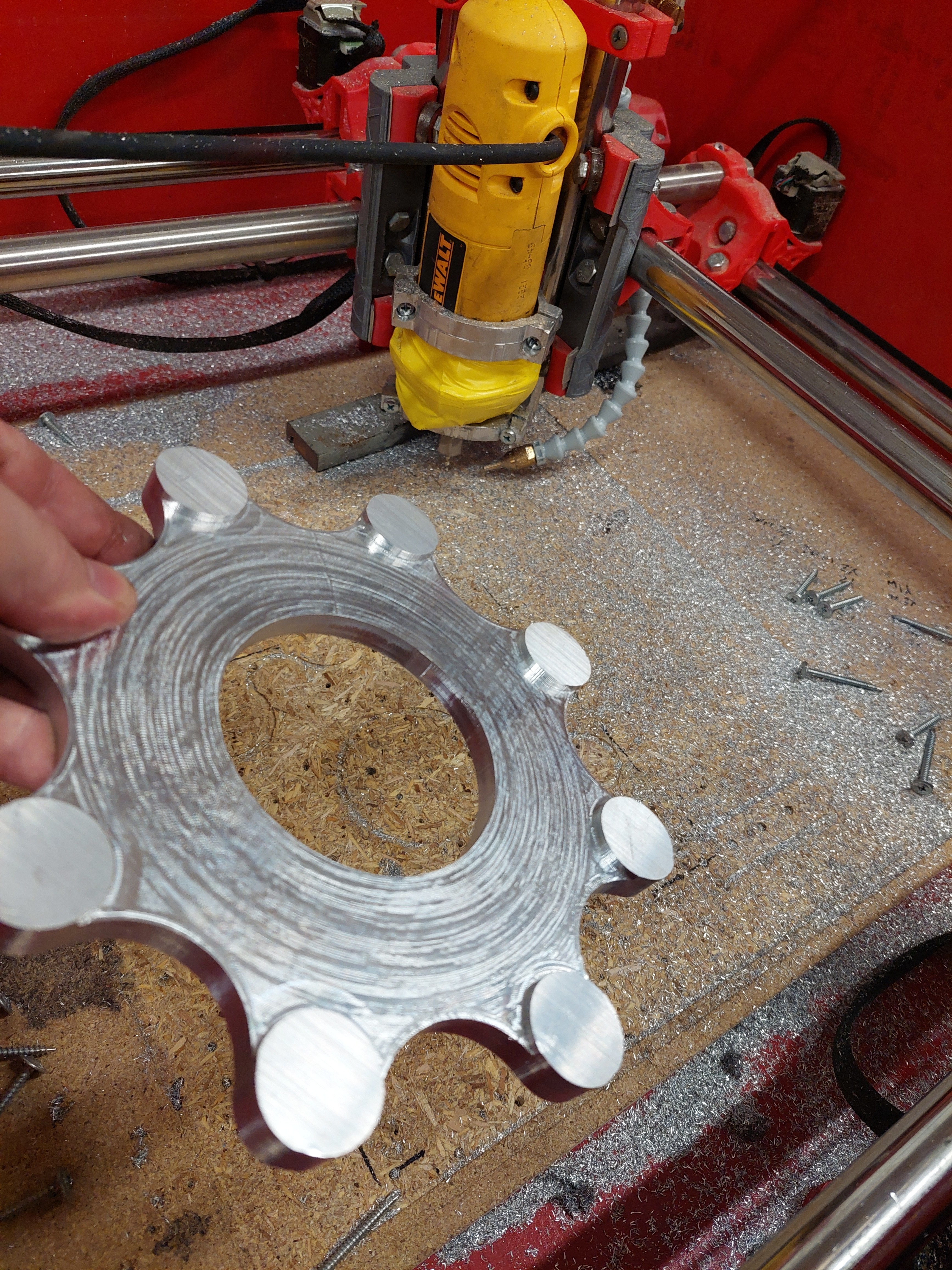

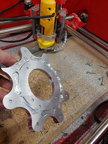

The almost final part. I will drill the holes I centermarked on the drill press and tap the 8 holes on the outside. Hopefully tap threads on the machine someday. I had to post since it came out so well. I am about half way through a duplicate part. Roughly 2.5 hours on the mill total for part. I submitted instructions to Ryan on my recipes so others can duplicate. Once I knew what I was doing, a $15 tool made it go.
Secret #24,
I create a program to “draw” a 0.5mm larger envelope of the exterior surface. So when I flip the part I dry run the program over and over until an end mill can track all the away around the part with router turned off and not move it. Then I lock it down with screws and start cutting.

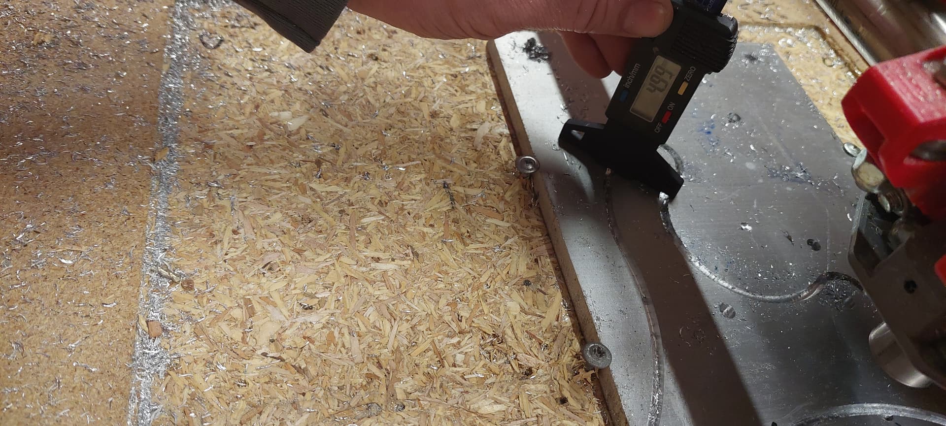

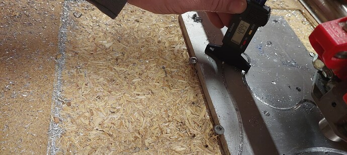

So I started measuring the out of roundness on these parts and found they are all crap. At least .030" out which is not going to work with this part. All trash. Unless I work on a way to center them up. I was surprised since must of my other stuff looked good.

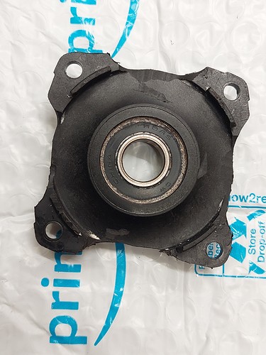

I have not posted in some time, but still hammering my MPCNC. I got the DRO squaring opertion working better. I will post a video next time I square it up. Blew out my 2nd bearing on the DeWalt to decided it was time for an upgrade. It is replaceable, but i prefer a little more durability. It just takes too long to troubleshoot when something is off. Plus many of my programs take 2 to 4 hours which is too much to eat or repeat if there is trouble.

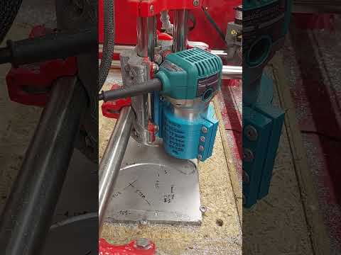

So I went for the Makita RT700. I went through the entire machine checking torques and friction. Had a few cracked leg mounts I replaced. Found a heavy duty mount design for the router on Thingaverse. Not the best design but I made it work. And it is solid. I think the router mount is the most critical interface in the MPCNC. I struggled with Flexing and loosening from vibration with DeWalt mount until I replaced it with aluminum.
So far I am happy with the Makita. The 1/8 collet has loosened up a couple times so I have to apply a lot of torque to the nut to hold the end mill. I think this will get better over time. The router mount also loosens but when it does it only allows the router to rotate, no flexing. And it takes 5 seconds to check and fix it needed. Again, will get better with time. It runs quieter and the extra power seems to keep cuts a little more consistent.
Ran a 2.5 hour program tonight with little oversight. 5mm tri cuts in aluminum. I hope the bearings hold for out for long time.

The DeWalt bearing was molded into the mid-plate so you had to replace the entire thing at $25. I almost took a shot at redesigning the mid-plate to accept a replaceable bearing but in the end decided it was not worth it. I wanted the Makita for the variable speeds and 1/4" capacity. Looking forward to playing with that. I have some 3mm steel sheet cut outs as the next project.
On a side note, i kind of gave up on the rotating aluminum parts I was working with in previous posts. In the end I got down to around 0.008"-0.010" in positional accuracy when making small and big holes in aluminum (which was my target) but decided i needed better than that for the application. Trying to increase accuracy beyond that involves way too many variables. Accuracy of moving the core around with no loads is just slightly less at 0.001"-0.007". So I cant say i am not happy. I have made some other rotating parts that allowed more tolerance since then and they turned out great.
Here is a quick video of new setup.
