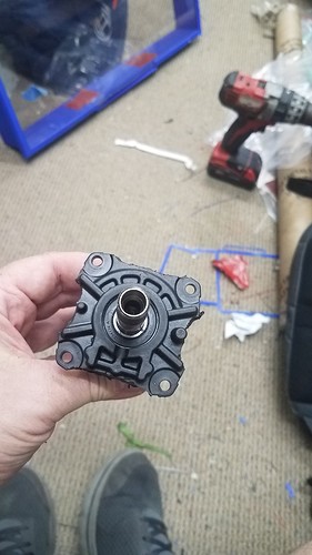

And for my contribution back to the community I found a nice trick to keep the cutting area clear of debris. I noticed the Dewalt 660 blows a tremendous amount of cooling air. I disassembled the head and ground out some cooling ports in the plastic bearing holder to allow the air to flow down through the collet hole. I then taped off the side cooling holes. Some of the air still escapes around the shaft lock button so I added a little tape there also but still allows the button to be pushed. The air blows around the bit keeping everything cool and clear. I shelved my plans for a air purge system.

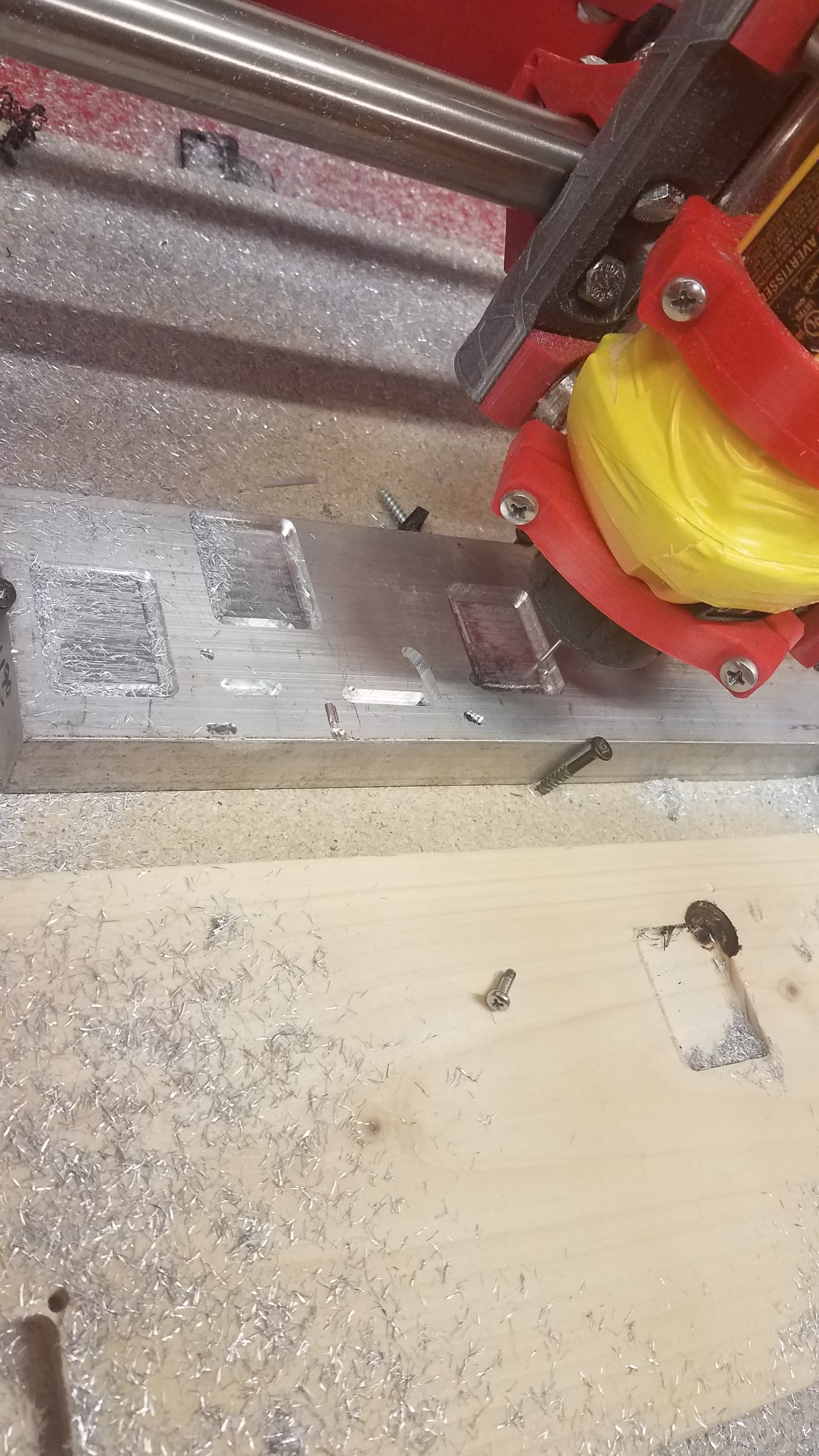

I tried a 3d profile in aluminum and that turned out ok. Think of a small 2" diameter x 1/4" high dome. It smoothed out with a little 100 grit sandpaper. I am curious just how smooth a finish I can produce.

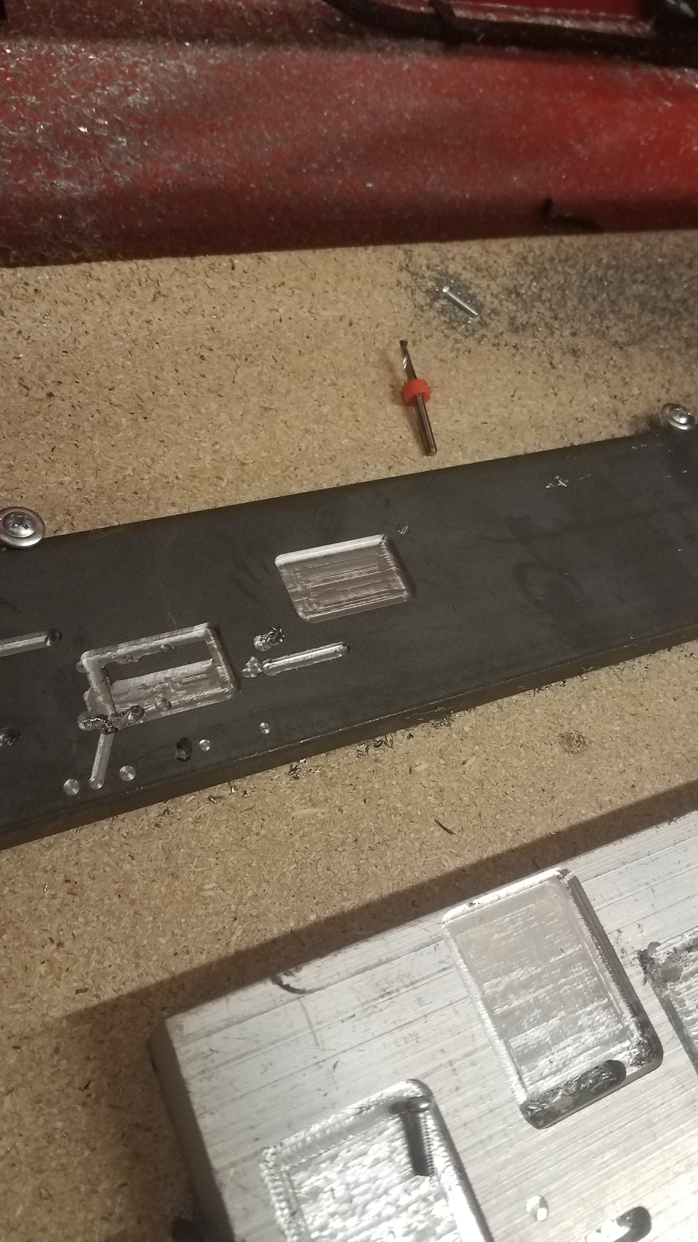

Acomplished my first pocket cut in steel! I backed down the feed until it made chips and then increased steppover to get the chips bigger. So far only 2mm depth. Not sure what type steel it is, looks cold rolled and almost no rust from sitting in my shop for years in the Florida humidity. Definitely trickier than aluminum. Every crash resulted in a dull bit. But once I got the recipe right, it was really smooth and didnt seem like it was loading up the machine that much.
Here are some pics of my aluminum and steel samples. Just trying to get my confidence up to start some production parts. Nothing planned in steel for now, but damn that is seductive.
