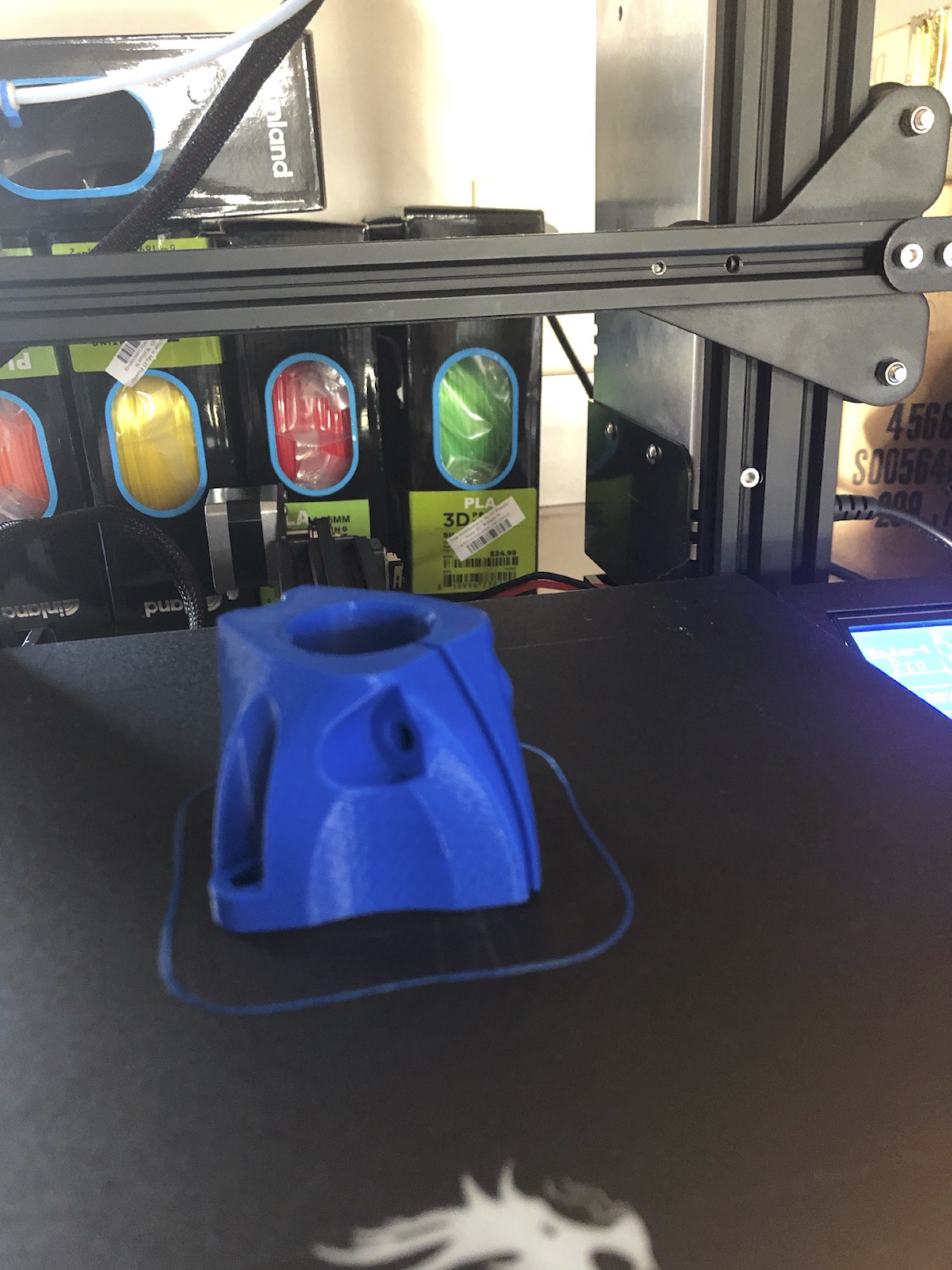

And with that. Here is the beginning of my build. I decided to start with a foot with the Inland PLA+ I bought by mistake.

Second foot printed! So two down two to go.

Kudos on the first foot! My first real print with my Ender 3 Pro was also a foot.
Yours looks much better then mine - I had a serious case of elephant foot (a bulge at the bottom). I got better as I moved through the prints. Yours though looks nice.

I’ve been playing with temp and settings. I don’t claim to be an expert but I think I’ve got a few basics down. So probably enough to be dangerous enough to start thinking I’m starting to know what I’m doing.
I also am printing these with PLA+. I’m not sure if it matters but it seems to be much nicer than the regular Inland PLA.
I now have two done and another printing. I was going to go to Home Depot and get the pipe but couldn’t resist making some more as these looked so good.
Overall I’m really happy with them, so decided to print them all while I have the settings for these right and might as well make them all the same!

Interesting that you can see the infill pattern. Is the filament translucent? Or maybe your printing the infill before the walls?
Or maybe not enough perimeters. Make sure there are at least 3 on the sides and probably 6 top and bottom.
@jeffeb3 what do you mean? I’m still learning, so I’d appreciate an explanation.
@atomist I’m not sure. It’s Inland PLA+. I’ll check when I get back to my office.
In your slicer, you can set hiw many solid perimeters it uses on each layer and how many layers on the top and bottom are completely solid. Each slicer has its own name for that setting, but solid perimeters can often add more rigidity than more infill %
I’m using the web version of Cura on a Mac
I’ll have to check when I get back to my desk what those are.
I don’t know about the web version. But on my cura that is called “walls” and it can be set in two ways. You can set a wall thickness, then cura will take that and divide it by your line thickness to get the number of perimeters. Or you can manually set the number of walls, at witch point it then ignores the wall thickness setting.
For top and bottom on cura it’s call top and bottom layers. And can be set in a similar fashion to the walls.
