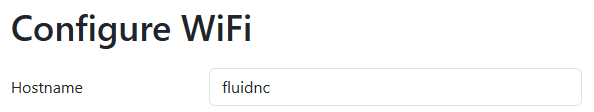

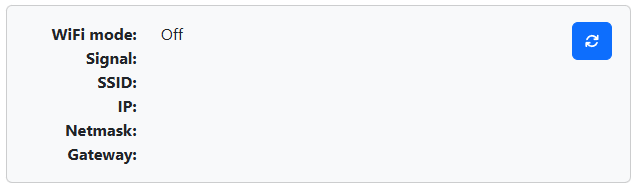

  • Once it refreshes, click the refresh button in this section:
It will update and show you details on how it’s connected. You should be able to access it in the browser by the IP listed (note that it could change in the future). If you use fluidnc.local, that should stay the same. That address is based on what is set as the hostname:
It should show that it’s connected in STA mode with all the details populated.
