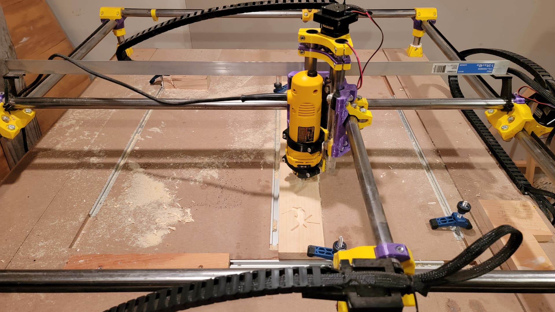

Finished my build a few weeks ago and have played around with it some. About 3 feet by 3 feet, 4.5 inches in workable z height. Steel 1" OD x .045" wall mechanical tubes. SKR v1.3, dual endstops (not configured), and 84oz in Nema 17 motors. Modified the skr and tft case to mount to the side of my table, and added modifed cable chain mounts to fit my chains.
Here are some pics of the build / some coasters I cut out. Just drew a box w/ circles in solidworks and overlaid the skiers on it in estlcam. I also used the CNC to route out the slots for T-Tracks to be inlaid into the wasteboard, but it looks like I’ll have to lower some of them as I ran the bit into one when trying to cut out a coaster.
