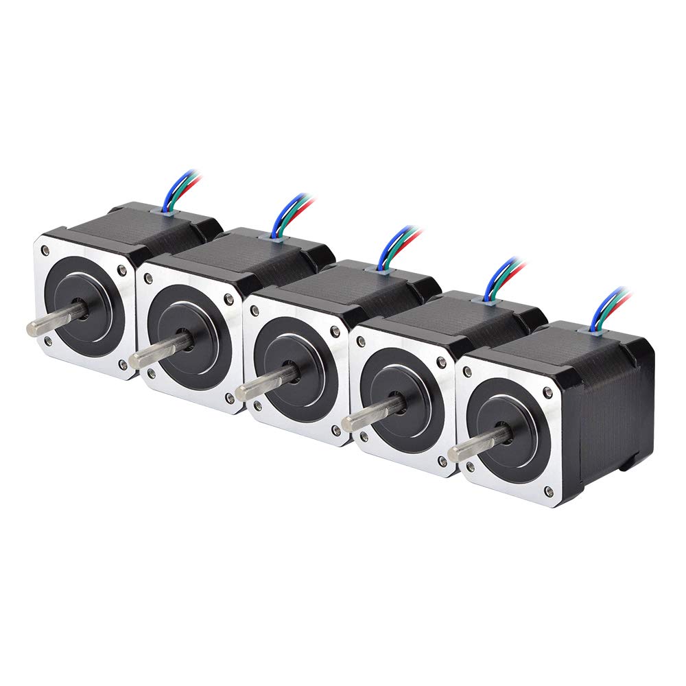

That said, I may have had my first bad stepper. The Z axis keeps giving me issue on one side unless I crank up the power. I checked that everything runs freely and even without the router in and little weight one side often has trouble. I am thinking of ordering some stronger ones, by they are all 1.8degree steps, I believe yours are double that. Do you see any issue using this to replace (in pairs)
There are 94oz steppers but they are longer and would require modification of the plate for the Y axis.
I just don’t want to order a stepper that is not a good fit for the lowboy and mini rambo.
Thanks!
Chris
I use 1.8’s. Just swap out your Z for one of the Y steppers. That does a few things, proves the issue being stepper of build, potentially saves you cash, if the stepper still moves chances are really good it is fine.
You can always just slow down the Z a bit and maybe decrease the Z acceleration. I keep the Z under 10, usually 8mm/s. I will always sacrifice speed for reliability.
