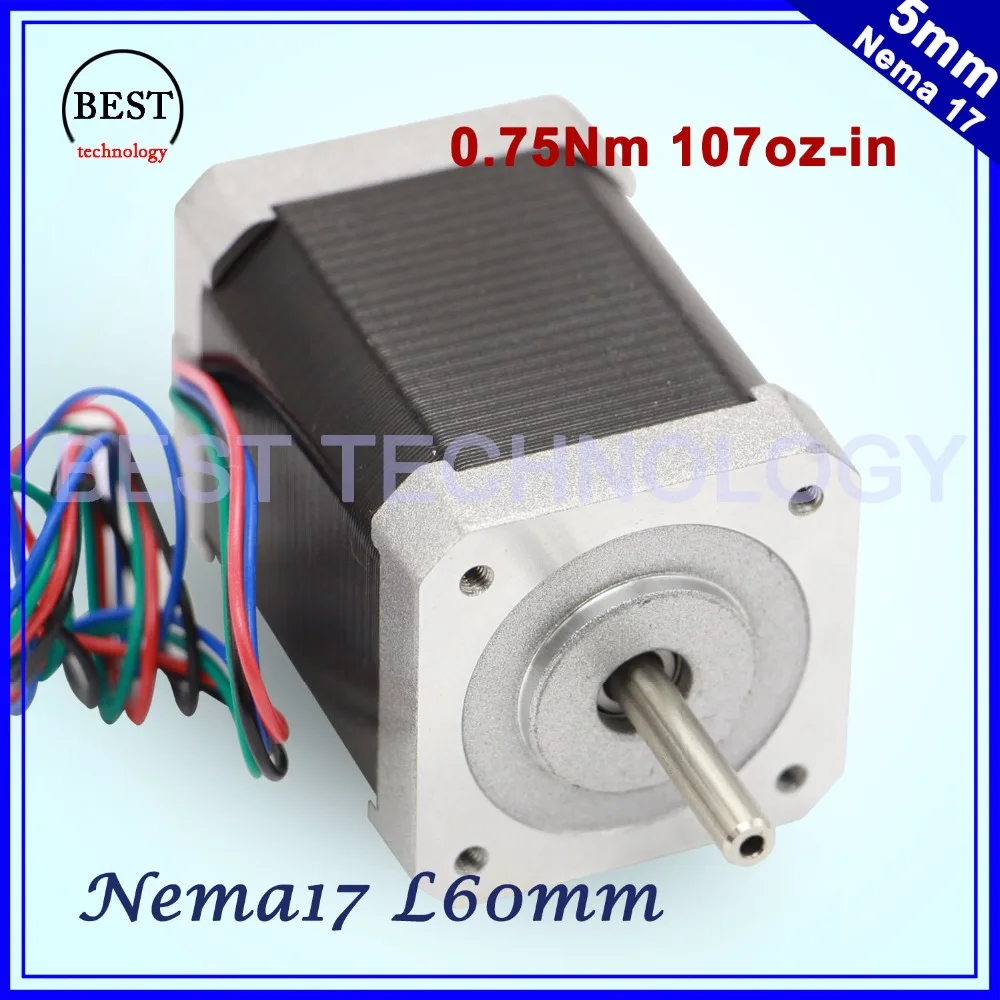

Hi, I’m searching parts for build this great machine. I’ve read most people go for 84oz/in steppers and ramps 1.4 with ads or drv drivers. I already purchased a ramps with drv8825 drivers but I’m in doubt about steppers.
I’ve found this cheap steppers on Aliexpress:
I don’t understand why they are so low Amp rated : 0.6A ¿?¿ and 104oz/in. Maybe a typo from seller?
Does anyone have experience with 104oz/in ? It’s worth go for them? or go for 84oz/in ones?
Sorry but I’m newbie with this …
Thanks!!
Looks like it would just add weight in exchange for unneeded extra torque.
So do you think it’s better go for 84oz ones? My plan is make a machine about 400x600mm work table an put something like a dewalt 600 or a three phase chinese spindle about same power.
my plan is mill aluminum but I don’t need to do it very fast maybe 1mm passes
Pretty sure those of us that have tried aluminum have used the stock suggested steppers. It’s not a torque issue.
My cut area is 350mm x 750mm and the steppers in the kit are fine. Added weight could create flex
