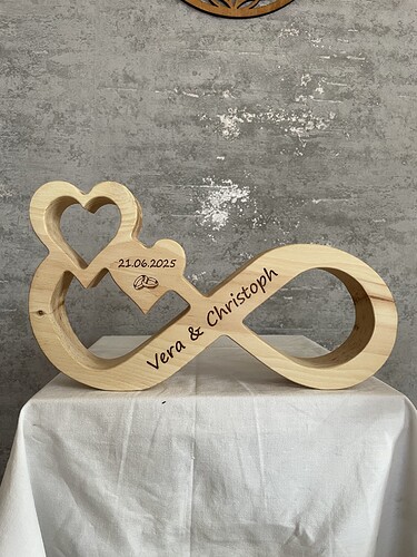

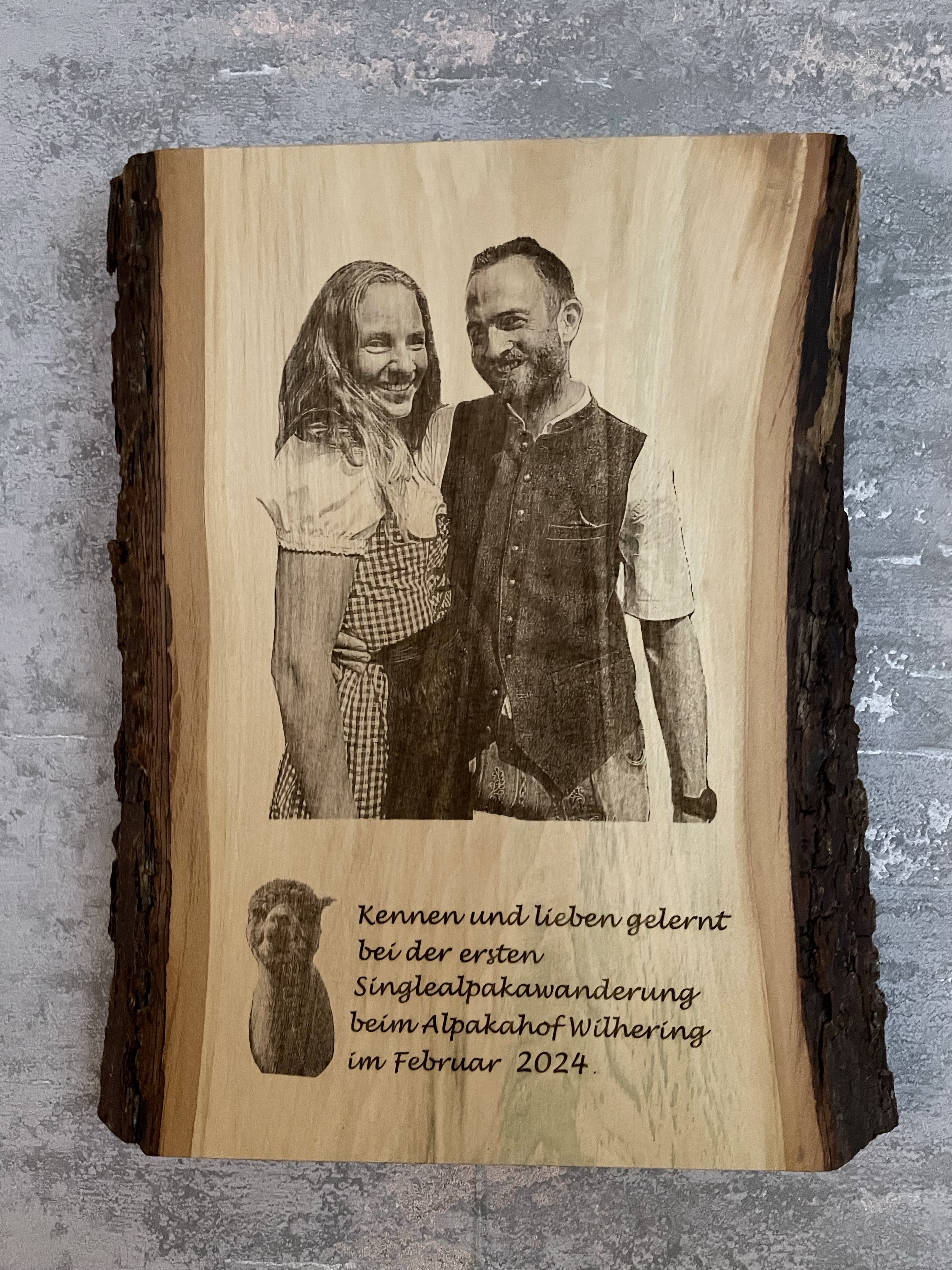

After a five-week break, I finally found the problem and my Neje laser on my MPCN is working again. Here are a few finished parts for you to take a look at!
Bulb approx. 400x600mm 3000/min 24% power 45 degrees
Oak approx. 200 x 400 mm 2500/min 22% power 90 degrees
Swiss pine approx. 200x 400x40mm 3500/min 24% power 45 degrees best regards Gerhard from Austria

Beautiful projects. Nice, dark burn. Did you spray the wood with borax?
Those turned out great!
Matt varnished without any pre-treatment!
