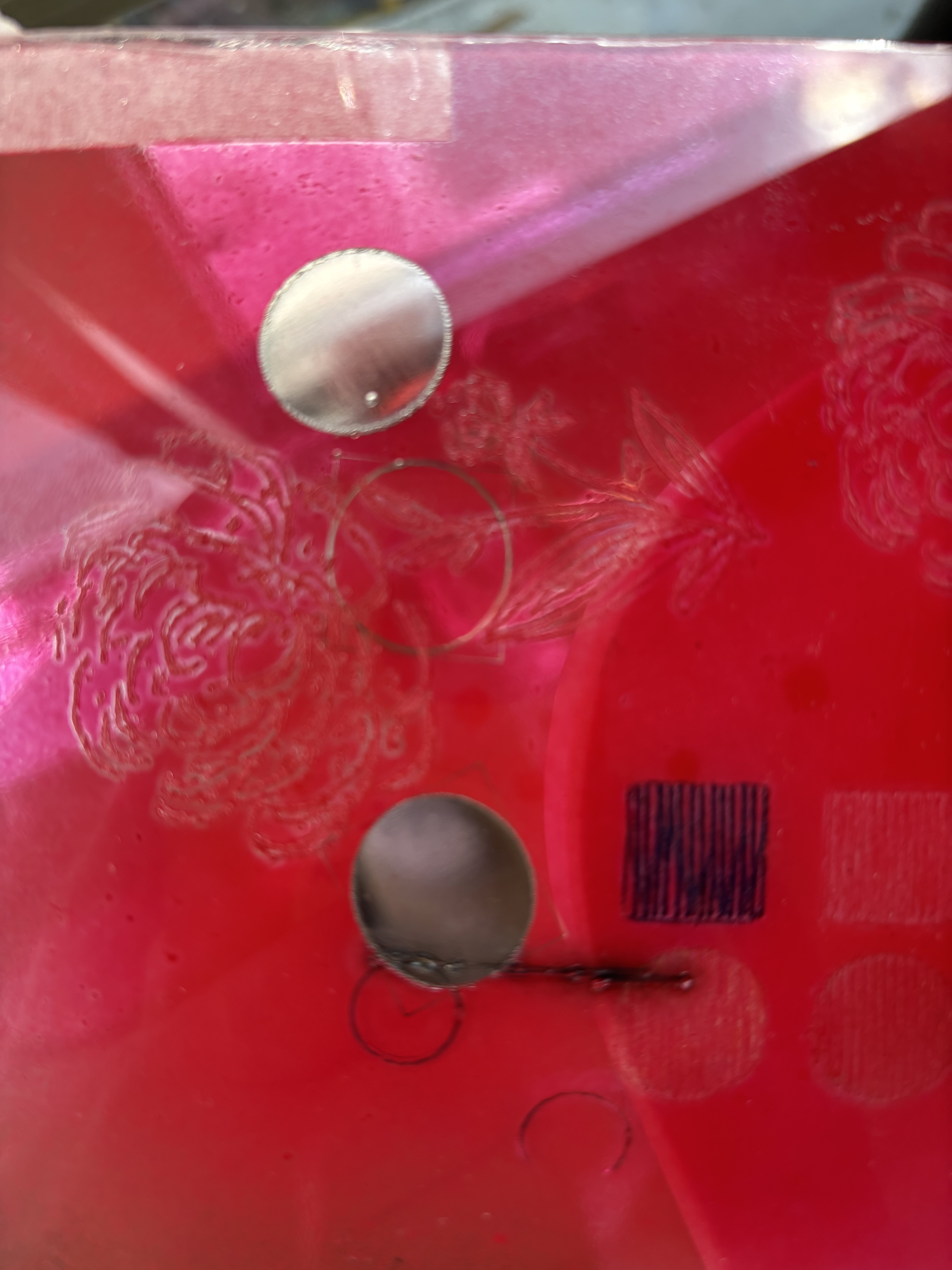

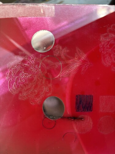

I’m trying to laser-etch transparent extruded acrylic using my NEJE A40620 diode laser (blue laser, 450 nm). To make the surface absorb the laser, I painted it with red automotive spray paint. My settings were:
Power: 8%
Speed: 6000 mm/min
Passes: 2 (front and back sides)
The laser successfully removed the red paint, but it did not etch or mark the acrylic surface underneath on either side.
I understand that clear acrylic doesn’t absorb blue light well, but I was hoping the paint would help. After reading more, it seems red might reflect too much of the blue laser light.

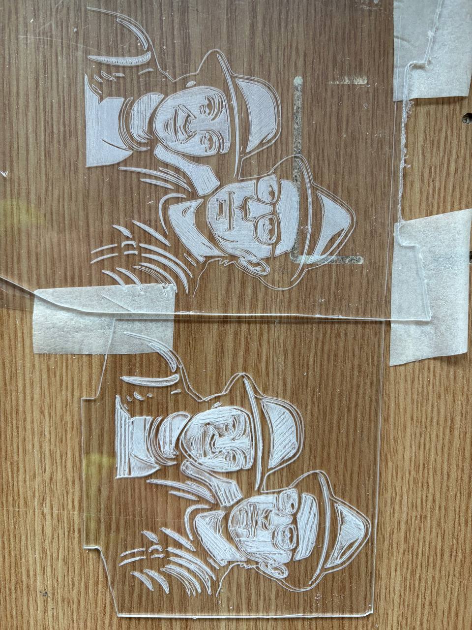

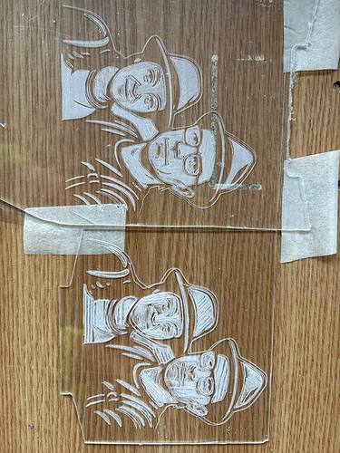

I have seen videos like this before and tried it my self. I was not able to achieve the same results as they were. I might could have gotten it with a LOT more trial and error. But acrylic isn’t cheap so I just use a Diamon Drag Bit on the LR4 and get what I need. Not as fast as a laser would be, but it works and its quite lol
Hi @Jonathjon !
I use the drag bit also, it works pretty well with vector, but not with bitmap(
My etching:
That seems like a software issue. You could just convert it to svg using inkscape (easier said than done, but possible with most images you’d want to etch).
Since he is wanting to use a bitmap image I assume he wants more than just black and white. He is wanting the gray tones as well, which the laser can do. The drag bit not so much. I could be completely wrong though.
