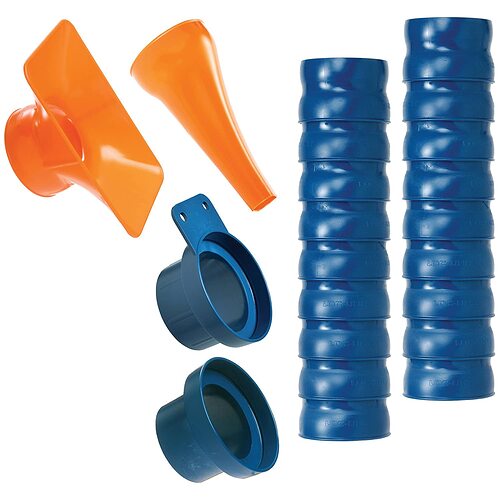

One question if any of you guys know⌠I am trying to looking up and find something that I can attach the hose/dust hood too that would be positionable - I thought there were things like like that for welding, etc but I have no idea where those things are called. Basically something that you mount and then attach the item you want to position and you can move it around to the position you want and then lock it in.
Something like this?
https://www.amazon.com/TOPPROS-Plastic-Flexible-Coolant-Adjustable/dp/B08KXX7DP2/
I searched for adjustable coolant hose.
Boom microphone stand? I come from a theater background so like to look broadly for retaskable solutions.
I found this but after my test today the fan I bought isnât powerful enough.
