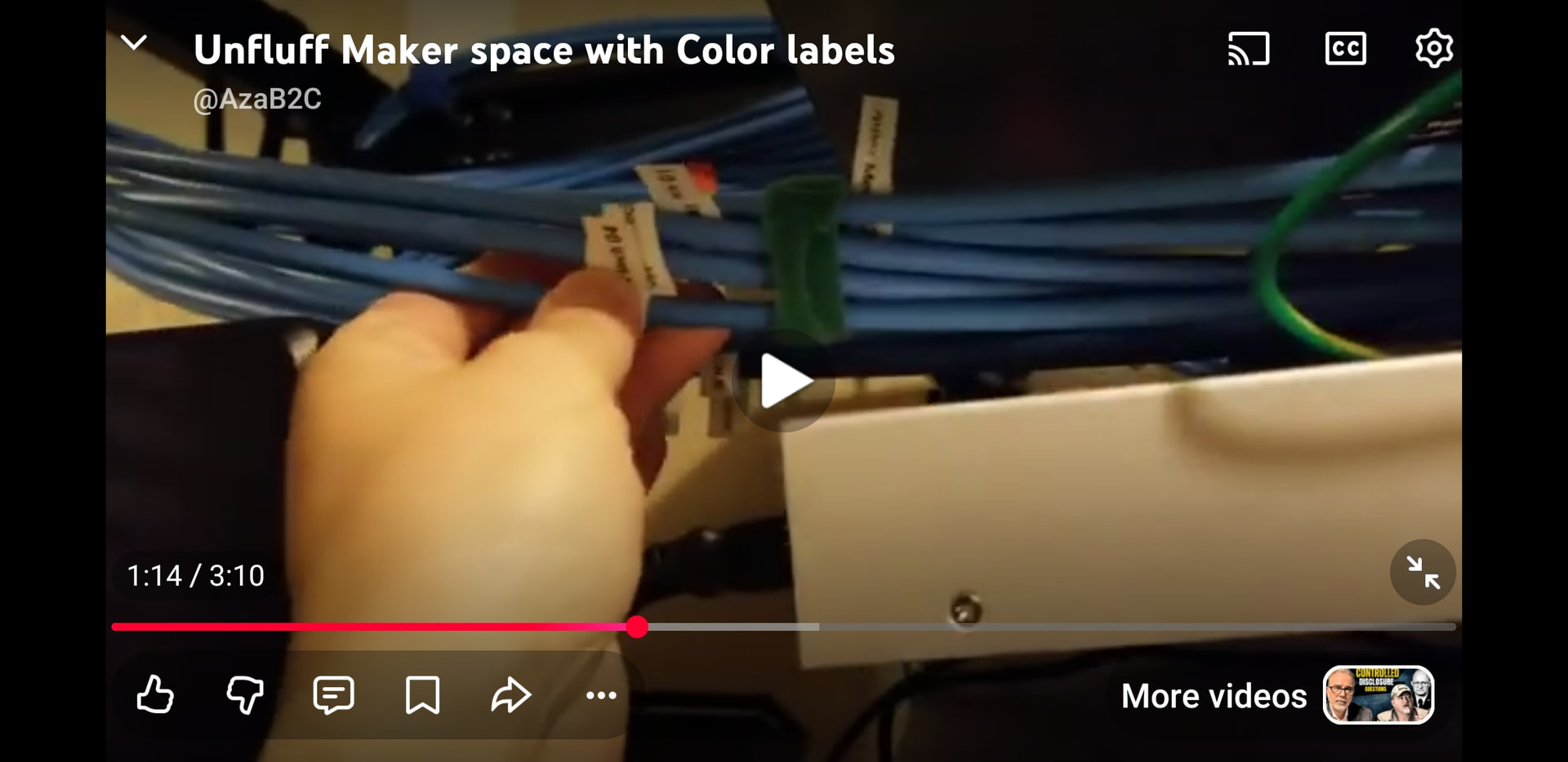

My 18mth old Brother P-Touch label maker has been useful, only used occasionally to unfluff and organize my setup. Didn’t realize until your topic that Heat Shrink Label Tube cartridges are available. Would’ve been neat to have discovered heat shrink labels before crimping 20-30 cat6 home runs to the router. On the plus side, the regular labels flappy tags are easier to finagle and read imo.
Also, Brother’s SDK/APIs have been fun to mess around with…
I think flag style labels are great for things that need more than a few letters. But for things like “Y MAX" in a tight space, it would be cleaner over all…. That’s the thought process anyway. I don’t actually know. But my old Brother P- touch have me years of service until it just said no more.

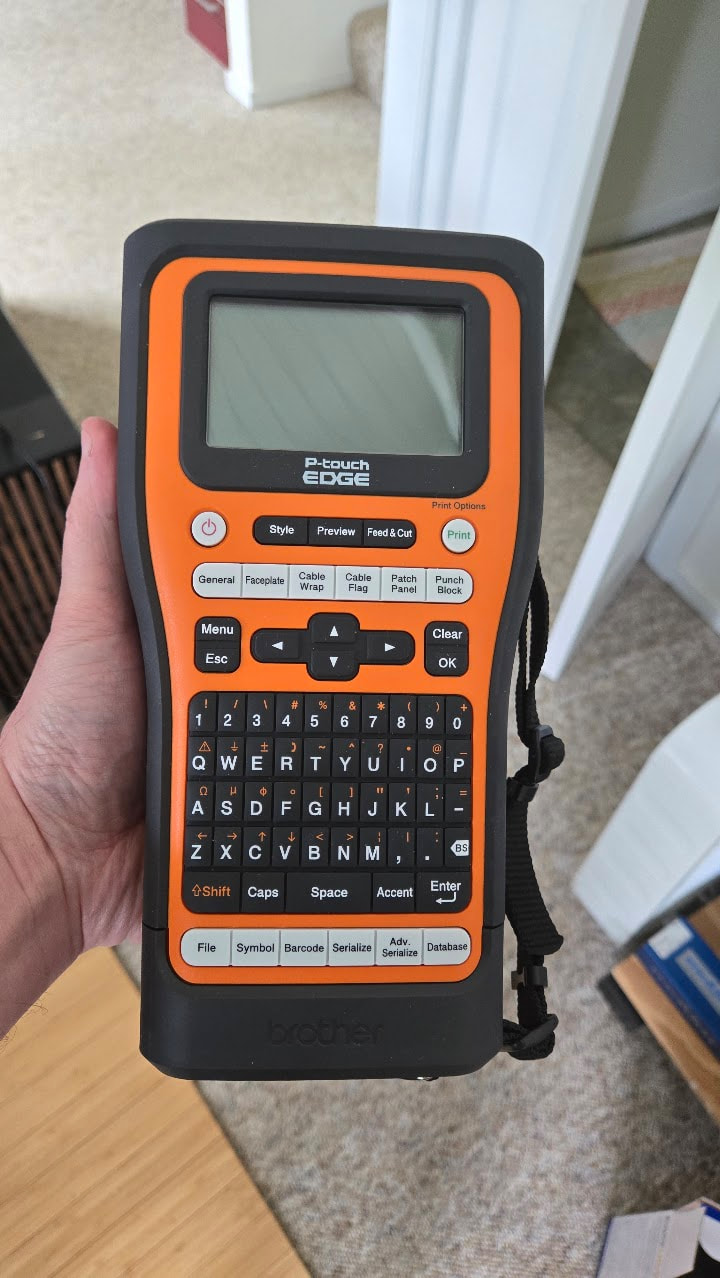

I have a Brother label maker that does heat-shrink labels.
It’s an older version of the PT-E560BTVP Electrician’s label maker.
I guess depending on how much use you’re planning, the heat-shrink labels get pretty spendy, especially if you need multiple sizes. I’ve tried the knock off label maker cartridges before and never really got a satisfactory result but, to be fair, I haven’t tried the knock-off heat-shrink ones.

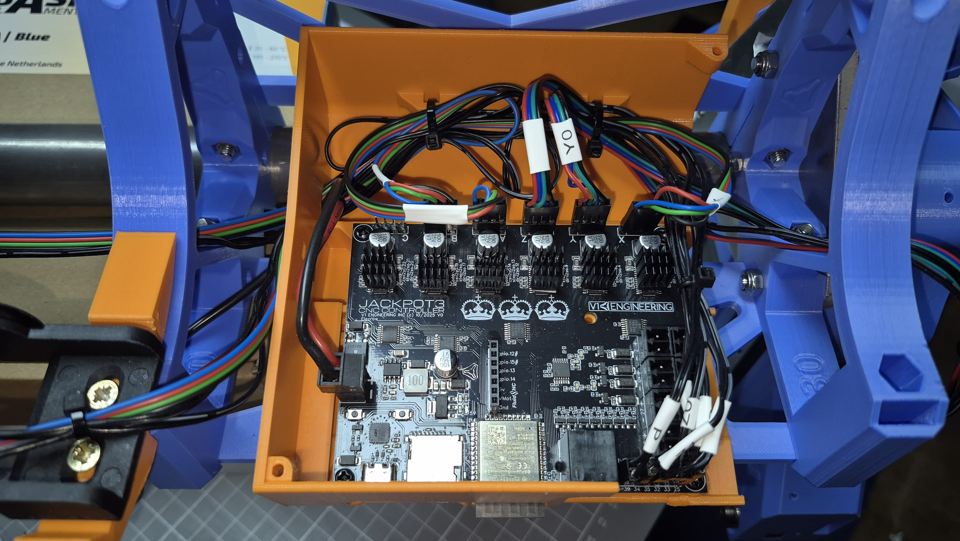

My issue has always been the US$40 a roll or whatever it costs here, with a roll being 1.5m / 5’. Works out to around $1-3 a label depending on size and how many you’re making at once. My preferred alternative in the end was to just use the regular labels and then put clear heat-shrink over them, if you want them to be axially printed. In most cases I end up just printing them and putting them on as flags, though, just because it’s easier, especially for labeling after install. My main switchboard and so on are all done that way, as are all the cables and connections in my MPCNC, pick and place machine, etc. I still really like the standard Brother labels because I’ve had good experiences with the sticking well to cleaned surfaces and lasting outdoors, even in a port/salt water environment. Getting a cheaper label-only printer and the proper label cartridges plus some clear heat-shrink would realistically suit my usage better.

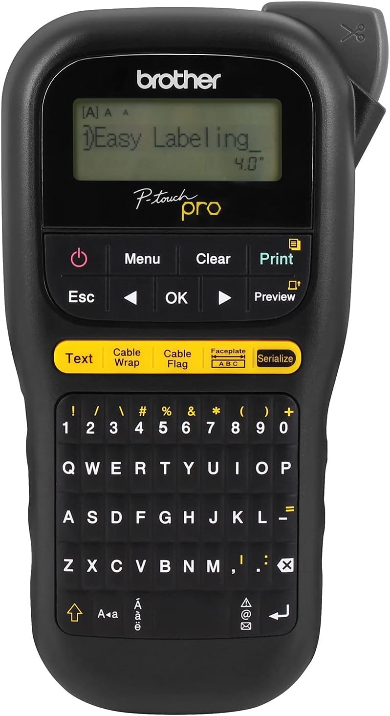

This is what I’ve used for years. I use it with these small electronics all the time without issue. I’ve never tried the heat shrink tubing because I’ve never seen a need.

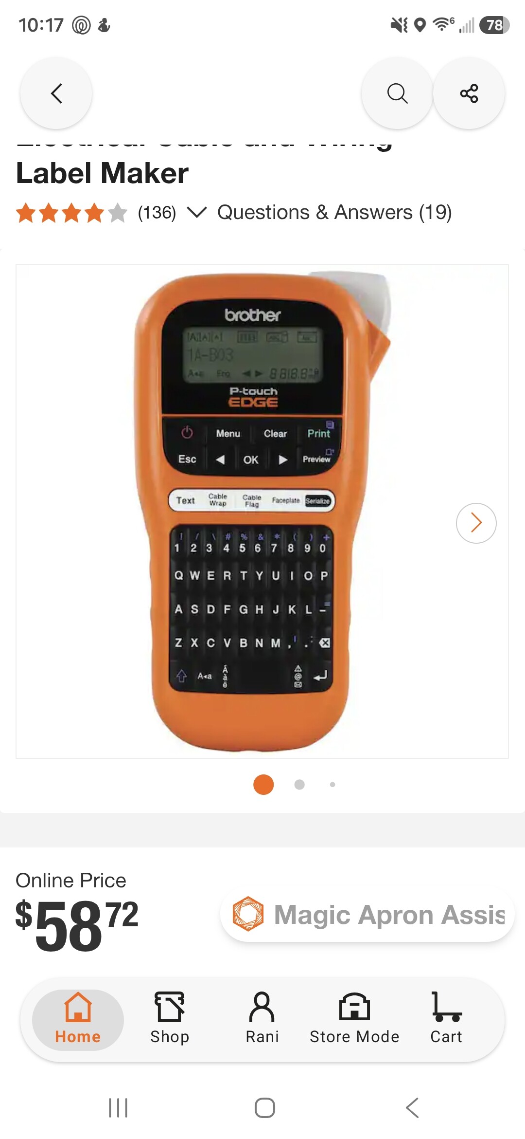

Yeah. That’s the one my coworker uses and recommended. I can’t justify the cost yet, but it’s on my wishlist…
https://a.co/d/03ShFJ4t
I almost pulled the trigger on that one’s little brother at home cheapo today

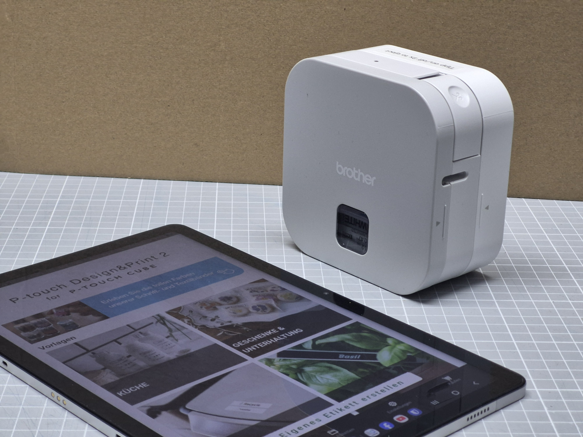

I went the cheap way:
No keyboard, no screen, you need your phone or tablet for it.
Is it good - nah, not realy, but it does it’s job.
Heatshrink worked fine with it:
