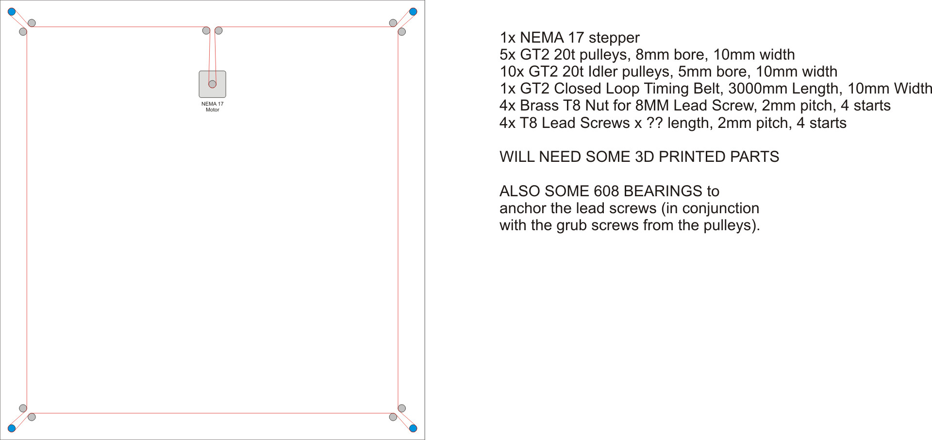

I’m in process of making a laser enclosure, and I have the wherewithall (parts in hand, for most of what is needed) to give it Z-up & Z-down buttons for raising and lowering a cut bed, independently of the control board. My big 100w CO2 laser has these kinds of buttons, and I find it tremendously convenient and a wonderful feature. The buttons don’t raise or lower the laser gantry, but rather the bed.
However, I need tips/advice for how to wire that to happen.
My rudimentary thoughts are: the stepper is DC, so I need a way to get DC power to it, whereas the incoming power is AC. Also, my general impression is that one of the two switches would complete a circuit on one of the wires (but which?) and the other of the two switches would complete a circuit on another one of the wires (but which?).
Finally, I have no idea how the existing Z system on my big C02 laser manages to keep the bed in position even while the power is turned off. What keeps it from falling down? Is it just friction because all the lead screws? Is there some kind of ratchet system?
I would surely appreciate any help and advice anyone can give. Thank you!
PS: in the diagram below, the blue dots represent lead screws (my plan is for T8 lead screws, 8mm diameter, 2mm pitch, 4 starts), and the red line represents a 3000 mm long GT2 belt, that is 10mm wide. The corner pulleys have teeth and grub screws, and the two “near” idlers for each are smooth. I welcome advice if this seems unworkable.

There will be sufficient friction in that belt drive to hold the elevator without any power to the motor. Your diagram should work but you might want to add some form of sprung loaded tensioner in the belt to keep it taut.
SNAP!
I agree with your drawing, and previous comments as I have run across this while diving down other avenues similar to your use case. So I know the concept is spot on.

The challenge for me (mentally) and what I never googled was where to find a continuous belt, or how I was going to join the two ends together (being I’ve only played with a “flat” belt, fixed in printed parts). Obviously a flat belt could be used if z travel is small, and the printed part traveling between the idlers, was the extend of travel from top to bottom of the lead screws. (Aka: how would a printed part even with TPU travel across the toothed gear). I made the assumption that a continuous belt, would dictate the distance between lead screws or the overall size of my z lift table. The other option I thought off, if belts were going to be a challenge, was the stepper motor with a small gear, driving a much larger gear in the center of the z table base. That larger gear would drive four small gears, one at the base of each lead screw. It would eliminate belt tension as a challenge, and or the continuous belt. However it would add other challenges (at least in my mind), like gear ratios, and I walked away, and side tabled the idea for now. Also would dictate more of a square shape, without adding more gears. But without sitting down and doing the math, I think if all five small gears were the same size, ratio shouldn’t be a factor, it would be down to force. So your drawing and other comments match (IMO) what is already available for purchase.
My gridbot has a continuous loop of GT2 belt that drives two Z 4-start leadscrews. My bed is a lot lighter than your laser though, probably.

The drawing does not show the slots that are to allow moving the motor position to tension belt.

As for what’s keeping our bed up, it’s just the stepper motors that are geared down and used to drive the lead screws. No other mechanisms. I’m guessing the combination of correct number of starts on the lead screw and the gear ratio to the steppers would do it.

You can play games with ratios and the number of starts on your leadscrew. A 1 start needs 4x the rotations for the same linear movement, but it is 4x more force for the same torque. That is a simplification that ignores friction (which is significant). If you can get the nema17 to overcome the friction of a 1-start screw and you are ok with it going a little slow, then there is a high chance it will work.
