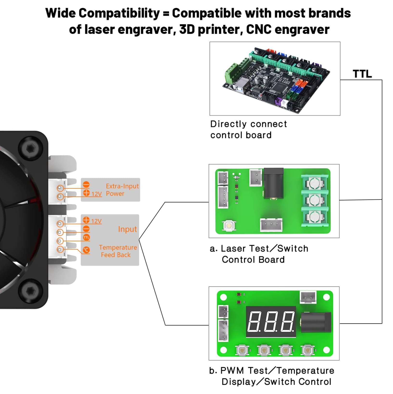

I finally got myself a NEJE A40640 module and I am so happy. Haha. Thanks to this forum it was easy to pick which laser module to buy and here I am now, with a bunch of configuration and wiring to do!

These are the modules I received with my laser:
Seems kinda straight forward, but I need some guidance with the firmware :slight_smile:

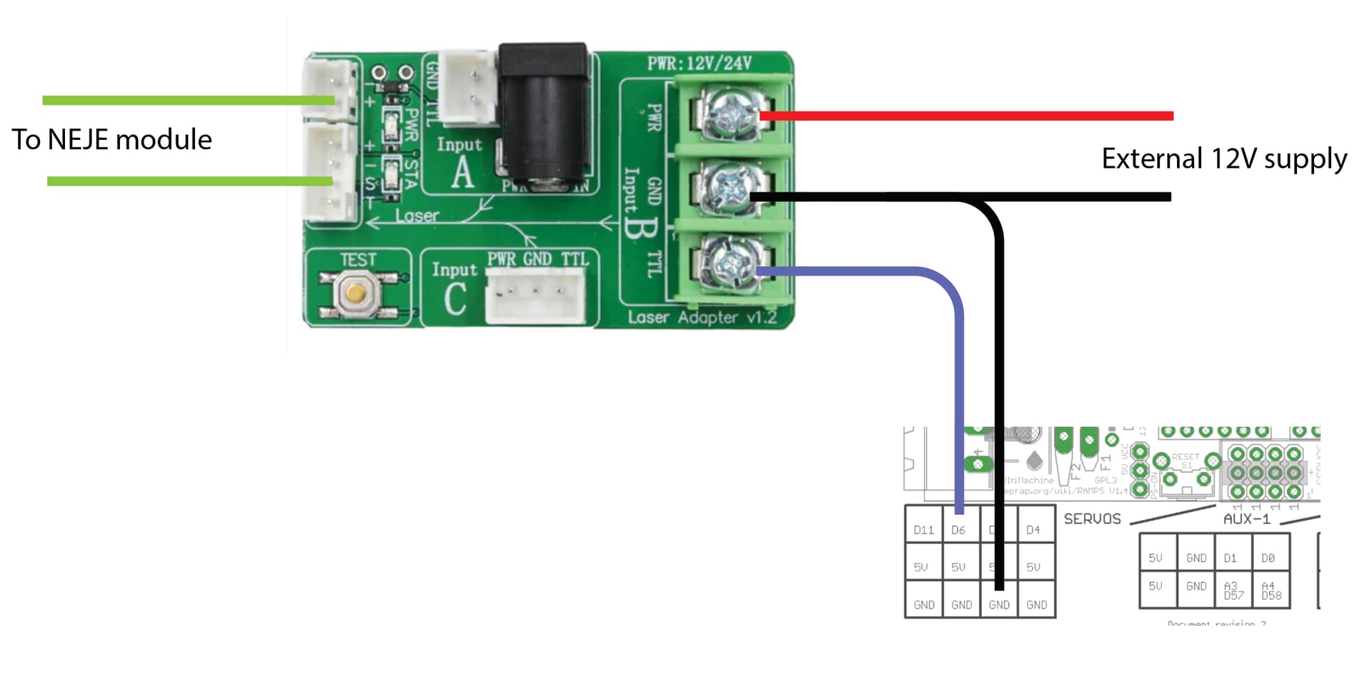

This is my wiring:
Do I use the correct ground? Maybe I have missed something else.
Does the laser pulse if you hit the “Test” button on the interface adapter board?
Yes :slight_smile:
What RAMPS pin is the adapter board PWM pin connected to?
If I recall correctly it has to be pin 6…

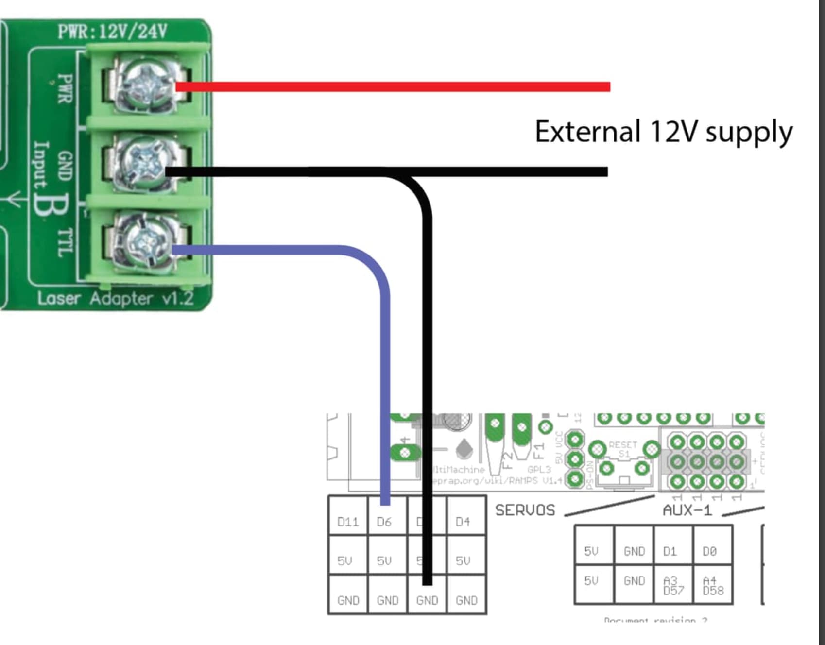

Signal goes to D6, like attached picture.
I have just tested the PWM port with the multimeter and the command M42 P6 S255 and I get different voltages depending on what value send.

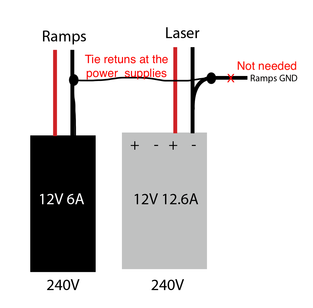

Try connecting your GND pin on the laser adapter directly to the RAMPS incoming board power return.
Not sure what else it could be.
Edit- if you have dual power supplies you should jumper the returns on both. Disregard that part if you only have a single PS.
Okey I will try that. Will report back when I have.

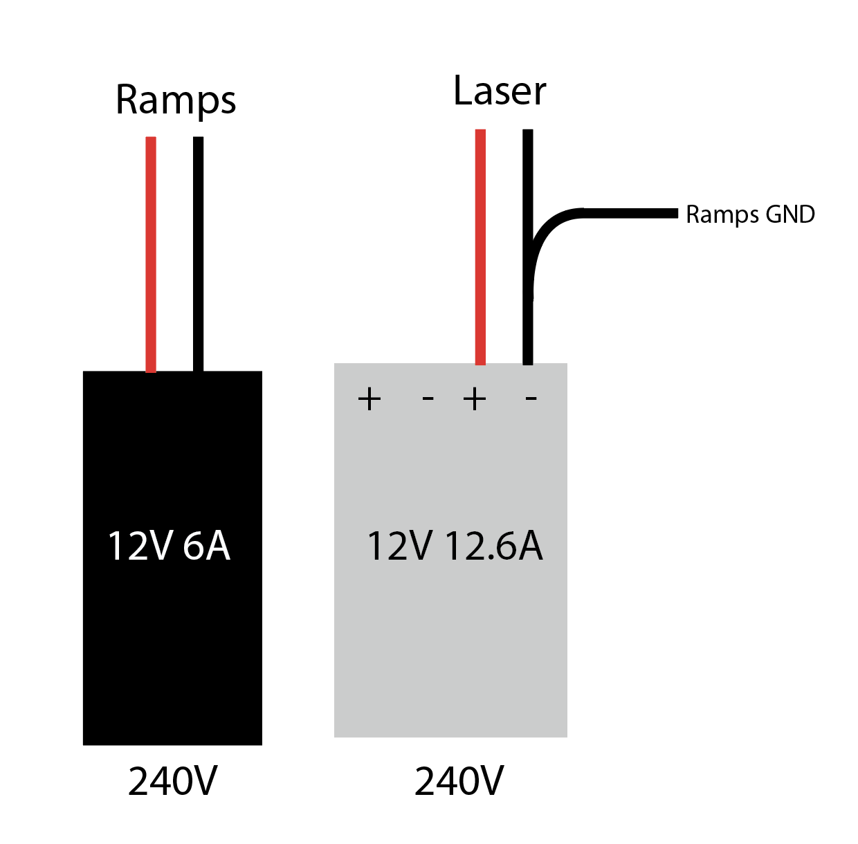

I have a power supply for the Ramps/Arduino and one extra for the laser. Should I wire them differently?
If using dual power supplies, the two PS returns have to be jumpered together.
Hopefully that solves it for you.
hmmmm, the PS I have for the Ramps is 6A. Maybe I should just use that one and scrap the separate one?
12V 6A gives 72W and laser is 10W. Should be enough for steppers too?
How big is the laser PS?
The A40640 is 10W of OPTICAL power out, which needs at least 30-40W of electrical power in.
The laser PS is at least at 120W. Don’t remember at this moment.
How do I actually bridge the returns of two PS?
Last time I did this, I just ran a 12 AWG wire between the two PS. The wire had a ring terminal on one side and a fork terminal on the other side, but that was because of the terminals on the power supplies.
If there aren’t multiple return terminals on one power supply or the other, you can turn ring or fork terminals upside down (one up, one down), to fit more than one terminal onto the PS.
Or, you can make a harness that splices things, or use terminal blocks to splice things.

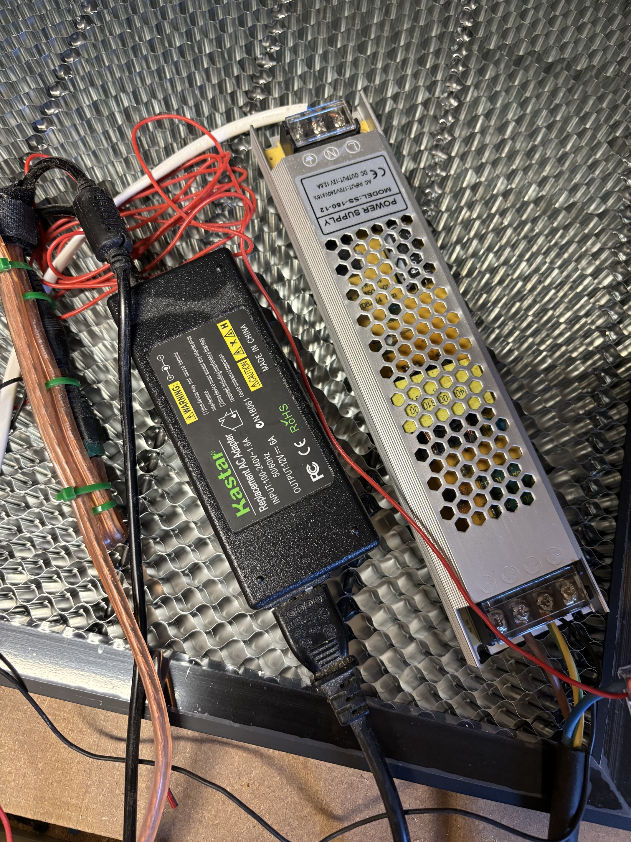

A picture of your setup will help advise you.
This is the current setup I have. :slight_smile: What changes should I make? I am really grateful for your help!
Or to be more clear. This is my setup :grin:
Edit:
Laser power supply is beefy enough to make that the only PS in the system.
That’s an option.
Cool. Then I will go with only one PS for everything. Thanks! I will try that and see how it works!!
