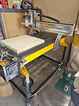

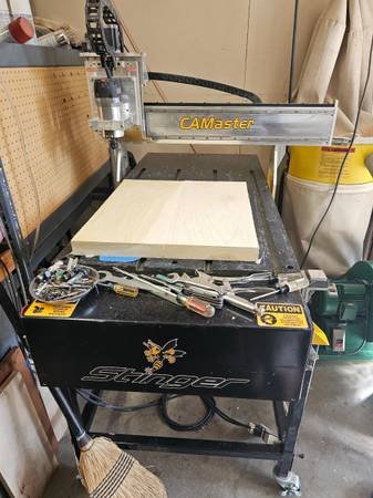

He has an older commercial machine, a Cam Master Stinger 1. He paid like $5-6k used.
Looks like a beast to me but I have no knowledge of those machines. I guess it is not functional, and was proprietary and they went under. So it’s just sitting there.
He was looking at a Grizzly CNC ($7,000!!) but I told him (politely) to please try a LR4 or I’d give him my Primo and tweak it.
Questions:
  1. I’ve seen some V1 folks that also make guitars. Can they jump in?
  2. I suggested we try my LR4 to cut a body and see if it works. He has the files.
  3. I am not sure, and this is NOT a V1 item but I would think he could retrofit his Stinger with open source control? I think they are NEMA 34 steppers??? Make any sense to try?

Get pictures. I"ll bet something like a Doberman CNC controller and external stepper drivers would run that machine.

I do believe it could be FluidNC converted. Plus I think a LowRider would be a fit for that use case.
Thanks @MakerJim. It told him he would be impressed by the accuracy. He agreed to try doing a cut on my LR4 which is a 2’ x 4’ perfect for his needs. I would love to maybe build an electric but just to many other fun projects get in the way :grinning_face_with_smiling_eyes:
He feels the rack and pinion is just a little too loose on his Cam Master. But I would think that could be adjusted or even replaced.
I think the steppers are 23? If that makes sense.

On most of the rack and pinion systems I’ve worked with, the stepper motor/pinion gear are usually on some sort of slotted mount for the stepper motor where you can adjust the slop in the drive by loosening the 4 stepper mount screws and pushing the stepper so the pinion is tight against the rack, then tightening the mounting screws.
Can you get pictures of the stepper/pinion/rack alignment and mounting?
