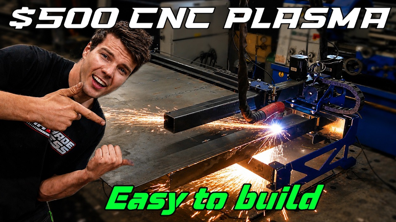

The Dutch guy created a pretty neat Plasma:

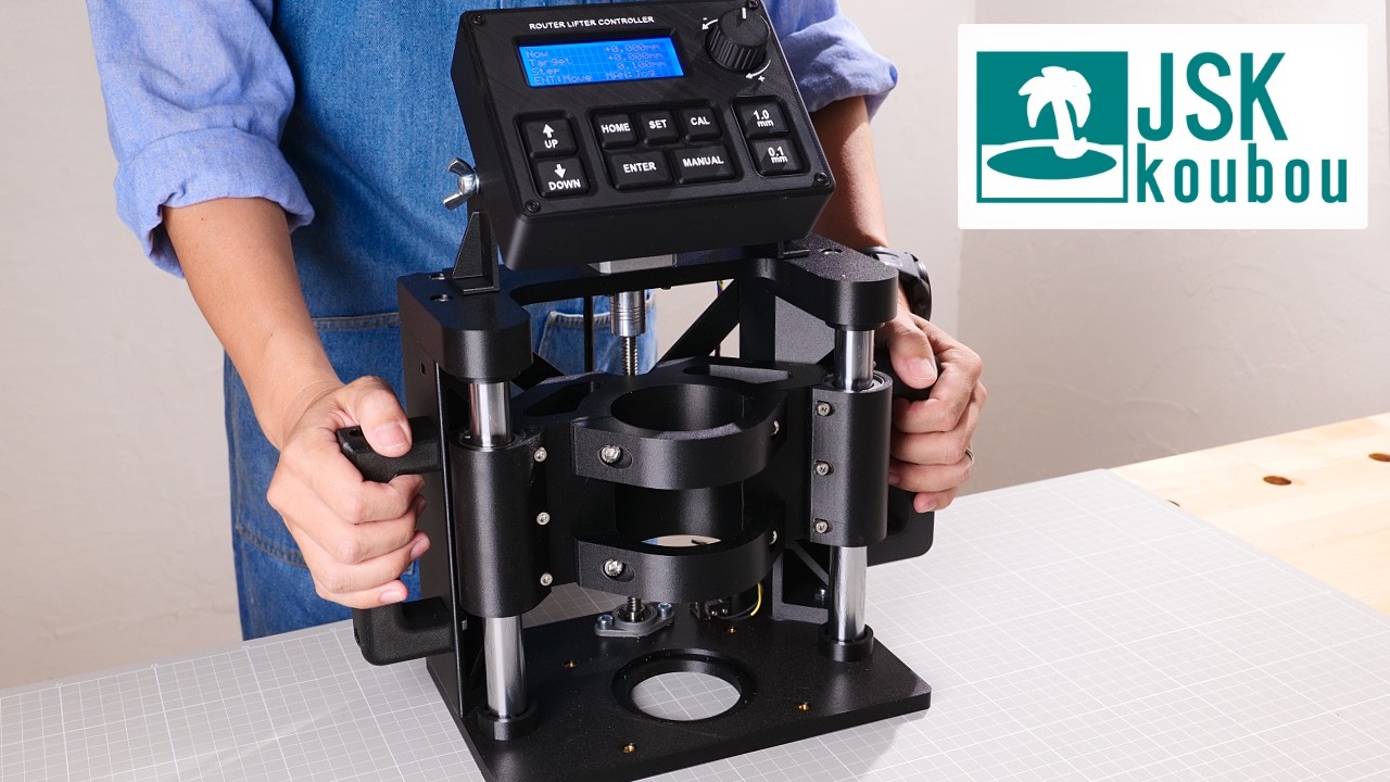

Pretty robust DIY router table lift
Oh, wait for Shaper Origin’s call… :smiley:
Whoops, shouldn’t have gone by the thumbnail… :stuck_out_tongue:
That is what I thought at first glance too, but no just a lift.
i came across that video a few week ago , i do like the way it folds up so compact , its on my bucket list :slight_smile:

Kinda want to build one of these now. I don’t have the shop space for another huge machine, but if I can fold it up, that’s a great idea.
You can just slap a plasma head on your LR, the issues show up if you need Torch Height Control, then you need a ROS like linuxCNC and that needs a more complicated Mesa Control Board system. Topics tagged plasma, mine is the gold control box.
Yup, I was watching Dougs videos on it. But I have the LR4 on a wooden bench… and just made such a pretty spoilboard. LOL
You can run it full height and just add a small water tub or metal stand off. The plasma is only ā€œsharpā€ for a 1/4" or so. Easy to protect a surface from.
The only thing that shocked me was how much smoke there is if you are not running a water tub.
The black powdery balls of metal all around are what got me.
Could be a relatively straightforward thing to do as an external addon that just breaks into the step/dir lines for the Z axis. Would love to have a stuff around with that at some point but not having a plasma cutter, let alone an LR4 makes things a bit of a challenge…
I wouldnt be surprised if this happens at some point. Honestly the only thing I need is a floating head mount and that should be fine for most of what I’d be doing anyway. No need to get fancy with the arc voltage and such. ā€œprobeā€ with the floating head, pull up a few mm and let it rip.
