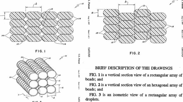

These kind of patent issues have always bothered me. I hope this gets fixed so we can get this functionality sooner than later.
One of the printing youtubers did a test and found it didn’t really help that much. Angus maybe? I can’t remember now.
All, it was Stefan on cnc kitchen.
