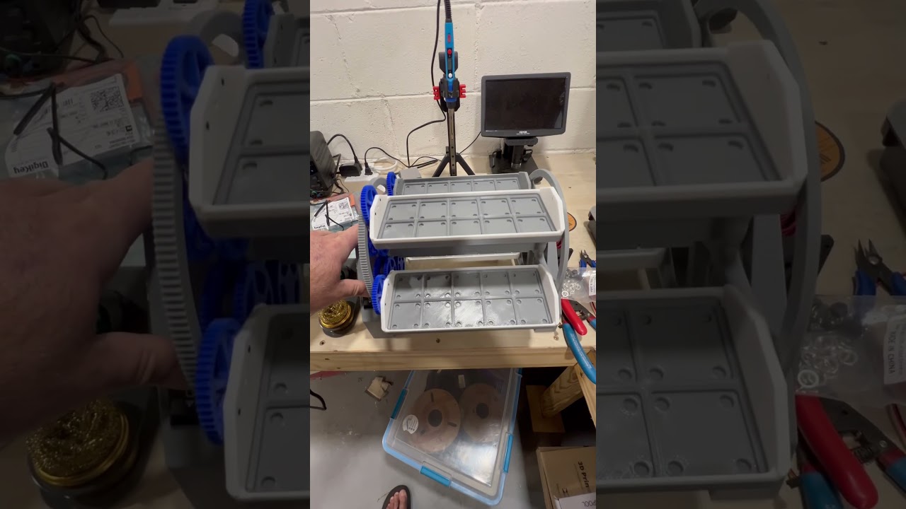

man oh man, that thing really binds at certain points!
cute though.
Idk if its really binding or if its that he has weight in just 2 of the carriages and none on the other 3. It seems to line up when its starts bringing that weight back up. If he had equal weight on all of the carriages I don’t think it would do that.
the weight is most likely correct, never thought about it.

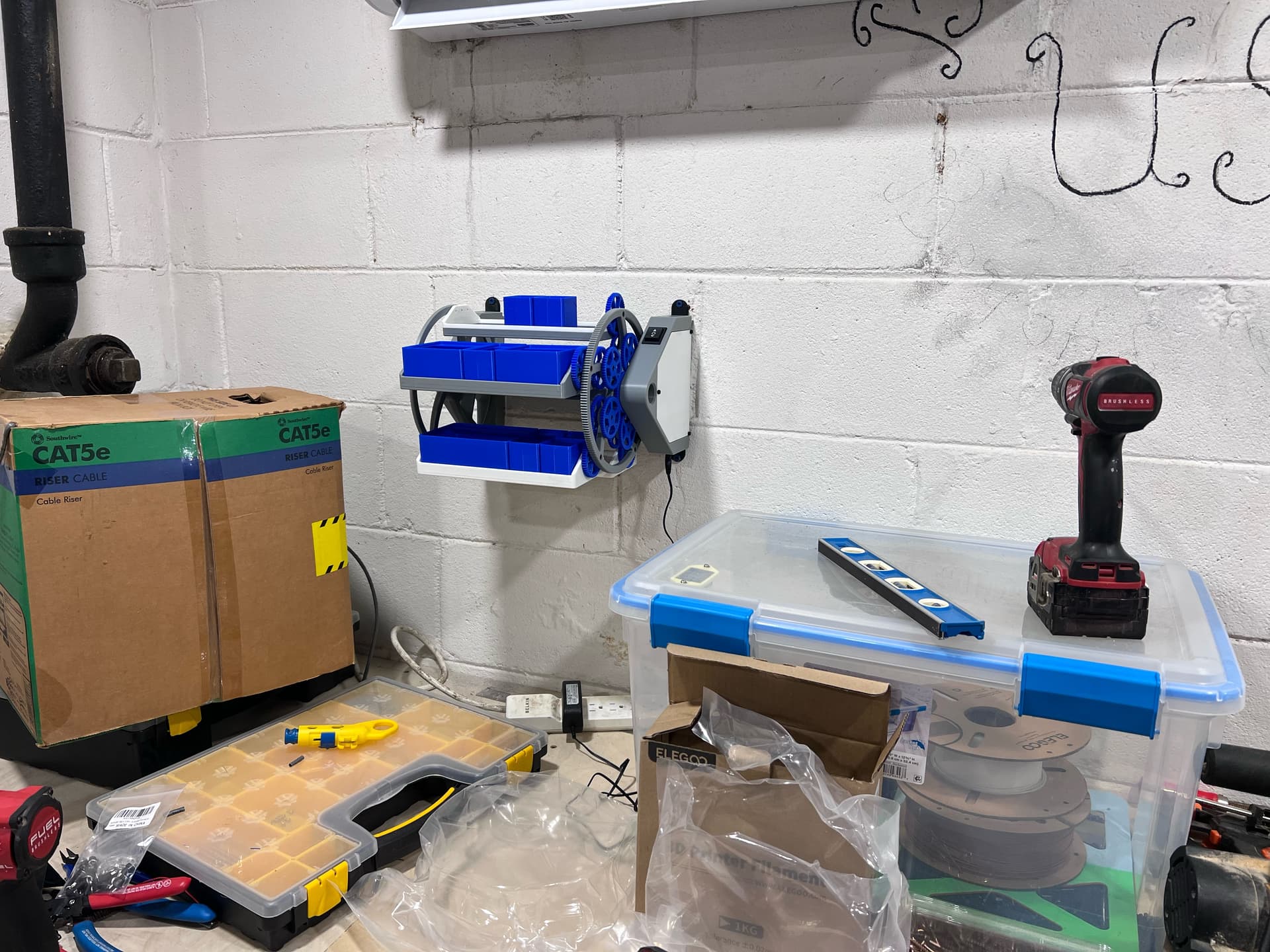

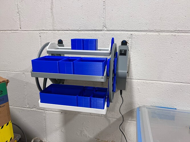

I still have more bins to print. Using @azab2c OpenSCAD to generate the boxes. Works REAL nice! I do wish I had left the labels off of the 1 unit boxes though. Will probably change that on the rest. Got almost enough parts to build a second one minus the motor and printed parts…
I need to take the ā€œdoubleā€ gears back off and sand the mating surfaces down a little more and see if I can tighten them up just a little bit. Every once in a while one will catch on the side. He should have put a decent chamfer on that edge so they wouldn’t catch. But so far its just been a little bump, nothing that stops it.
There is a bunch of room in the side where the motor is. Already stand off for a Pi and something else (cant remember) so people can make it run similar to that.

LOL I started printing this as soon as I posted the link/video here. I was just waiting on parts. One nice thing about having multiple printers. Kept the V4 and V5 open for Beta stuff. Although the V4 messed up and now I get to disassemble an extruder at some point today :man_facepalming:

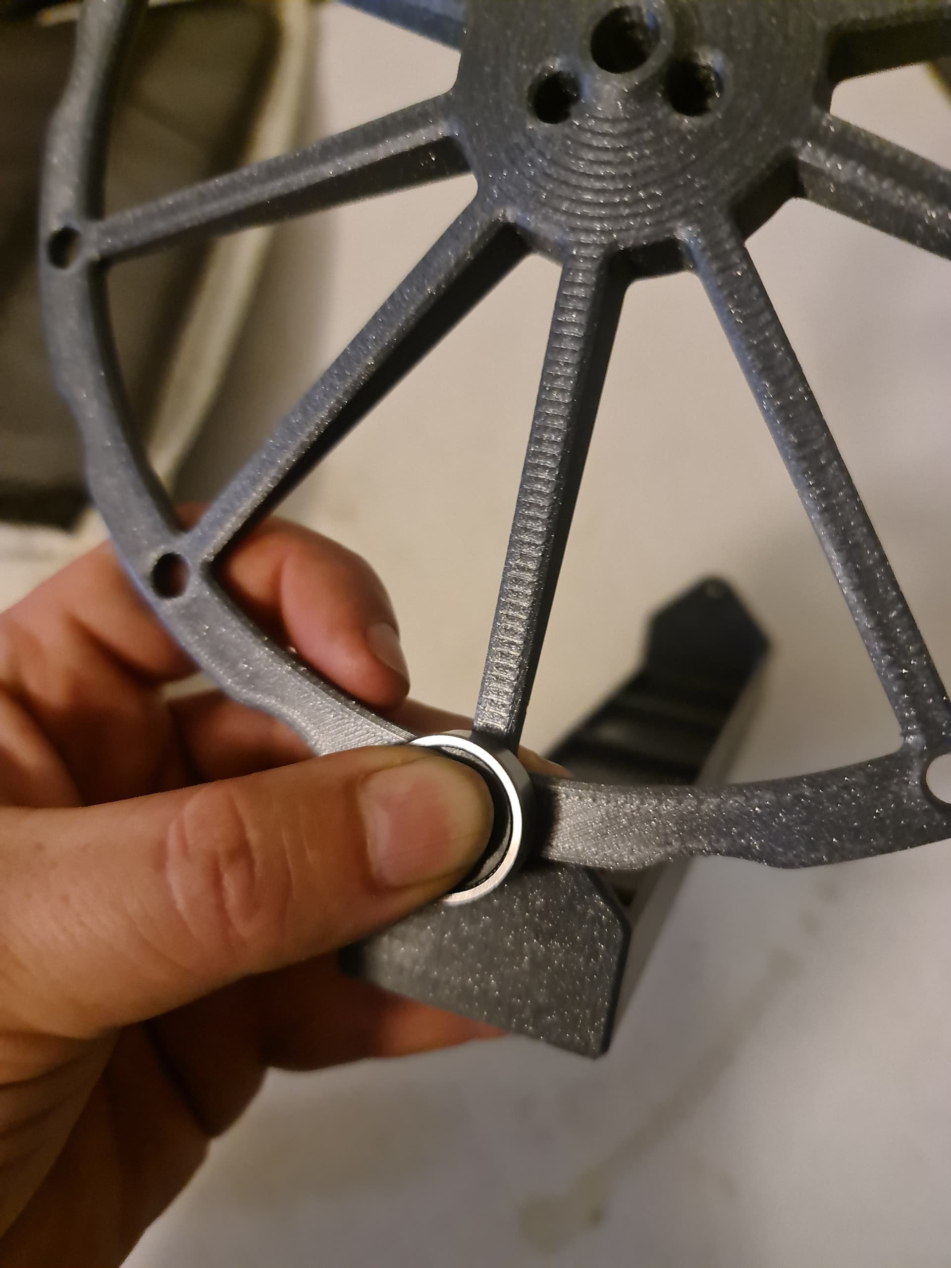

I like the gridfinity caurosel, however, the cost of the bearings is pretty high.
Where would you start if you wanted to design a 3d printed ā€œbearingā€ that would suffice in the caurosel??
Look at print-in-place planetary gears. They can be used as bearings and do a reasonably good job of it, though printer resolutions often make them somewhat large.
Ok. The gridfinity carousel uses 20 pieces of 683zz bearings. The 683zz seems like a quite small bearing.
Yeah, which basically means that you will need a basic bushing instead. This isn’t bad if you have a smooth rod, but isn’t easily workable if you have screws as axles, and I suspect that the size means M3 screws, so…
Edit: 1/8" smooth rod isn’t too expensive (here. Maybe 3mm rod elsewhere?) If you make a capped bushing and open up the screw holes to the 1/8" size plus tolerance, it may be possible to use small cut pieces of rod. Even cheaper, small cut sections of something commonly available like a coat hangar, or baling wire could be made to serve.

The screws used are M3. I will try to print a bushing and insert a 3mm brass rod into it.
I have a lot of 608 bearings, would a 608 bearing on the outside of the wheel work?

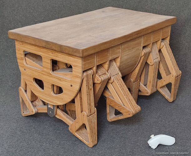

Read the story on the page. Absolute madlad.
The Carpentopod leg linkage itself was generated by some software I wrote that evolved thousands of virtual generations of leg variations by having them compete against each other.
