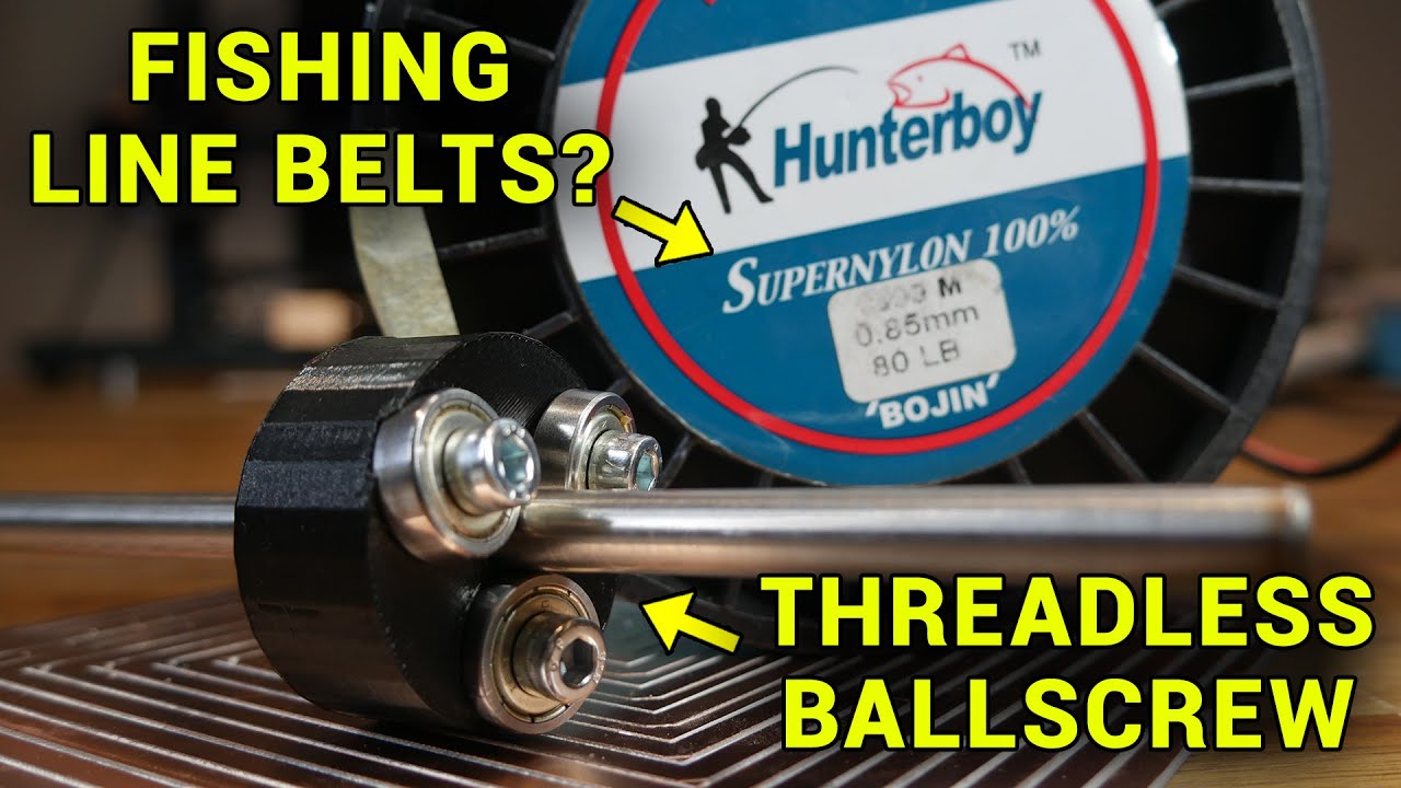

How would that compare to Synchromesh? This stuff seems pretty cool too
I’ve been told it has backlash issues.
I have always seen that and wondered about twist. Under heavy load will it twist at all? It is great for moving small things very fast, but the longer the run and the heavier the load I assume (could be wrong) that it is more likely to twist (backlash).

This video popped up after watching the Synchromesh one.
The threadless ballscrew is pretty slick. I worked at a diecasting company straight out of college and we used to make automatic sliding door brackets with this mechanism. You can imagine that it can handle a pretty good load with the weight of the door and safety glass.
It was used as a safety feature in case of power loss. You can manually force/push the doors open causing the bearings to slide on the rod without damaging anything or worrying about losing position. Pretty slick. I always wanted to use it on one of my own machines just never found a good fit.
My very first MPCNC truck-and-rail assembly was a threadless ballscrew, just with an extremely steep pitch. I was just messing around with the linear rail before building the machine. If I had to guess I think it was in the range of 0.01 to 0.05 revolutions per meter.
Cool. I assume you meant mm? How did it work out? I imagine the that pitch was way too steep.
No, I meant the MPCNC truck rolled with a very slight twist as it went along the length of the conduit. I don’t even remember what was wrong, perhaps the bolts were not set properly or something. Not actually a roller screw but technically the bearings would have traced a helix if the conduit were long enough.
