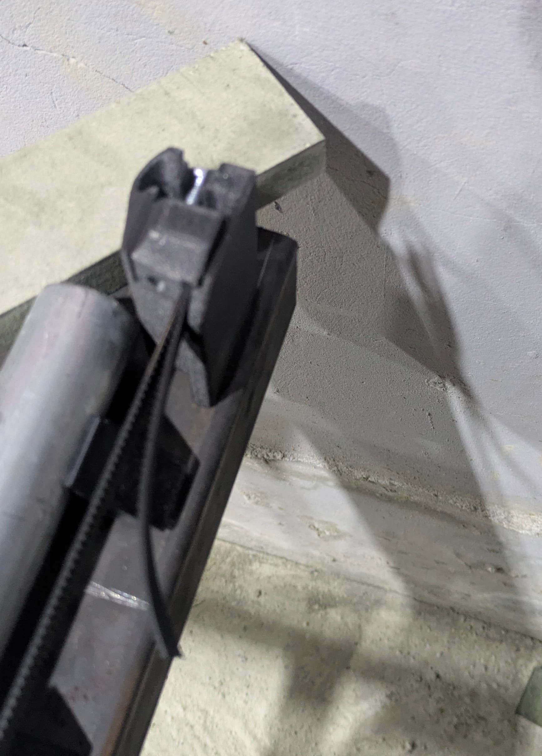

Oh - it may also be nice to give a warning to not use SS bolts on the tool mounts if you want to hang a z probe magnet from them :rofl: Took me a few days to figure out that I had SS bolts and that was why my magnet just wouldn’t stick like the one in the photos did!
Be prepared to have a millon of support questions there. Funny but true
@azab2c @vicious1 here is a good edit for the docs:
To change and use allen m5 bolts on the Y axis tensioner if you are going to keep the table next to a wall.
