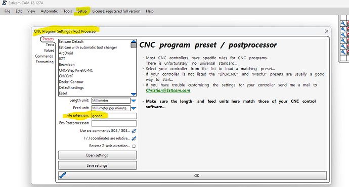

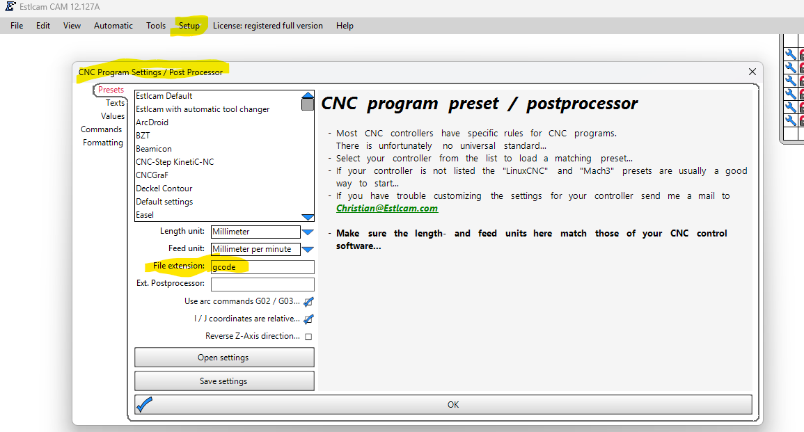

Hello, I am having an issue with ESTLCam. When I hit “Save CNC Program”, it generates as an NC file and it comes up blank when I load it into my machine (Rambo 1.4 running Marlin). Any ideas on how to fix that?
You should probably just open up a new thread for your problem with your own details.
It’s easier to keep track of issues that way, and you will likely get more eyes and more responses on a new thread rather than re-activating one that’s been dead for a couple years.
As mentioned, a new thread would be appropriate, but here is the answer to your question.
There are two ways to fix the issue.
One is to simply use Windows Explorer to rename the file from *.nc to *.gcode.
The other is to change the setting in EstlCAM to save files with a gcode extension rather than a nc extension (Settings - CNC Program Settings / Post Processor)
Got it, thank you!
