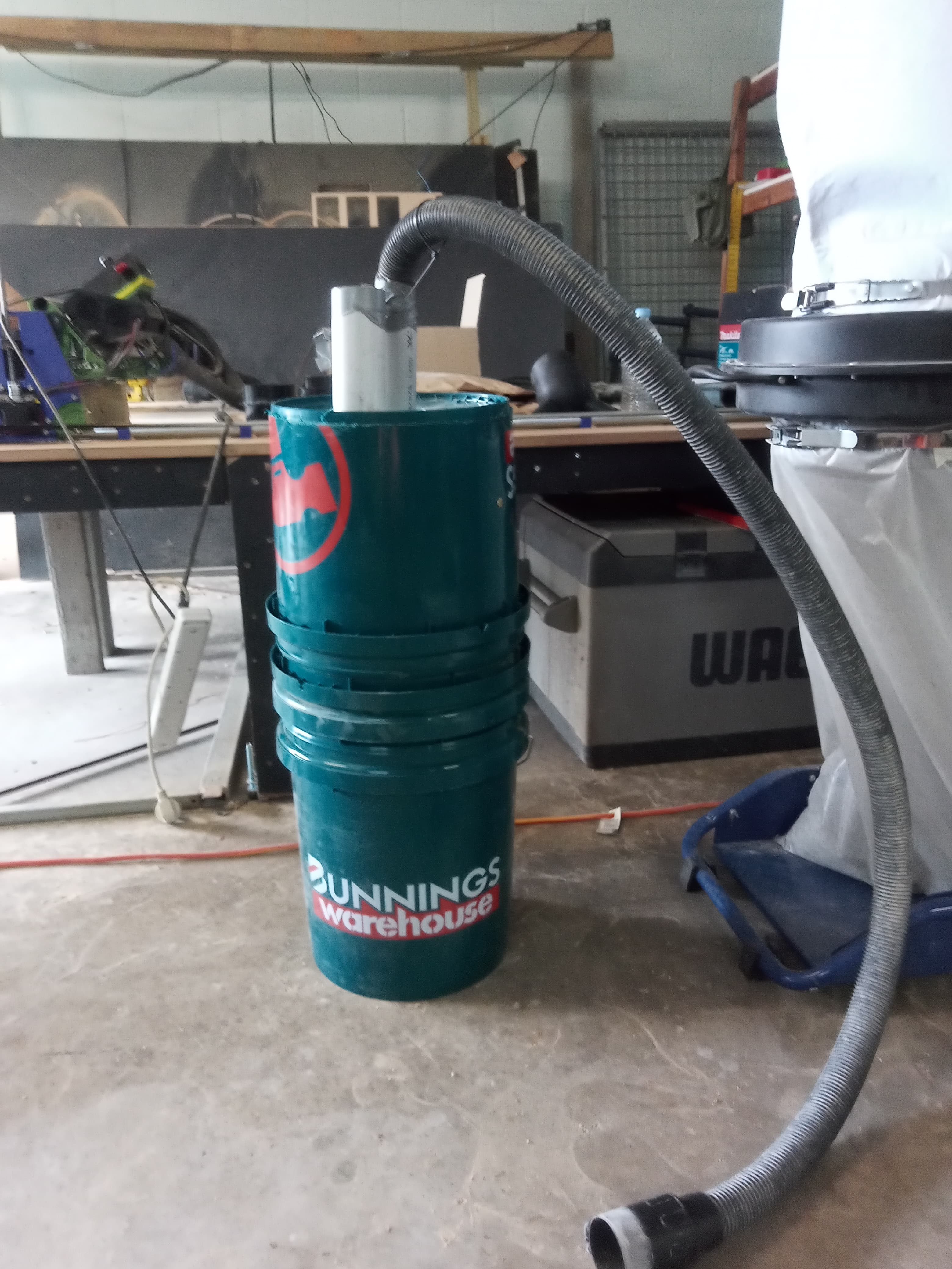

Threw this together yesterday.
Picked this up today
Very supprised how well the buckets work.
I was using that one with my Shopvac. The only problem I had was I didn’t pay as much attention as I should have to the levels in the bucket, and it would fill up quickly and then still get to the vacuum. My recommendation would be to cut the bottom of the 5 gal bucket off, and affix it to the top of a 33 gal trash can (or just a larger collection container) so you don’t have to empty the bucket as often. I stopped using it when I got the HF 2hp DC. it didn’t work at all (as was mentioned earlier) as the reduction to get it down and the low pressure CFM was not suitable. Otherwise, it worked great with the shop vac.

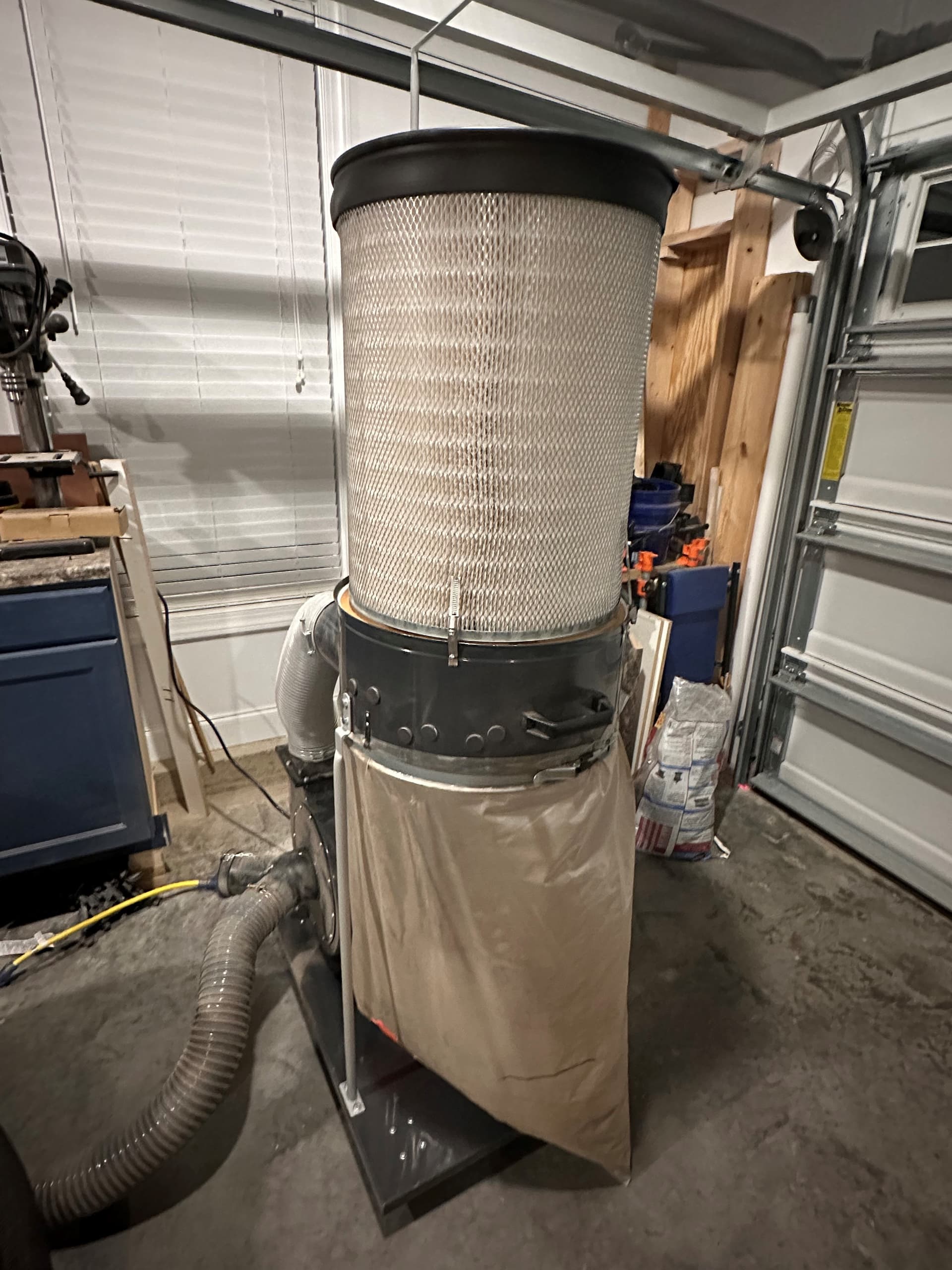

@niget2002 I went this route too, though I am using (going to update) a Thien Baffel. I plan to mount my to the wall in my new garage, and I scored a 55gal white plastic drum for $20. I also upgraded from the bag to a Donaldson Canister Filter (Wynn comparable but about $200 less in price). It increased my airflow and getting much better chip extraction/clean up. I took a picture, but don’t have it on me at the moment.

Oh, and I finally pulled the pic of my DC off my phone:

I found someone on craigslist giving away fiber barrels with steel lids (basically paper 55 gallon drums). I added a Thien baffle and reworked the layout of my Harbor Freight DC with Wynn filter. I took two since I was sure I’d mess the first one up. It went better than I expected, so now I’ve got the second bin taking up the limited floor space in the shop.
