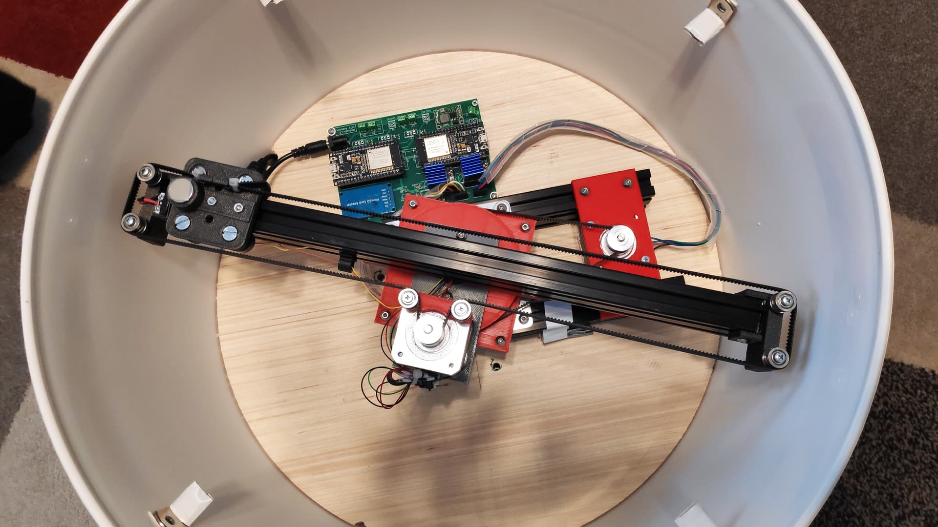

The round table
The table is a pot for large plants. It is plastic, well finished and can be adapted to be a sand table. It has the advantage of being very cheap and pre-made. The movement of the table is polar. I used a lazy susan bearing for rotation and an aluminum vslot profile for the radius. The other parts are 3d printed.
It has a radius of 43cm and the usable space is 33cm. The mechanics are very quiet and have been reliable. The two tables ran for 3 days from 9am to 7pm without any problem during the Makerfair. The drivers again are TMC22209 and the motors are nema 17. From Sandify I got the motion in rho and theta and with some code in Processing I translated them into Gcode instructions for the machine. The glass to put on top of the table unfortunately broke some time ago and I have not purchased the new one yet.

Are you planning on making the parts of your polar design available? Are you using a slip ring to get the rho stepper motor wires? Do you have endstops?

the polar design is available here: https://www.tinkercad.com/things/hi6yER1jzso
I used the slip ring, with 6 cable: 4 for the nema17 and 2 for the endstop. I use only one endstop in the rail.

Do you happen to have a links for the plant pot? I really like the idea!
Edit:
Just realized you glued those metal brackets hin there? How did you get them to stick properly?
This is the pot: https://artevasi.com/product/san-remo-matte-pot/?doing_wp_cron=1672999659.8154458999633789062500
the size is 42x39.5. I don’t know where are you, I bought the pot at Leroy Merlin, a big hardware store, but in Europe I think you can easily find also in an online store. I see it in the italian amazon store and also in ebay.
For the glue, I used simple hot glue. I started with bihadesive in ordet to find the right position.
