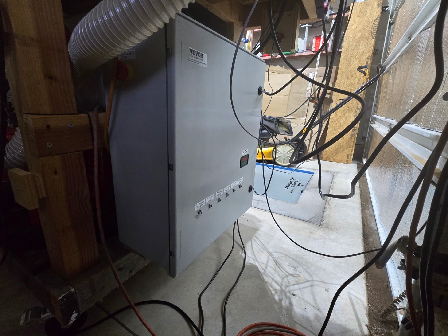

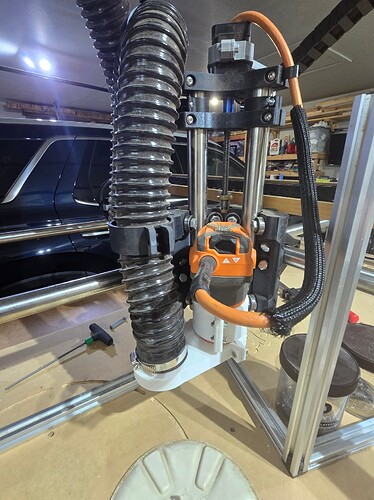

I printed everything out on an Ender 3 Pro, which itself has gone through several iterations of “improvements”. Another topic for another day I suppose. I think I printed every single part at few times, minus the core. That thing was a beast which failed to print twice. It’s been so long since I’ve printed it that I can not recall what settings I used. Recently though, I reprinted the corners with the gyroid infil to then back fill those parts with Smooth On two part epoxy. Other “modifications” include using some timing belt cut off between my 1” stainless pipe to help with slippage, inductive limit switches, a custom built router clamp for my Ridgid R2401 and a fiberglass electronics enclosure for all of the electronics.

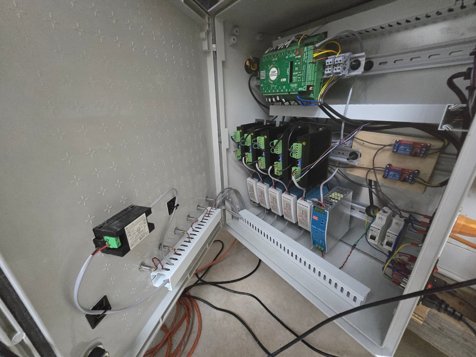

Warp9 Ethernet Smooth Stepper
C25X break out board from CNC4PC
Mach 4 Hobby from Artsoft
Ridgid R2401 router with extended power cord, removed and replaced factory cord
Meanwell 120-24 power supply for the ESS
5 x Meanwell 60-24 power supplys for the stepper drivers
I was running TB6600’s, but recently changed to the China DM542 (these things are super quiet)

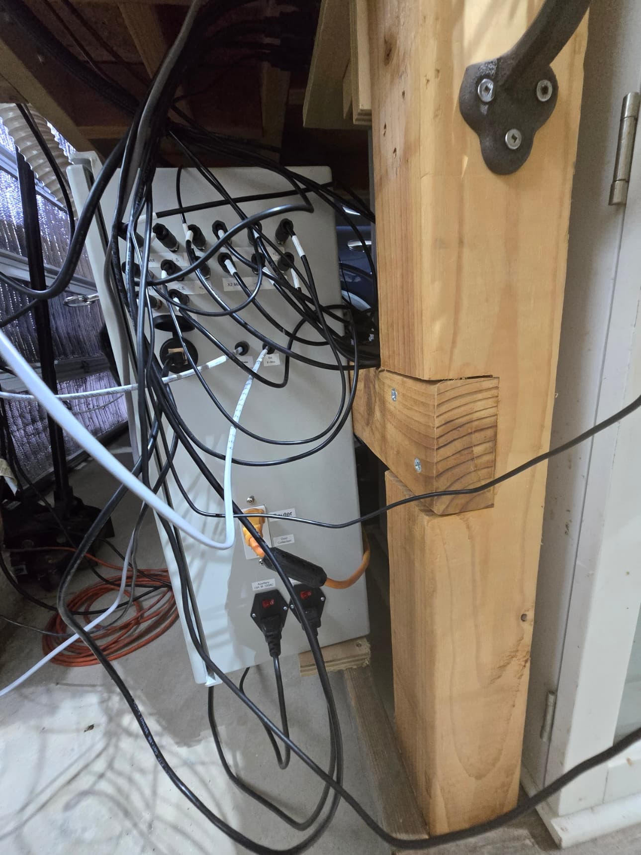

M8 4 Pin, 3 Pin and 2 Pin connectors for the various connections at the electronics cabinet

Shielded CAT 6 bulkhead connector for connection between the ESS and PC

DIN Rail for the cabinet
3D printed custom DIN rail mounts for the power supplies and accessories
Digital Ammeter/Voltmeter for the ESS PS and accessories (Dust collection/Router, still need to install)
LEDs to show power at the power supplys
Open slot wiring raceway to keep the cabinet tidy
I also added 4 electrical circuits to my load center. 2 x 15 amp and 2 x 20 amp. The 20 amp is on a single throw double pole breaker to shut everything off in the event it hits the fan
Operator side E-Stop, with a far side E-Stop built into the Cabinet
Internal breakers to the cabinet
Fused AC power for additional protection

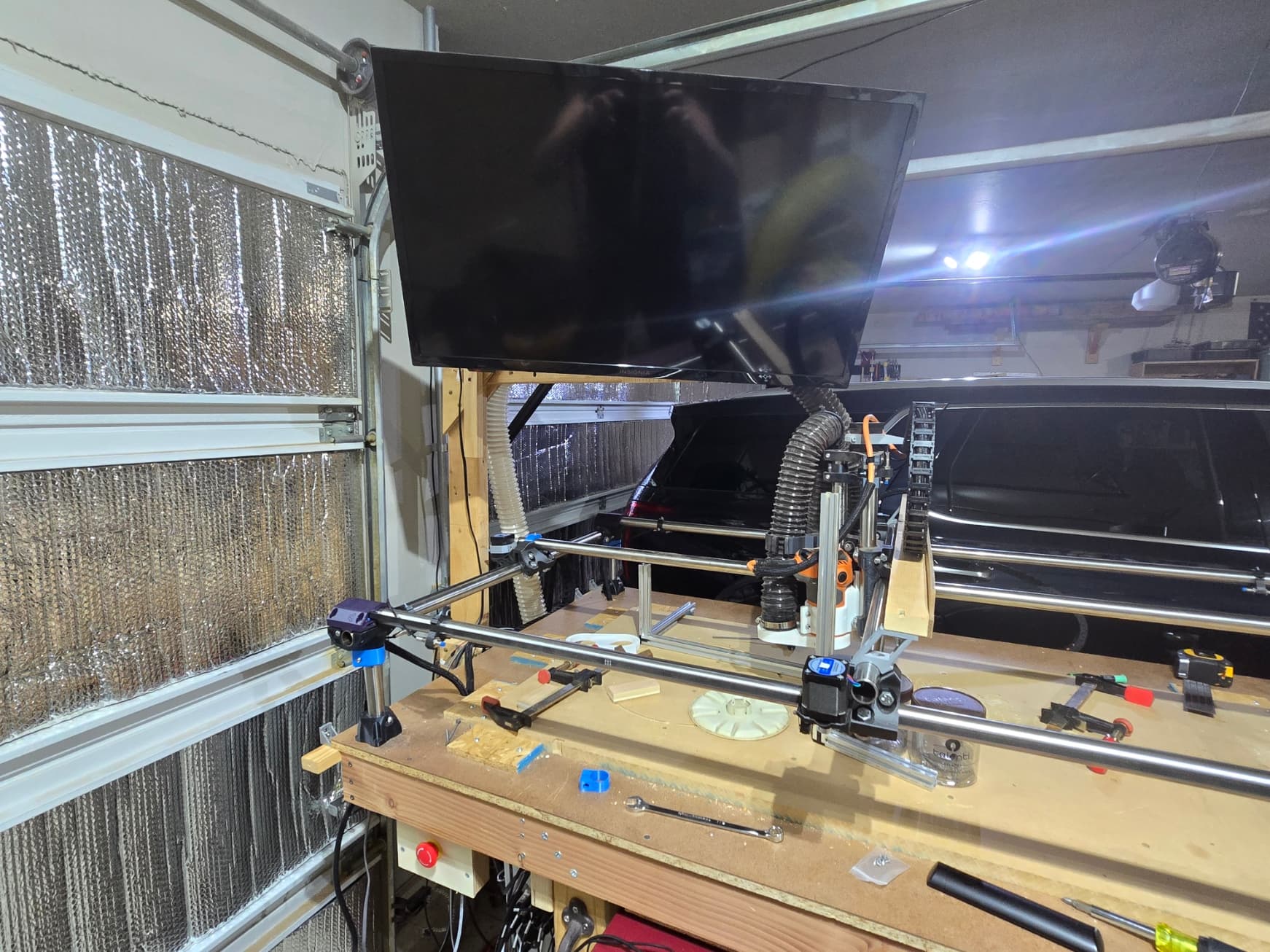

FireTV mounted above the table
3D Printed, custom dust shoe (still a work in progress as I can’t find brushes that are soft enough)

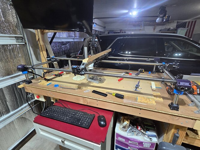

I’m still in the process of settings things up but the last items are settings the distance from the corners for the limit switches and getting those dialed in. I was also able to get the frame square today, which was a huge win for me as the previous build I could never get square.
I haven’t made any cuts on this iteration as of yet. The previous build I was running the STB5100 motion controller with Mach 3. I made a couple MDF spoil boards with 1/4” holes to house a tee nut on the back side. I had made a sign but wasn’t happy with the results, which led me down the path of upgrading just about everything.

Welcome to the forums. For that size it might be better to just build a LR. You are going to have quite a bit of chatter I guess and the Z axis won’t be too stiff either at that size. :slight_smile:
But check out how it works out, you can always change later. :slight_smile:

So why did you opt for each motor getting their own supply?
No real reason other than wanted a dedicated P/S for each driver!
