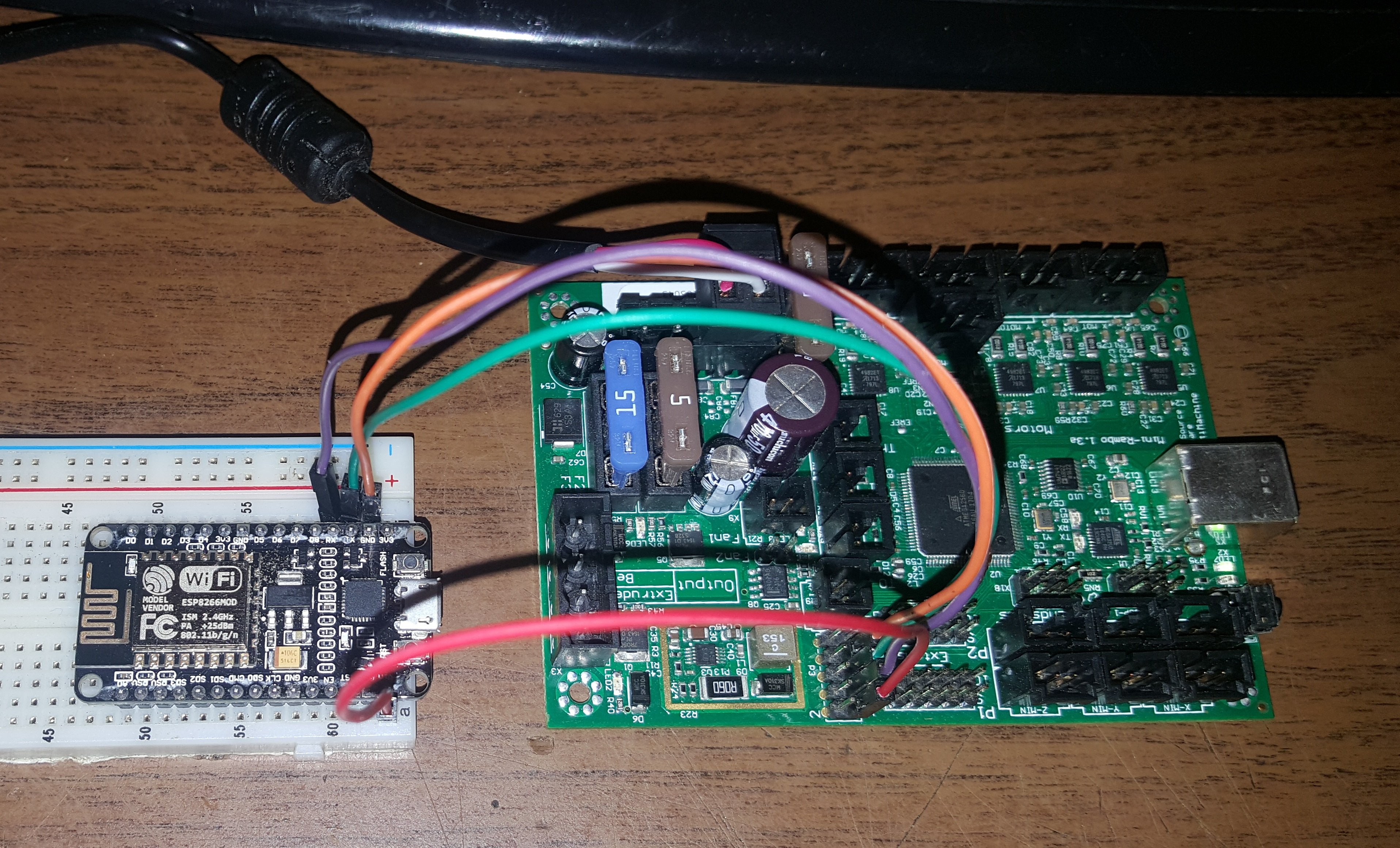

So, I added a NodeMCU to serial 2 (mini-rambo 1.3) for a wifi connection. The connection a little flakey, but when it work, it works well.
How does that work? How do you actually connect, what program?
