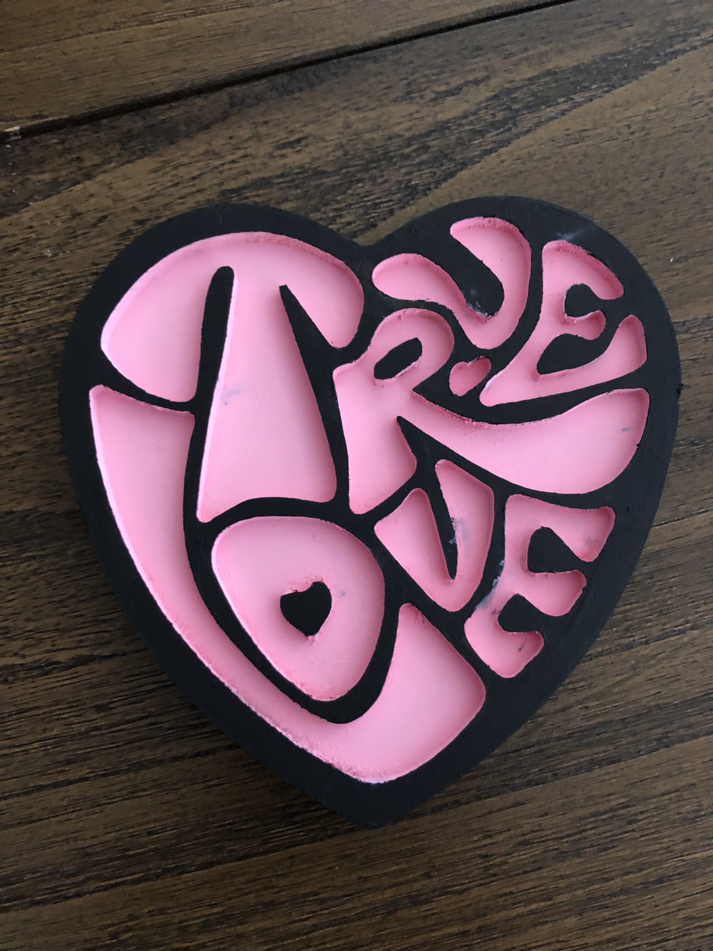

My mpcnc project!

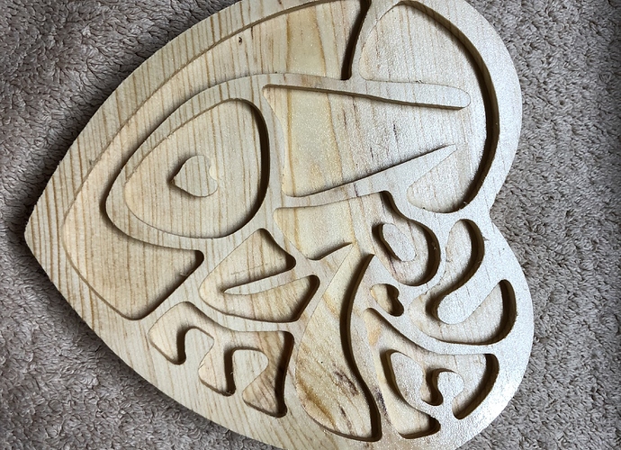

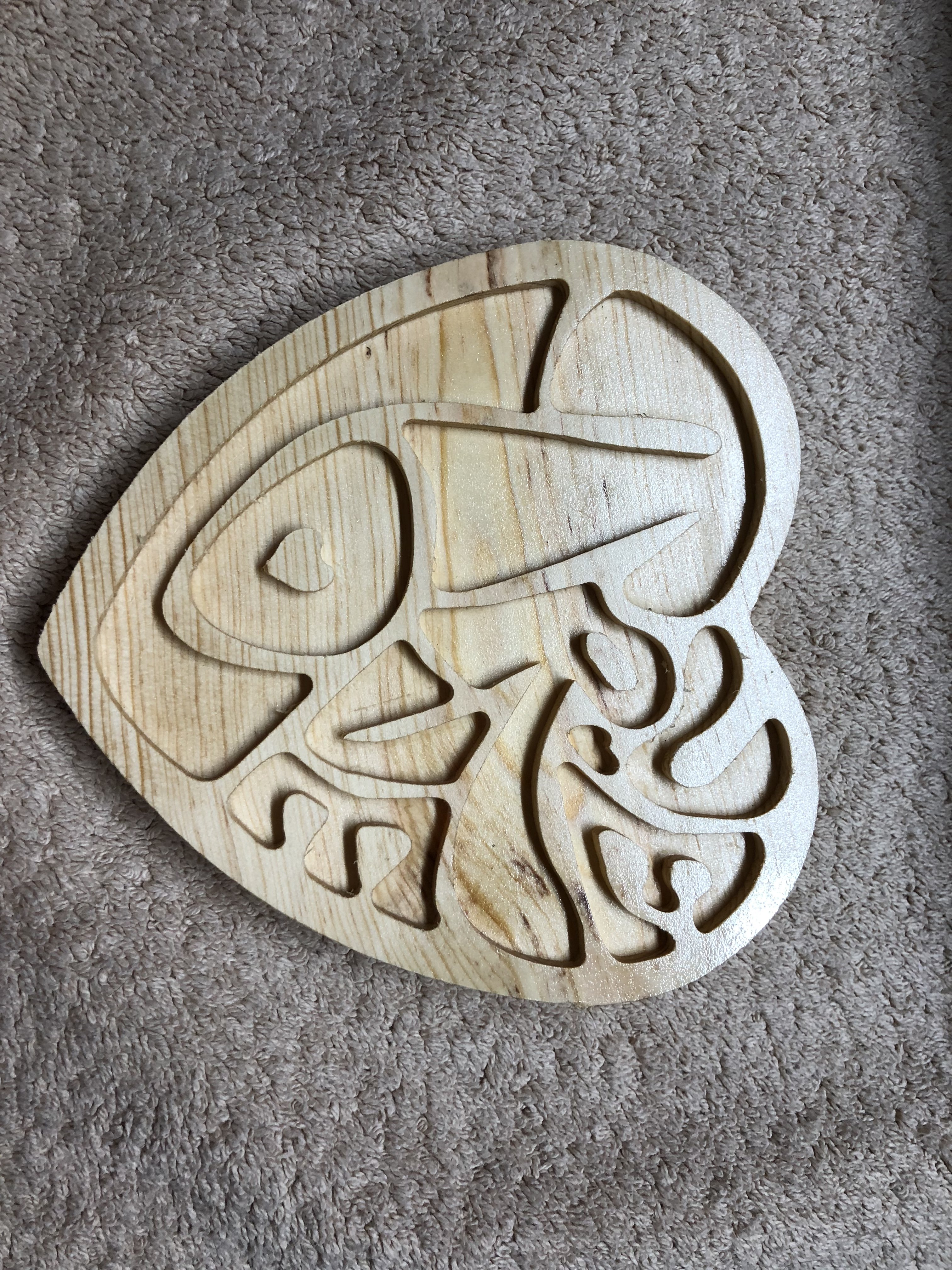

Great minds…
2mm depth and much faster. :slight_smile:
That looks great!
Do you think you can do 3 or 4? I think 3-4 for slotting is pretty safe. Those pockets should easily be handled at full depth.

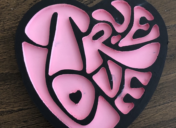

Painted.

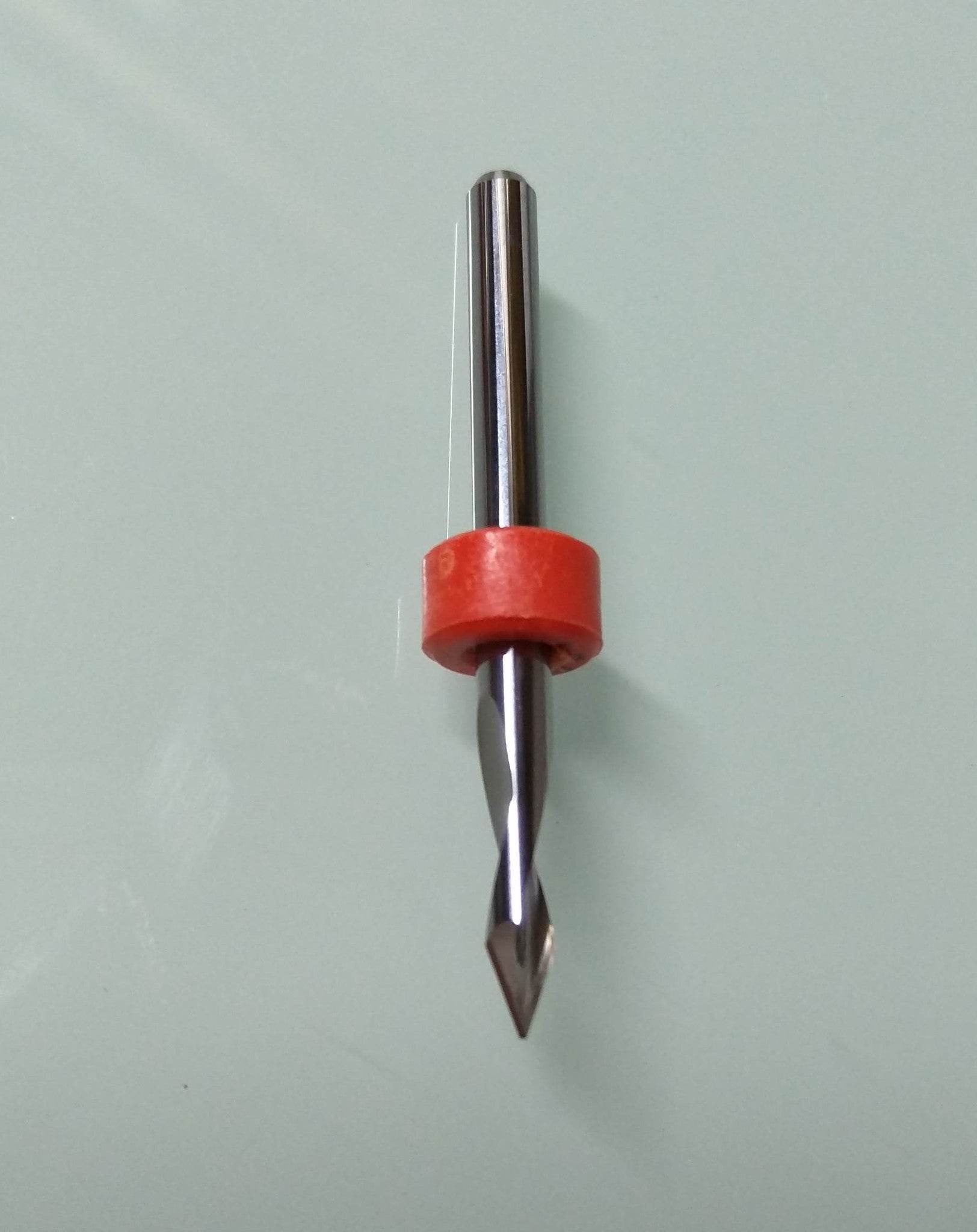

Any idea what bit they are using here?
V bit
This one or larger?
That will work. I use it all the time.

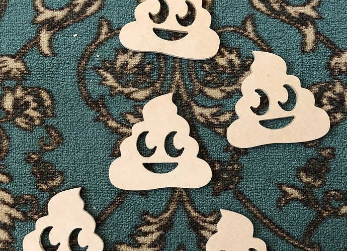

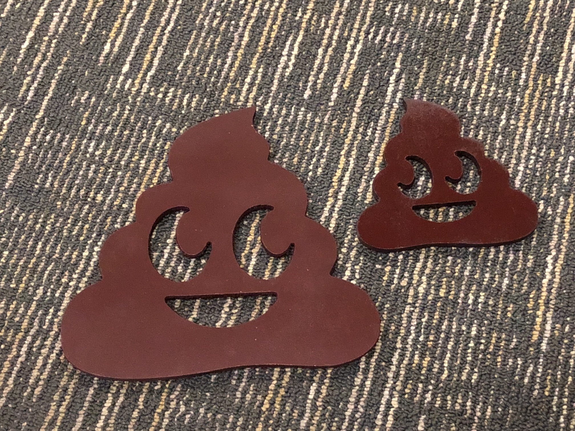

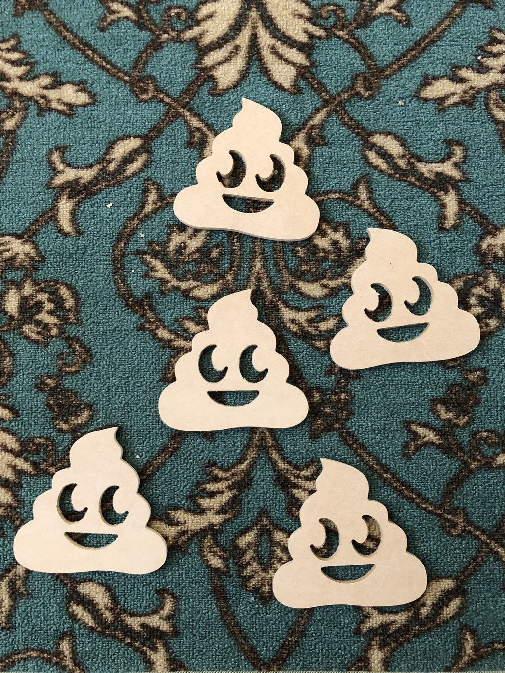

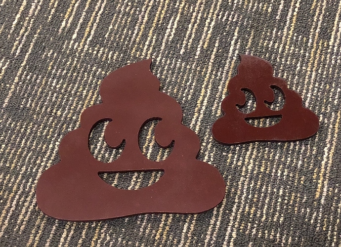

I made a few of these last weekend… and when the kids saw them I had to make more. :slight_smile:
[attachment file=65898]
[attachment file=65899]
Awwww poop!

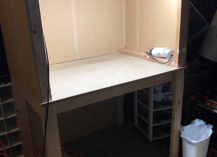

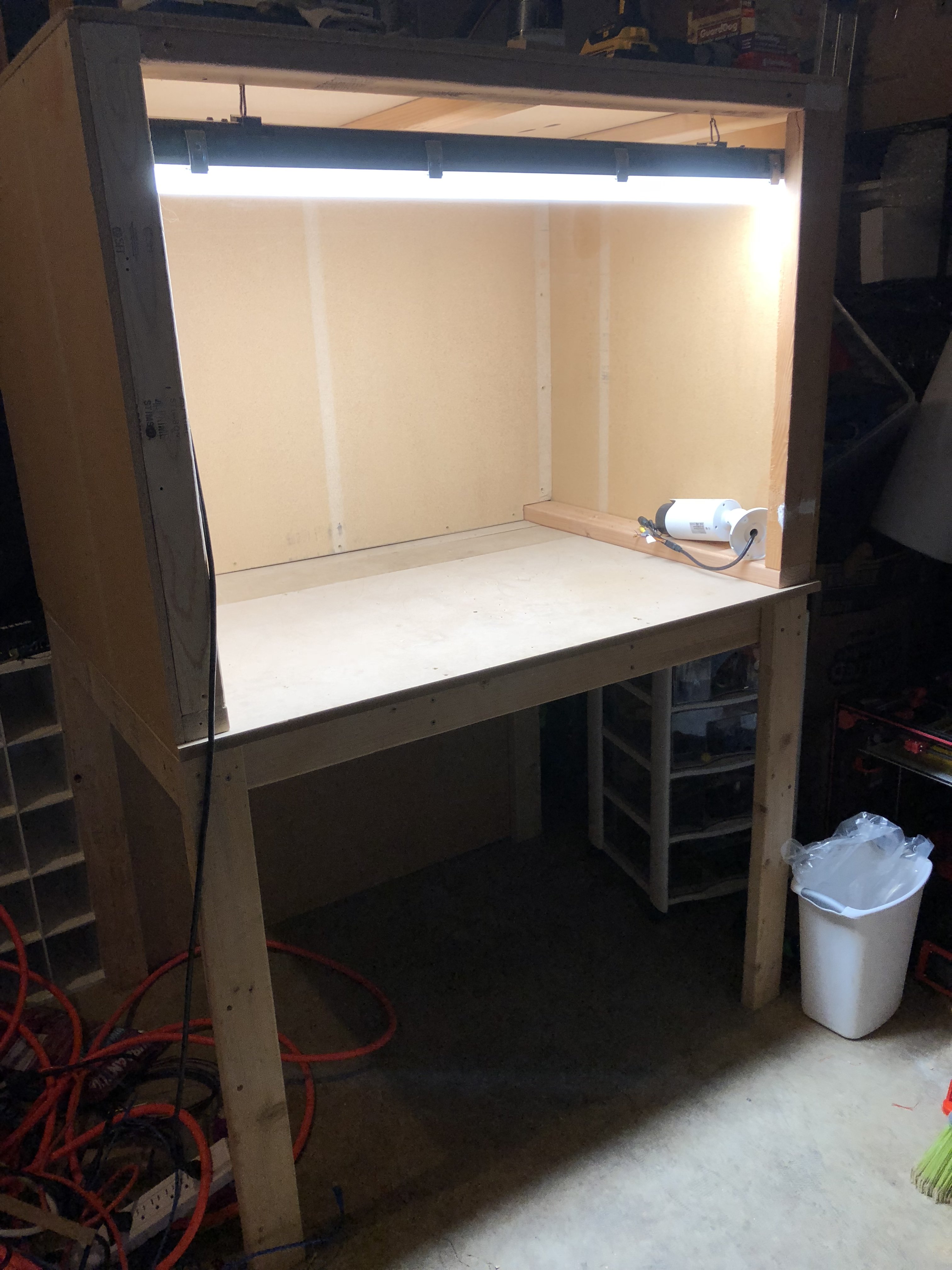

Here is the enclosure I’m building for my MPCNC. I think I want to add another piece of particale board on the sides as well to help with noise. The back has particle board on both sides already.
When it comes to dust, should I just run the hose to the dust shoe? Is that enough when it’s totally enclosed?

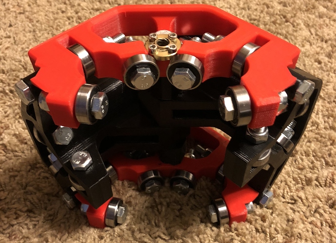

So I tore apart my MPCNC since I wanted to update it with Burly parts. It was a good time to print all the other parts as well.
I’m currently using EMT and 23.5 parts. Can I keep all of my 3D printed pieces and purchase stainless? What size would I need?
Burly…
[attachment file=“2018-10-28 18.37.55.jpg”]
I’m currently too lazy to change the size of the other photos so that’s the best photo I can do for now.
Nope, all different. I mean you can keep the locks, legs and feet and swap out the rest with stainless and stainless sized parts but…
You just got everything together, you didn’t wanna break it in a little more first?
