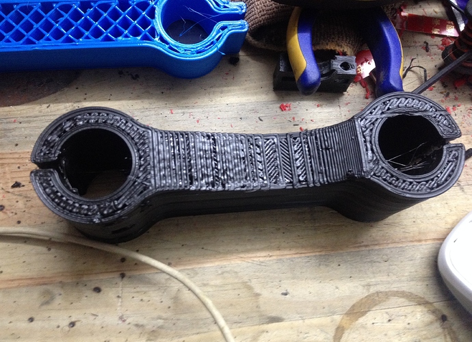

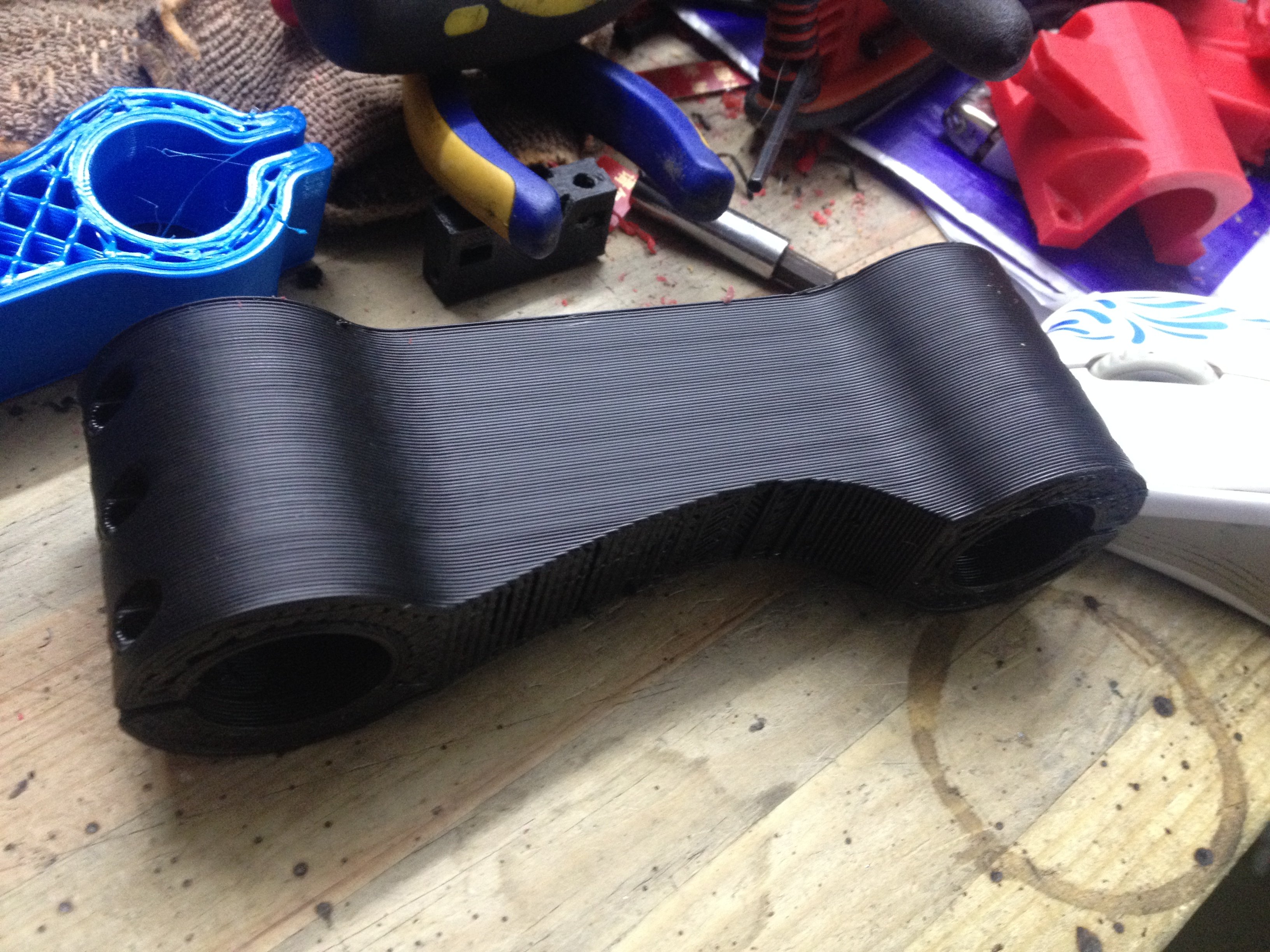

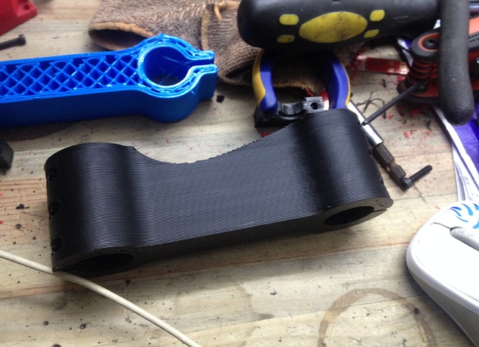

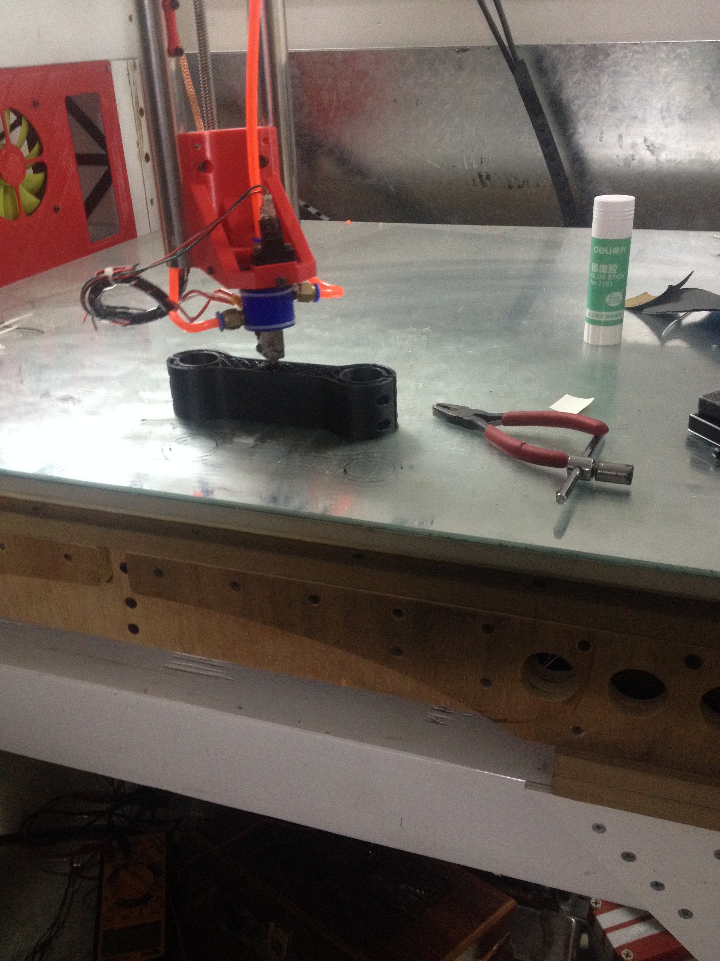

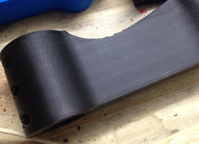

Good news everyone,
I finally have what I can call a “decent print” out of the MPCNC. Not that the previous ones were absolutely horrible, but in order to be used they needed a lot of reworking, and they didn’t look great.
This time, I think I’ve found the sweet spot. I’ve printed a bracket for the electronic box of the MPCNC and it turned out just amazing… I’ll just let the pictures speak for themselves:
[attachment file=56580]
[attachment file=56581]
[attachment file=56582]
[attachment file=56583]
[attachment file=56584]
[attachment file=56585]
[attachment file=56586]
There is still a few things to be tweaked up:
-The infill and the top/bottom layers, obviously
-The retractions and prime
-Add a part cooling fan
But other than these little issues, I think I finally have a working setup.
Now the next steps is to make it as reliable as possible and to add the bed probe sensor system, because the only real issue with this machine so far is to get the first layer right.

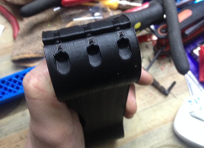

I printed this using relatively conservative settings:
-40mm/s for the external perimeter
-80mm/s for the internal perimeter
-90mm/s for the infill
-120mm/s for travels
The accelerations varies from 300 to 1000 depending of the type of movement. It is nothing close to what this machine can do, I’ll crank up the speeds later. The print time was 1:45. This would have taken 9:20 with the delta. I think it can be done in less than one hour with no major quality issues.
I’ve taken a small video of the machine doing its job, just for you guys:
In the end, the print is perfectly usable right out of the printer, 4-5 time quicker than whatever would be possible with the delta. Huge win!
I’m super happy with this, it is actually better than what I was expecting to get! Keep in mind that this is with this giant 50cm long Z axis!

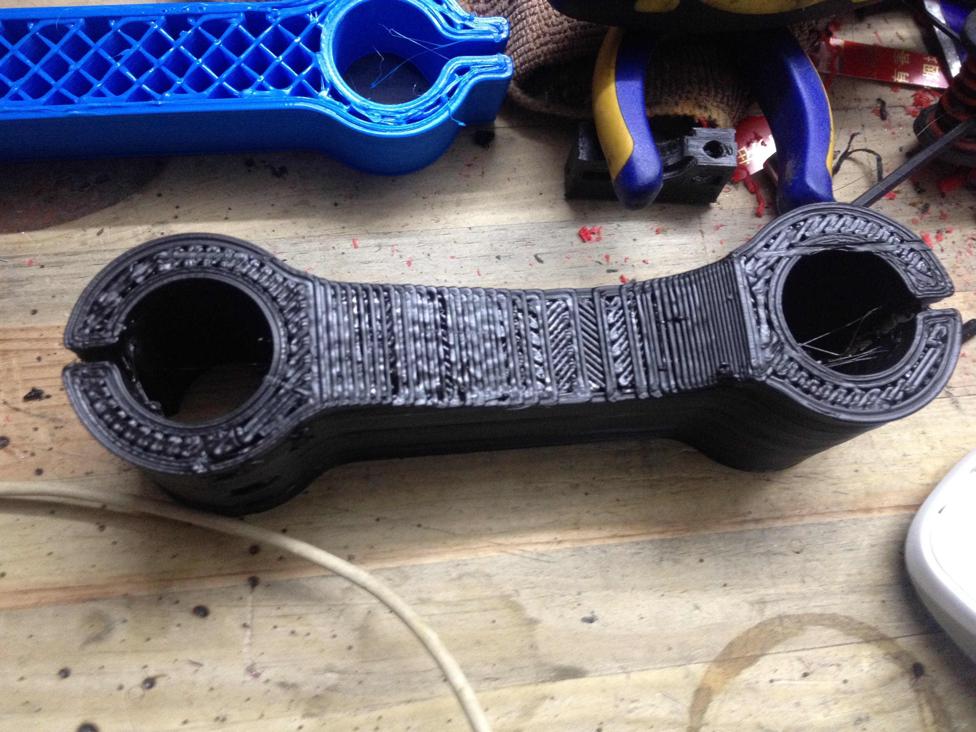

Good news everyone,
[attachment file=56589]
[attachment file=56590]
[attachment file=56591]
[attachment file=56592]
[attachment file=56593]
[attachment file=56594]
[attachment file=56595]

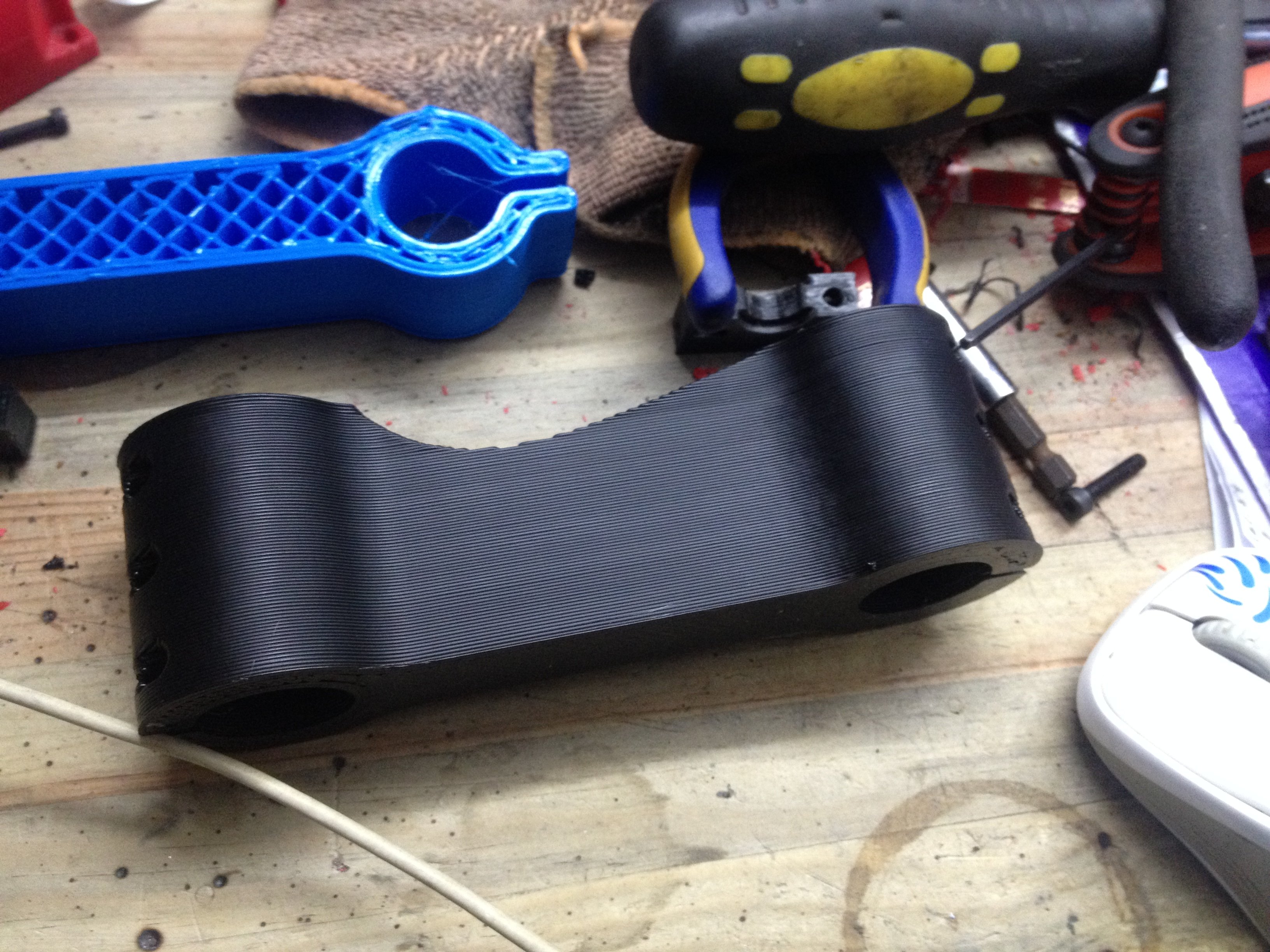

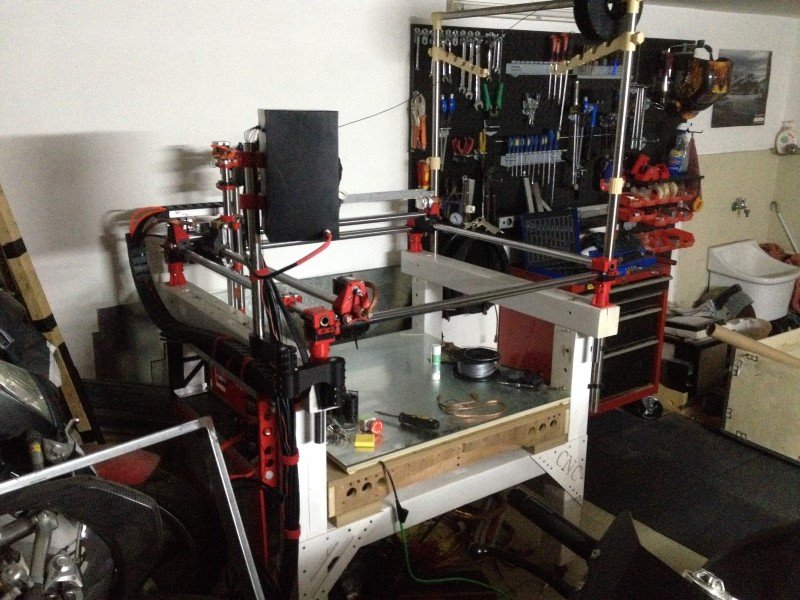

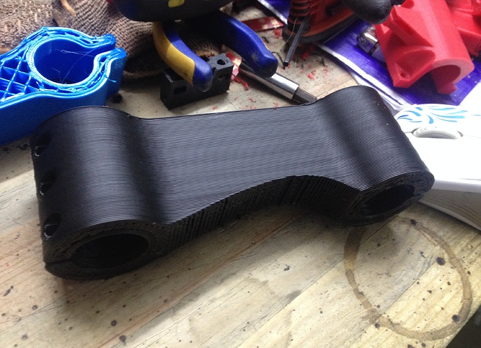

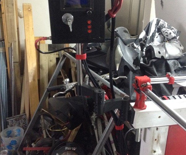

I made a few more tests this weekend.
Turns out that I counldn’t find out the solution to my retract/prime issue on Cura. So I turned out again to the good old Kisslicer… and it turned out to work just fine. So I guess I won’t use Cura again and stick to Kisslicer, except for some very specific printing needs. There are less options in Kisslicer, but the slicing logic is just way better. Cura sometimes feels so stupid in the way it arranges travels, it’s sometimes quite a bit annoying. BTW, if anyone has a really good slicer to recommend, I’ll be willing to give it a try.
So, I’ve printed a little bracket system to hold my electronic box. I think it looks pretty nice, and it is actually quite tough. The parts are perfectly usable and look more and more decent the more I experiment with slicer settings. So far it has been very reliable, I haven’t had a single issue once passed the first layer.
[attachment file=56833]
[attachment file=56834]
[attachment file=56835]
[attachment file=56836]
That arm is awesome, I have tons of conduit laying around and that looks like a good use of the small bits. Just like my TV mount, but smaller.

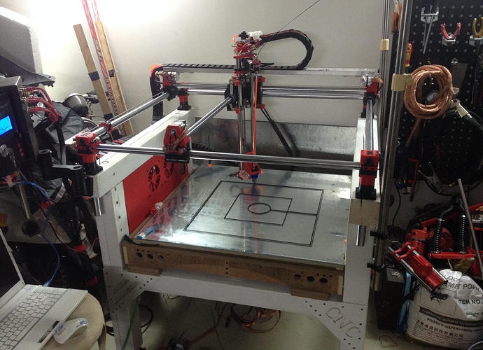

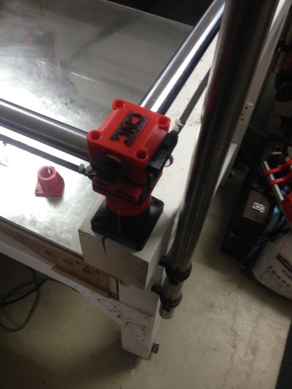

Hop, the new corners are finished now:
Just need to print a few more feets and it should be done. Then I can finally tackle the bed autoleveling part.
[attachment file=56944]
[attachment file=56945]
[attachment file=56946]
[attachment file=56947]
The new feet I made have 3 screws to let you anchor the far corner to keep it square, then you can clamp the tube and set the other two. They have slotted screw holes as well to let you make adjustments to square and clamping tension. With 4 screws center set you can either tension the clamp or set the screws but not both. If you get a free minute to edit those you might want to get the slots in there it makes a huge difference to squaring, ease of use. I also switched to a thicker wall to increase rigidity and lower the stress on the plastic. I know they look cheesy but they are a big improvement. I am a function over form guy.
Yours do look pretty dang beefy though, I am sure they get the job done.
Yes, you are absolutely right, I thought about this issue during design.
On my particular machine I don’t really need to get these really squared, because the wood chassis is actually doing all the work for me (unfortunately it is not totally square because it was hard to hand drill those holes perfectly square given the tools I have, but that’s an other issue…). IMO, the way to assemble those feet should be to clamp them first to the tube, then adjust squareness and then only screw them to the table once you get the squareness right. I wouldn’t really rely on the corners parts to check squareness since you would have a bit of a hard time to perfectly align them respectively to each other after they’re being clamped anyways.
I was thinking of a different approach originally, which was to not make the corners feet a square, but more like a slight trapezoid. This way, after finding the correct angle through a bit of trial and error, they would have ended up perfectly square after being tightened. But it sounded like a bit of a hassle to design, so I went the easy way. I guess your way is quite easy and convenient too, but I think only one slot is really necessary, the other 3 wouldn’t move much after tightening.
I haven’t seen your new design yet, is there a thread I missed somewhere in the forum? I think I understand what you’re talking about but I’d like to make sure.
Also, regarding strength, I printed those with 4 perimeters and a bit more infill (30% or so)
That is why it took me so dam long to remake such a simple part. I was stuck in that same thinking. With these new feet, you can loosen the screws a bit, like half a turn, and adjust every single one at least 1/8" in all directions. I seriously have never had such a perfectly square build as the last two easily within a half a mm and that is as good as I can measure. Those oversized slots make it ridiculously easy.
https://www.v1engineering.com/new-foot/
