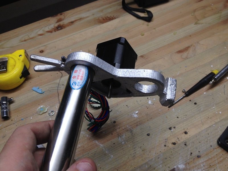

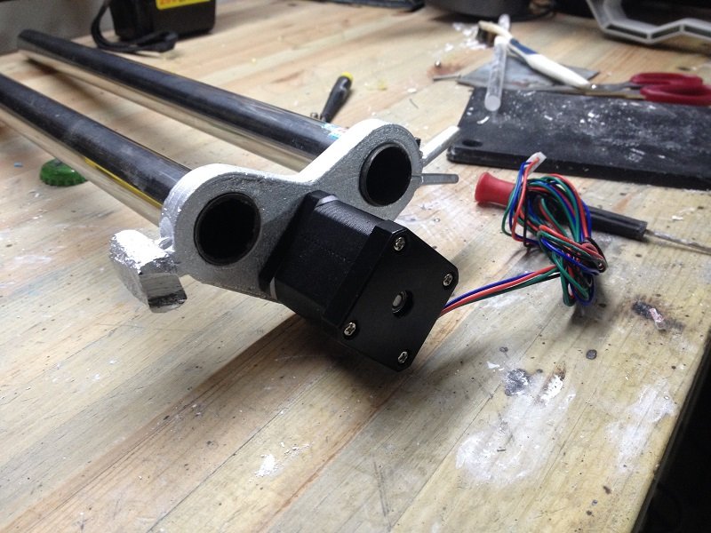

Hey guys, Breaking news!
You’re about to see the first MPCNC part made of cast aluminum!
So, As it turned out, I tried yesterday and had a great success with my first cast attempt ever. Sure, the part is not perfect, but I’m pretty surprised how well it turned out. Let’s see some pics first:
[attachment file=48627]
[attachment file=48628]
The second pic is kinda bad, the part looks quite a bit better IRL.

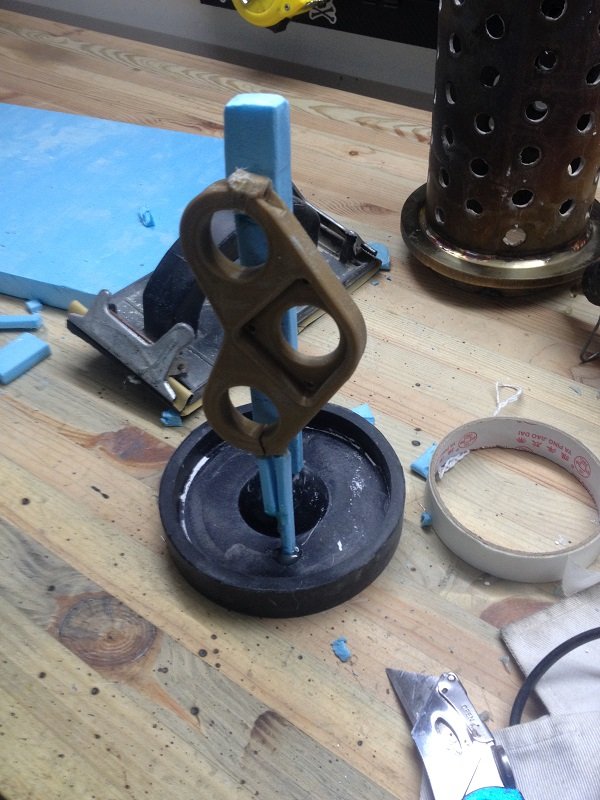

First, I had to create the mold. My plan was to go for the lost PLA technique, because this technique would allow me to do a lot of great things, using the 3D printer to make metal parts.
So, basically, the first step is to 3D print a part (I used a Z motor mount I had in spare already). Then, add some channels for the metal to go in, and some other channels to let the gases escape. I just used some regular blue foam for that.
[attachment file=48629]

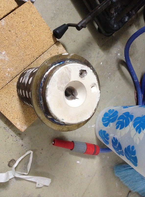

The next step is to pour plaster all over it, then wait for it to cure. I waited about a week, just to make absolutely sure that all the moisture was gone, but it is probably not necessary. I guess one day or even a couple hours would work fine too, but I didn’t want to take any chances for my first attempt.
Then, you have to remove the plastic and foam from the mold. For this, I’ve put the mold in my furnace, and gradually moved up the temperature, from 50 degree C to 400 degree C. I’ve let it in the furnace at that temperature for about 24 hours, but I guess 4 or 5 hours would have done the trick.
My mold came out of the over absolutely flawlessly, not a single crack, which is actually quite a great achievement in itself:
[attachment file=48630]

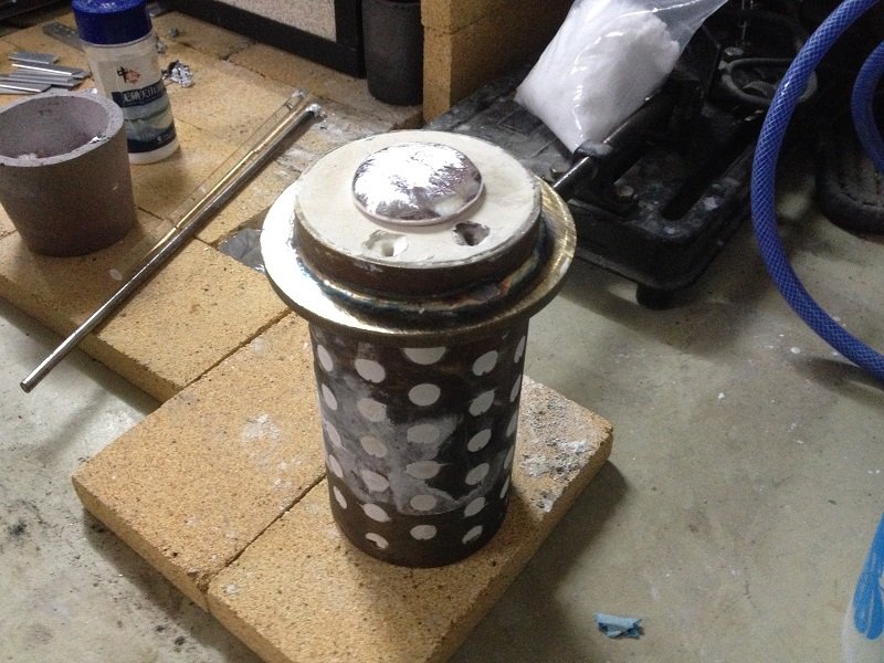

Next step: heat up the aluminum to about 730 degree C, remove the dross, add a bit of salt to lower the surface tension, then pour into the mould:
[attachment file=48631]

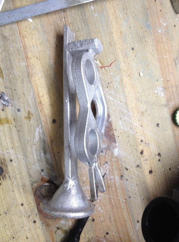

I was supposed to wait for about half an hour for it to cool down, but I was just too impatient, so I waited 10 minutes and threw it in a bucket of water :smiley:

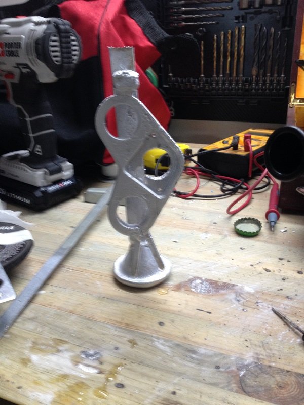

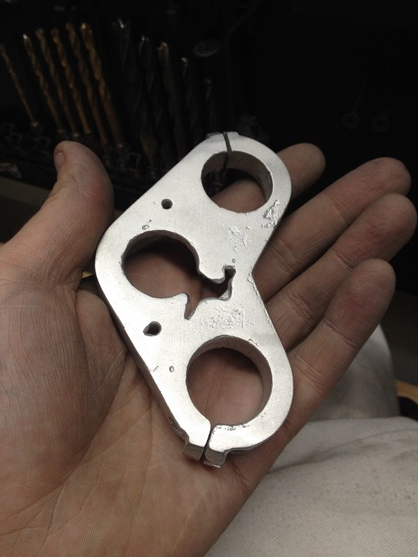

After cracking the mold open, here is what came out of this:
[attachment file=48632]

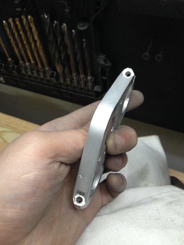

Even the tiny screw holes came out perfect, I didn’t even had to drill them for the screws to fit perfectly into place!
[attachment file=48633]
[attachment file=48634]

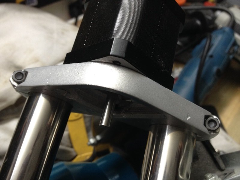

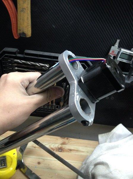

Same thing about the tube holes and the motor fixing places, everything fits perfectly!
I still have to remove the channels, give it a bit of sanding and cleaning, and sure it is far from perfect (a lot of tiny holes, also a spot under the motor wasn’t filled properly), but in some places the quality is just astonishing. You can even see the 3D printing artifacts, which were extremely tiny since this part was printed on my very well calibrated delta printer. For example, the tube holes came out absolutely incredible.
So I’m super happy with that, I end up with a functional part at first try, it really isn’t that complicated and it was pretty cheap to build. That’s a very nice DIY thing I recommend you all to try!
I think I’ll try to build a full aluminum gantry for the MPCNC soon, just need a bit of time to improve a bit my technique.
Cheers!

Yeah, the screw holes worked just fine and even the tiny little gap between the two parts of the clamps, which is about 0.5mm wide, for which I had no hope at all that it would ever work. So basically, I just had to put the screw in there, tighten it and it was holding the tube super tight. I just don’t know how this could even work at all, I guess I was lucky enough to get my hands on some really good plaster.

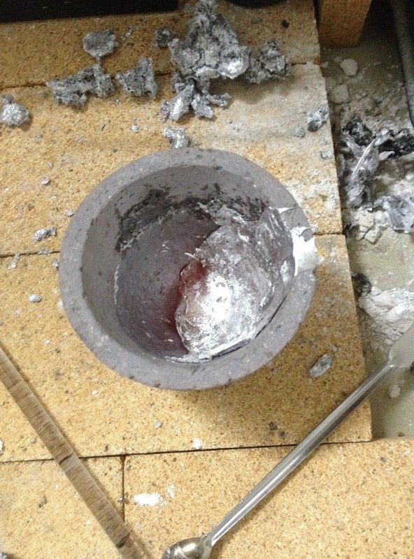

I’ve made another casting part yesterday, still using the lost PLA casting process:
Super hot crucible, I’ve almost burned my hand through the casting gloves just by standing 30 cm away from it

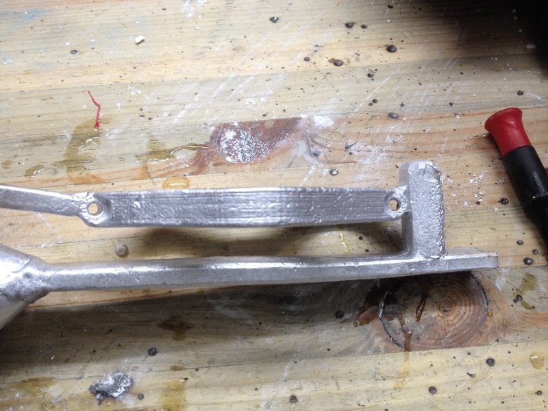

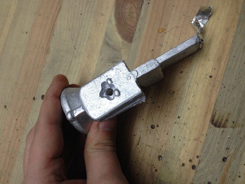

Here is how it came out from the mold:
[attachment file=49136]

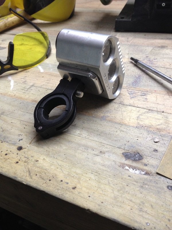

After a bit of sanding:
[attachment file=49137]

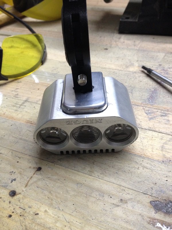

Then fine sanding with 600 grit paper and a bit of polishing, nothing super fancy but I think the result looks pretty great already:
[attachment file=49138]
[attachment file=49139]
[attachment file=49140]

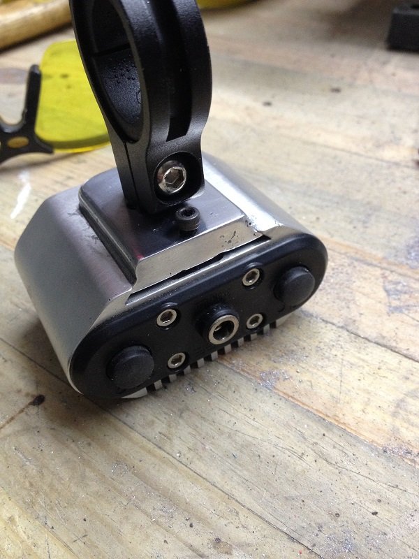

It is a bracket for a LED lamp, I made that for one of my coworkers.
The result is not perfect, a few tiny holes all over the surface, the little cross shape in the center is a bit too rounded and should have been a bit sharper, and the side grooves didn’t came out as the original drawing, but in the end it works and most of the defects are not visible and did not affect the function.
So, I call that a win too!
I still need to experiment more to get better results, I will try a different feeding technique next time. Also I may have to try using some kind of vacuum system, to get all the tiny details, but I have no idea how to build such a system yet so I’ll need to make some research.

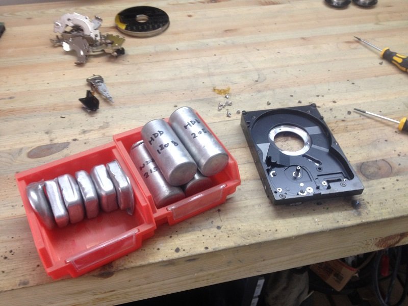

I’m making some stock of aluminum ingots for further castings. I’ve melted 6 Hard disk drives aluminum casings and got about 1.2Kg of nice aluminum. Does anyone has any idea what kind of aluminum this would be?
