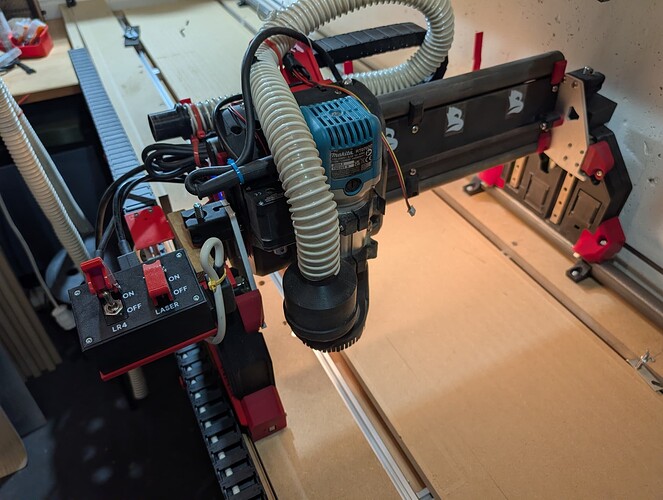

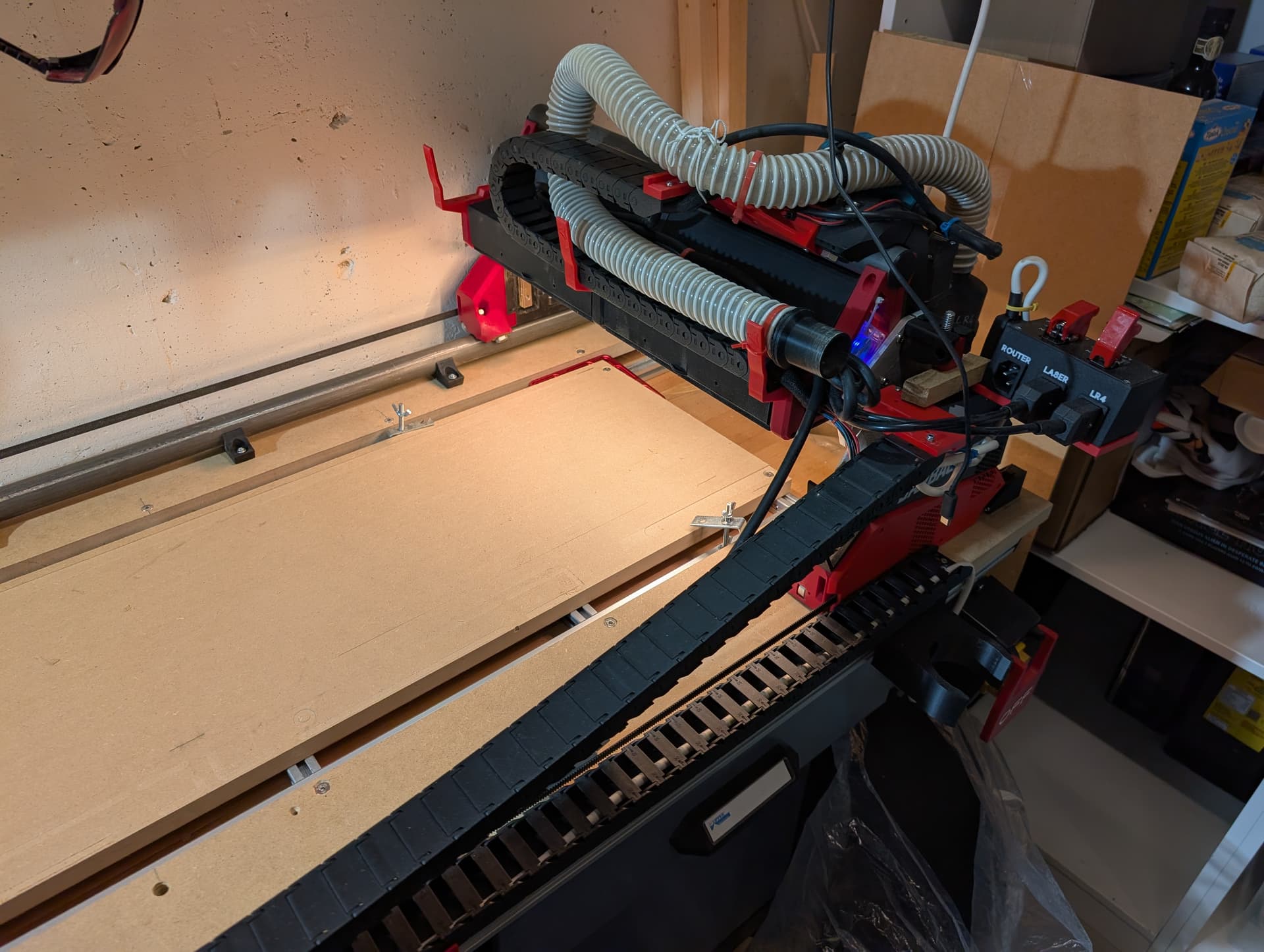

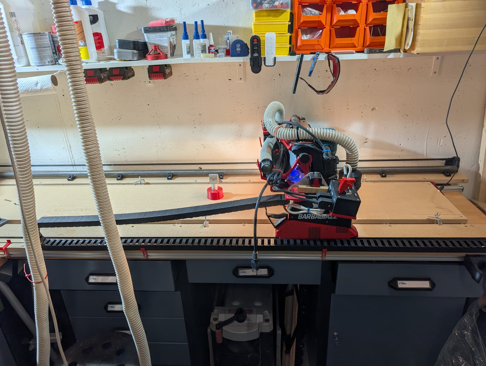

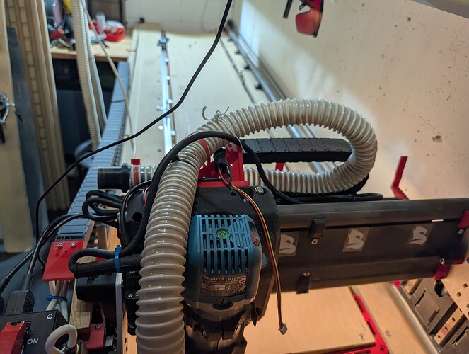

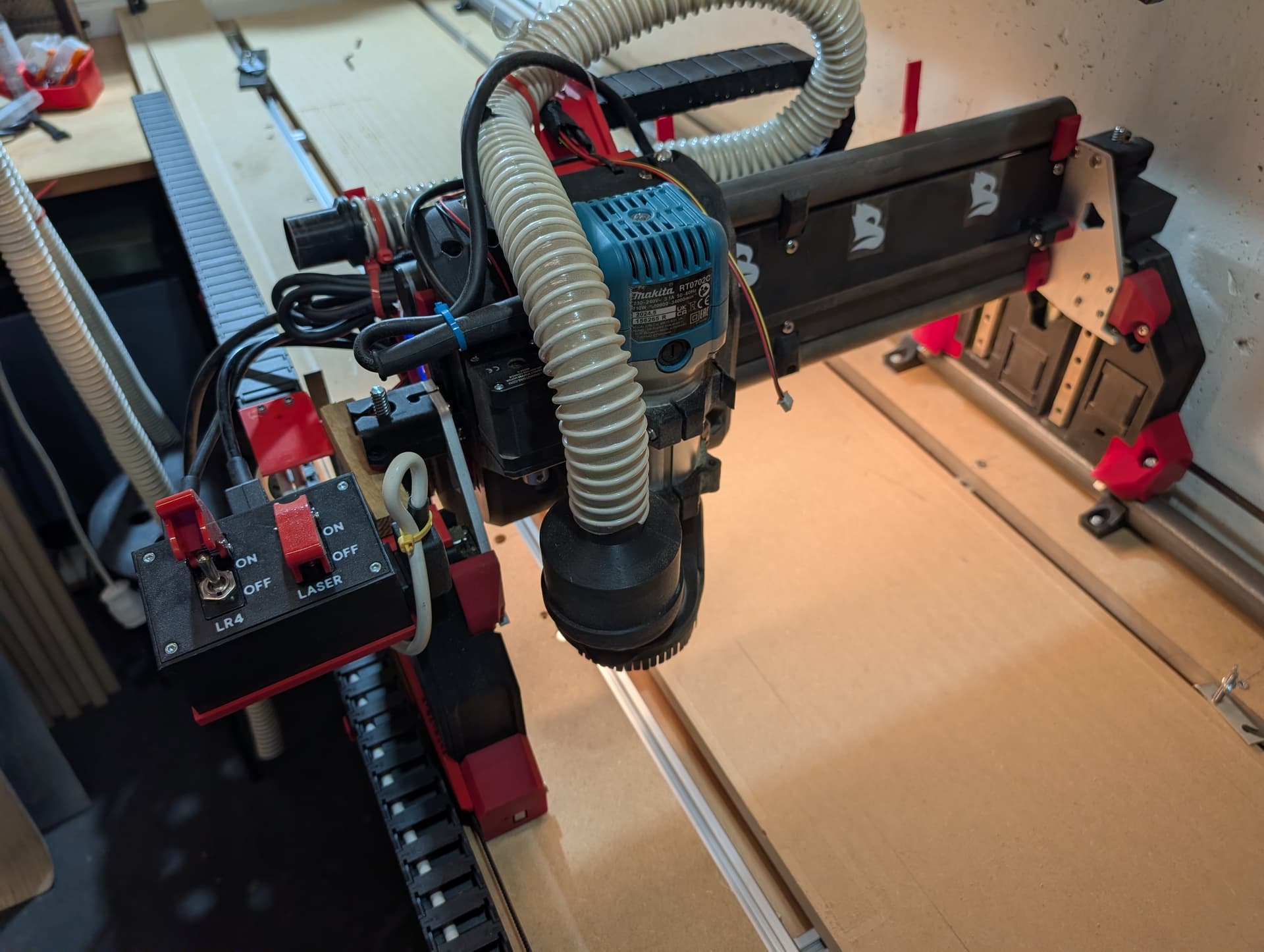

Hello,
Here’s a few pictures of my LR4 aka “SkiNC”. I am borrowing the SkiNC name from JD from RedBarrel: SkiNC
The main constraints I had for building this machine were:
  1. Limited space in my basement
  2. Having a working surface on 2 m long
I ended up with a 300x2000 mm cutting area
The machine is primarily used for :
  1. Cutting the core
  2. Cutting the base and the tip/tails inserts with a dragknife
  3. Using a laser diode to cut the wood veneer for the topsheet
  4. I am considering to use the machine for core profileing but not sure how exactly (I will open a dedicated topic). For now I am using a jig with a handheld planer
Of course this the current state which I consider 99% done but you never know :slight_smile:
Cheers
Mike

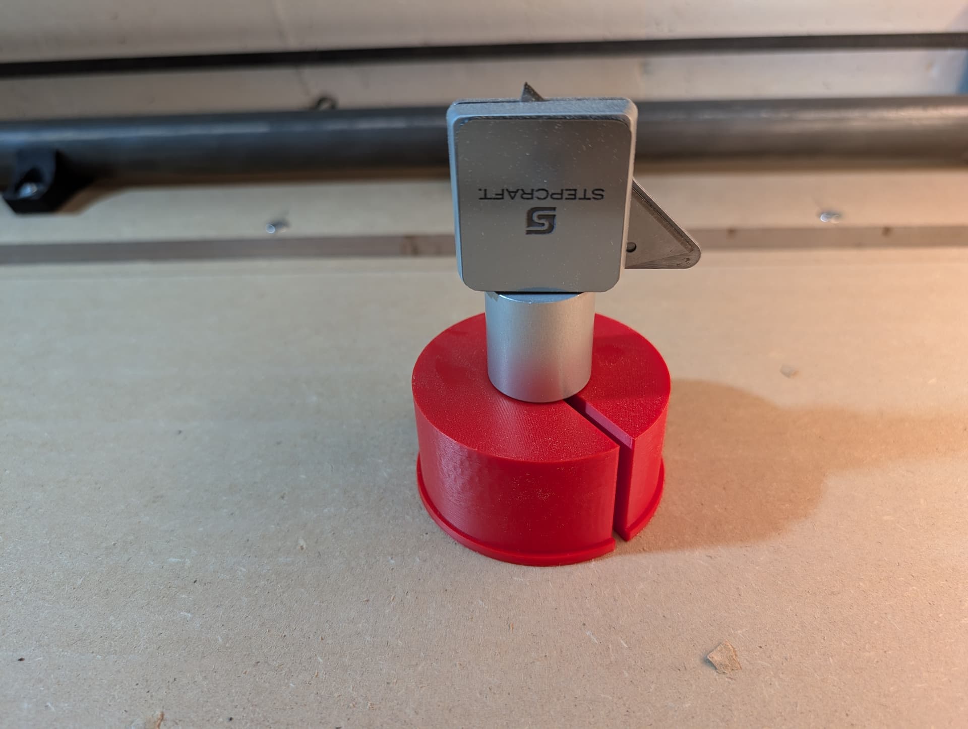

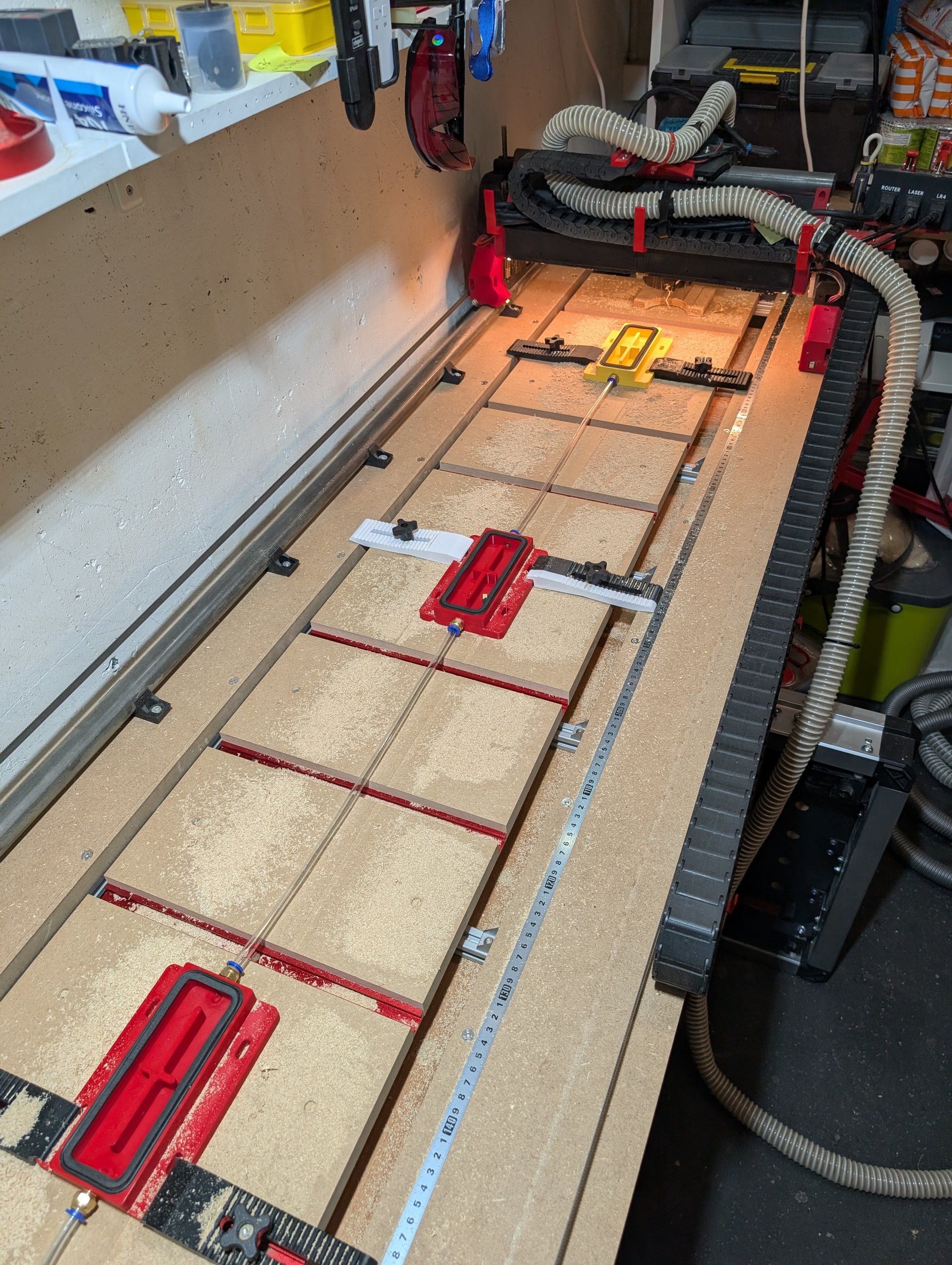

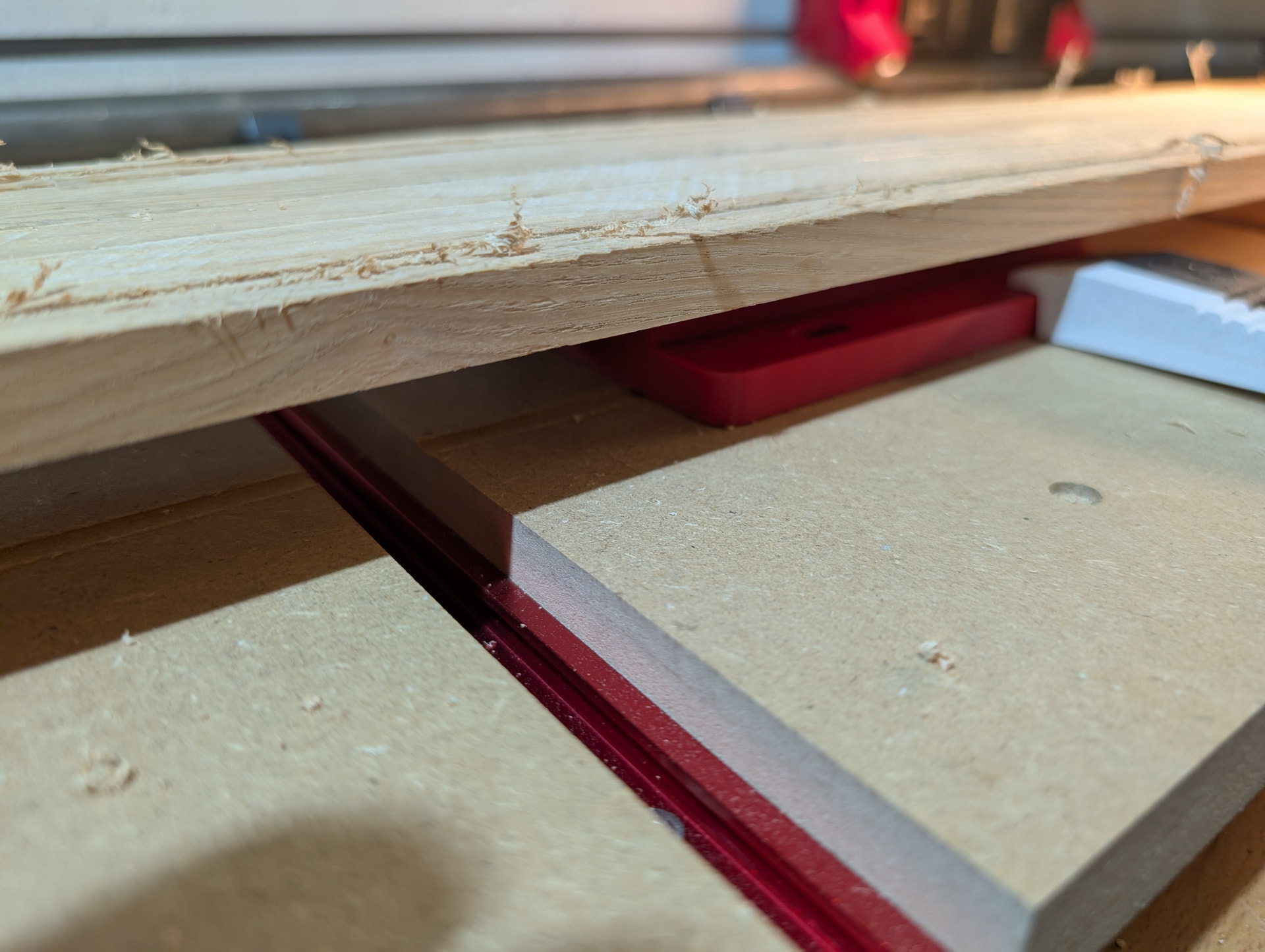

I started to use vacuum pods on my SkiNC and they are a great upgrade. I printer these Vacuum Pods with PETG-HF and modified to have two holes to allow daisy chaining. I use the same vacuum pump I use to press the skid.
These look so much more easy to print than mine… :smiley: Damn…
Very nice setup I like the series idea. Do you notice any loss of vac pulldown on the far end?
For now I only did 3 in a row and no issue with the last one.
