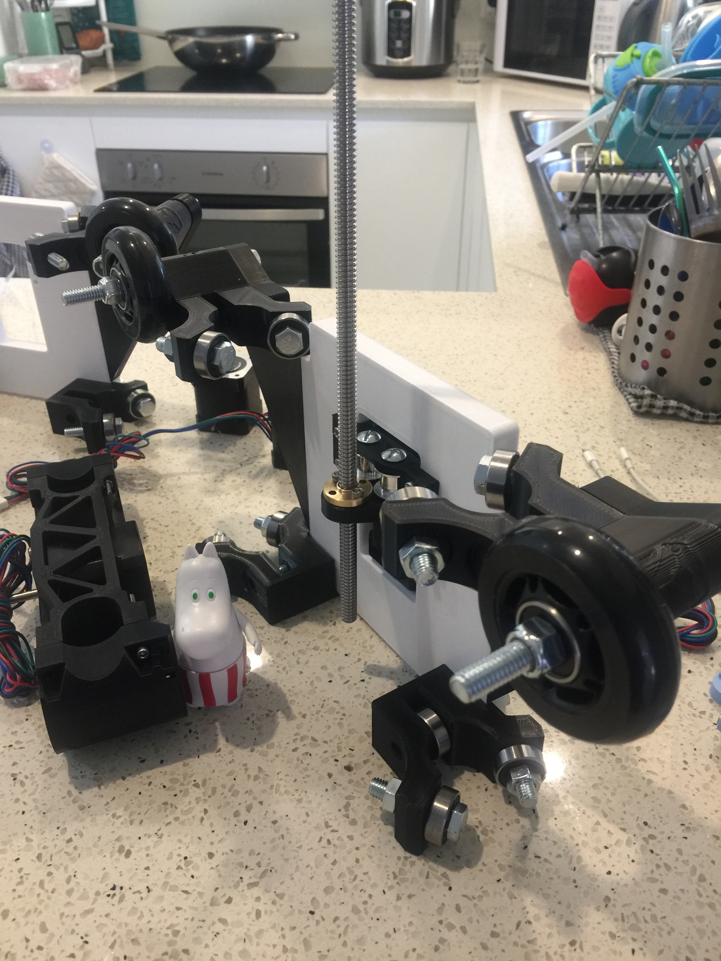

OK so I’ve finally started the build process… all plastics are printed and assembled ( no problems there ) I did have a have issues tracking down the correct size nuts and bolts though. I’ll atttach a few images of my progress to date. I printed the Side plates (Y Axis) rather than cutting them from ply wood. They seem to be extremely rigid. I ahve all my pipe cut and have the BIGTREE SKR-PRO V1.2 board hooked up and poweredon with TFT35-E3 screen powered on.
Next up - The stepper motors (nema 17) I’m finding it hard to track down any walkthru on setting these up as the LR2 docs online only show the RAMPS board. I feel I’ll have no prob. connecting the wires from each stepper motor. The main problem is in the firmware and hooking up seveal end stops.
NUT n Bolts and plastic bits… everywhere.
Here you can see a 3D Printed Y Plate ( three parts dove tailed and glued together )

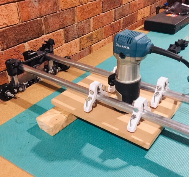

Today I built a temporary table so I could assemble the LR2.
Spent most of the afternoon drilling cutting screwing… and then the assebly began.
Here’s a few pics so far.
Tomorrow I hope to square things up and attach the belts.
BELTS are on…
