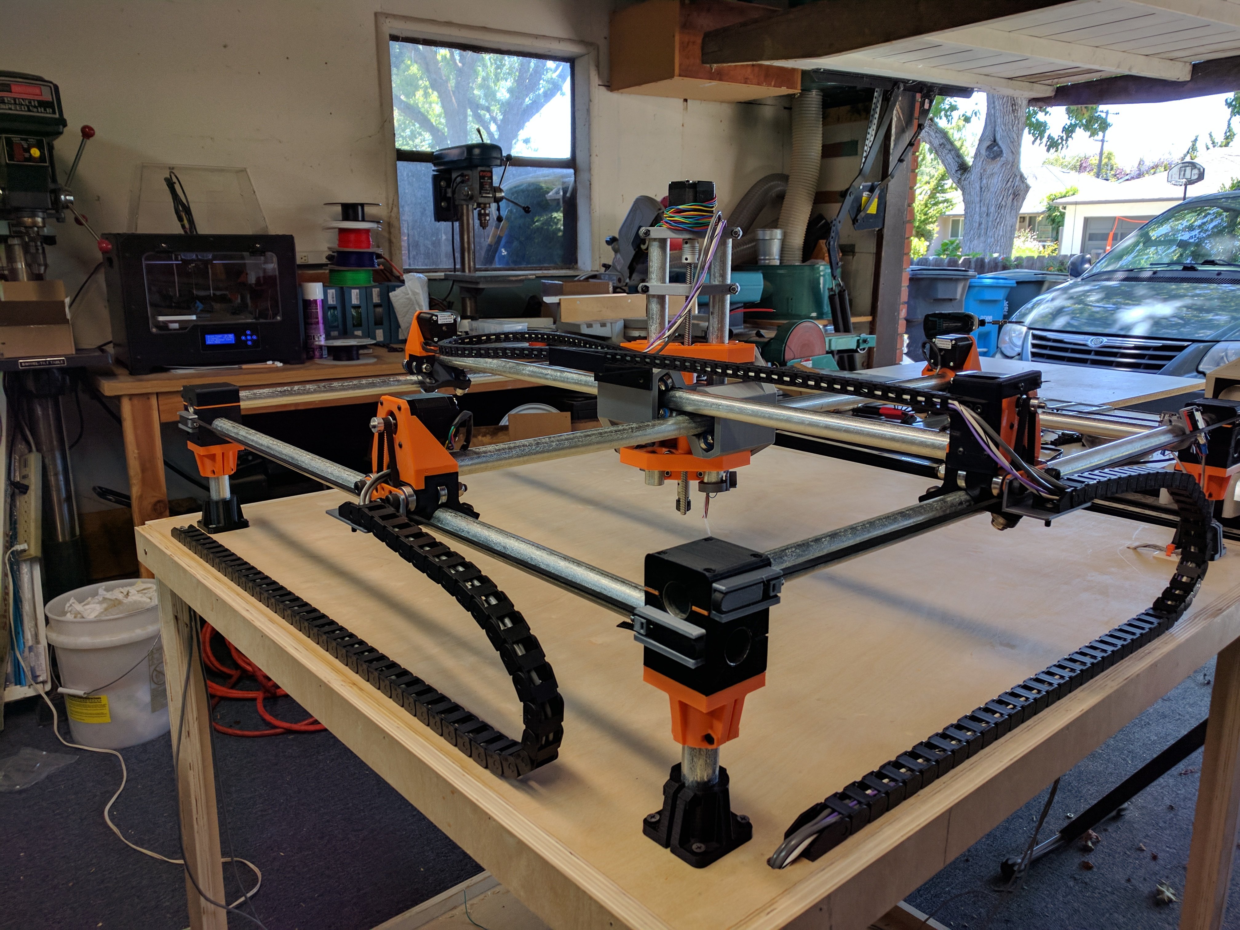

My 525 Build
So I am just finishing up on my build. So far so good. I used 2 sheets of Birch play 48X48" and made the table (40X40")
I was using the ramps setup but decided to use Mach4 (overkill I know)
I’m hoping someone can help me determine the “Revolutions per inch” number that I need to set up the motors in Mach. Is there a calculator somewhere I can use?
