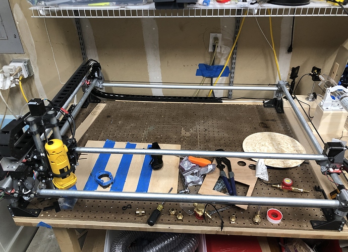

long time user and modder, recently added CO2 laser capability, but mostly stick to supporting the Facebook group. Thought I’d update my pictures of my build.

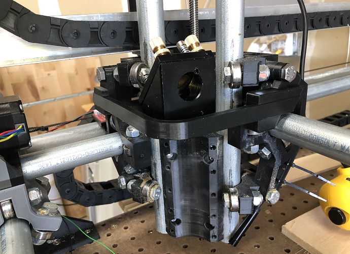

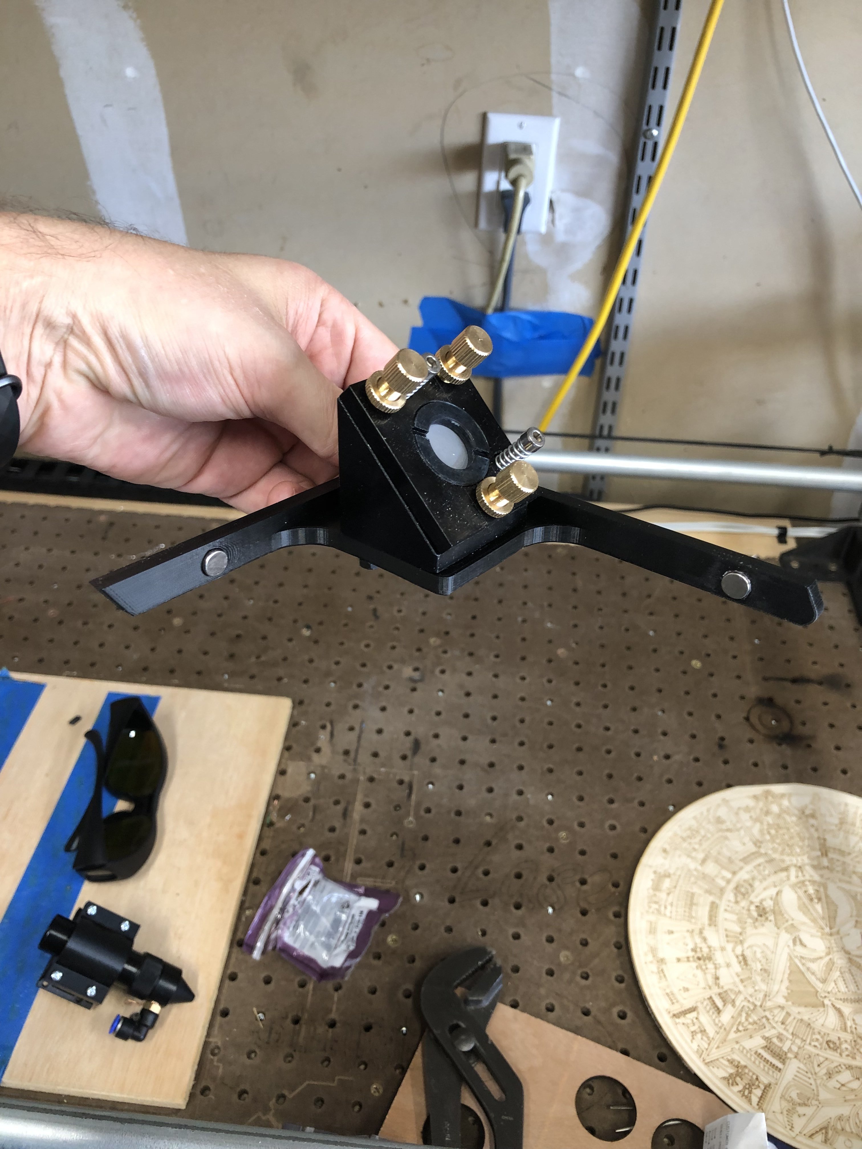

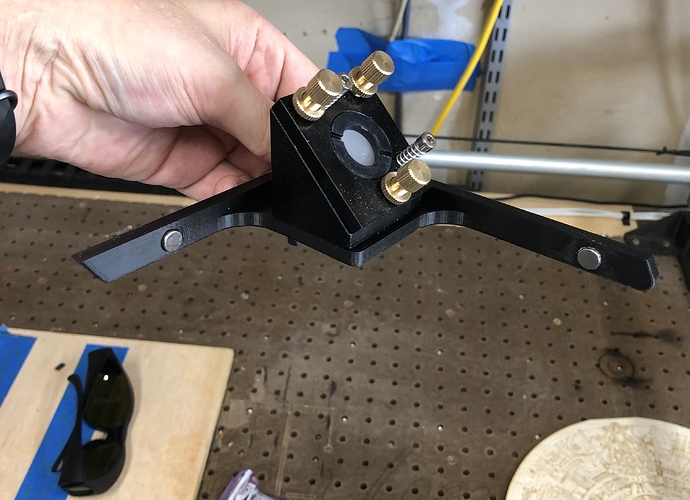

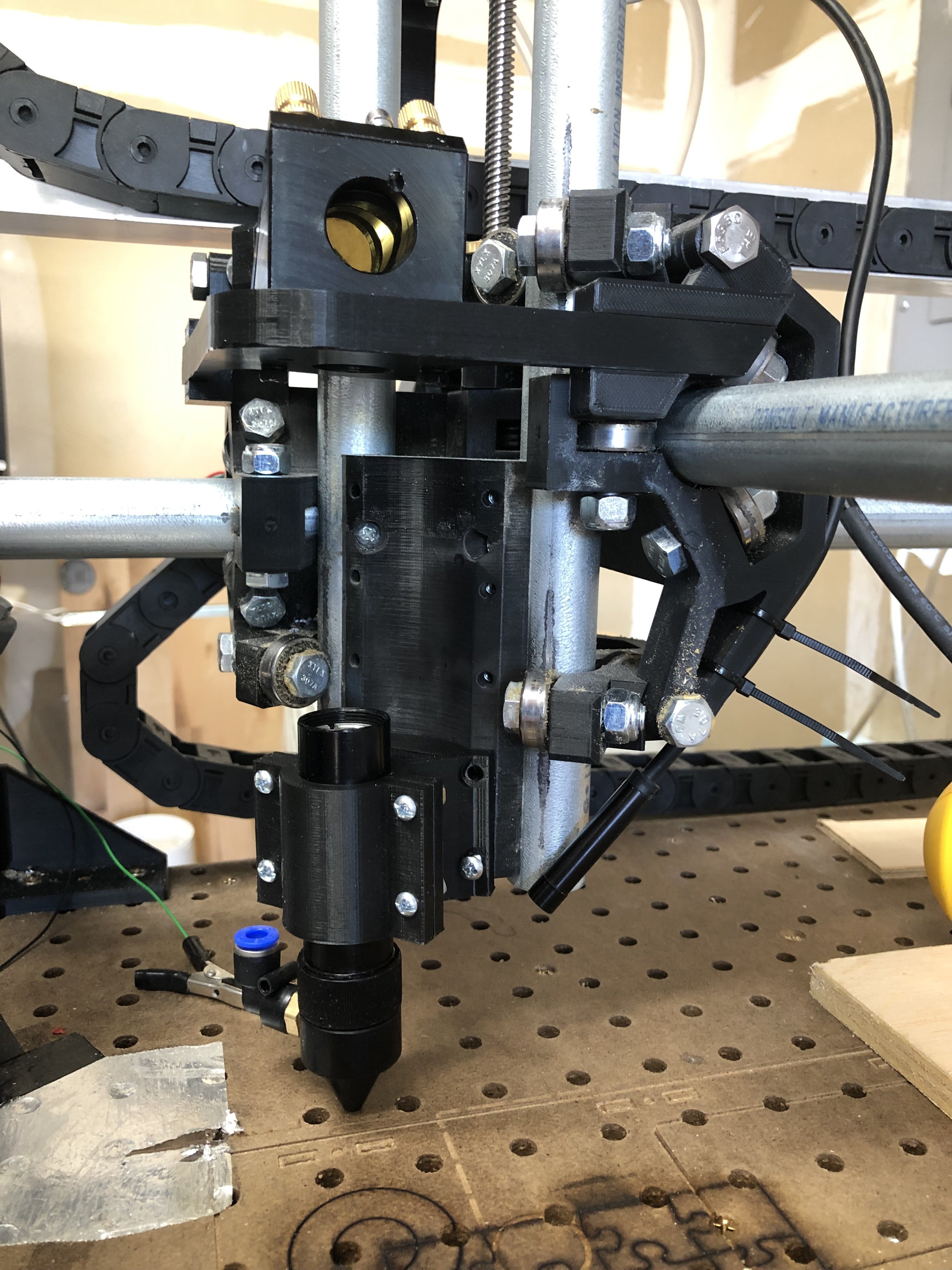

my CO2 mirror set up allows for easy removal of the final mirror so I can switch tools to a router or spindle.

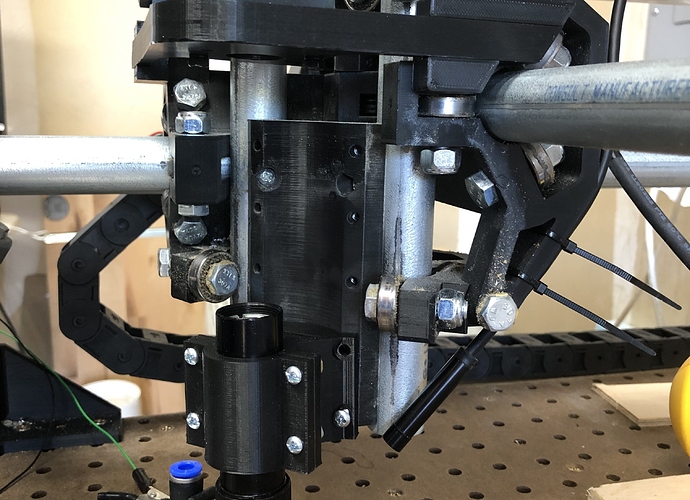

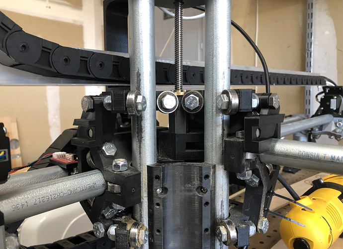

the Z axis is also available in laser mode so I can move my focal point.

Cool. From the pictures you posted I can’t see how the laser makes it to the work piece, but maybe that’s just my inexperience. So how powerful is the tube you have? How do you deal with the fumes/smoke etc?
That looks like a whole lot of fun on one bench!
Here you can see the magnetic mirror mounts I made and the focus lens attachment to the z axis.
my tube is a 40W Ten High from Amazon. I also have a 5.5 Watt diode model I can swap in for just engraving.

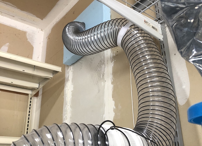

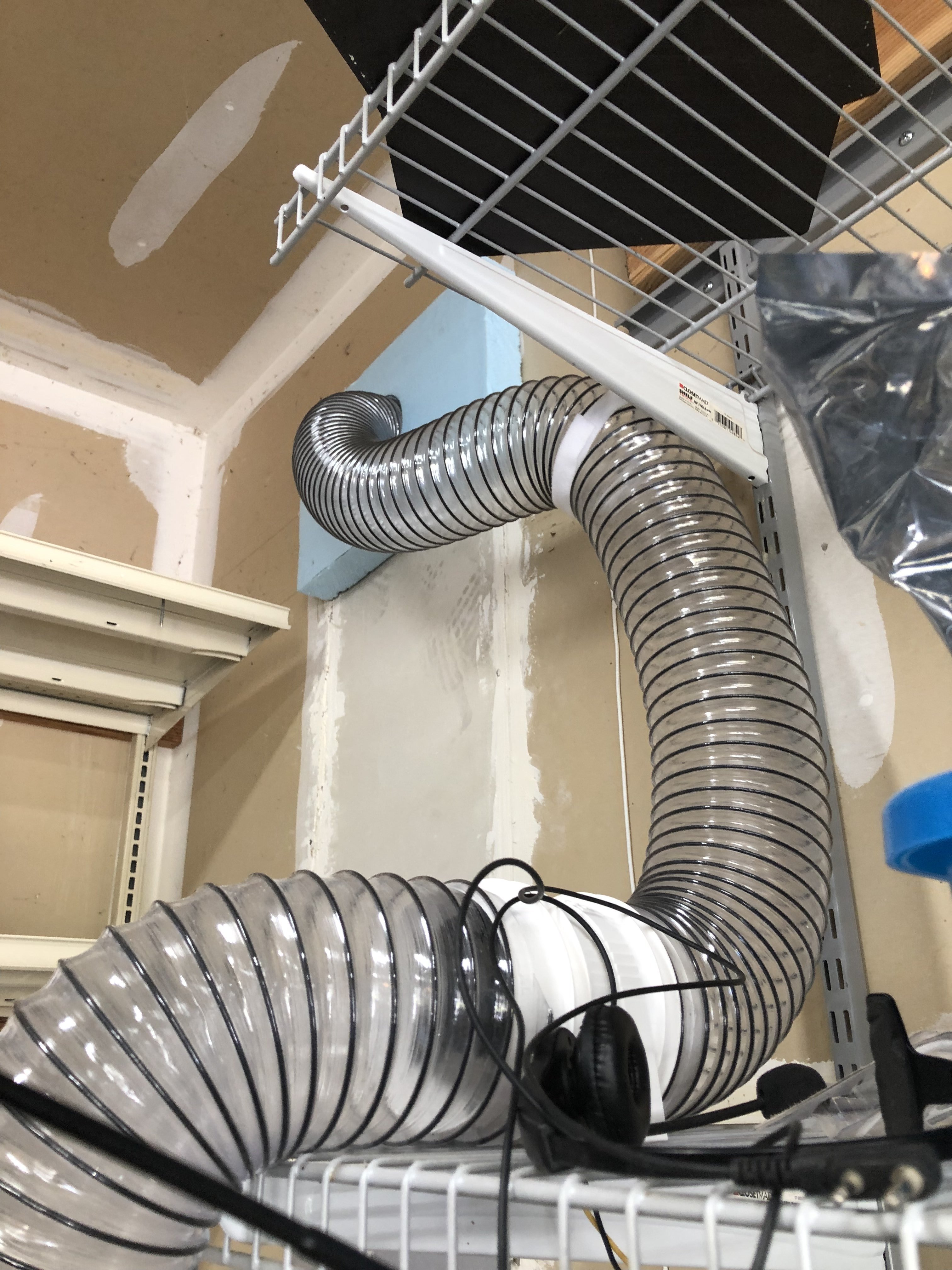

For fume extraction I have a 12v 4” duct fan inline with my dust hose, pull all the vaporized particles away and the smell and vents it outside at my neighbors house ?

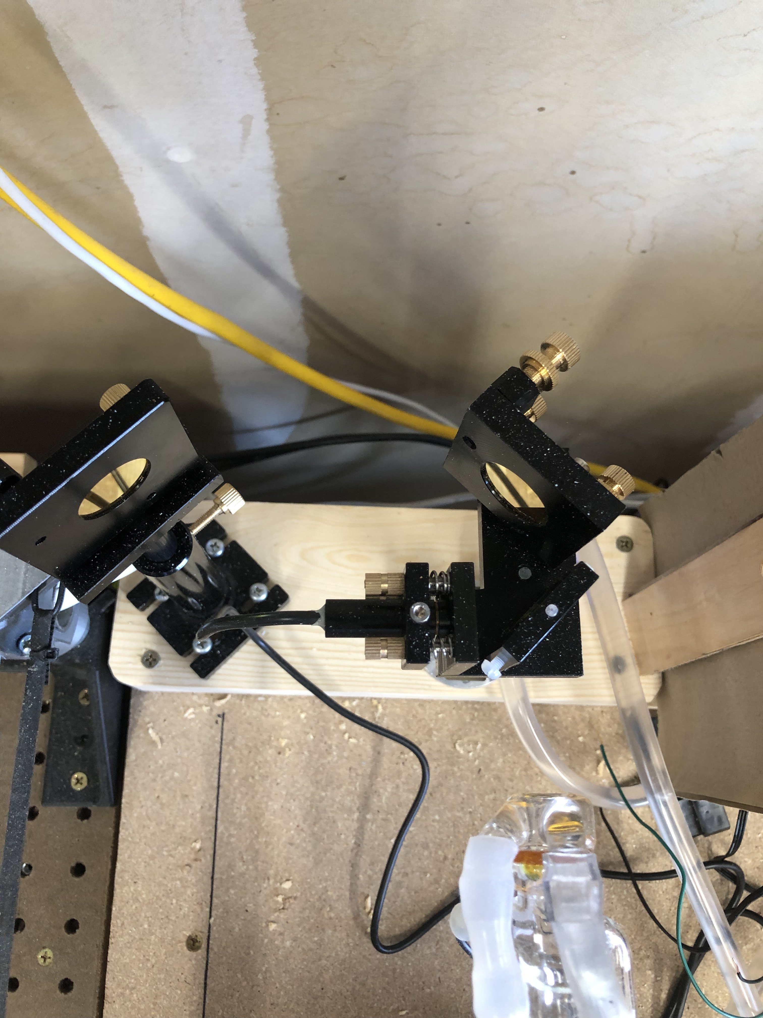

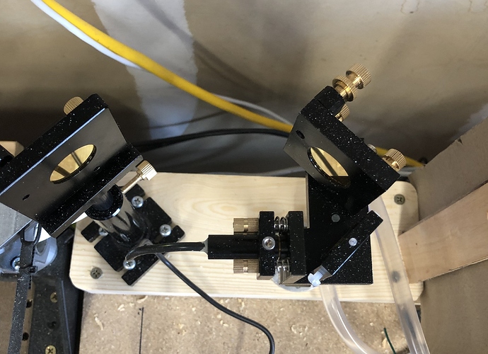

A fun first stage mirror and beam combiner combo lets me set up a laser dot pointer directly along the same path as the CO2 tube making mirror alignment much easier to do in real-time.
and a great way to verify the path after a tool swap.
