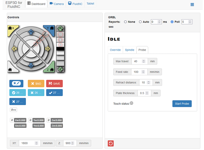

And how do I get this layout?

old layout, you don;t want that.

Ok, I will leave the layout as is. Yes, it was working perfectly before, minus the homing, which I believe is fixed now. I have the jackpot 3. I never unplugged it while moving, but I did unplug it a bunch of times while doing diagnostics, and I may have unplugged/replugged while the unit was on. I ordered a new jackpot3 that is supposed to be here this morning.
