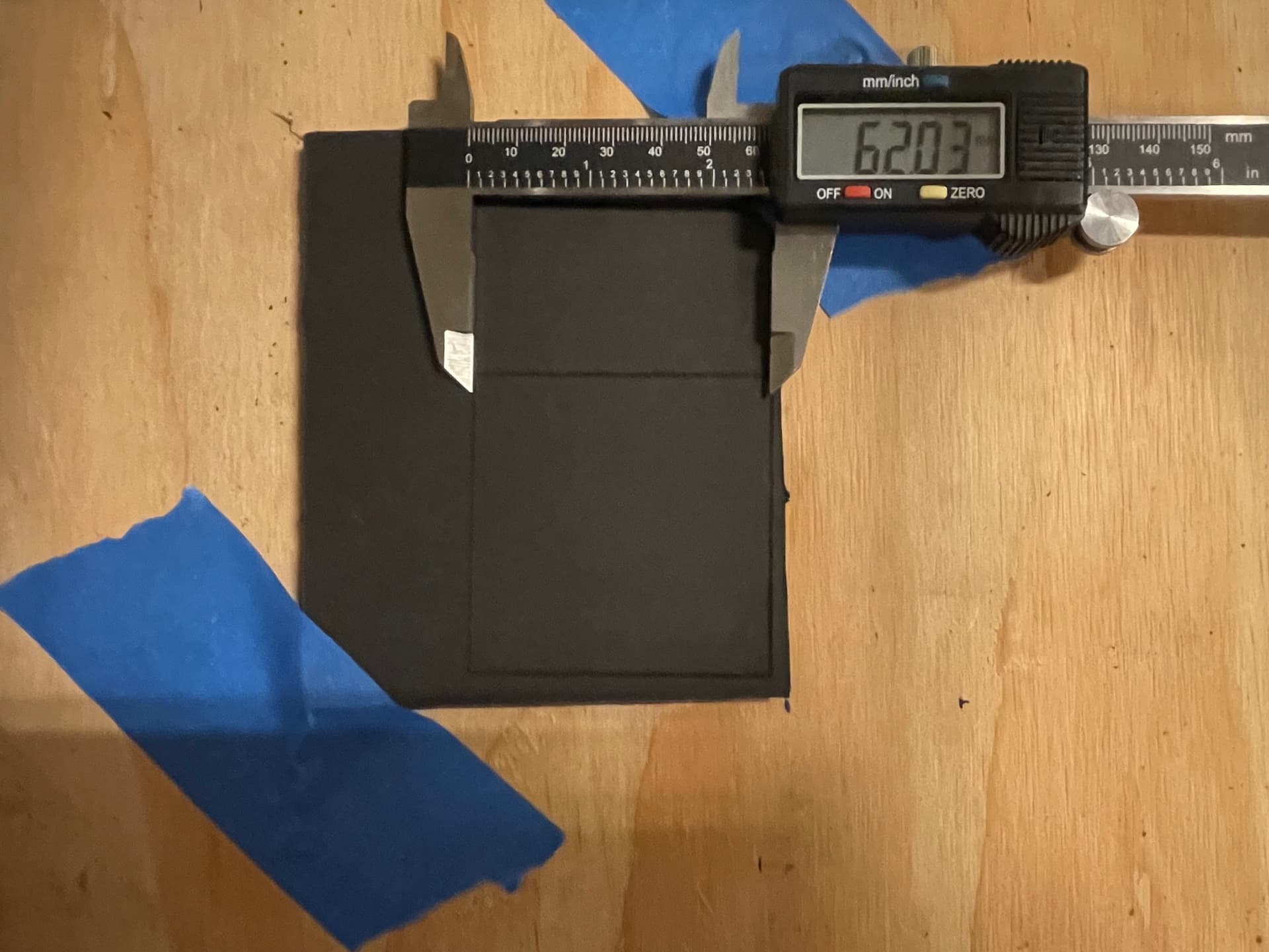

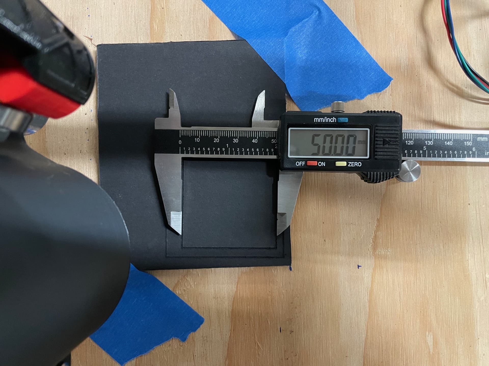

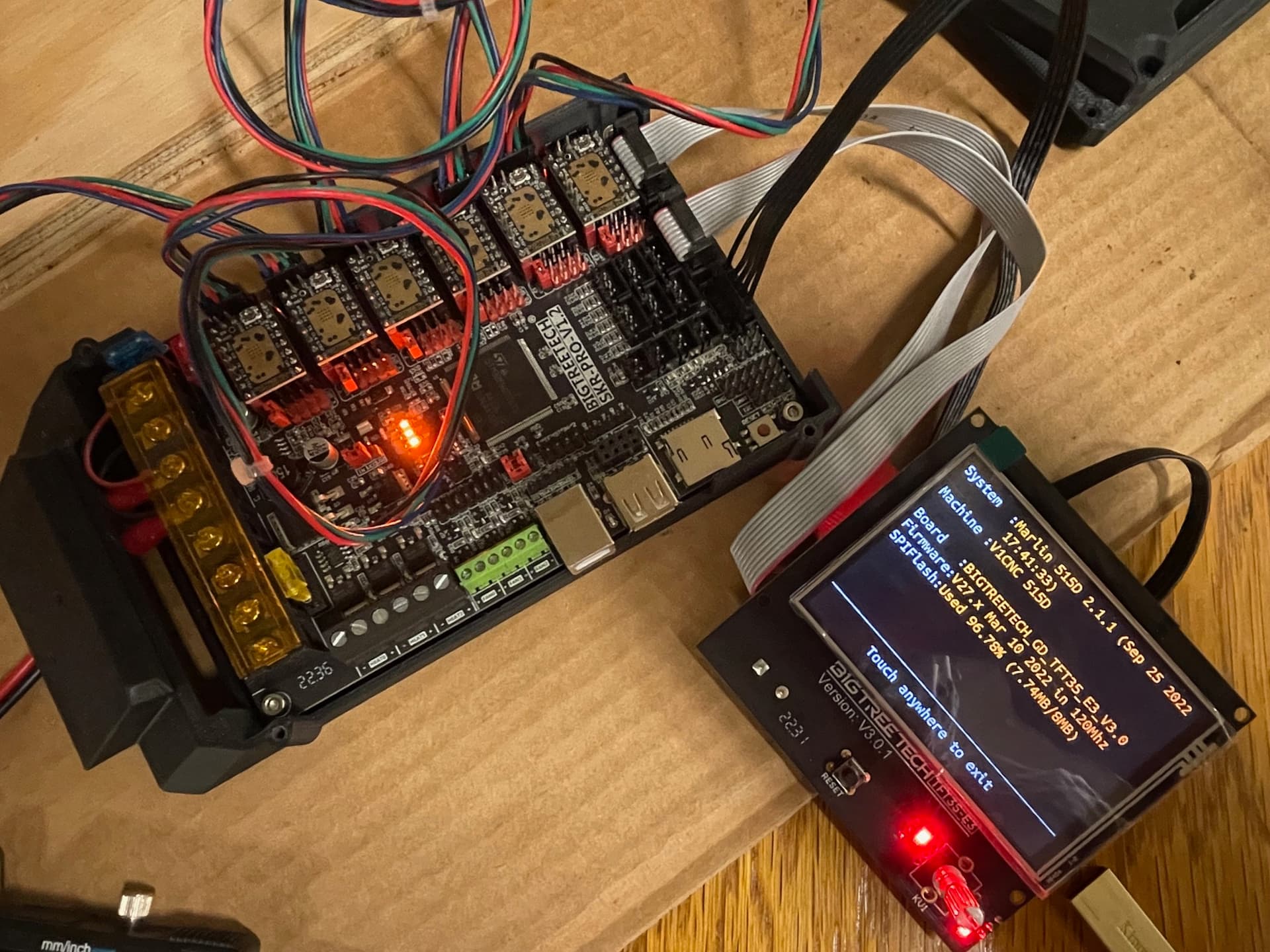

I am newbie and having an issue with the X and Y scaling. I carved a 50mm x 50mm square and the MPCNC generated a 62mm x 62mm square. I am not sure how to fix this. I am using SKR PRO V1.2 with the firmware that came with it.
A few pics…

Is this a new build? Either you have the wrong size drive pulleys (20 vs 16) or your mm/steps settings are off. I would bet on the former, but you could compensate by adjusting the latter (although buying the correct pulleys would be a better choice IMO).
Thank you Bartman, I have ordered the 16 tooth pulleys, and I will give them a try. Keep you posted of my results.
Tehmosp
Bartman,
The 16 tooth pulleys came in and I tested them out. This fixed the scale.
