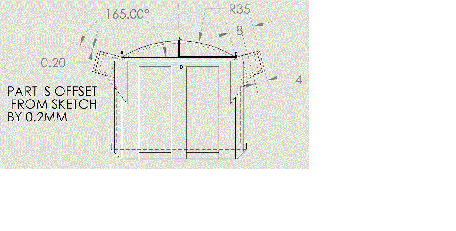

Ryan,
I tend to do my 3D printing design in OpenSCAD (its the scientist in me!) and so the dimensions of the toolmount would be useful. Can you confirm please that the dimensions, angles etc. in http://www.thingiverse.com/thing:805803 ( design of yours dated May 3rd 2015) are still valid for STLs downloaded from your site in November 2016? If not is there another source of the relevant parameters?

Those are correct.

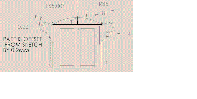

Ryan,
Its probably me being stupid but I think there is a critical dimension missing from the drawing. I have attached a gif with 2 dimensions A-B or C-D which I think I require. Only one is required as the other is calculable by school geometry. I have imported the STL into NETFABB and using its measuring function I reckon A-B is 37.35mm which produces an outline which looks correct but it would be nice to use the exact figure, rather than print lots of trial pieces.

AB=37mm, remember that line is then offset by .2mm to get the sketch I use. that usually makes up for 3D printers accuracy and allows for a tight fit.
